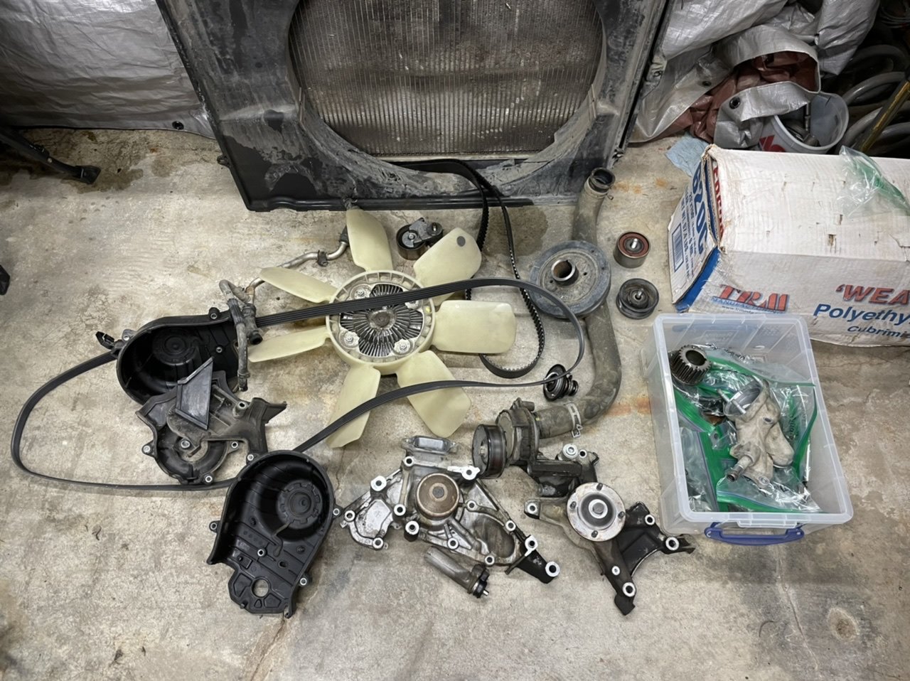

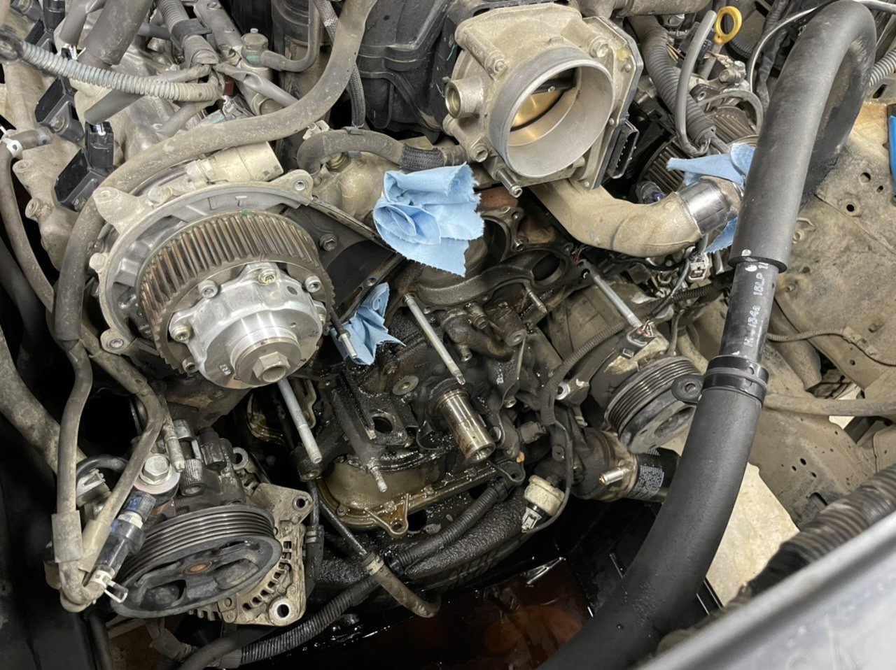

    Yeah it’s all torn apart right now. I need to replace the front main seal and the little water hoses.

    @Diablo169 There will be a date stamp on the water pump if its the original Toyota pump. Mine was the original. It had a November 2000 date on it.

    I suggest not being blacked out when you decide to tear your engine apart. Luckily I had my girlfriend with me to label bags.
    Still can’t find the upper left long water pump bolt Cool thing about Toyota’s is you only need 90% of the hardware to make it functional.
