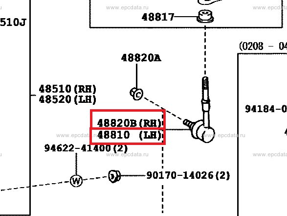

    Never try to use the national Parts site to find parts. It can lead you to the wrong part. Been there, done that.
    Use this: https://www.tundras.com/threads/howto-use-the-toyota-parts-system-to-find-order-parts.113808/
    Once you go to that EPC site linked in the bulleted parts section, click on "Transmission and chassis", then click on "Front spring & shock absorber".
    That will get you to the correct diagram. Then click "Open full size scheme" under the picture to get the big image. In the image, you can hover over the numbers to see the part name, or click the number to see the part number.
    Click on the "RH" number here, it will take you to the page with the right hand (passenger) link. Then repeat the process for the LH number. That will get you the number to plug into the Parts system.

    As long as you got the part ending in "6" you're fine. The part ending in "7" is for lifted trucks.
    The SuspensionMaxx links are fine, they recommend keeping the lower came (the rounded base) parallel to the ground at install.

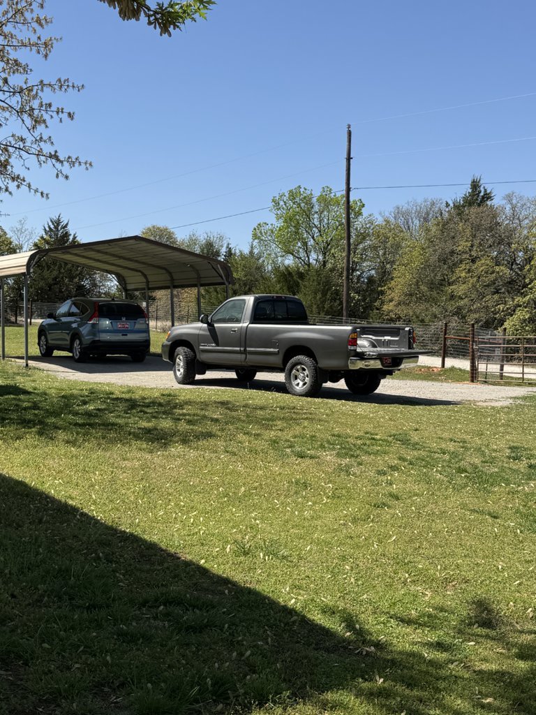

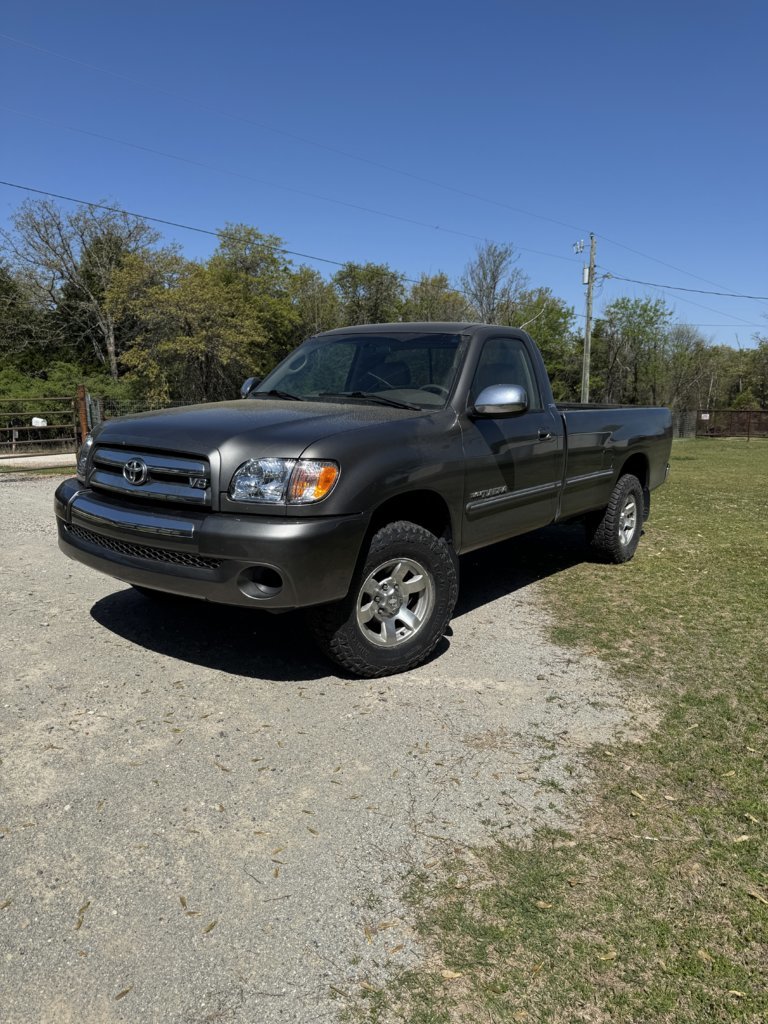

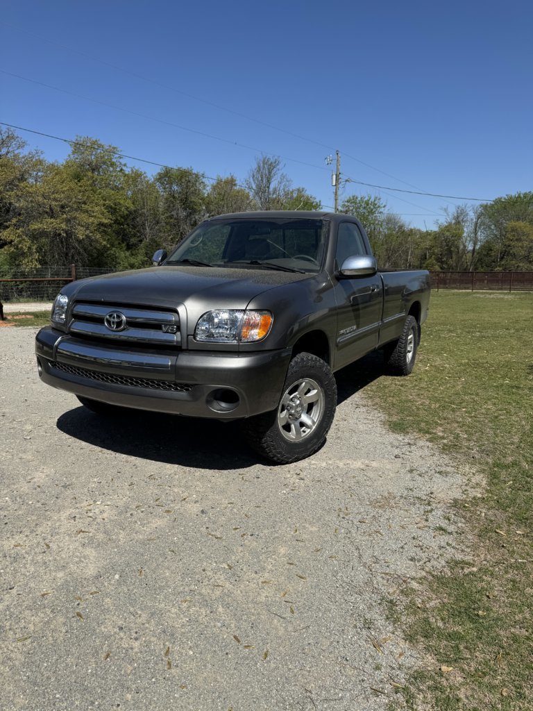

    Lift kit removed, Mickey Thompsons are a lot quieter. Bilstein 4600’s, new fluids, valve cover baskets, plugs, oem LBJ, aisin water pump, Timing belt, supermaxxx sway bar links.
    If anyone wants an almost new lift kit for a first gen with new tires it’s yours for 200 bucks.
    Thanks for all the help!

    Truck looks friggin awesome. Congrats!

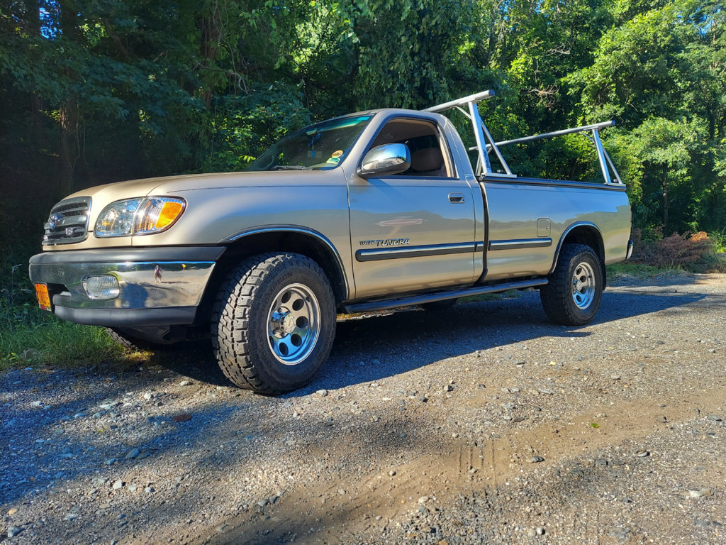

    I run same size MT on my RCLB w -4.5 backspacing..no rub at stock rideheight. Nice looking Tundy20240610_084857.jpg
