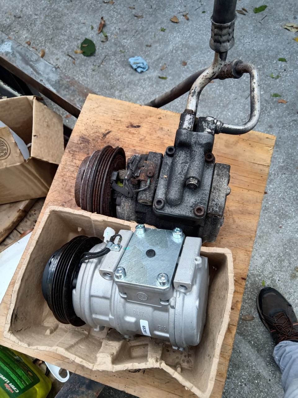

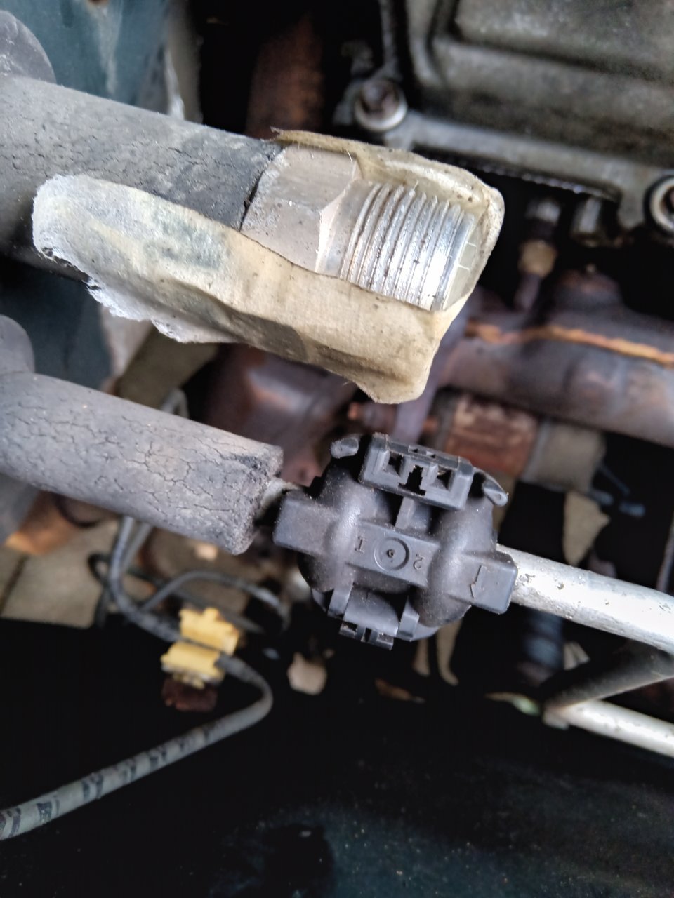

    Did I get the wrong compressor or am I expected to swap the top part over?
    Also what is this little doohickey and where does it go?

    If there arent hose ports, i guess you'd have to swap it over. Maybe the gasket is under the plate?
    more pics of the doohickey.

    My brother said the doohickey is an expansion valve.
    I just don't recognize seeing it anywhere

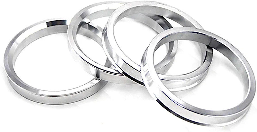

    I sold the 17" 4runner wheels today and so tonight I splurged new parts for Tuntra
    16"x8" 0-offset
    265/75/r16
    110 to 106 hub centric rims

    That’s just a shipping cap to keep it clean, you’ll have to swap over your top piece, and usually they get shipped dry, so you’ll have to look up oil specs and amounts to add before you finish swapping top plates. That chingaso is probably the filter drier if I had to make a couch guess.

    My brother said the chinsago is an expansion valve

    Cool! Thankyou for helping me finding the expansion valve. Luckily I don't have a center console and I have the lines already disconnected so the job shouldn't be too bad

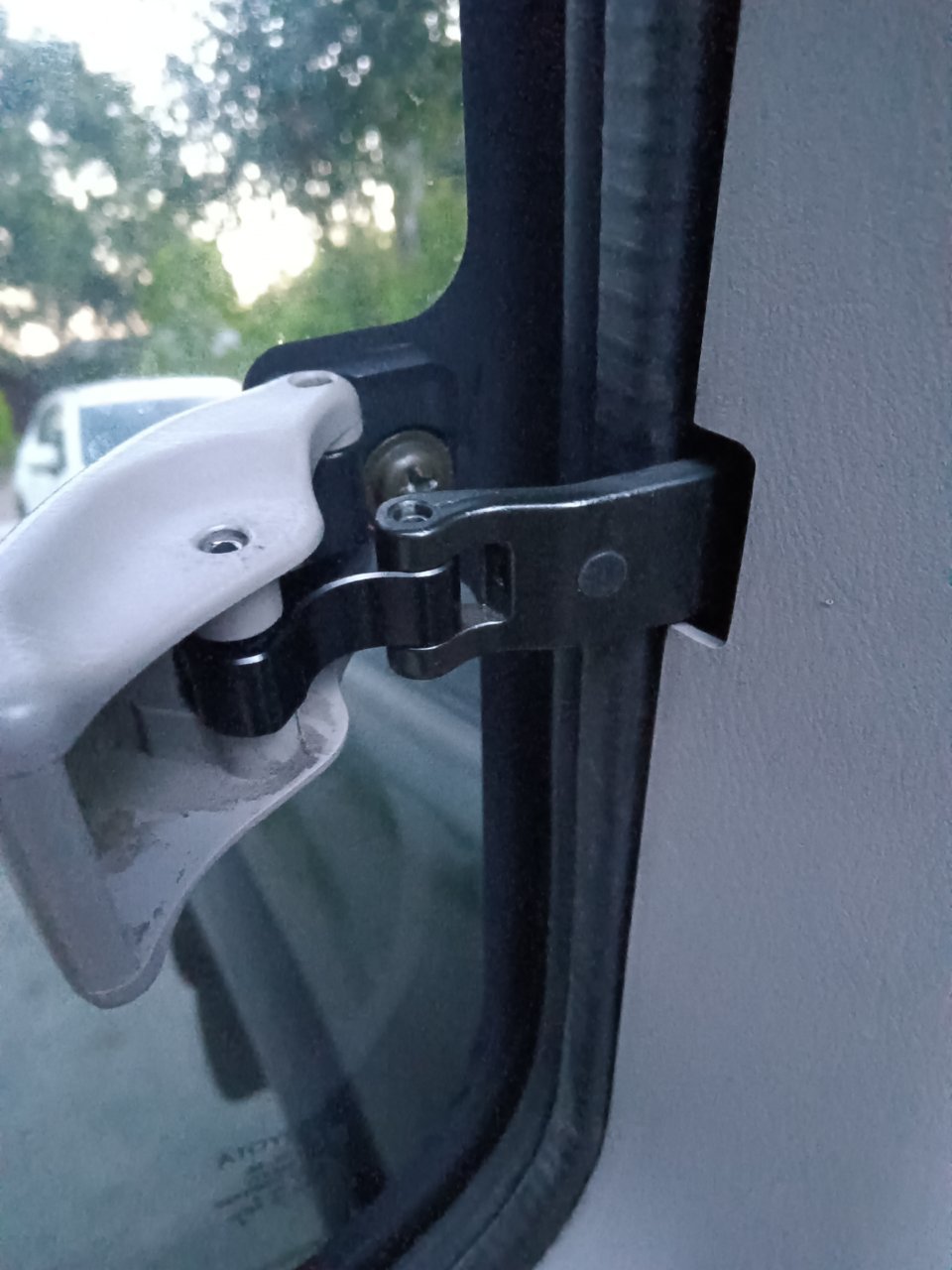

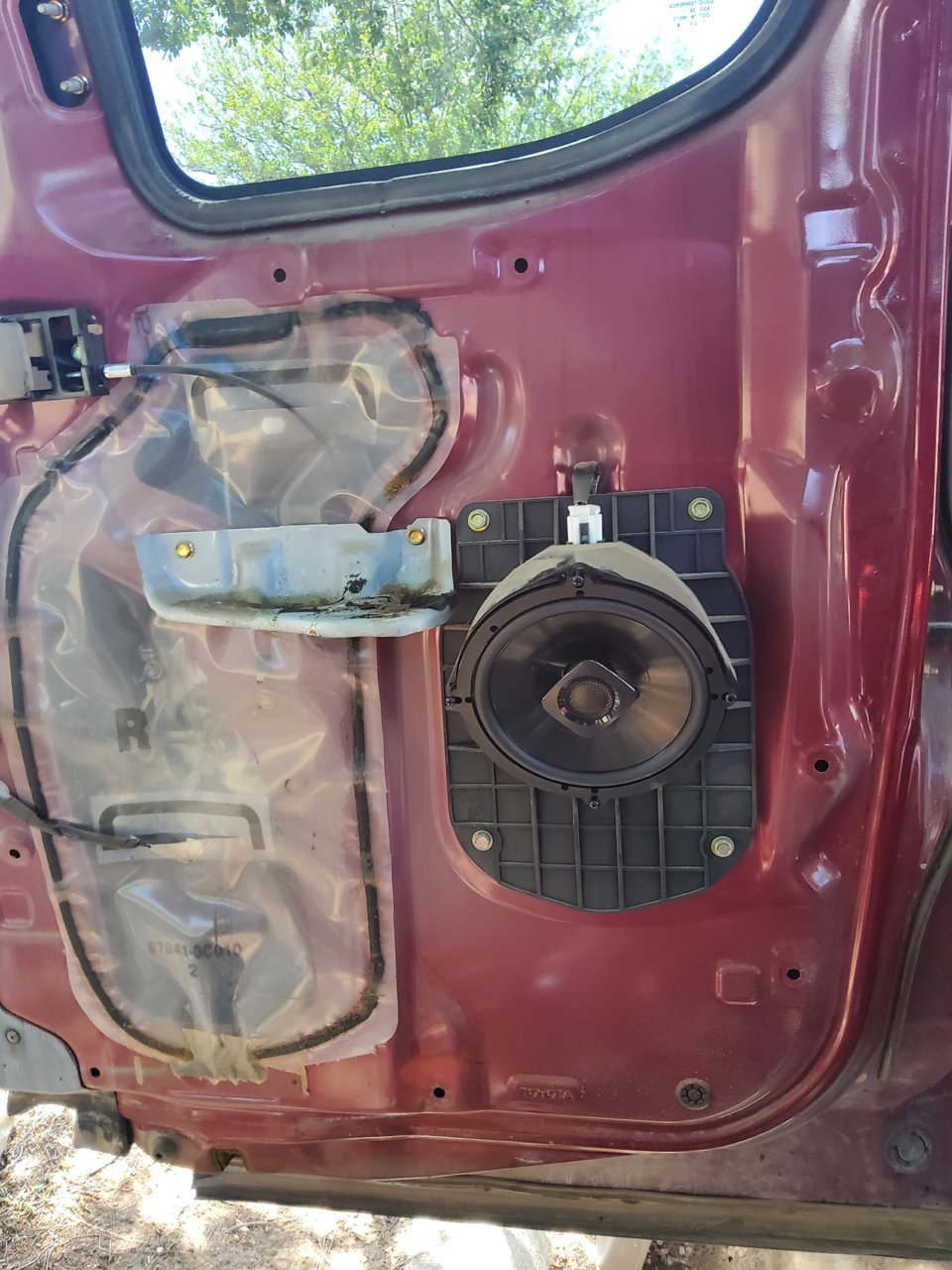

    Shifty, thanks for the input. Both sides are broken on my truck so I need to replace them.

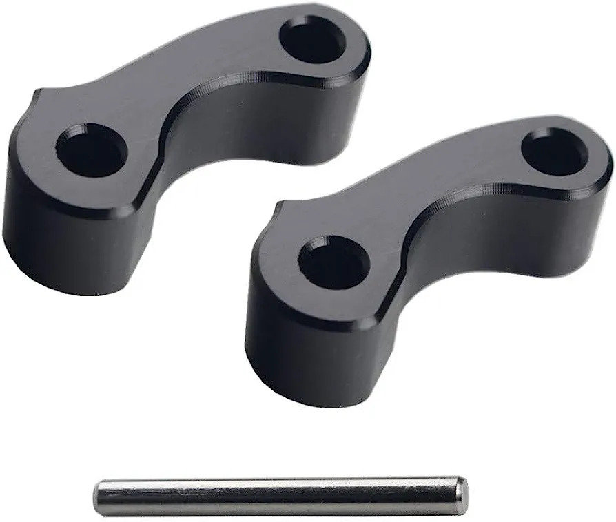

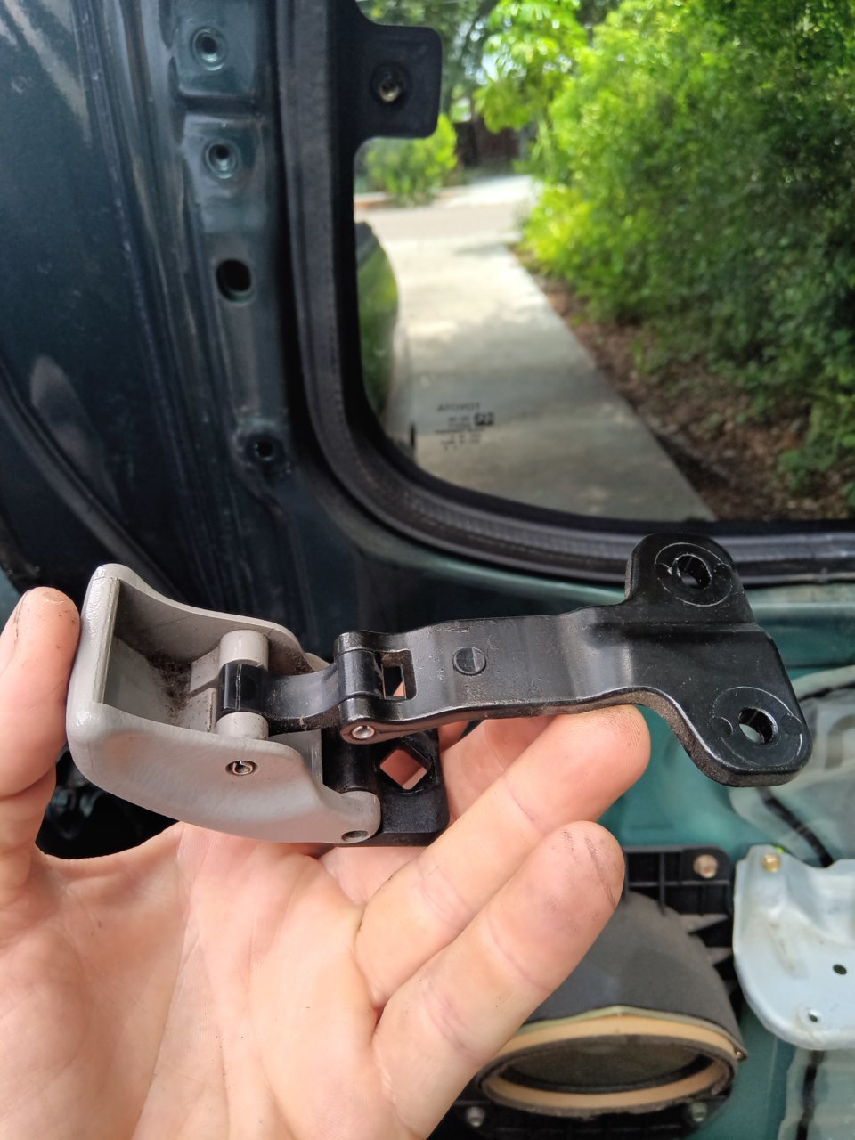

    I think it was @Jack McCarthy who mentioned the ideal way, probably in reply to the post I linked.
    Pop off the door card back there. There are two screws holding the latch onto the door frame, pop them off. There's one screw holding it to the glass, pop it off.
    Once off, transfer to a bench. Tap out the tension pins. Don't try to re-use the tension pins; Use the round pins that came with your kit - mine had none of those, and the force required to install the OEM tension pins without a proper tool is ... I believe ... what caused my unfortunate result.

    PS - while you're in there, you could upgrade your rear speakers with some solid 3-ohm JBL Club midbass co/tri-axial speakers too :D

    I used a punch with a ball-peen hammer to get them out, supporting the backside with a block of wood to localize the force to mostly just the pin itself.

    Latch removed:
    Aluminum Doo-dad installed and latch replaced:
    Feels good. Window opens and closes nice.

    I reused the pins on my AC rear window latches. Had to tap the holes a little larger with a drill bit (RIP, drill bit) and they still didn't quite fit, so I squeezed the pins inside of some pliers and pounded the pliers with a hammer to "close" the weird serrated jaws-thingies on those pins all the way, then they fit just fine.

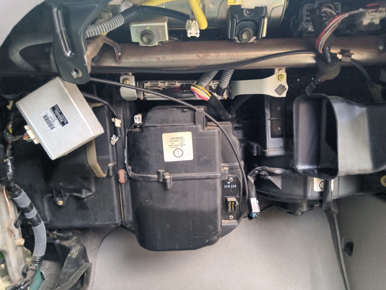

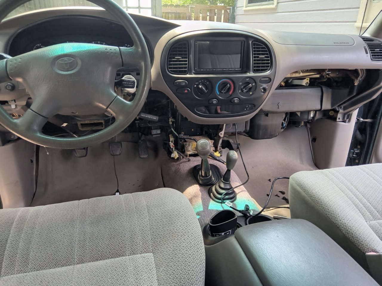

    Getting to the evaporator and expansion valve
    Now I'm stuck until I can get the line disconnect tool.....
