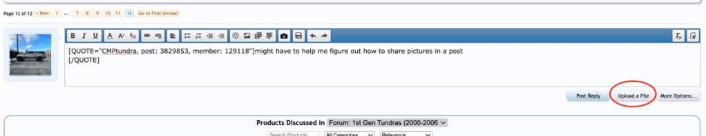

    might have to help me figure out how to share pictures in a post

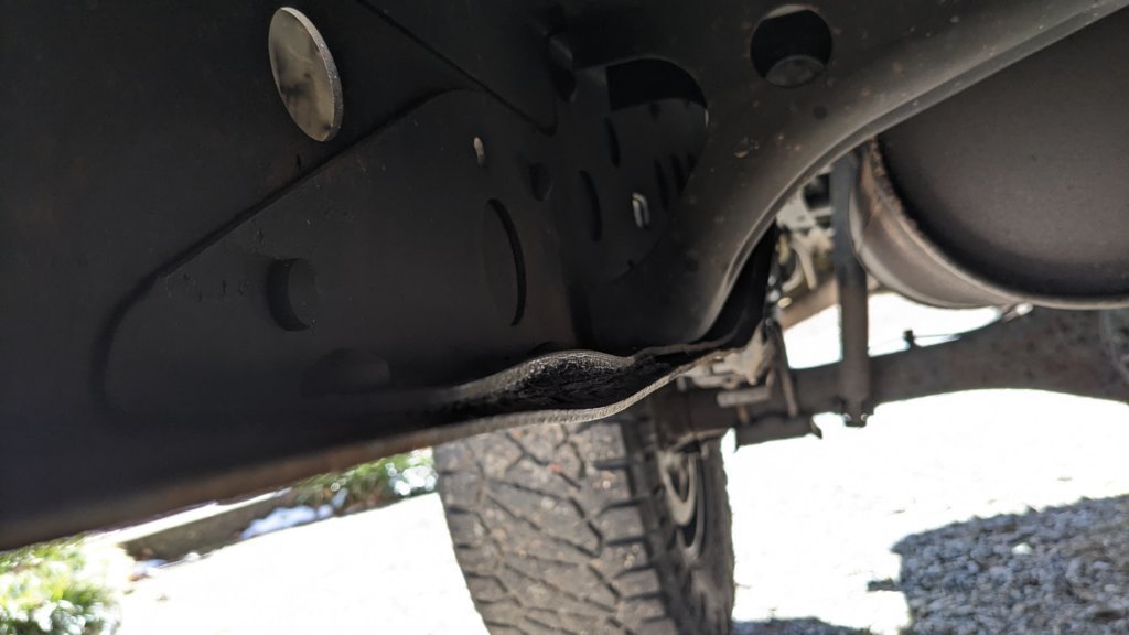

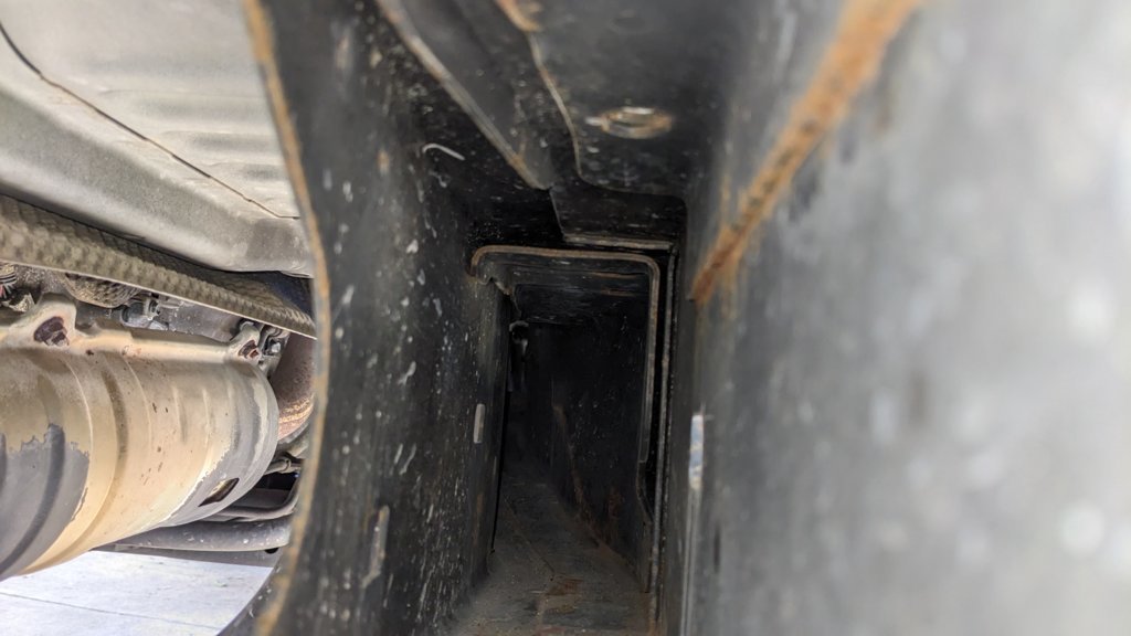

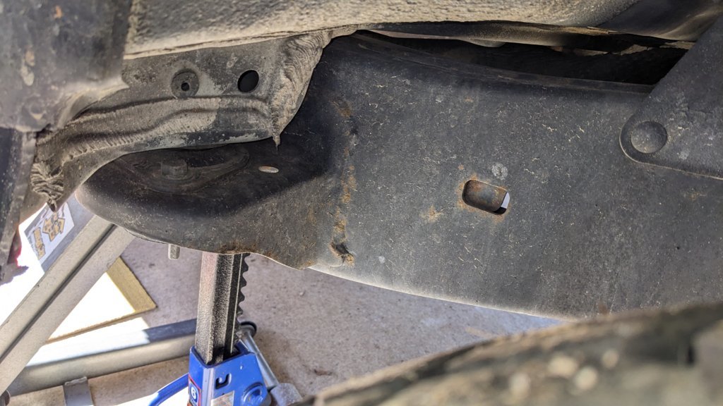

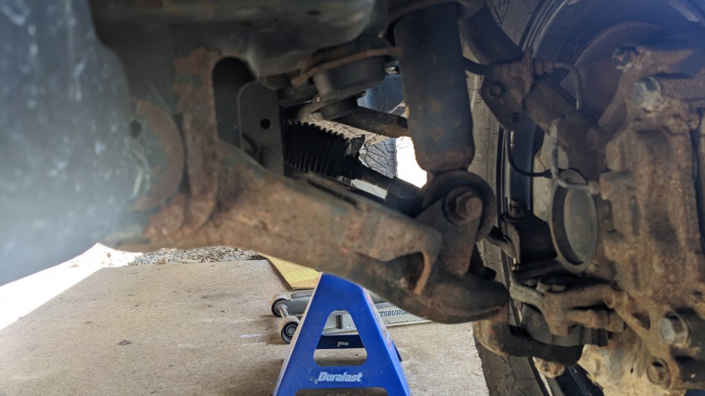

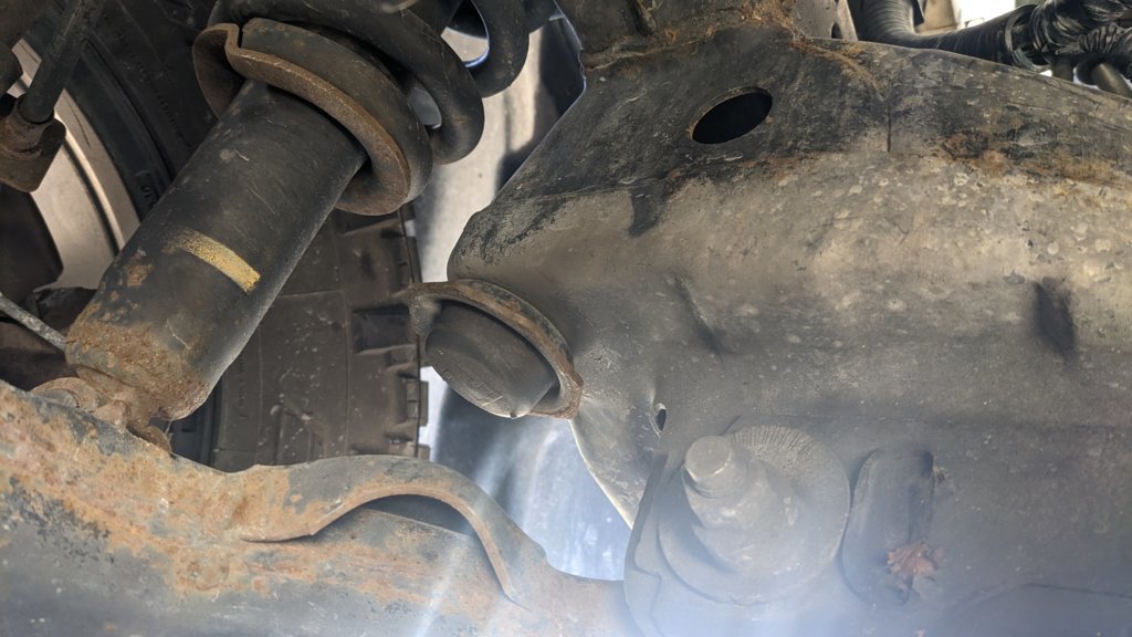

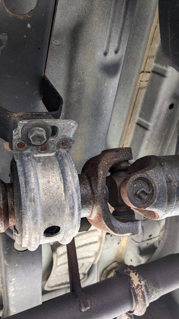

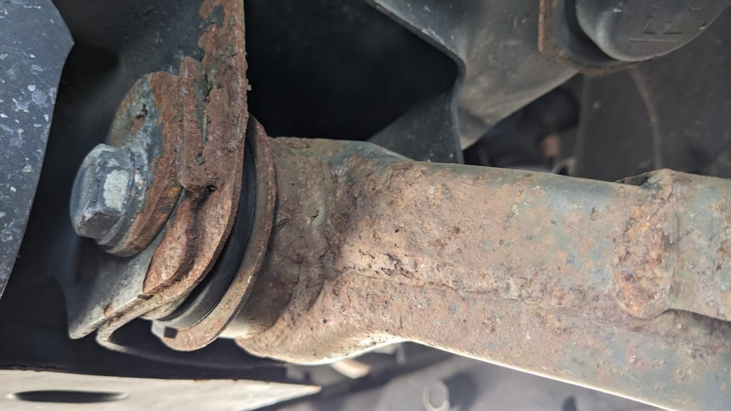

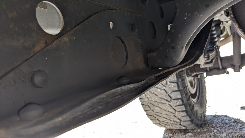

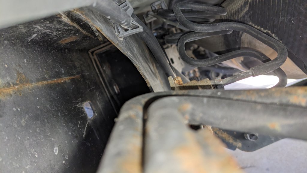

  12. Jan 24, 2025 at 1:45 PM
    #342
    CMPtundra
    CMPtundra Wandering Tundra Owner
    Jan 19, 2025
    #129118
    73
    Alabama
    05' 'New To Me' DC Limited

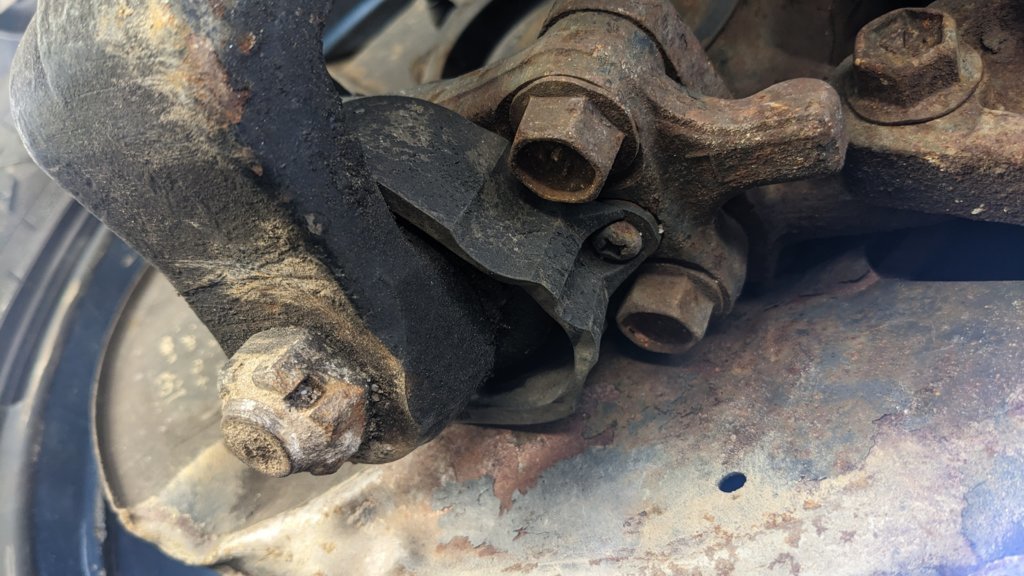

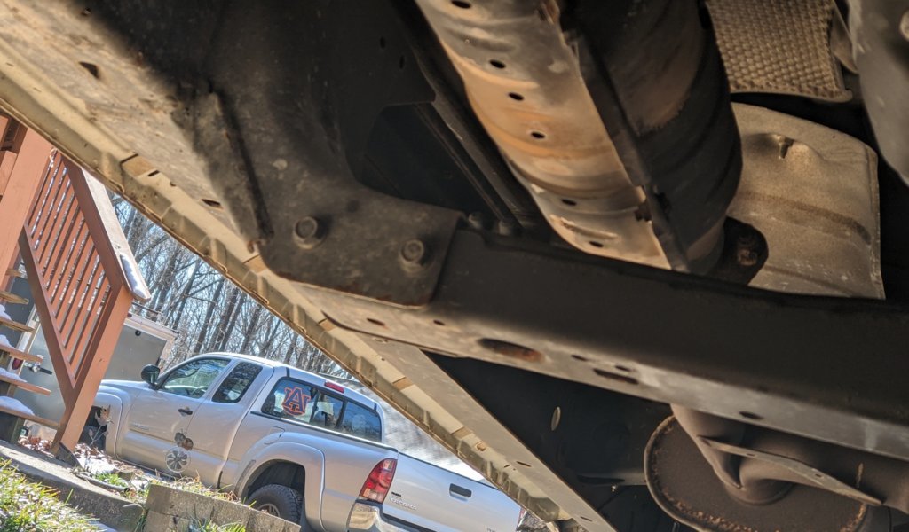

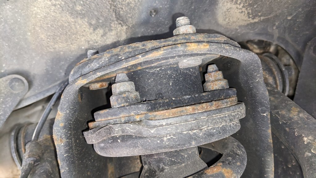

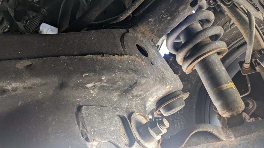

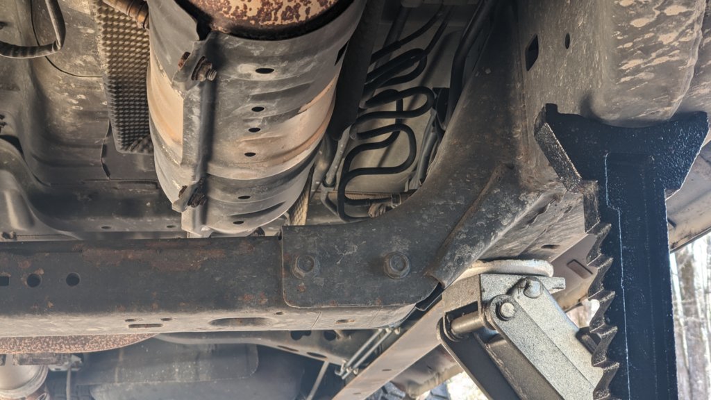

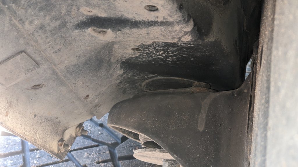

    all x-member bolts accounted for and no visible cracks on it. Honestly I think its the lower bushing of the strut or the tie rod end making the noise now after poking and prodding. And btw, that clunk noise is not at all consistent and rarely do I hear it, and I've only noticed it three times since I've had the truck for about 4 weeks now. The LBJs are solid and no movement so that job will get pushed to back burner for a 'warmer weather job'. I happened to take a look at my Tacoma's LBJs though at the same time because of a knocking noise its been making that I feel in the steering wheel.....that's a different story and is more urgent.
    I took several random pics, so feel free to take a look and comment. The rusty pics are all the areas of concern I know about already.
    The lower bushing on the strut is crushed. I'm familiar with this from my previous Tundra.
    I really don't like this setup with a spacer there and plan to change over to 5100 struts with the 6XX springs and matching shocks in the rear when I have the $$. Right now I'm focusing on the crucial items that need attention.
    both tie rod ends left a lot to be desired. pretty sloppy feeling imo.
    This is the worst area of the entire frame, passenger side about 8-12 inches in front of the front leaf spring mount.

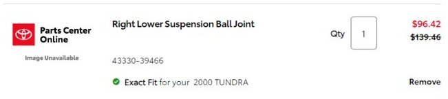

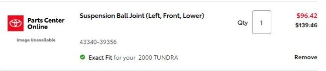

    Is it unusual that my 2000 has never had a recall for the Lower Ball Joint? I assumed all the First Gens had recalls on this? Is that not the case?
  14. Jan 31, 2025 at 1:04 PM
    #344
    Anima
    Anima New Member
    Jan 24, 2025
    #129323
    44
    2000 TRD Tundra V8 4x4
    Do the Lower Ball Joints from 2005-2006 trucks fit on 2000-2004?
    The post on page 8 says the part numbers are for 2005-2006. Mine is a 2000 and it the Toyota website says they wont fit on my 2000. Can anyone confirm they will fit?

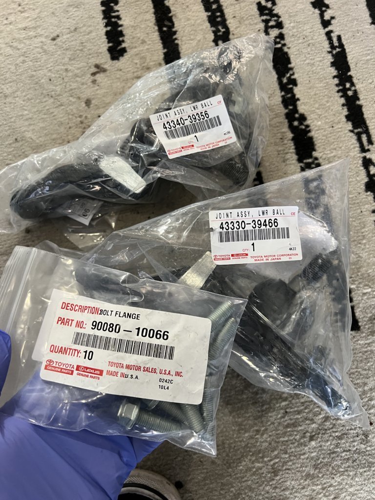

    Imma keep it stock
    This is what I installed and what you WILL NEED to install. Prices have changed I'm sure.

    Tonto cover
    No they won't, unless you switch out lower control arms, steering knuckles, lower control arms and LBJ bolts. LBJ bolts are spaced differently between the two LBJs/ steering knuckles, and the bolts are different sizes as well.

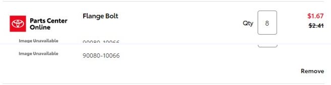

    I had already placed the order and then realized I made a mistake. I was freaking out! Thank you both for confirming.
    I found those part numbers @The Black Mamba but they wouldn't come up on the Toyota of Temecula Parts Website, so I went with the ones @Methodical posted. The guy at Temecula Toyota was nice enough to call and changed the order for me before he processed it. Thankfully.
    Hopefully the Google web finds these part numbers for the next guy.
    2000-2003 Tundra
    Lower Ball Joint (left): 43340-39356
    Lower Ball Joint (right): 43330-39466
    Flange Bolts: 90080-10066
