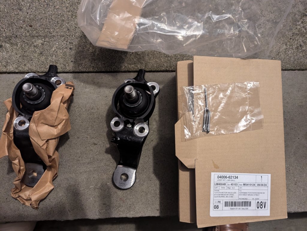

    My LBJ kit arrived today from Ourisman containing 2 LBJs and 4 cotter pins.
    Castle nuts were *not* included.
    I see nothing indicating country of origin.

    Does yours not have the sticker on the side indicating origin, same as Jerry? It'll be in the red text as I think I showed in a prior pic.

    I'm an idiot :crazy:
    Yes there is a Japan sticker on the box

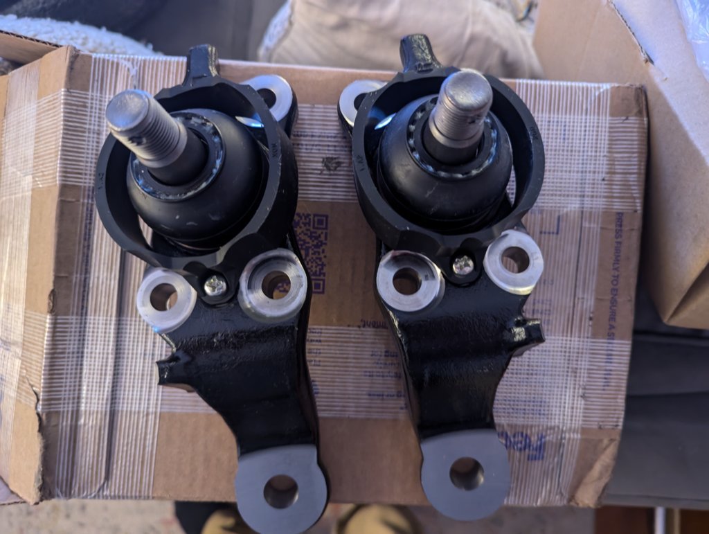

    Well Gentlemen, I did it. The job was easy; it only took me a few hours. I really got a look at the suspension. The only challenge I had was the rust on the tie rod end caused the nuts to be a challenge. I will change those very soon.
    Thank you all who helped me to better understand OEM parts, I will never shop at my dealership again. It took 2 weeks to get the damn bolts. They came in Wednesday before last and when I went in that Saturday, 2 had been poached for a "work order." I was so pissed as I missed a trip to Tahoe because of the delay. They kept referencing a "nation wide shortage on this part." After a week of no word, I had to call the manager they finally brought a couple in from a neighboring town.
    The FSM has a section on "Inspection" of the LBJs. I did that and determined they definitely were bad. The new ball joint set could not be turned by hand, the old could be turned freely.
