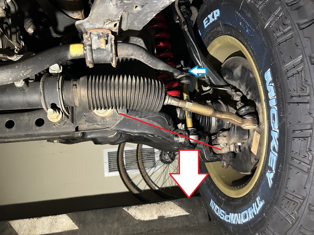

    1,018
    2003 Tundra AC V8 4x4
    Love the gold TREs...to match the wheels ... and the Maxlinks. Whose are these ... not OEM?
    Chrisfrom1986 likes this.

    '06 AC Limited V8/4WD
    From the factory. At least I know I haven't changed them, and the truck only has 77k.
    ToyotaDude[QUOTED] likes this.
