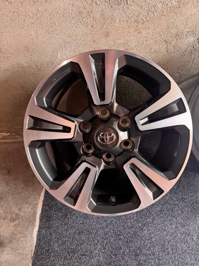

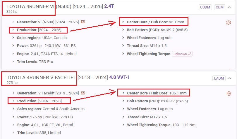

  6. Apr 19, 2025 at 7:51 PM
    #1146
    shifty`
    Jun 20, 2020
    #48239
    31,427
    ATL
    '06 AC Limited V8/4WD
    If they’re from after 2023 or 2024 (I forget) fairly sure they won’t work without adapters. They changed the center bore to like 95mm or something, ours are around 106mm on (all?) 6-lug wheels in one of those two years. More info in the megathread. I’m too lazy to look.
    matkes77 likes this.

  8. Apr 19, 2025 at 8:12 PM
    #1148
    shifty`
    Jun 20, 2020
    #48239
    31,427
    ATL
    Hub bore (hole in center) has to match. 105.9 - 106.1 mm should fit
    Lug count has to match. 6 lug
    BCD (the distance between the lugs) measurement has to match. 6 x 139.7mm or sometimes written 6 x 5.5”
    Aside from that, you just need to know the wheel width and offset (how far the mounting surface is from center of the inner/outer rims), to calculate the backspace (backspace calculators are online if you hate math).
    You can buy adapters to mount damn near anything on any car, but it’ll cost you dearly. However, as long as you know the four things above are a match, and the backspacing measure out to 4.25” - 5.0”, and the wheel isn’t wider than 9” - 10”, it should fit.
    HBTundra and Nicklovin[QUOTED] like this.

  10. Apr 20, 2025 at 6:30 AM
    #1150
    shifty`
    Jun 20, 2020
    #48239
    31,427
    ATL
    Again, I'd direct you over to the general source of most community knowledge, your one-stop-shop for common questions, the "megathread", it's there for a reason (note the last two bullets, but the rest is helpful too, I think):
    • Wheel fitment (backspacing/offset info) ... backspacing/offset plays a HUGE role in whether or not you'll rub with larger-than-OEM tires. If you need help understanding what ballpark to play in, this is a good thread to read. Gist: Best fit to put you near the fender edge w/o rub on 8½" wide wheel is ~4¾" backspace, 9" wheel aim for ~4.5" backspace. Popular Tundra OEM 7½" wheels had 5" backspace, some Tacoma OEM are not ideal at 5.5" backspace. With leveling, oversize 275/70r17 tires on 17x8.5" wheels @ 0 offset (i.e. 4.75" backspace) should only have minor rub.
    • Wheel fitment (caliper rub): If your truck has larger 13WL calipers, beware of caliper rub on 16" wheels! 13WL is std on 2003+
    • Wheel fitment (from other Tundras): 2007-2022 Tundras use 5-lug wheels. In 2023, Tundras started using 6-lug axles again, but the hub bore is smaller (95mm on 3rd gen vs. 106mm on 1st gen), so they technically won't work unless you spend a couple hundo on custom-made spacers.
    • Some other tire size considerations see HERE and more over HERE.
    • Wheel fitment (from other Toyota models): Anything from PRE-2024 Tacomas, 4Runners, Land Cruiser, LX470 and GX models that are 6-lug will typically fit. Someone here is probably running it already, and pics of it are in the OEM wheels thread. Make sure the hub bore is 106.1mm on the donor wheels else you need hubcentric adapters.
    Nicklovin[QUOTED] likes this.

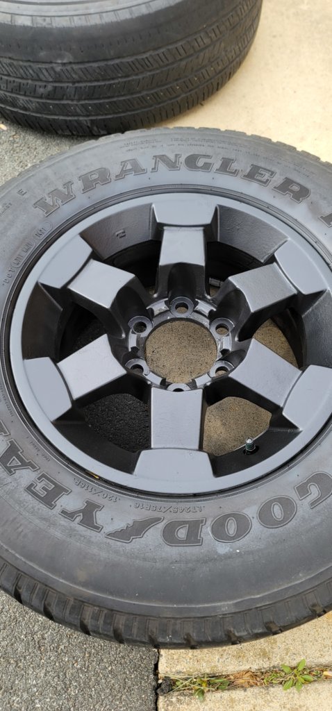

    2002 SR5 AC 4.7 V8 4WD
    Couldn't get the old plastidip (or perhaps not, and whatever the hell is on there ) off. So I ended up just plastidipin over it. Used 4 cans and 6 coats. Not perfect by any means, but good enough for me and still a significant upgrade to what I have on now until I decide to get newer/better wheels. All in so far (wheels=$150), 4 cans= $35) for under $200--I'll take it. Will need to inquire local tire shops about swapping theses on.

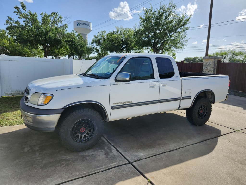

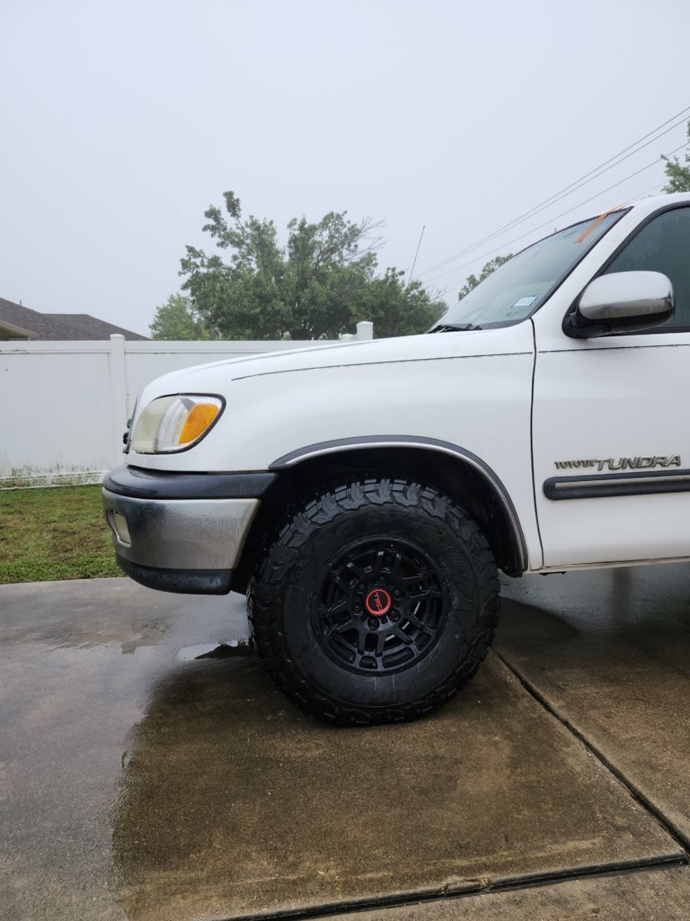

  16. May 6, 2025 at 11:54 AM
    #1156
    matkes77
    matkes77 New Member
    Apr 30, 2025
    #134257
    95
    2002 4.7L AC 4x4
    2023 Tacoma TRD wheels bolt on directly to my 2002 4x4, but other years might work with Wheel spacers/conversions from Spidertrax for example. Be careful though, depending on the wheels it maybe be hard to find correct lug nuts if your lug studs are not same size as the vehicle that the wheels came from.
    These are BFG KO3s 265/75/R16

  19. May 7, 2025 at 4:01 AM
    #1159
    NickB_01TRD
    Jun 16, 2021
    #64346
    2,768
    Nick
    KY
    01 Tundra V8 4X4 AC SR5 TRD
    I need some details here. Which generation Tacoma did these come from, was it the newest gen or the gen before? This is the EXACT setup I'm trying to run, wheel, tire, tire size, everything, exactly what I'd like to piece together.
    matkes77[QUOTED] likes this.
  20. May 7, 2025 at 5:45 AM
    #1160
    matkes77
    matkes77 New Member
    Apr 30, 2025
    #134257
    95
    2002 4.7L AC 4x4
    These TRD wheels came off a 2023 Tacoma. They are a direct bolt on, so no spacers are needed unless you want a wider stance. Newer Tacomas had different hub size and would need an adapter/spacer.
    G_unit3000 and 455h0le_dachshund like this.
  21. May 7, 2025 at 7:29 AM
    #1161
    NickB_01TRD
    Jun 16, 2021
    #64346
    2,768
    Nick
    KY
    Got ya. I see your other posts about the wheels now too. Guess you must have gotten on marketplace and saw those at just the right time. I'm on the lookout for some. Guess I'll just have to commit to spending a pretty penny if I see some come available.
  22. May 7, 2025 at 7:33 AM
    #1162
    matkes77
    matkes77 New Member
    Apr 30, 2025
    #134257
    95
    2002 4.7L AC 4x4
    Yeah I got lucky. Guy was upgrading his wheels and tires so I got them together for a decent price. You can find these same Wheels as knockoffs on eBay for around $800 for four of them. Some of them offer two different styles center caps but you obviously want to verify the center hub opening dimensions
    NickB_01TRD[QUOTED] likes this.
