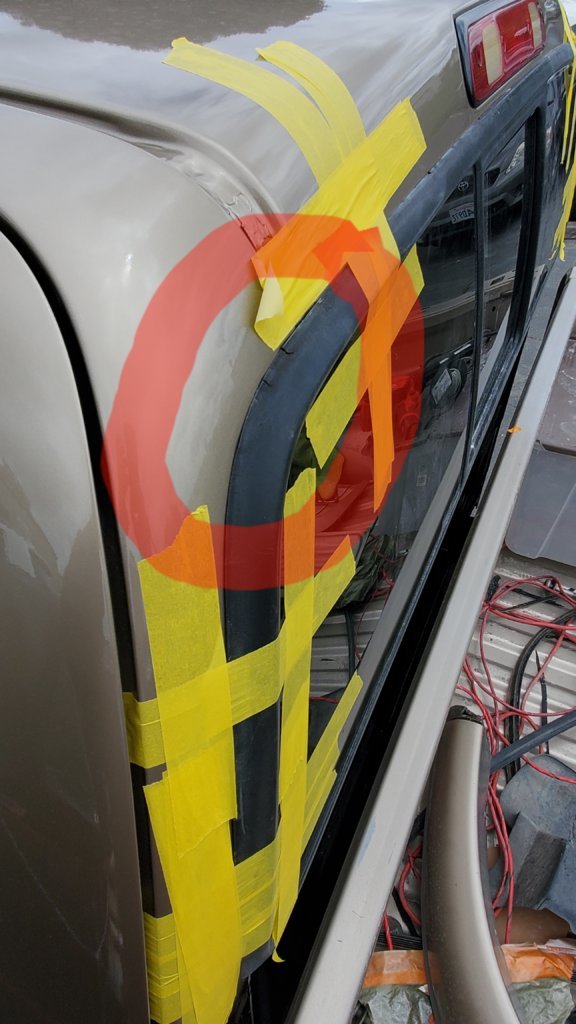

    Big concern now is backglass- 18yr old truck: good chance glass frame may survive R&R, but the 4 install bolts might disintegrate.
    Any chance those bolts survive on 18yr old [dry central vly] truck?
    Im gonna try to source a JY back glass/frame ahead of time...lookd up via Toyota parts: w/slider $600, non-slider is $400 [dont mind giving up slider].

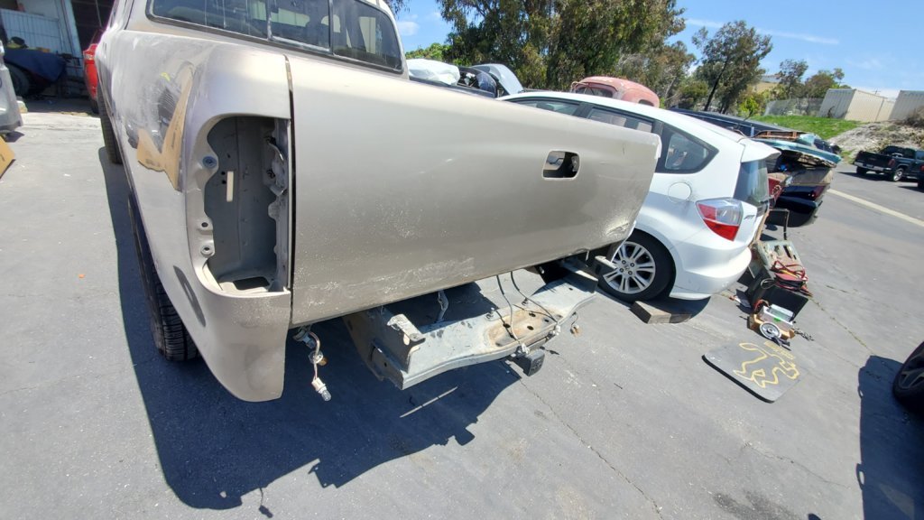

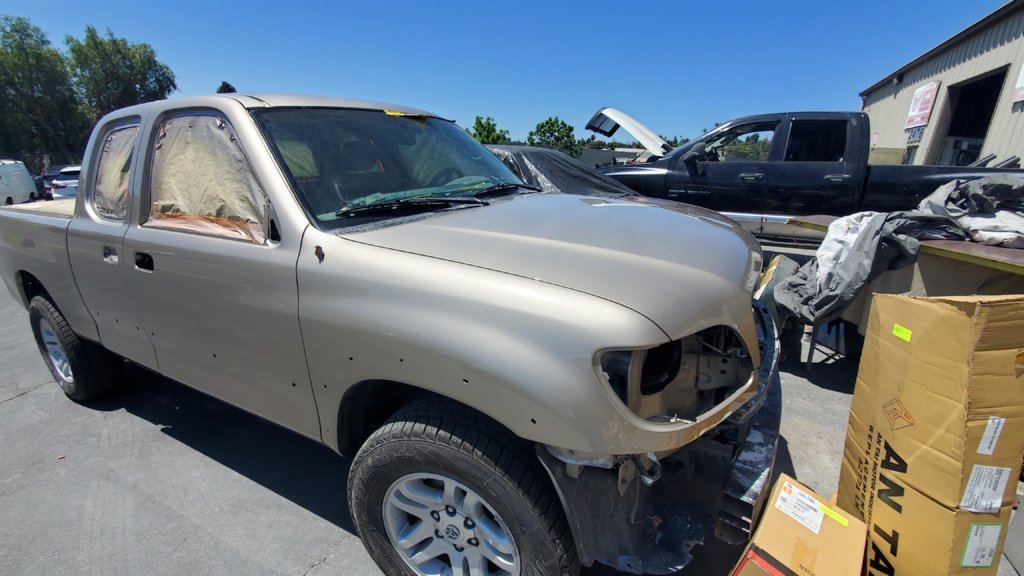

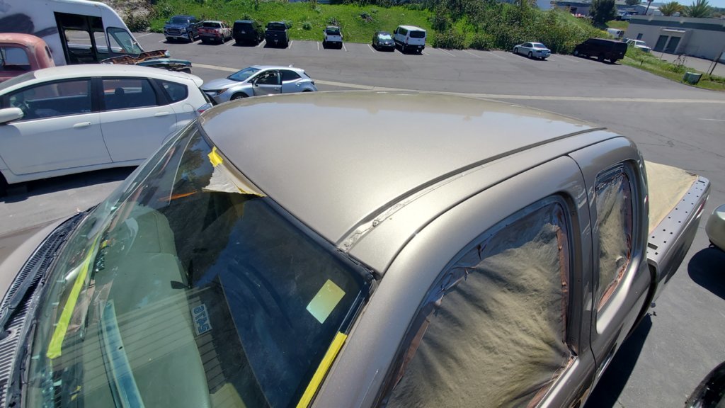

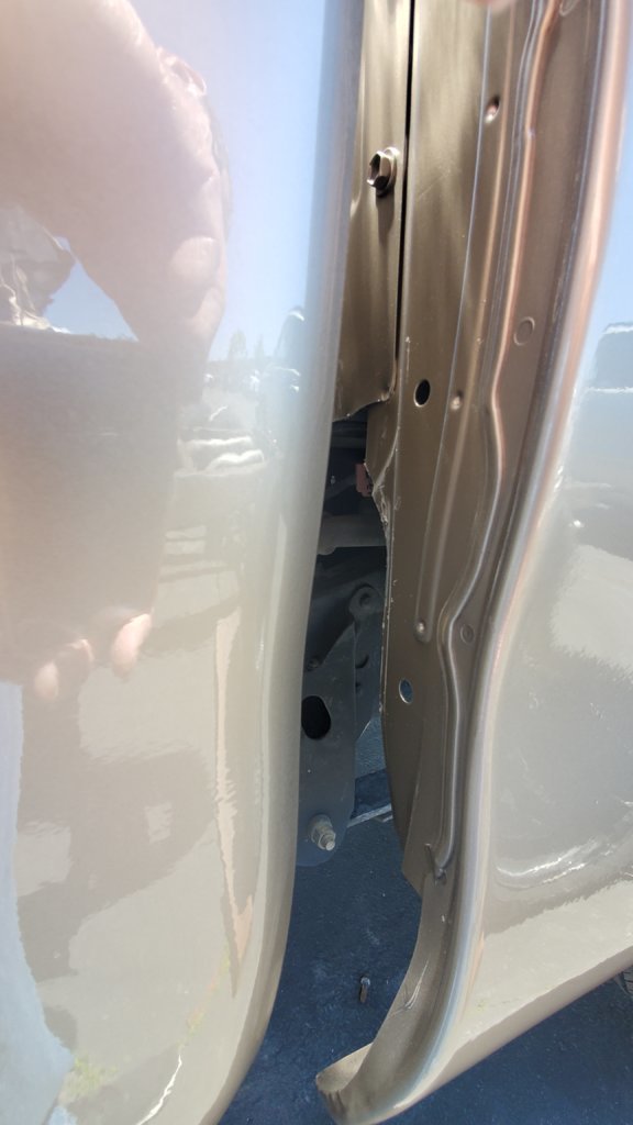

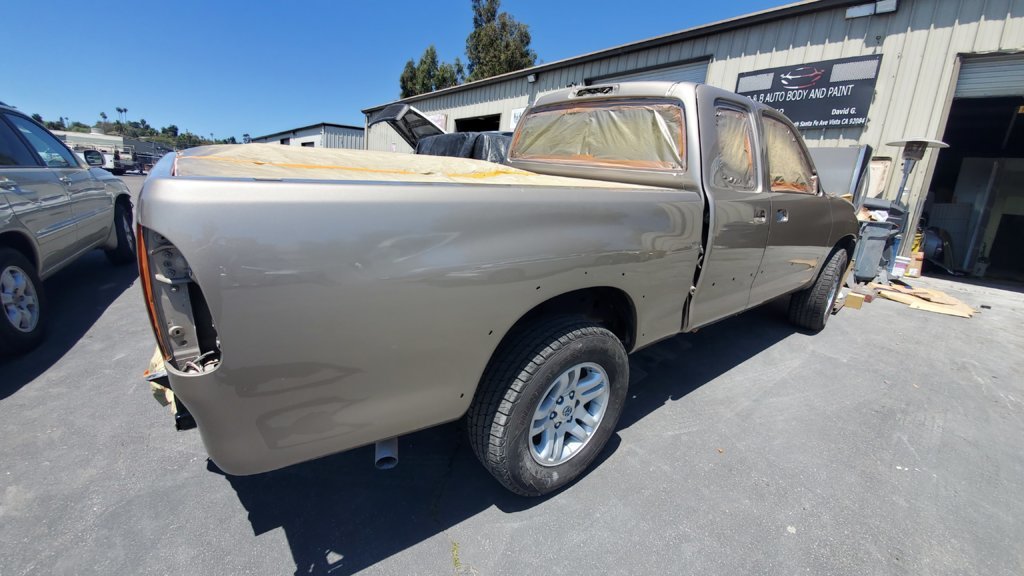

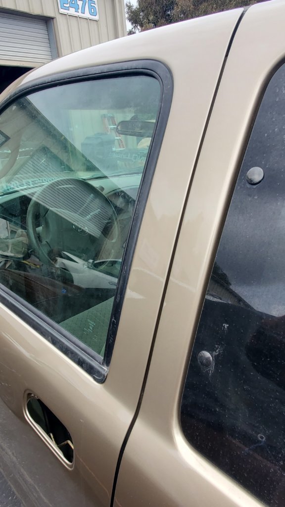

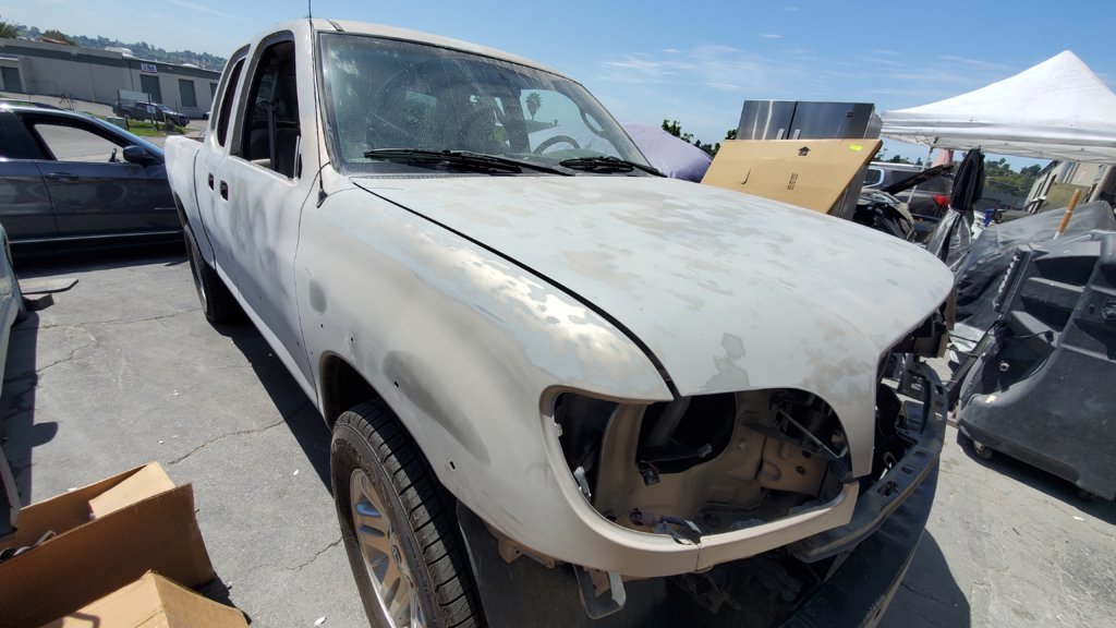

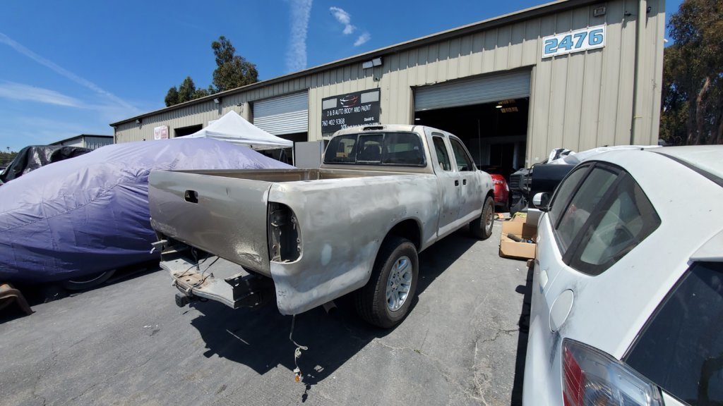

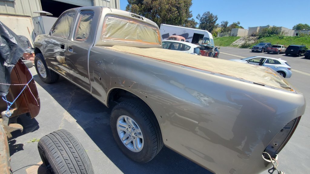

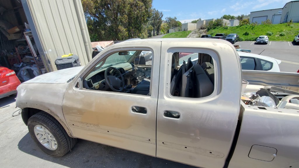

    ...continuing the topic, I delivered my FGT last weekend to the B&P shop. Went to see progress today and below is the dis-assembly to date.

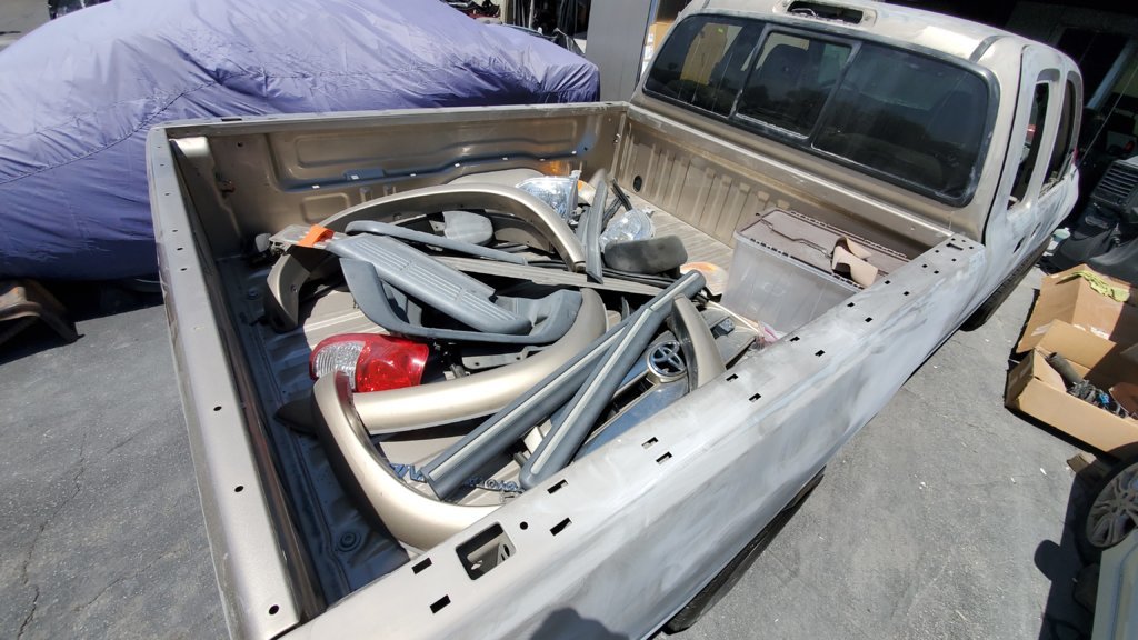

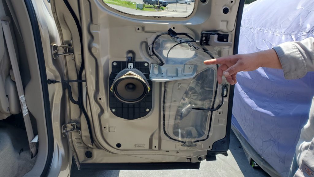

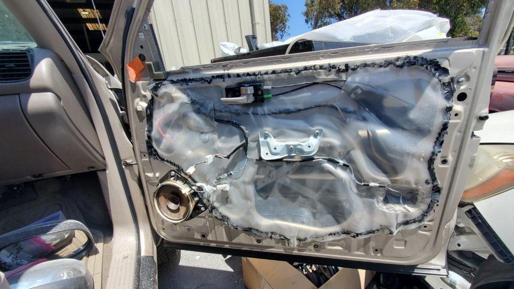

    BTW: Im thinking of speaker upgrade while door panels are off; shop owner says theyre 5"...i didnt measure, but they looked like std. toyota 6" to me. So, any advice or recommendation of brand, model, etc would be appreciated. Eventually, I'm aiming to install the Alpine ilx507 w/out amp or sub for starters, or maybe I'll be good with just that...?
    Altho its really beside the point, the OEMs are in very good shape, which explains why they sound so solid, but not great by todays standards. Didnt think to check the tweets in the panels, but I'll replace all before it all gets reassembled.
    Aside from all that, everything 'seemed' tore down without any breakage [or at least not any I saw]. Thinking to go back Mon and load my parts and bring home until its time for reassembly; this way I can reinstall new tweets, then showup with the other 4 new speaks when its time.
    So, out of all so far, the only big question is the BackGlass; it hasnt been attempted yet. Bed will come off once all spot dings are done and whole truck is ready for prime, color and clears.

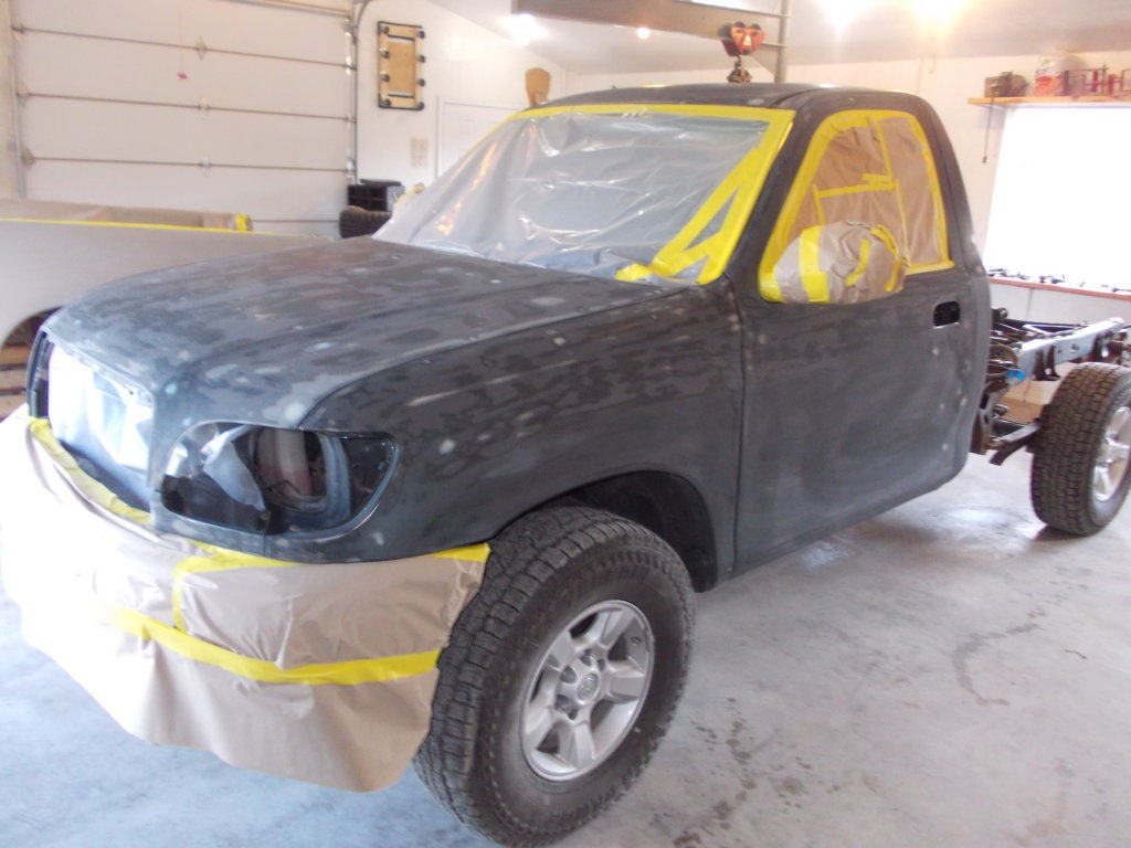

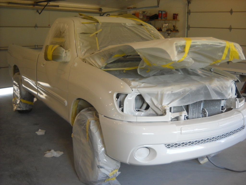

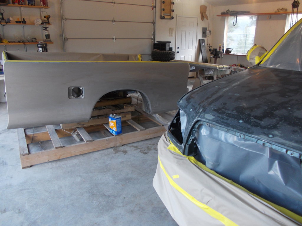

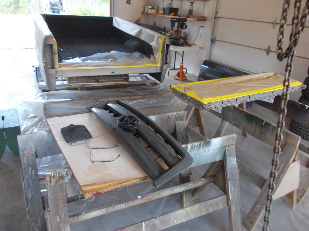

    I repainted both of my RCLB's with single stage urethane in factory colors Natural White and Dark Green Mica. The green one had hail damage and the bed had 5 collisions so I replaced it with a $880 junkyard bed.
    I didn't remove the windows or mirrors, just debadged (and left them debadged) removed antenna, lights, rear bumper and roof strips.
    Non metallic paint like the White truck require the least skill. I painted roof, hood, tailgate and misc pieces one day, then remasked and did the rest another day.
    On the plastic front bumper, if painting a light color you need to mask the lower grille, which is a pain. I didn't on the white one because I plan to install a chrome bumper someday. Masking the grille black on light colored trucks requires considerable manual dexterity. I skipped that on the green one and it's not noticeable.

    I installed 6-1/2 coaxial in the rear, and I think it maybe was possible to go 6-3/4, or 7” with minor modifications. I really need to get a pair of the rear housings, I’d like to model up some 6x9 housings to 3D print.

    @Dook55: nice work...like youre ready to open B&P shop. Yes, minimum disaasembly woulda been ok by me, but B&P shops not only want to do the work, but might be merit to idea of minimizing paint peel or flaking along weather exposed edges. Reality of 5 different shops, only one was willing to do job w/out bed removal [and he was only $100 less than my guy], but all were going to do the same dis-assembly otherwise.
    BTW: Id have taken a Sgl Stg paint FGT, but you get whats available in used market. I think someone here mentioned the lack of a C-coat on Sgl Stg paints makes them a bit more vulnerable to effects of moisture, etc. IDK. OTOH, my CCoat was probly dried up in 1st 5 years of its life; dont really know. Even tho i use truck as a boat-puller/utility rig, im trying to keep as rust-free as possible since it lives in the dr/way about a mile fr/ocean...for sure I'll have at least a cheap polyester cover on it eventually.
    @Shifty: maybe Ive mis-read in past here, but I thot these FGTs came stock w/6x9s in frt?
    Also, with a coaxial, are you just getting wider sound spectrum from a sgl speaker, vs a non coaxial? IE: just b/c coaxial doesnt mean your HU or DSP allows discreet sound adjustment of the multiple elements of rear coaxials, right?

    No 6x9 for us with AC.
    coaxial is simply two-speaker so you’re getting a mid with a tweeter, so better range. And it’s crossed-over directly on the speaker using capacitors.
    in the rear doors where you can only install one speaker, if you want full range sound you need to go coaxial or triaxial. Up front, it’s better to go with components IMHO, for the AC/RC trucks at least.

    My green truck was base clear from the factory but the white one came single stage from the factory. I had peeling clearcoat on the green truck so I just deep sanded a couple inches into good clearcoat and then epoxy primed the whole truck. 3 years and no peeling.
    I put enough coats on both trucks so that I can buff them out if they fade before I take my dirt nap.

    I was thinking if I had a desert sand tundra like yours I would repaint it with a single stage non metallic about the same color, maybe that Tacoma beige babyshit brown. The existing door jambs would match sorta and it would the quick and easy paint job. The thing about non metallic paints if you get a run it's no big deal, just cut and buff. That doesn't work on metallic paint.
    Removing the bed is not needed unless there is a color change. Just adjust the gun to the round pattern and carefully and lightly paint that gap and let it dry 20 minutes before shooting the rest. Be sure to re-adjust gun afterwards.
    The green truck was the first paint job I did in about 45 years and I got some runs and decided to live with them because the truck had 250K miles on it. The White truck I did last year and the activator and reducer were just right for the ambient temperature and the only run I got was covered up by the grille, which was painted separate. I did get a little bit of orange peel on both paint jobs but not bad enough to bother me. I'm just an amateur.

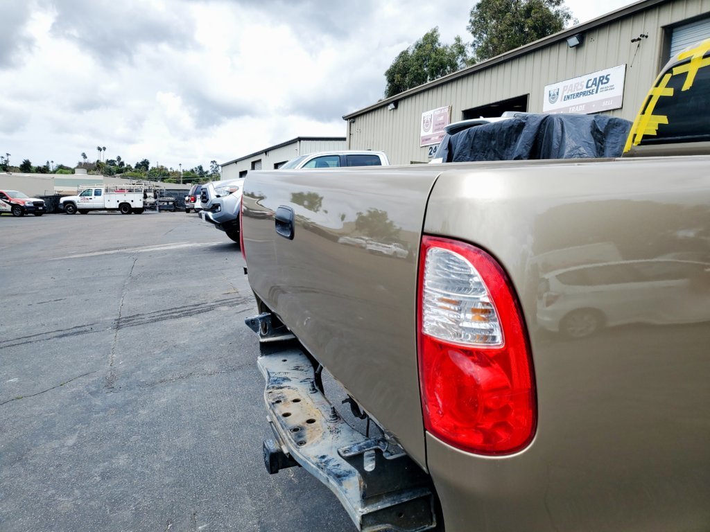

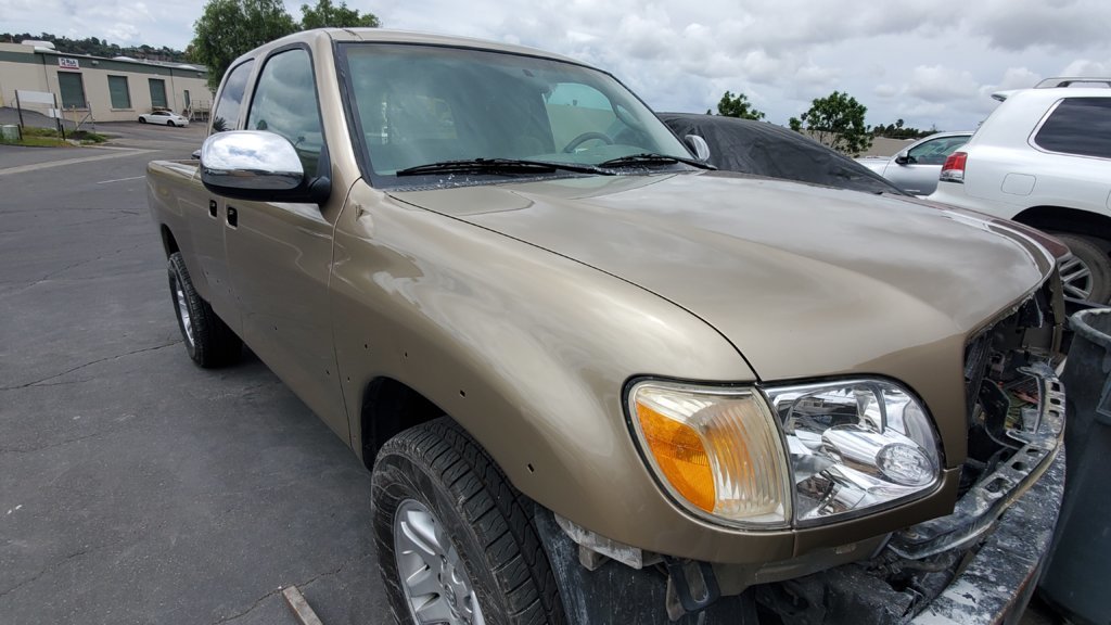

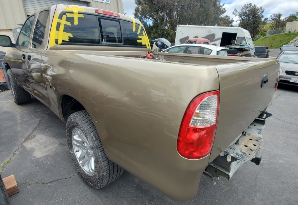

    UPDATE:
    20 days after drop off.
    Almost there.
    another 7-10 days to completion.
    thats all for now...

    Update: 4 weeks later, not quite there yet...but a few more pics anyway
    Some basics re-installed:
    Worst of weather seal condition...decided to re-cycle it...
