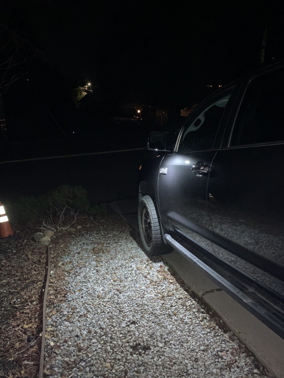

    Just did my Bright Trax as well. Love the difference.
    Not bad! I like it.
