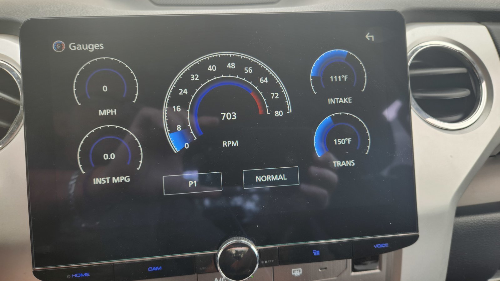

    Did you try what I mentioned in my other post?

    About shifting between P1 & P2?
    If so, yes... Any of the spots where I do see it listed it's grayed out.

    What did you wind up doing to get it to display?
  5. Jun 11, 2024 at 1:12 PM
    #35
    SD Surfer
    SD Surfer [OP] Globe Trotting Bon Vivant
    Oct 13, 2022
    #84846
    2,064
    Bruce
    So Cal
    2019 SSM CM SR5 TRD OR 4X4 5.7
    I can't really take credit for that.
    @centex worked with the guys at Maestro (Super nice and helpful gentlemen)
    He sent them the appropriate PID's from his Scangauge which they coded into a new Beta version of the firmware and pushed out individually to his Maestro account, and then subsequently to mine.
    Because I got the RR2 I was able to reflash via Bluetooth (RR would need to pull the unit and flash with PC)
    Then "Validate PID's" and Voila!
    The guys at Maestro said they'd do some testing on the Beta version and then it'd go live in the firmware.
