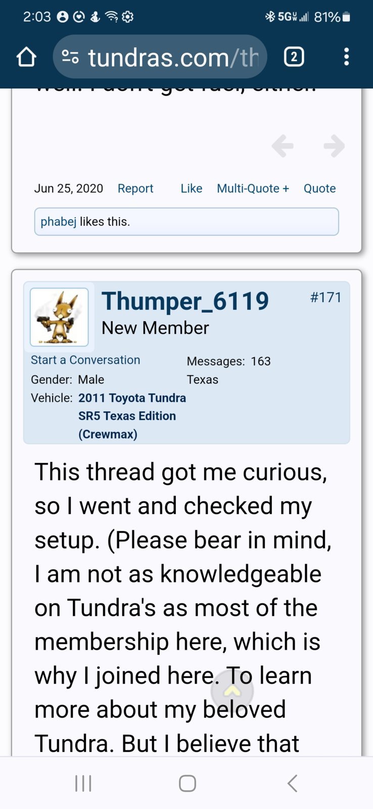

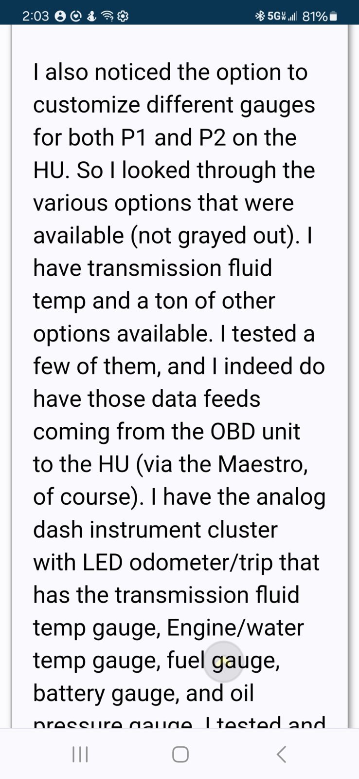

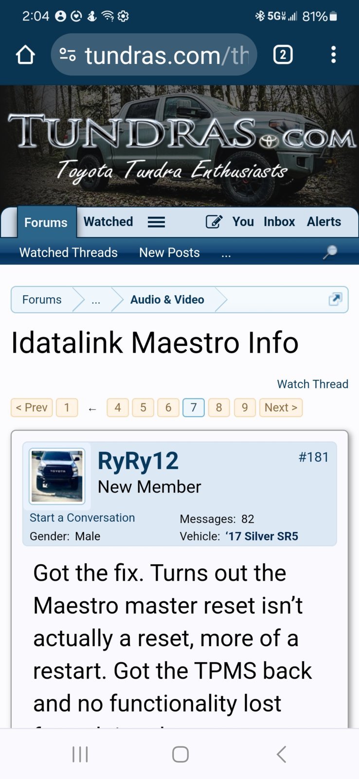

    So I found a couple of posts in the "iDatalink Maestro" thread that are encouraging.
    Fingers crossed.

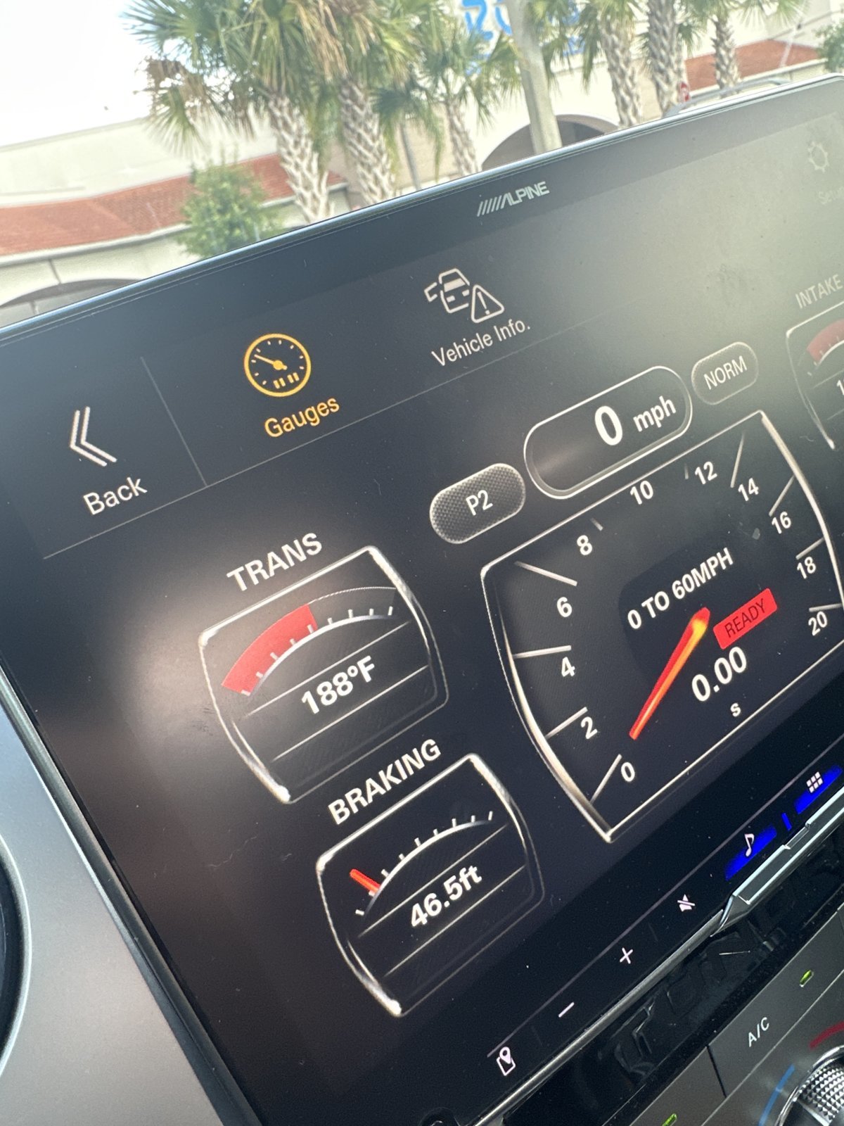

    got trans temp screwing with the Mastero on the alpine.
    bulldog93, SD Surfer[OP] and 1lowlife like this.

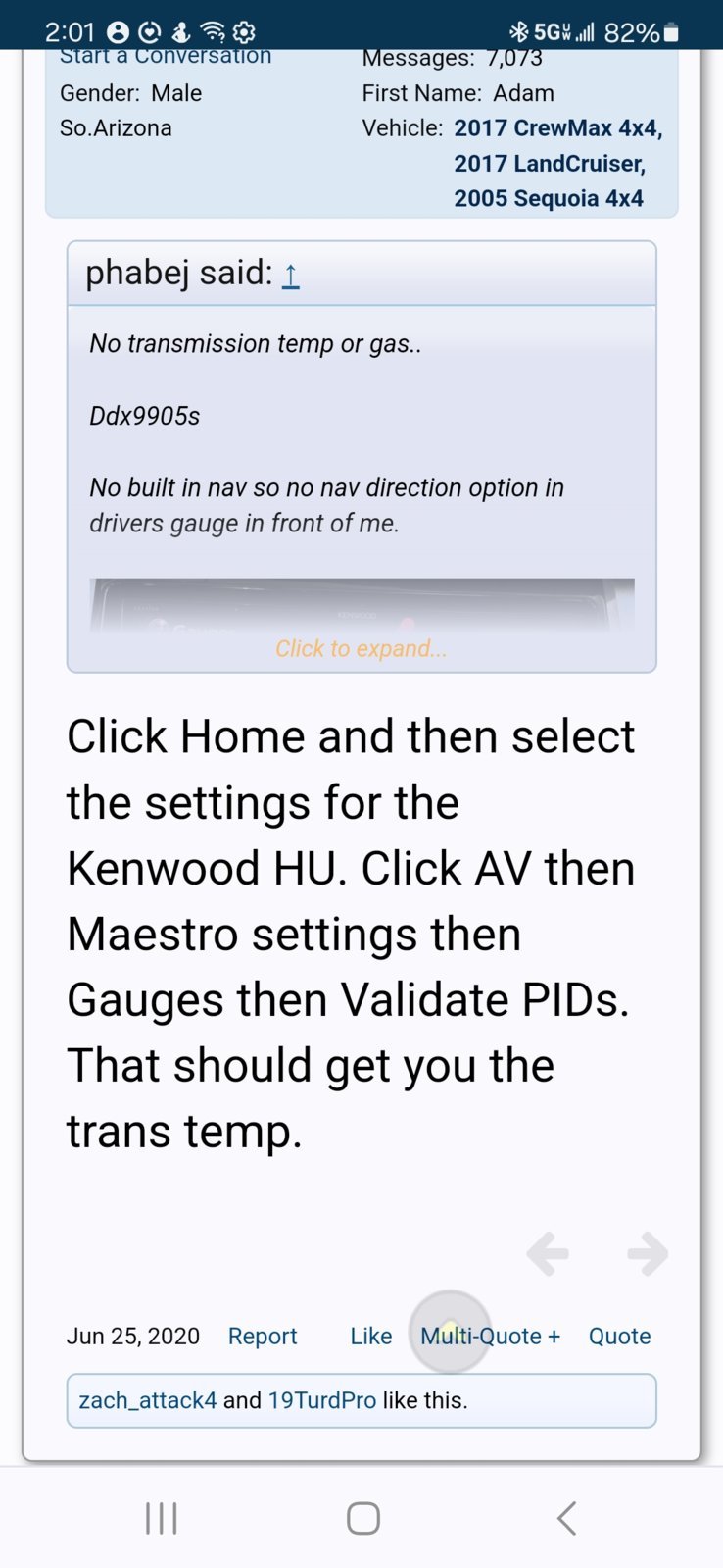

    Validating PIDs did it.
    I learned something today..:thumbsup:

    [​IMG] [​IMG] upload_2024-5-5_15-9-56.jpg [​IMG]
    Well done! This pleases me greatly since that was one of the selling points that made me want to spend the money, not to mention one of the ways I justified it to my wif... errr, I mean the CFO.
    So it reads the Toyota PID's on it's own, you just have to tell it to validate them, correct?
    I know on some of the other OBD readers you have to input the PID's

    I don't know.
    I just know trans temp wasn't there until I did your PID validation.
    Then it and a few more options popped up.
    I doubt the validation was ever done since I installed it years ago.

    After you validate PIDs, try shifting between P1 and P2. There's a difference in gauge types between the 2. If you see it and it's one of the smaller gauges, you can put your finger on it and hold it down for a couple seconds. That usually shifts it to the main gauge (center). This is how I do it on my Pioneer (similar interface).

    Try validating PIDs again.
    *Settings
    *OEM Settings
    *Maestro Settings
    *Validate PIDs
    (Or something like that)
    Sometimes my TPMS will come up with one tire zero'd out but will then pick it up again.

    I feel like it shouldn't make a difference, but I still don't get trrans temp so so I'm trying to figure out why you guys have it and I don't. I got the RR2

    So you don't see it as an option for ANY of the gauge positions?

    Nope, I see it listed for certain positions, but it's grayed out.
    Yep, that's what I'll need to do. I was hoping it might just take some time, someone said theirs took like 24 hours after validating PIDs, but it's 2 days now and no joy.
