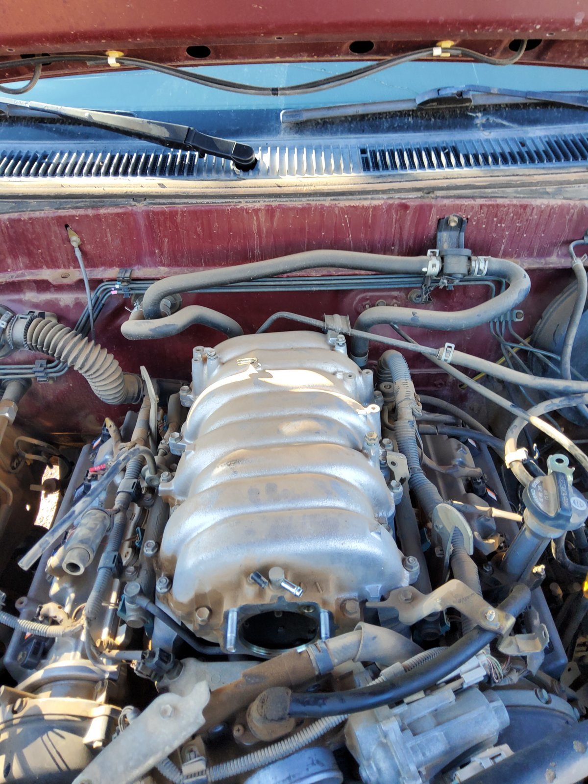

    My grandpa took off the cover that goes over this, the 4.7L V8 ‘plaque’ nearly a decade and a half ago, and one of the connecting ends for it. Could anybody show me where the piece for it to latch back onto is at? Just need a general idea because i have no clue and i’m having no luck with searching. IMG_0388.jpg
  8. May 16, 2024 at 6:24 PM
    #38
    BroHon
    Sep 19, 2023
    #104169
    2,682
    Bro
    Location: Bitch Mitten
    2000 SR5 AC 4x4 4.7
    Best I got

    And to your pic I'd add: You specifically need a pic from an '00-'04, because the '05+ VVTi engines with the black intake have the brackets in diff't places apparently.

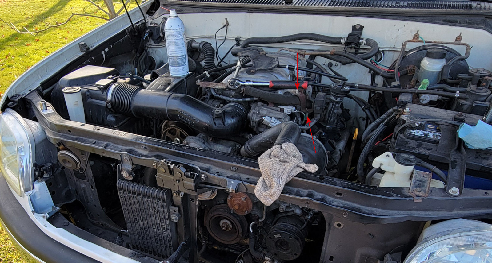

  15. May 21, 2024 at 7:41 AM
    #45
    bmf4069
    Sep 1, 2018
    #18880
    9,728
    Beau
    TX
    02 AC sr5 4wd v8
  16. May 21, 2024 at 11:19 AM
    #46
    TøphNDen2
    TøphNDen2 [OP] New Member
    May 15, 2024
    #116904
    37
    2002 Toyota Tundra SR5 Access Cab V8 2UZ-FE 2wd Stellar Blue Pearl
    Thank you!

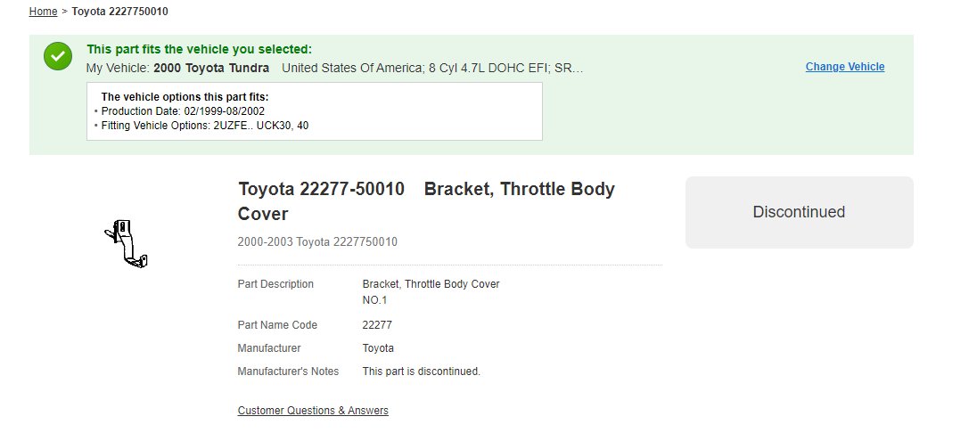

  17. May 21, 2024 at 12:14 PM
    #47
    TET1
    TET1 New Member
    Apr 10, 2024
    #115130
    54
    2000 Tundra AC V8 4WD

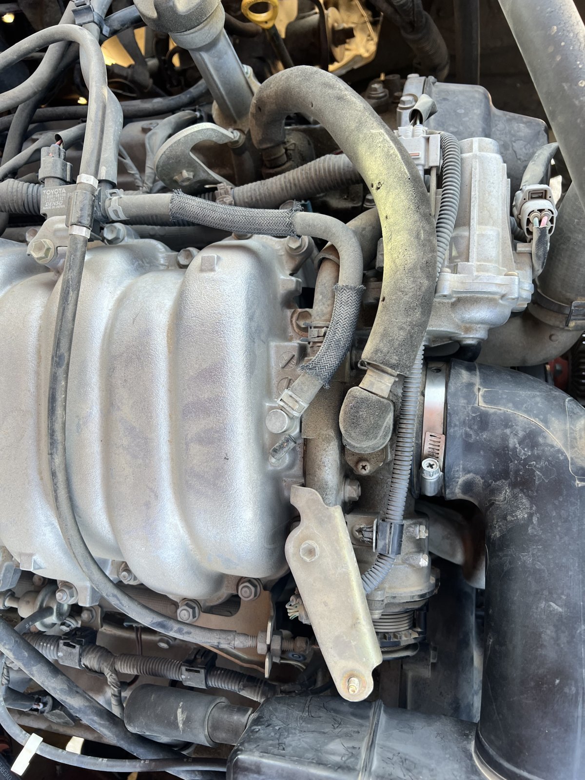

    You'll likely need to go to a junkyard to get that bracket. I'm pretty sure it's discontinued. I just replaced that exact bracket with one from the pick-n-pull since the bolt on mine broke:

    I have the bracket, it was just taken off and never put back on.
    TET1[QUOTED] and BroHon like this.

    I noticed here that the hose clamp hole is in the wrong spot. There is a little "pin" that the hole should go in. Probably not causing any issues at all, but it's the little things you'll start noticing.
