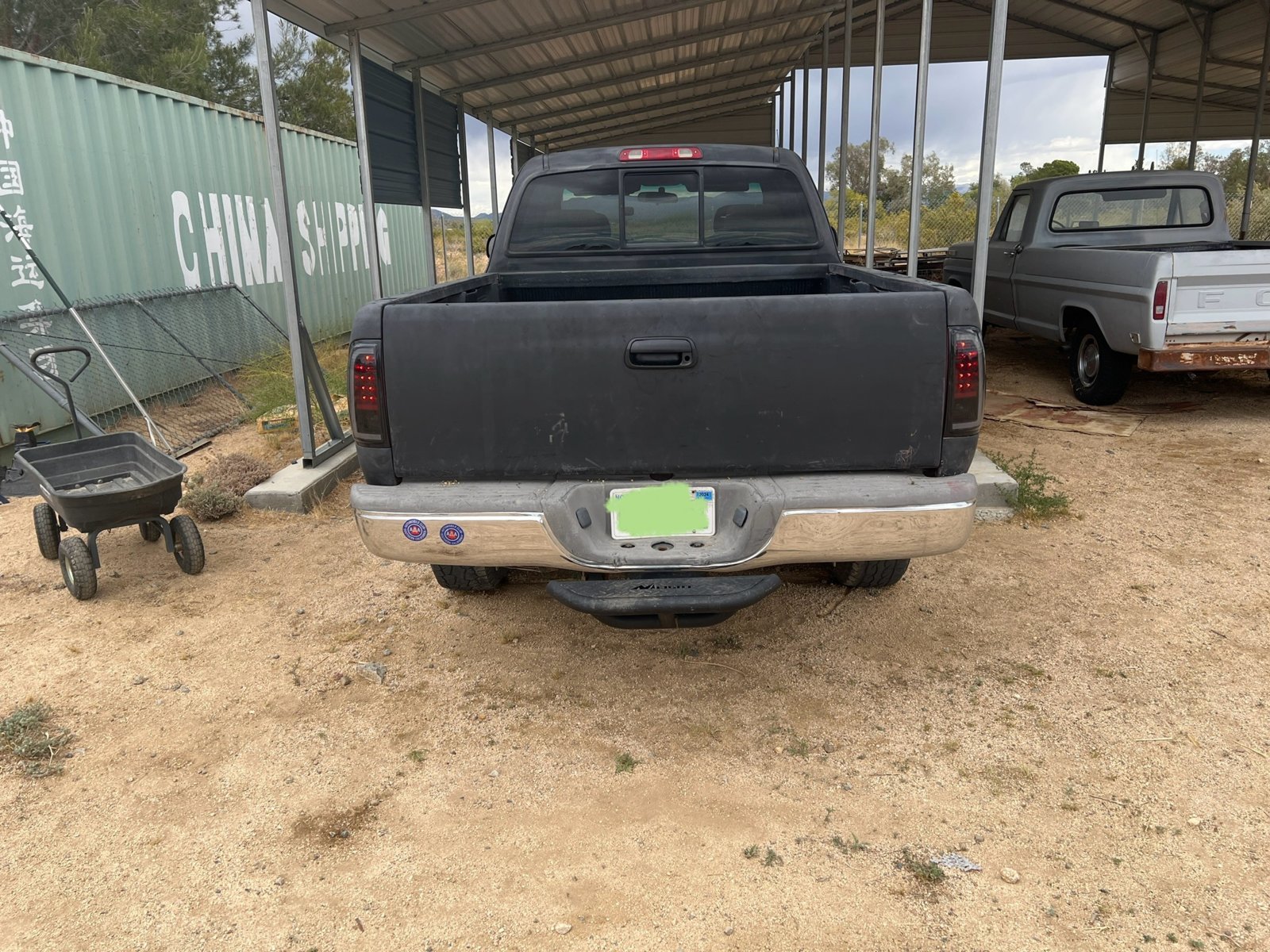

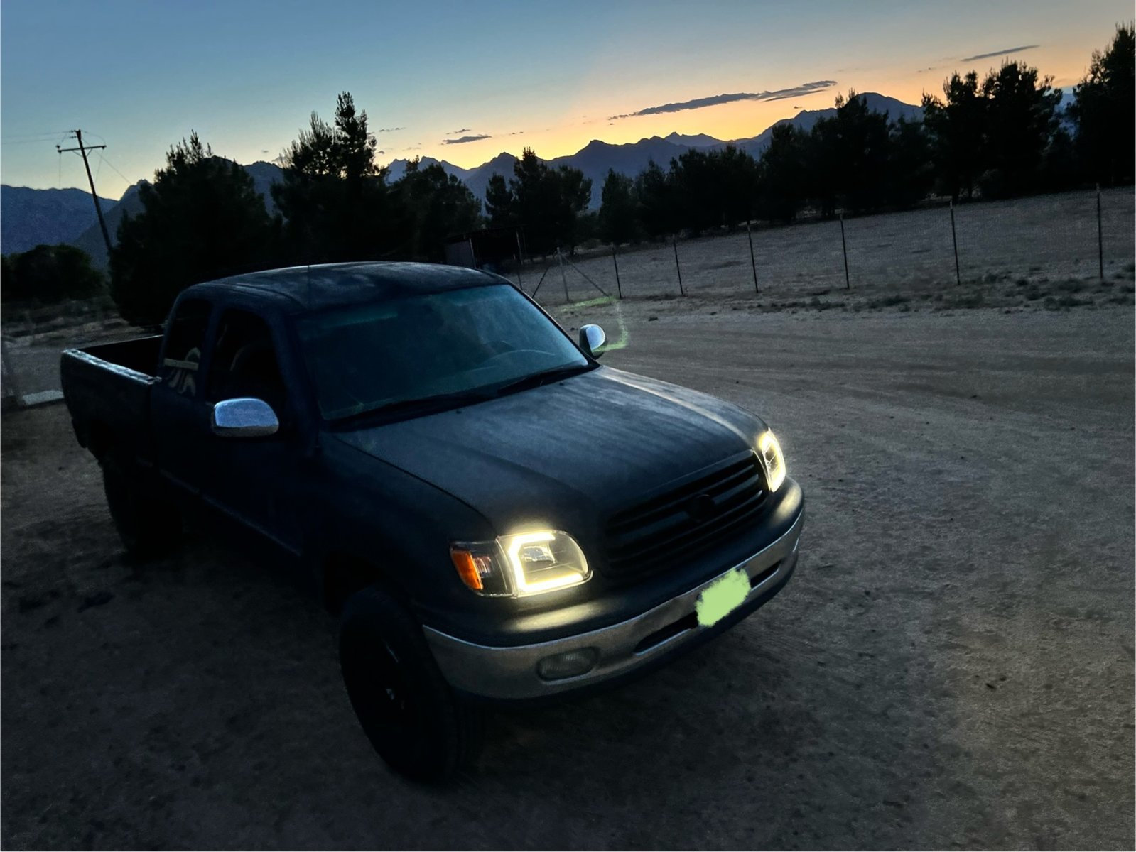

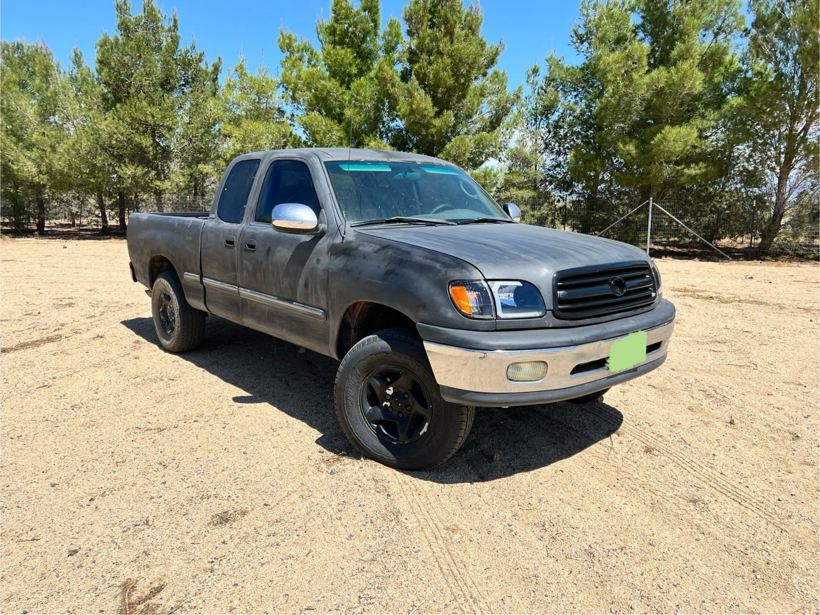

    some of the good pictures i have. Pardon the primer, i plan on paint soon. Looks so much better than how i got it. Sunfire Red turned to orange and peeled horrifically.
