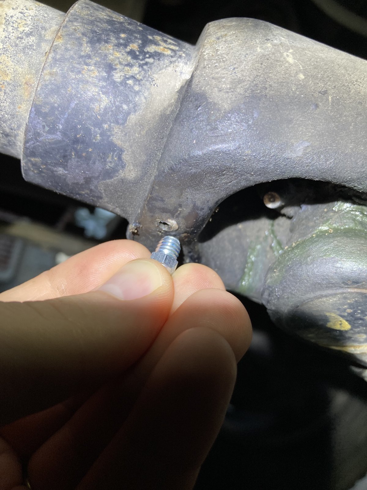

    So I had a weird issue like this the first time I greased my driveline. There was a weird nondescript hole where the zerk should have been. I ended up buying some zerks and tapping a hole and installing my own. Seemed a little scary when I did it but it worked for me. No clunks anymore! Pic 1 is from before it tapped it and installed the zerk. Pic 2 is after. That metal is pretty soft so if you decide to tap it be aware of that.IMG_0947.jpg

    Sorry I just realized you probably have a different problem than I did. Ignore my post above....
