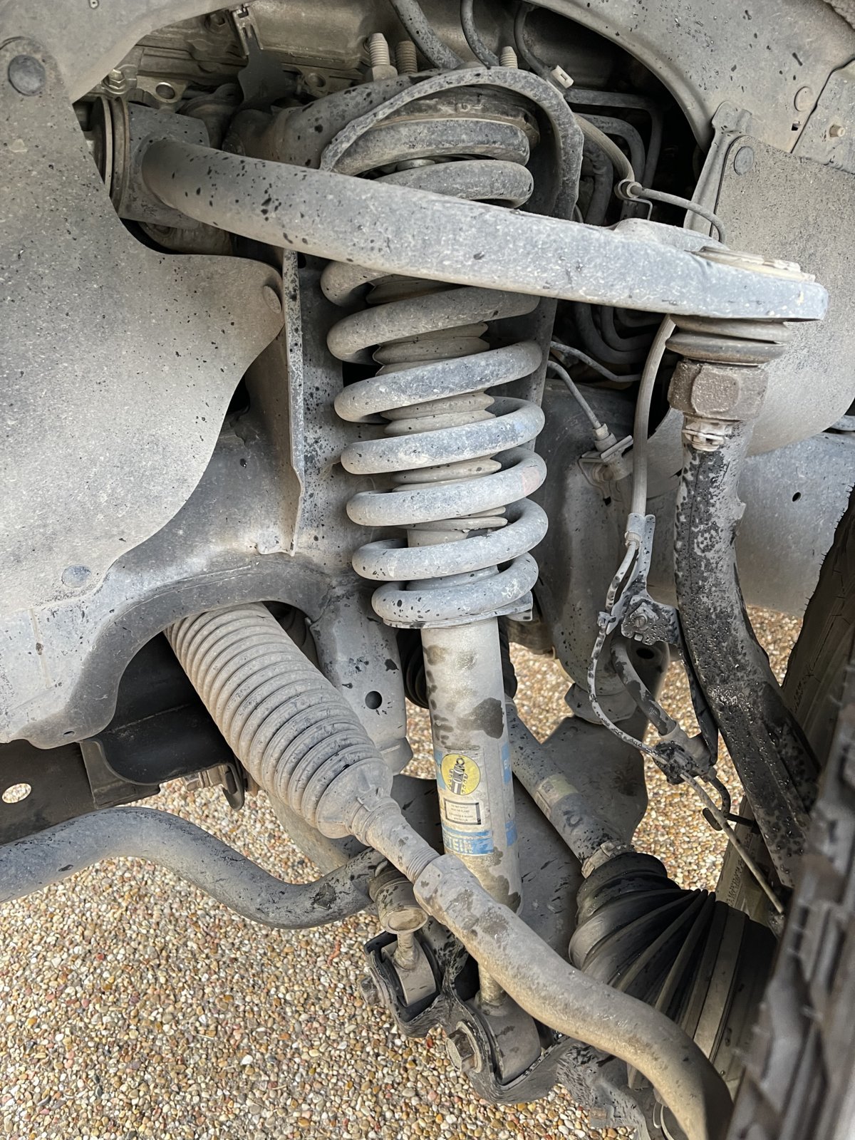

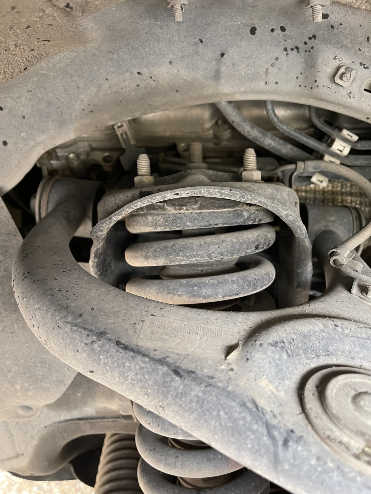

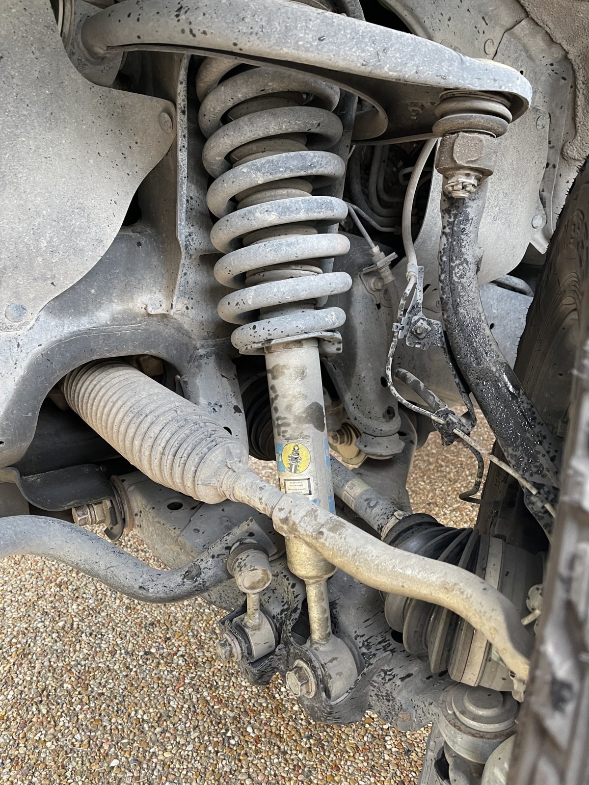

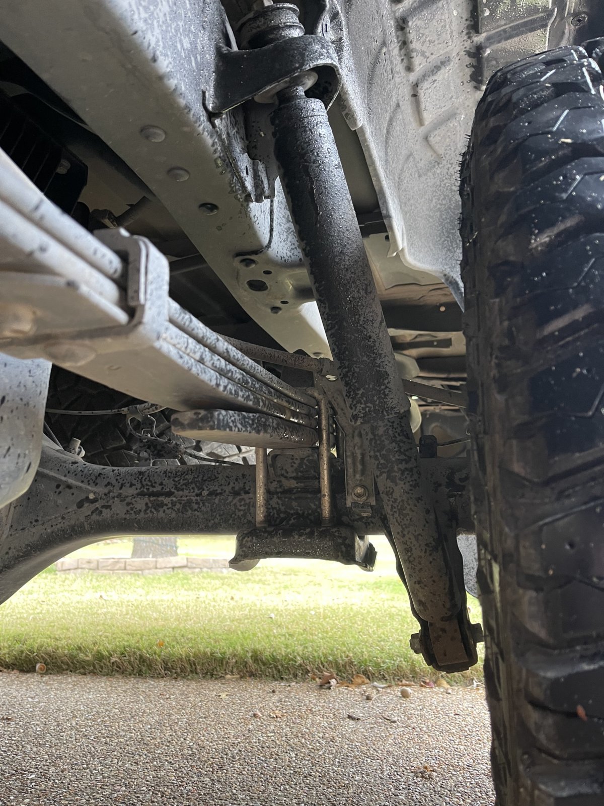

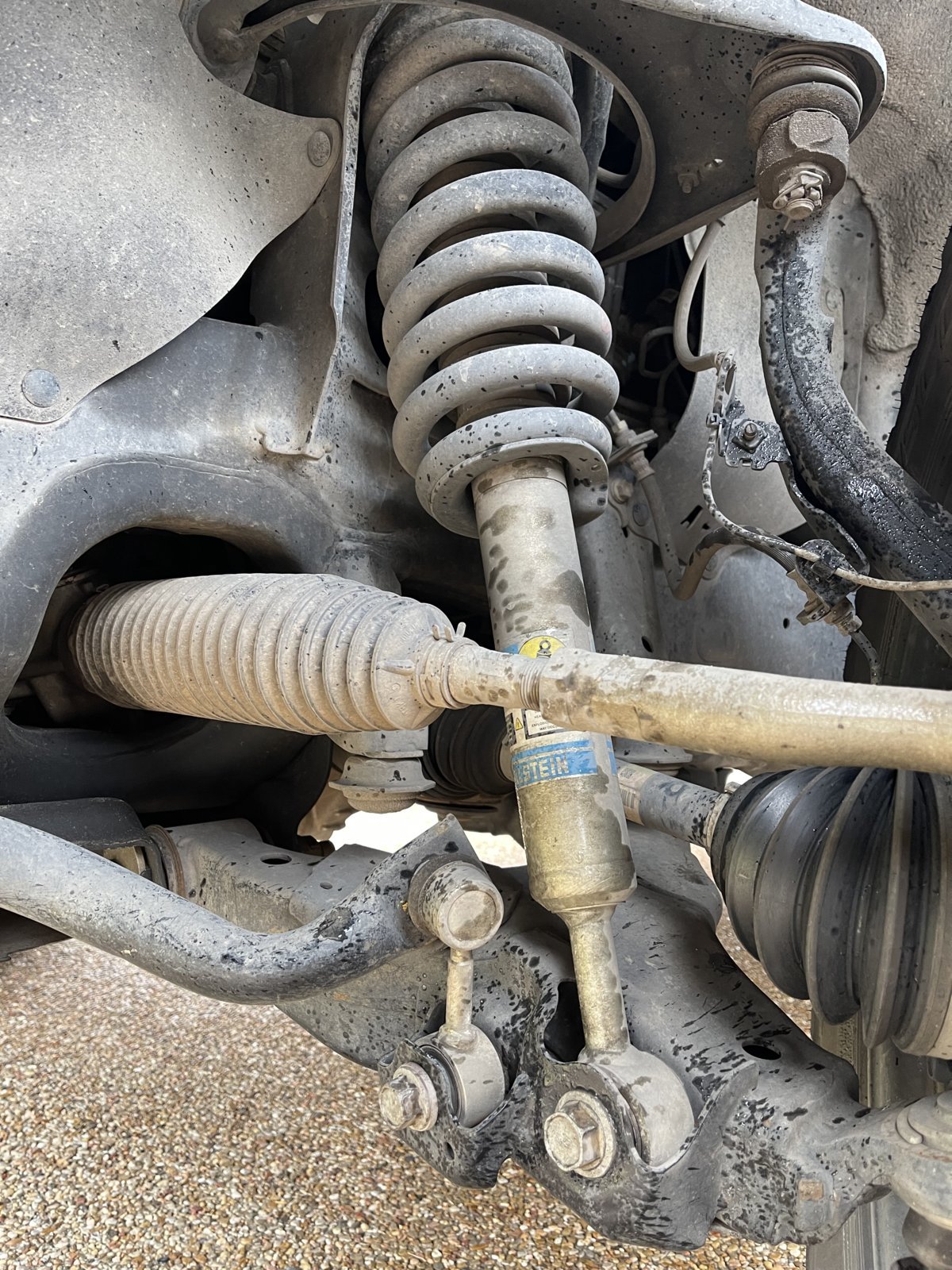

    sorry for the delay on this, but here is what it’s looking like! Multiple pics of front and one of rear setup.

    Those front shocks are Bilstein 5100's. They have an adjustable circlip with several different grooves on the the shock body to adjust height. Yours look pretty high already but there might be one more notch left to move it up and offset the weight of the bumper. Unfortunately, you need to remove and disassemble the shock to check or adjust. An experienced DIY'er or shop can do it in an hour.
    But you could also use some shims on top of the shock body. They usually come in 1/4" increments and you can add up to two per side. 1/4" shim adds 1/2" of lift, so you could adjust for up to 1" of sag using the spacers. You need to unbolt the strut assembly to install the shims, but you don't need to disassemble the strut like moving the circlip. Years ago I went that route to offset some shackles in the rear and give just al little bit of lift to my truck; I think I was able to get away with not removing the strut assembly entirely an just undoing the lower ball joint mount (two bolts at the very bottom of the spindle) as well as the four bolts at the top of the strut. You then pry down on the lower control arm and slip the spacers on top of the strut before pushing the top bolts back up in to the strut tower and bolting it back together.
    BTW, I would consider replacing the rear shocks with some matching 5100's. You will thank yourself. Nice truck, too :)
    Edit: I should also add that the 5100's retain the stock coil, which is a 700 lb/in coil. If the Demello bumper is 150 lbs and is about 2 ft away from the coil, you can expect less than 1/2" of squat from the bumper.
    An alternate route to go would be to replace the front coil itself with an aftermarket unit with the desired lift built in or a stiffer spring rate. I don't recall offhand what coils will fit as stock replacements, but I think ARB coils and Dobinson coils work. They both offer different coils for different setups, so you will need to find a stock replacement coil, not replacement coils for their higher end shock models. I don't think Old Man Emu coils work, but perhaps somebody will correct me on that. Either way, shims are the cheapest and easiest way if you are satisfied with the ride as is. Do NOT confuse the shims (1/4" thick) with spacers (1.5+ thick). The latter will screw EVERYTHING up.

    and I think I am going to order some 5100’s for the rear this Black Friday!! I really appreciate the recommendation. It looks like the 5100’s on the back don’t add any lift, and just keep stock height?

    Regardless of brand, rear struts/shocks do not add any height as they do not actually support any weight. Your leaf springs and shackles would be what add height if you change them, but if you lift the rear you may need new struts/shocks in the rear to accommodate any increase in travel.
