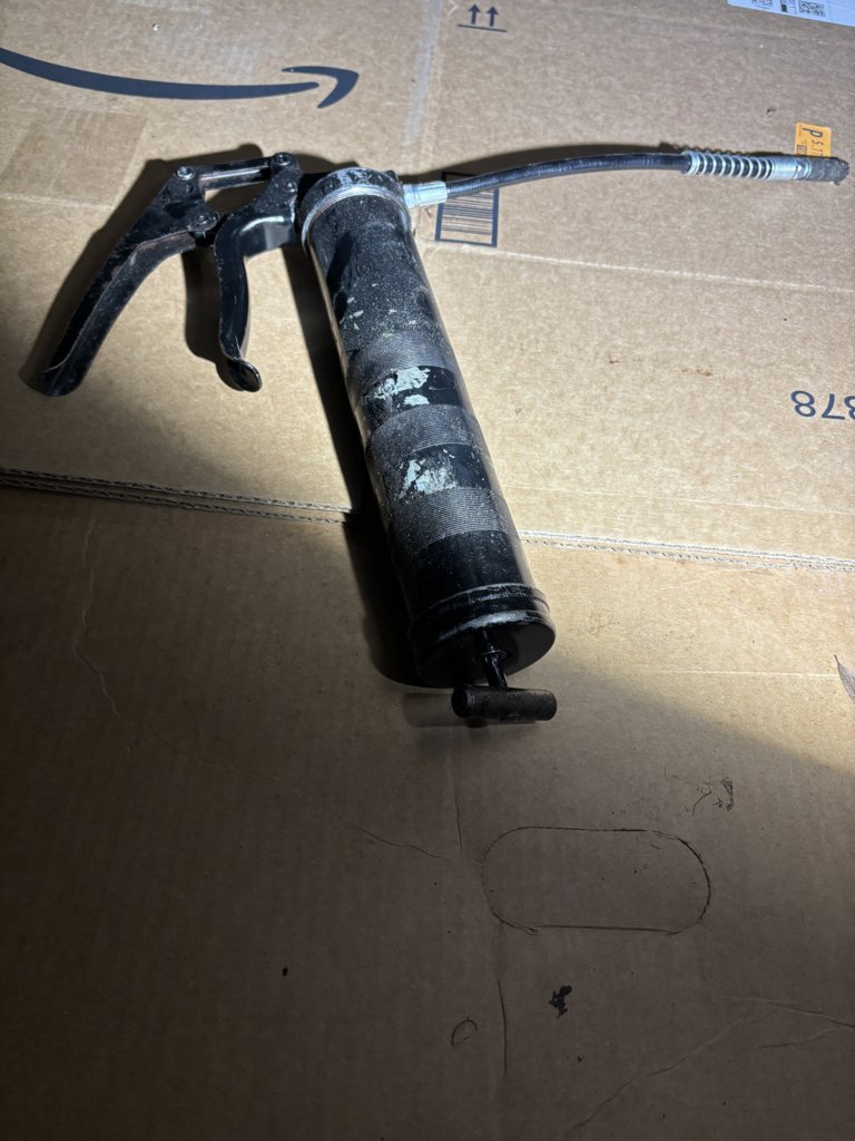

    This is what I use to get the hard to reach zerks.

    I made a modified tight clearance tip for my grease gun by grinding the end of it into a taper. Works great.

    Yeah, it really works well. My old grease gun finally shit the bed, and when I had to buy new it seemed that all of the couplers had grown. I was stupid and the tip did not get removed from my old one before it went into the garbage. I'm not sure what it was, but the old tips had thinner walls. I guess it's easier to make new ones thicker to account for cheap metalurgy? This was the easiest solution for me. It also works really well for adding grease to CV axle joints. Mine were slinging like mad until I replaced the clamps.

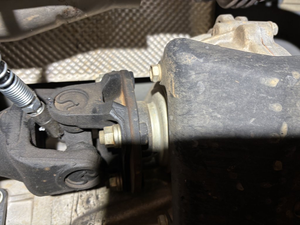

    Yup, that's what I essentially just posted in the 'whatd you do today' thread: https://www.tundras.com/threads/wha...-gen-tundra-today.2558/page-2224#post-3791015
    I'm quoting that text below.
    Rotate by hand. Lock on. And I included pics of me using a standard tip, sitting well-seated on the 4WD shaft, which I rotated by hand to get the best angle. I guess I've been living in the dark, the rear shaft requires more handfuckery IMO. Sure, the front is smaller diameter, but there are definitely avenues to get a good lock. If I can get a good lock, using one hand, with a not-so-special very old gun, not sure I see the beef here?
    Expand for pics:
