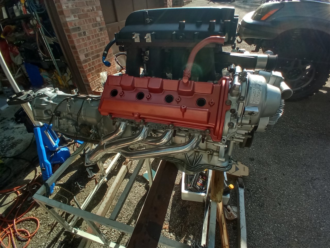

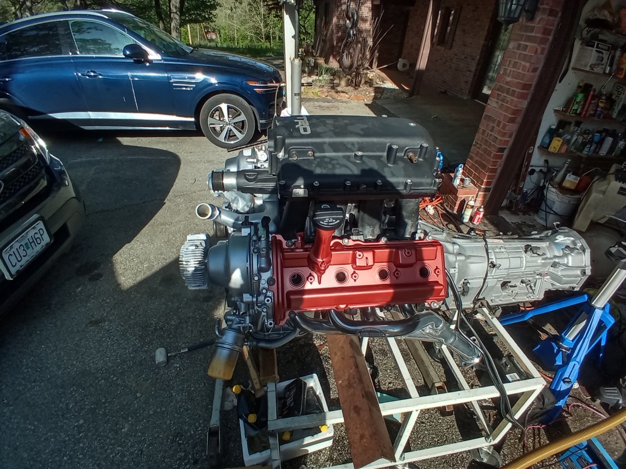

    I owe you Bubba thanks! Do you happen to have the 2004 FSM also for direct comparison? I am going to do a separate thread with photos etc. on the complete restoration of this GX470 when complete. I would love to dyno it to see what the actual output is. I will post details of mpg and performance also. This forum has been GREAT! You made my day! I am trying to get this engine in and complete over the next 3 weeks. I have factory 270 cc injectors and the TRD supercharger came with 330 cc injectors along with two 660 cc 9th and 10th injectors. I thought maybe I should go with 440 to 550 cc injectors? Anyone have a part number for larger injectors that plug right in? My 2004 RS6 4.2 liter Biturbo V8 uses 780 cc injectors.
    I bought this old 2004 Lexus GX470 new and was going to sell it cheep to get rid of it but after climbing all over it I realized this thing was built reliable/fantastic and it has no rust so I have made a tough off road Jeep out of it that is quite and fun to drive.

    We expect no shortage of pics once done :D

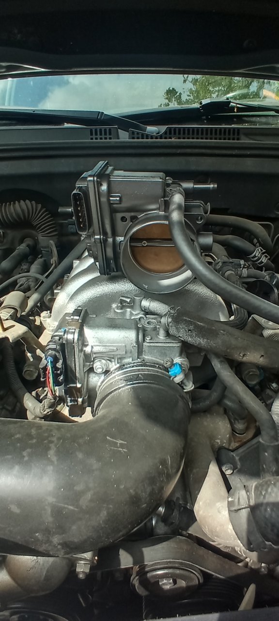

    Well more complications today the electronic throttle valve bolt patterns are different between the 2004 GX470 and the 2005 Tundra VVTi. These are both drive by wire. The TRD supercharger bolt pattern is setup for the 2004 plus 2004 uses larger diameter bolts. The hookup wires are the same 6 pin connector so maybe the signal the 2004 output will work for the 2005? Any guesses out there?
    Also I picked up several Pulse width modulators from Amazon and they control the VVTi valves very precisely with turning the knob I can retard or advance the intake cam from 15 thru 59 degrees. The non VVTi cam is set to 36 degrees. Since I am in unchartered territory maybe there is an advantage to my madness LOL? The 2005 VVTi was not setup particularly for supercharging and I am not sure if my 11:1 compression ratio is too high as it is yielding 230 psi cold cranking pressure on the compression tests. By controlling the intake valve timing I can get the effective compression ratio down to 10.2 to 1 with just a twist of a knob. I just really want two settings one to maximize economy at 1800 rpm cruise and the other for max power without detonation.
