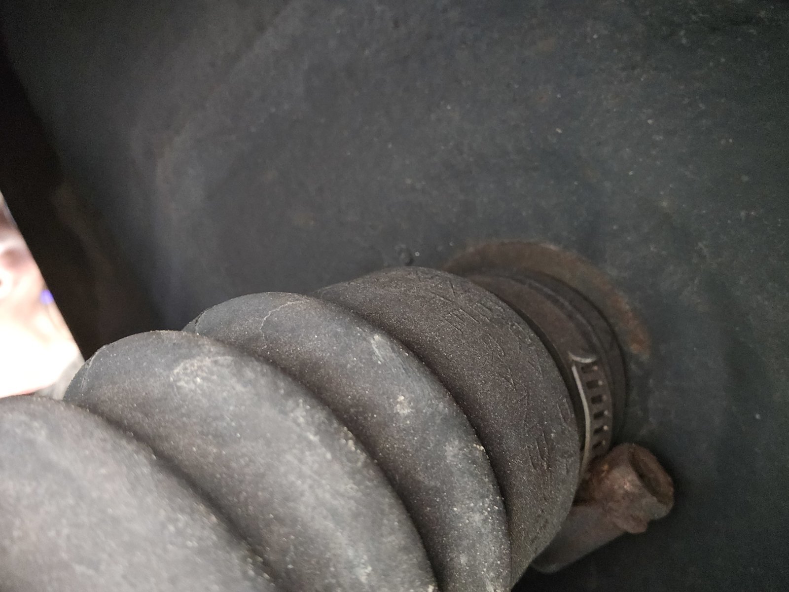

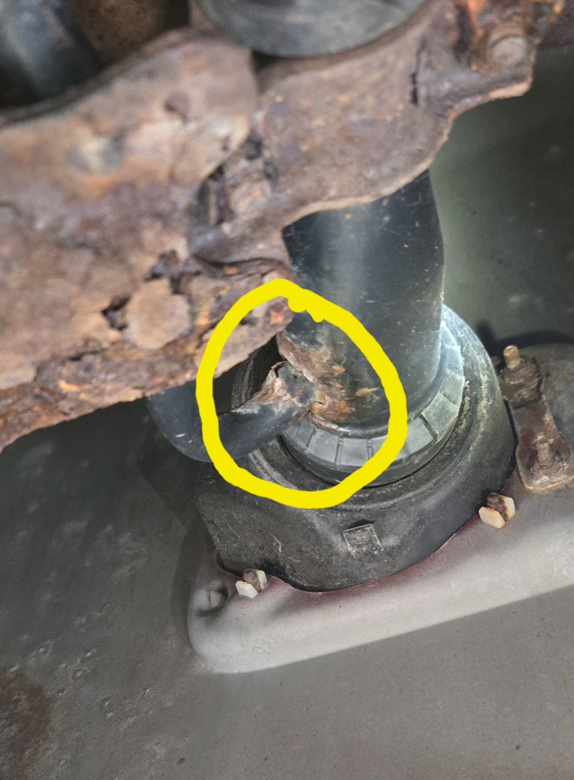

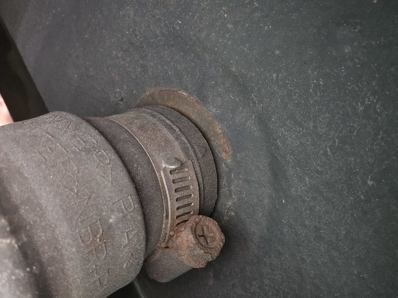

    So...took a few pics. I see the potential issue where the smaller hose joins the fuel filler tube....notice the rust area and what appears to be holes at that joint. Also notice the unusual gashes on both hoses...maybe someone was working in the area and a tool slipped. Looks like each of two hose clamps were removed and not replaced. I just bought the truck a few months ago. Was a one-owner vehicle.
    Also took pics of the other end of the hose at the top of the gas tank. Do not see an issue there although I could not get to the other side of that hose for a pic.

  11. Jun 11, 2024 at 9:25 PM
    Jack McCarthy
    Nov 2, 2020
    #54409
    10,580
    Bill
    North of Boston
    02 Tundra AC SR5 V8 4x4
    Have you checked the dealer to see if they carry the parts or if it was discontinued?
    If your frame got replaced/sprayed it might explain what you see (missing hose clamps and slashes).

  13. Jun 12, 2024 at 7:09 AM
    NickB_01TRD
    Jun 16, 2021
    #64346
    2,741
    Nick
    KY
    01 Tundra V8 4X4 AC SR5 TRD
    Man what does the rest of your frame and fuel tank straps look like?
  14. Jun 12, 2024 at 7:59 AM
    theleeb
    theleeb [OP] New Member
    Mar 1, 2020
    #43371
    50
    Tom
    Upper Marlboro, MD
    2002 Tundra Access-cab SR5 4x4 4.7L; 2016 Tundra Crew Cab - Limited
    Actually, those pics are pretty much the worst of it. The frame does have some spot rust but all the metal is intact
    NickB_01TRD[QUOTED] likes this.

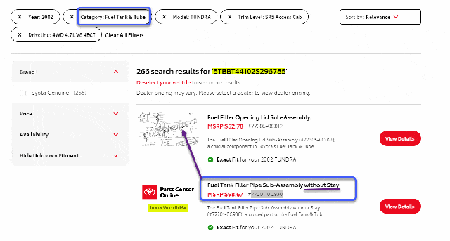

    On a Toyota parts site but have not been able to nail down an OEM part number for the fuel filler tube. It's an 02 4.7L AC 4x4 SR5.

  16. Jun 12, 2024 at 10:47 AM
    shifty`
    shifty` We call it “riding the gravy train”
    Jun 20, 2020
    #48239
    29,754
    ATL
    '06 AC Limited V8/4WD

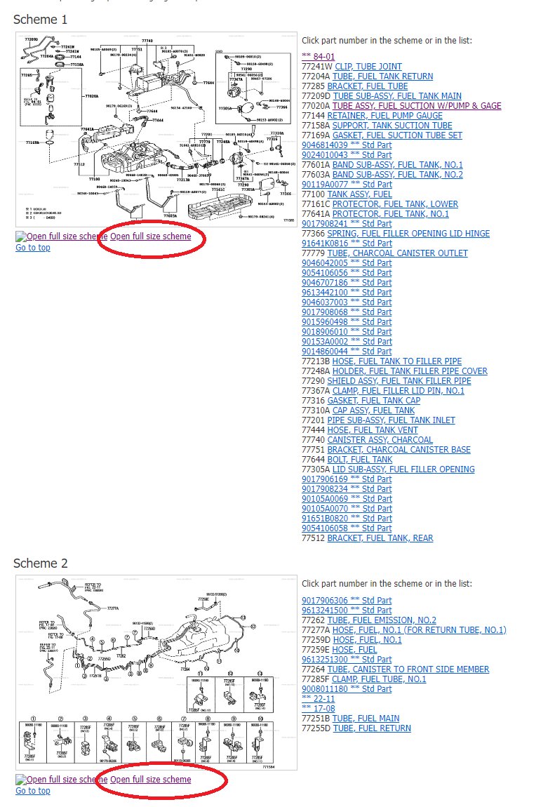

    Use the site in the bullet points here: https://www.tundras.com/threads/howto-use-the-toyota-parts-system-to-find-order-parts.113808/
    It should be under the 'Fuel and Body' section, then search the page for "fuel", click thru to the 'Fuel Tank & Tube'.
    Once in there, click on the 'open full size scheme' for each pic to find what you need. Click the number pointing at the part(s) you need.
  17. Jun 12, 2024 at 11:53 AM
    theleeb
    Mar 1, 2020
    #43371
    50
    Tom
    Upper Marlboro, MD

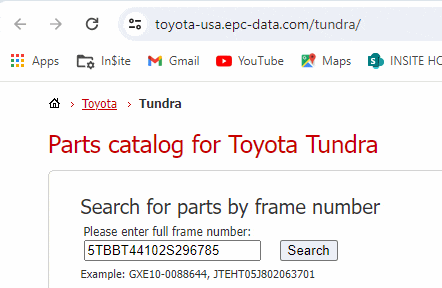

    Thanks for the information. The website from the referenced forum page, first bullet (https://toyota-usa.epc-data.com/tundra/), did not provide the schema for the fuel filling system...unless I missed it.
    However, using the autoparts.toyota.com site, I followed your guidance and I think it landed me on the correct part listing. It did not have a diagram but I looked for another part in that category that did to find the part.
    I will confirm with a dealer before purchasing. I will ask them what "without Stay" means as well.

  18. Jun 12, 2024 at 12:01 PM
    shifty`
    Jun 20, 2020
    #48239
    29,754
    ATL

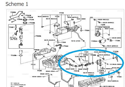

    Weird, I see all the filler stuff right here, as seen in my screencap above:
    Jack McCarthy likes this.

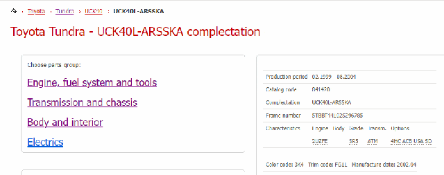

  19. Jun 12, 2024 at 12:43 PM
    theleeb
    Mar 1, 2020
    #43371
    50
    Tom
    Upper Marlboro, MD

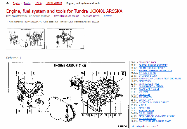

    Hmmmm, I see what happened. The category that site used for the fuel filler system is Body and Interior. That is not intuitive to me but that's where it sits, so I'm good now.
    Below is the play by play when using the more intuitive (at least to me) Engine, Fuel System, and Tools category. At least there are just four possible categories for deploying the trial and error method.
  20. Jun 12, 2024 at 1:01 PM
    shifty`
    Jun 20, 2020
    #48239
    29,754
    ATL
    Sorry, yeah, I had a typo above. I meant 'Body and Interior' but I said 'Fuel and Body', which isn't a category.
