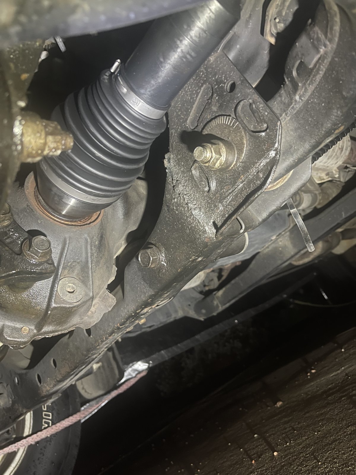

    No, compare the angles, i'll have my front wheels back off tomorrow afternoon & get a good look at the boots at full lock, but yea, i'd say the inner boots are longer. Gimme a minute.
    & they did extend, when i was attaching the ubj the knuckle slipped in my hand & i had thought the axle had come out of the diff, but it didnt. It all happened kinda fast & i almost forgot about it.

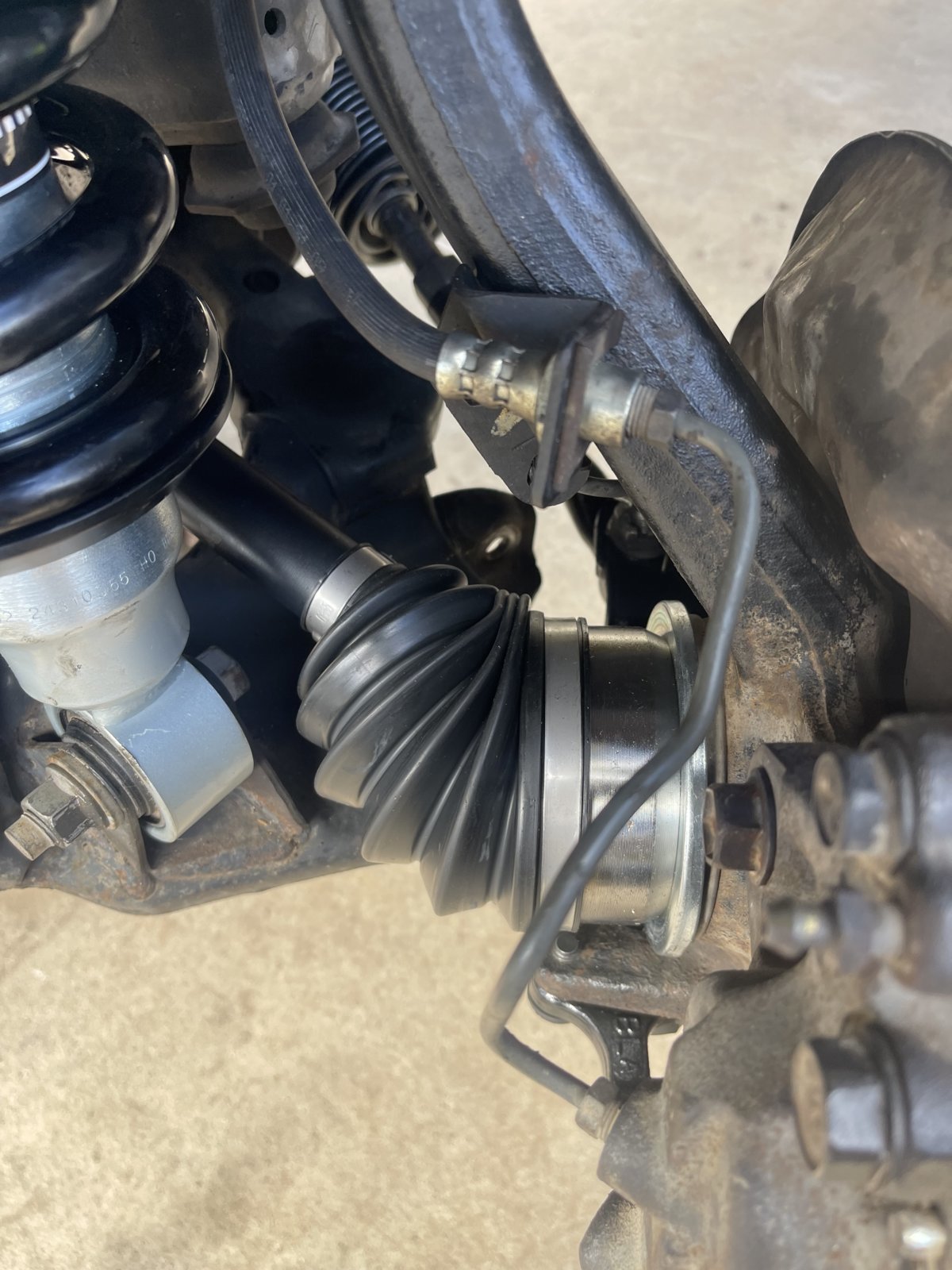

    Definately some boot touching. Not too bad straight on.
    pretty good at full droop, but i'm on the lowest spring setting. I wanted the extra articulation for a spacer above the shock. I dont mind a diff drop as long as it clears my skidplate.

    Looks like your inners don't seem to be rubbing and that's great. Guess that makes sense with only a mild lift but wondered how the Trackmotive boots fit as hadn't seen them compared to OEM that are pretty tiny.
    Can see your old CV boots must have split, eh? What did you do with the OEM CVs? Rebooting them?
