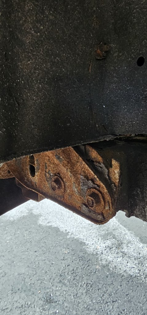

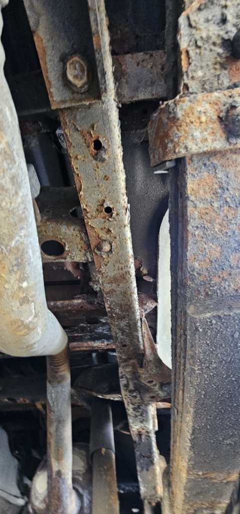

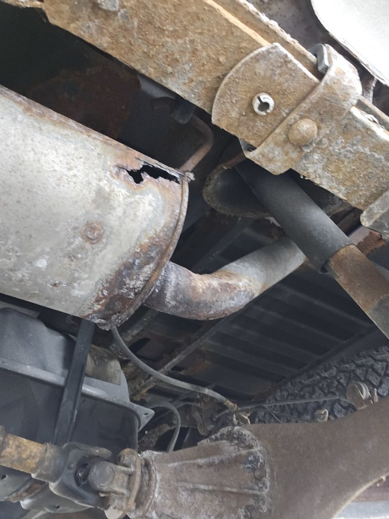

  17. Mar 3, 2025 at 5:35 AM
    Chad01Tundy
    Chad01Tundy [OP] New Member
    Nov 1, 2020
    #54366
    18

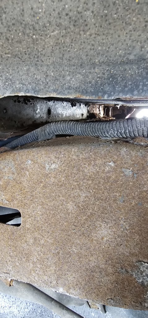

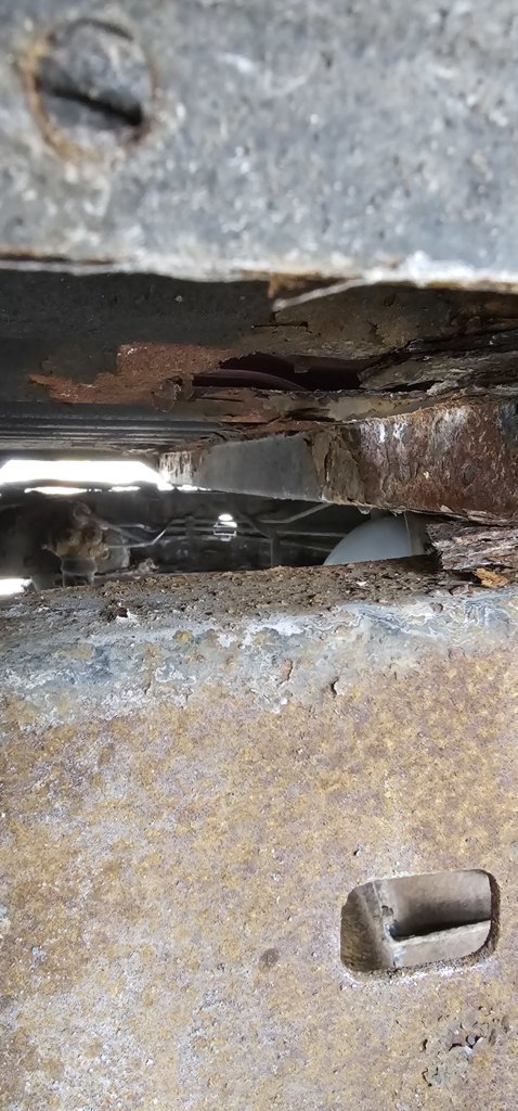

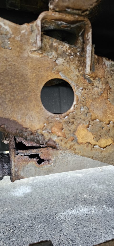

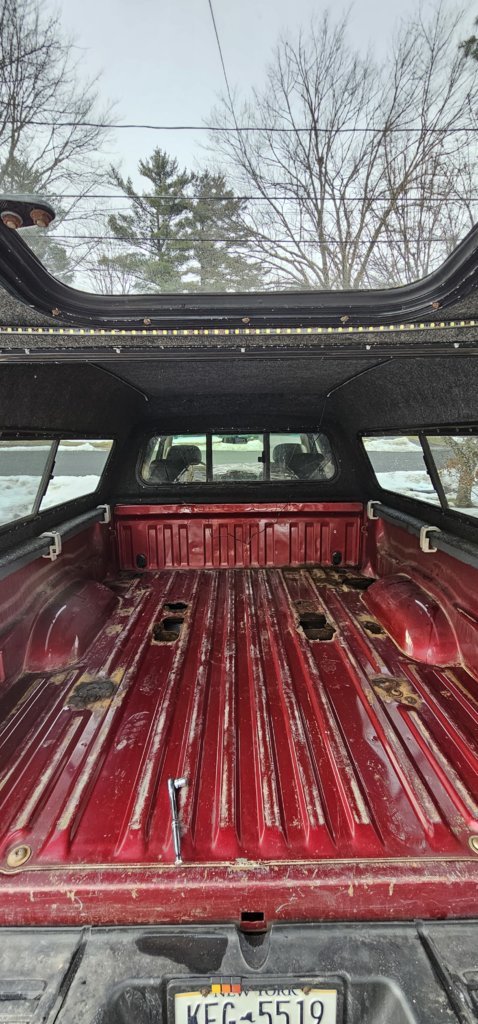

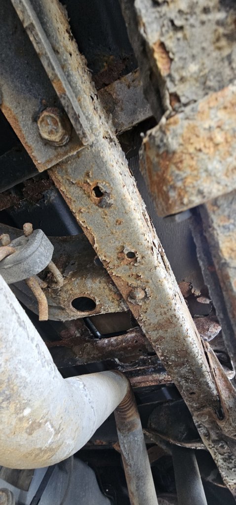

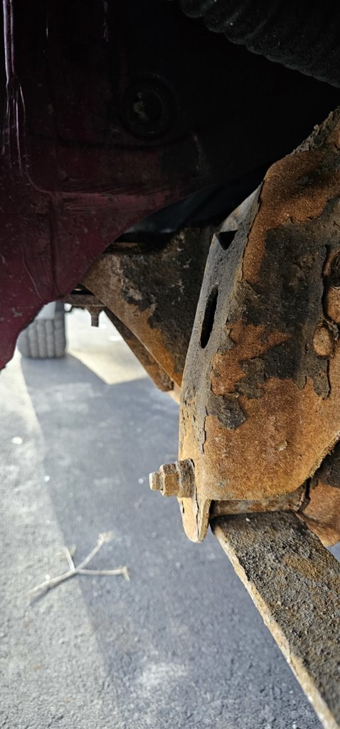

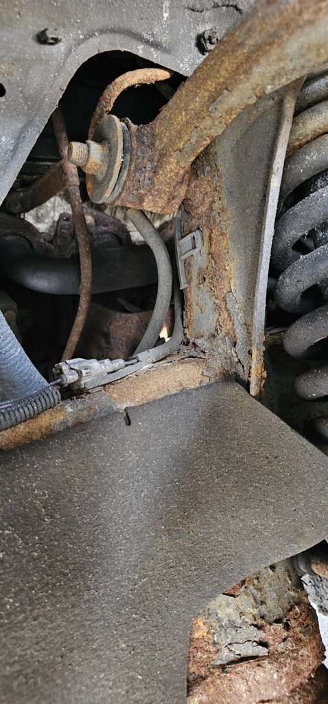

  18. Mar 3, 2025 at 5:37 AM
    Chad01Tundy
    Nov 1, 2020
    #54366
    18
    Hey Folks,
    Thanks again for your help so far. I feel like a should mark this as NSFW for those of you who don't live in the rust belt. Any insights you can share on the condition of the frame is appreciated. I can snap some more photos if that is helpful. Can't help but feel like I am in the waiting room of the ER right now.
    G_unit3000 likes this.

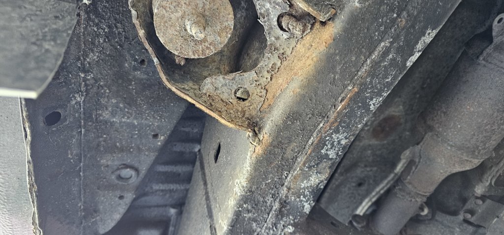

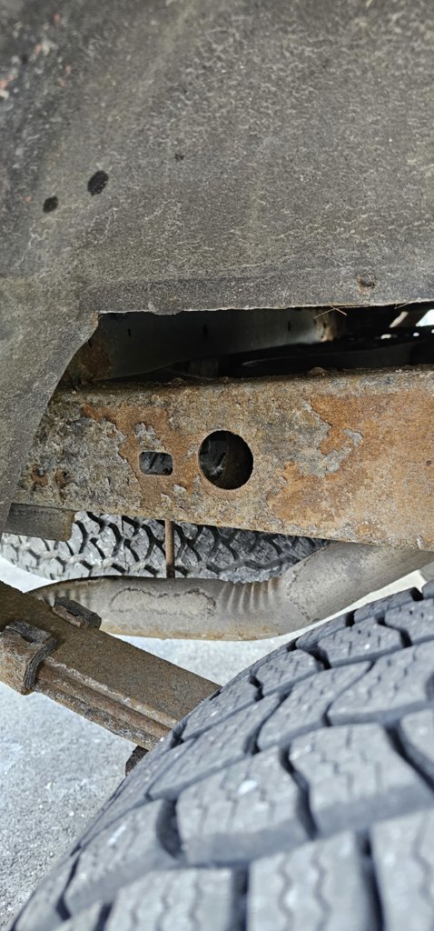

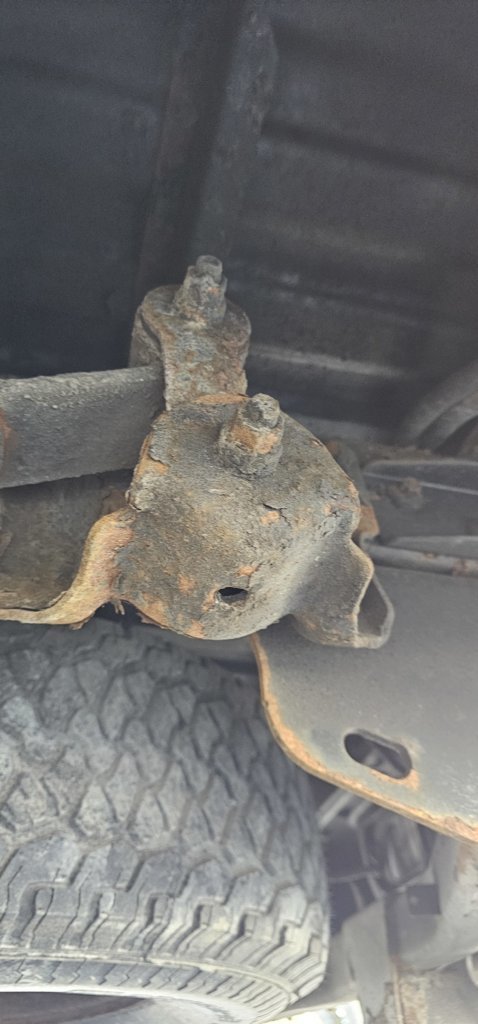

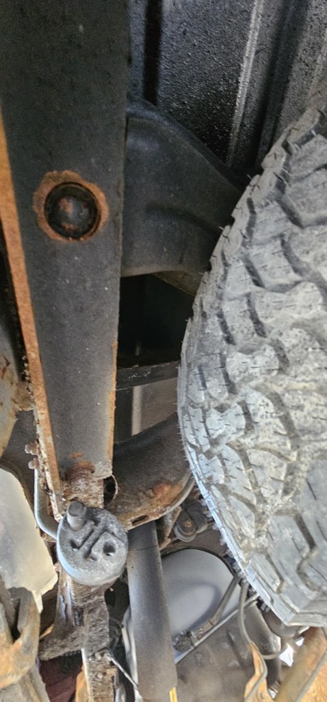

  19. Mar 3, 2025 at 5:44 AM
    shifty`
    shifty` Waving My Dick In The Wind
    Jun 20, 2020
    #48239
    30,101
    ATL
    '06 AC Limited V8/4WD
    Props for showing it.
    I'm sure those bed bolts are probably siezed up worse than a blood clot in your brain while having a stroke, and it's clear the horizontal braces are chonked. In that 5th photo you can see full delamination happening of the steel.
    Anything you do to that bed is going to be a temporary band-aid solution.
    Above the spare tire is an "X" shaped crossmember. Can we get a couple of shots, one from each side, where that is riveted to the two long, horizontal back-to-front frame rails?
    Your mud flap is hanging down in front of the driver side shock tower. Can we get a shot of the other side of the shock tower, a picture of the frame there? That's where the frames usually seem to crack in half, often on the inside of the framerail (engine bay side).
    I probably don't need to tell you, you're overdue to a muffler, ain't no saving that one.
    Clearly it was coated with something at one point, and that's since given way to cancer.
    G_unit3000 and Chad01Tundy[OP] like this.
  20. Mar 3, 2025 at 5:56 AM
    kentuckyMarksman
    kentuckyMarksman New Member
    Jul 24, 2023
    #100837
    536
    2006 Tundra SR5 Double Cab - 4.7L V8 4x4
    For the bed, I'd probably cut the rusty sections out and mig weld new metal in.
    But looking at the frame, you've got a fair amount of other rust going on. If it were me, I'd check out all the other areas on the frame / truck for rust and figure out how bad it was, and think about the work / cost involved in making everything right vs buying something else and decide from there.

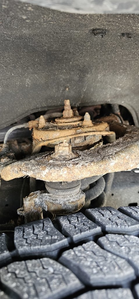

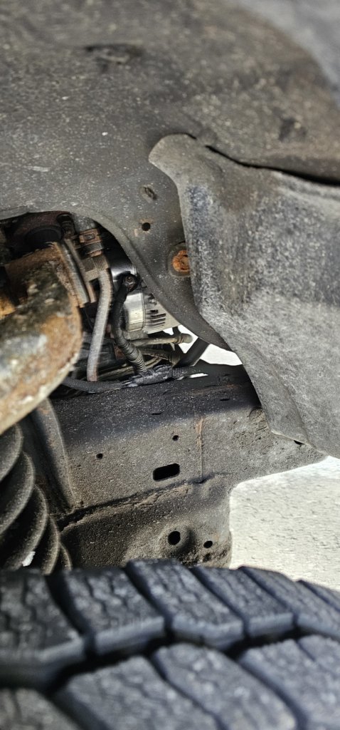

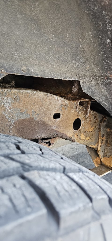

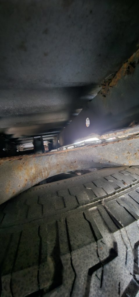

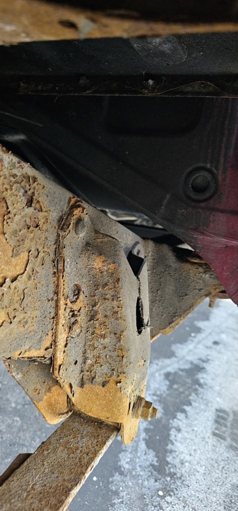

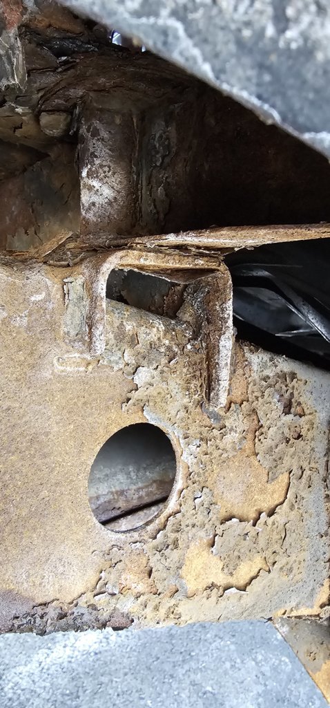

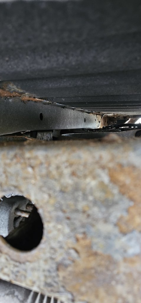

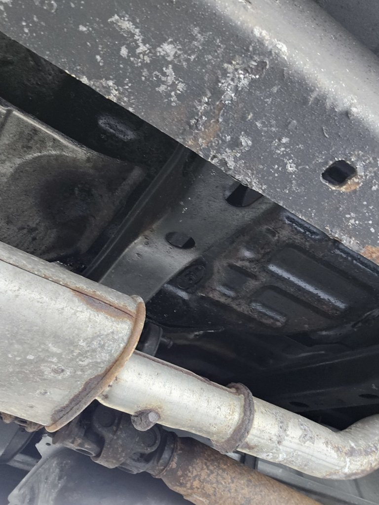

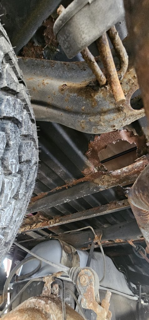

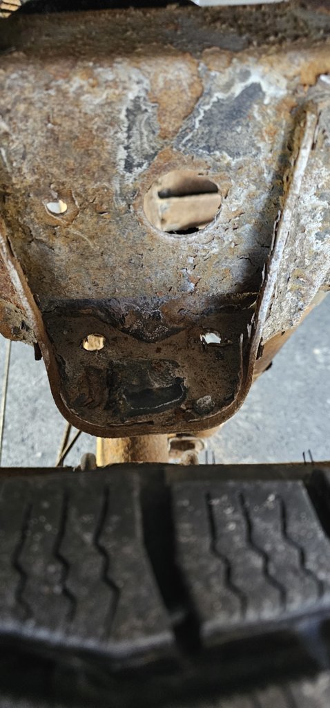

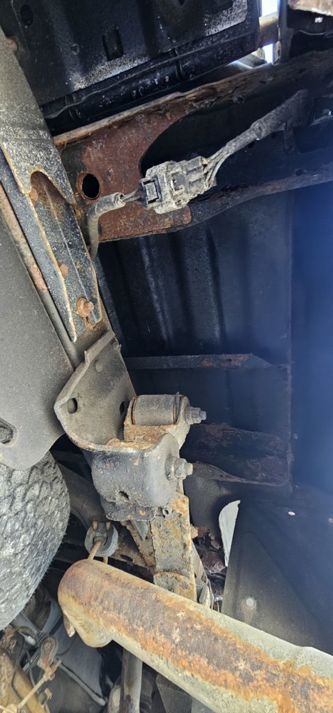

  21. Mar 3, 2025 at 6:07 AM
    Chad01Tundy
    Nov 1, 2020
    #54366
    18
    Thanks to those who replied. A few more photos. 20250303_084951.jpg 20250303_085015.jpg 20250303_084903.jpg 20250303_084958.jpg 20250303_082435.jpg 20250303_082500.jpg 20250303_082506.jpg 20250303_084915.jpg 20250303_084919.jpg 20250303_085311.jpg 20250303_085336.jpg 20250303_085430.jpg
  22. Mar 3, 2025 at 6:32 AM
    ATBAV8
    ATBAV8 New Member
    Dec 1, 2023
    #107779
    894
    Tempe, AZ
    2003 V8 SR5, Access Cab, 4x4, White
    Man, that's tough. While I think your frame is still salvageable, there are so many things that I can see that require attention, like yesterday. I think you're going to be chasing problems and throwing money at this thing for eternity. I personally would cut my losses and find something different. Not that I couldn't do the work, but even trying to get bolts off to replace parts is going to be trying. I would begin to hate that truck. I don't want to hate my truck. I want to love it. Just my $.02. Good luck with whatever you decide.
  23. Mar 3, 2025 at 6:36 AM
    Chad01Tundy
    Nov 1, 2020
    #54366
    18
    Thank you for your input. Care to expand on the things you see that need to be addressed? I love the truck. Drives great shifts great. Only 130K in the clock. But you are right, I don't want it to suck the life out of me.
  24. Mar 3, 2025 at 6:42 AM
    #24
    G_unit3000
    G_unit3000 New Member
    Jun 25, 2024
    #118959
    279
    Gman
    North East
    2005 Tundra DC 4x4
    Others can speak to the specific rust problem areas better than me.
    If you have been getting your frame sprayed every year since 2020, you should definitely go to a new undercoating shop or start spraying Fluid Film or Woolwax yourself. Spend a good amount of time with a screwdriver and wire brush scraping off the loose rust and old undercoat. And then spray the frame and the entire underbody in the early summer, don't wait for fall. The heat of summer will then aid in the fluid film creeping into all areas. Spray it multiple times over the summer because you will find areas that you have missed. Plan on using 2 gallons of fluid film. Go nuts.
    Edit: I should add, pop all those body plugs and spray in there. There will definitely be rust forming in those areas. Spray in the engine bay. Coat the inside of all of the body panels from beneath while laying on your back. The best video on how to do this was shot by Eric at South Main Auto.
    https://youtu.be/TRsD-fgt6h0?si=0iTZor2HOhVl_SMv
    Chad01Tundy[OP] likes this.
  25. Mar 3, 2025 at 7:25 AM
    #25
    ATBAV8
    ATBAV8 New Member
    Dec 1, 2023
    #107779
    894
    Tempe, AZ
    Let's see...Things I would want to fix: Front suspension probably including upper and lower control arms, bed (obviously), exhaust (maybe just muffler, but I'm willing to bet there are other holes about to open up), rear shocks, bushings (everywhere), brake lines (can almost guarantee you touch it, it's gonna break), LSPV and all of it's components (may not need replacing, but service), cleaning and coating the entire frame (big job). For sure you can count on breaking fasteners for any part you attempt to replace, and we haven't even seen under the hood yet. No mention of timing belt, LBJs, radiator, valve cover leaks, etc. The fact that you want to make a camping rig out of this really implies that it needs to be 100% dependable. Do you want to be broken down in the middle of nowhere? Keep in mind that rust NEVER sleeps. Again, my $.02. I'm spoiled, I have a rust free example that's been in AZ all of its life. But, it's still a 22 year old truck and it requires regular maintenance. I'm coming up on 100K and I know the LBJs and the radiator need to be replaced. Anyway, not sure of your maintenance history, and I'm a nit-picky pilot that goes over maintenance stuff with a fine toothed comb. Only you can decide if it's worth it. One thing I know to be true with older vehicles is this: if you can't do the majority of the work yourself, you better have a FAT wallet.
  26. Mar 3, 2025 at 6:13 PM
    #26
    Jack McCarthy
    Nov 2, 2020
    #54409
    10,670
    Bill
    North of Boston
    02 Tundra AC SR5 V8 4x4
    You got a crapload of work ahead of you to protect that frame from further rust cancer. You should check the condition inside the boxed channel of the frame below the front doors. Chances are rust is also eating its way from the inside out.
