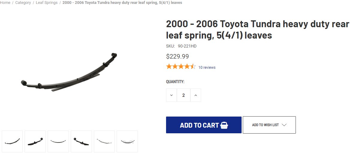

    There has been some discussion elsewhere on the forum about general springs. On the fence with them or Alcan again like I used for the V6.
    Anyone got any real world reviews? Did a quick searchie, but couldn't find what I was hunting.

    Mine work great. I went with new shackles as well. They're a tad stiff, but that could be the toytecs overdamping them.

    ‘06 ac has slightly longer, slightly thinner leafs, than ‘02 leafs.
    When designing made-to-order springs i’d be apt to exaggerate the overall capacity i’m looking for by 1000 lbs, so when it shows up weak, its perfect.

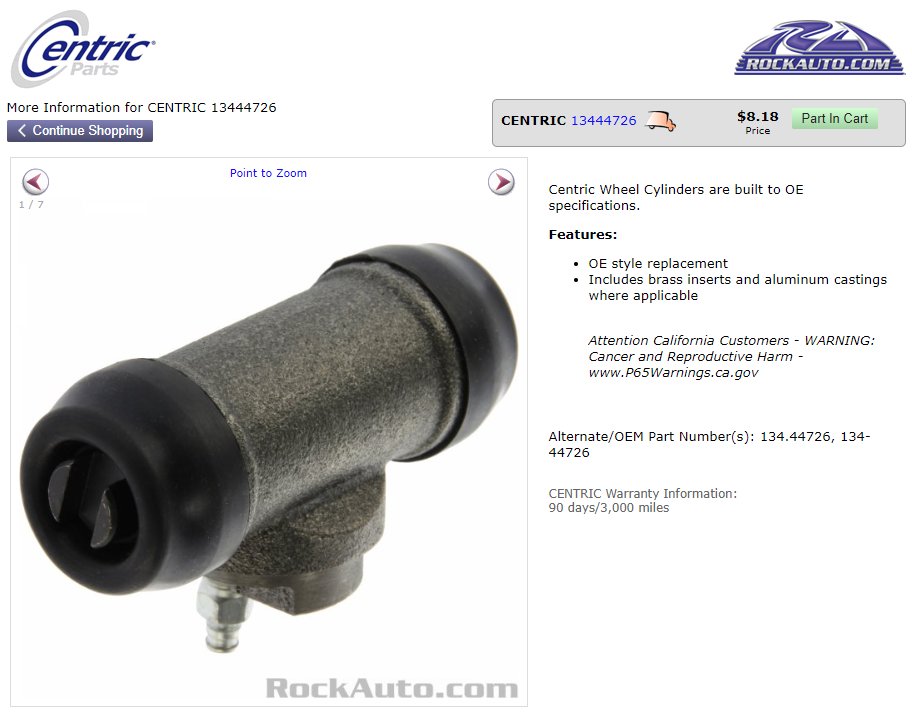

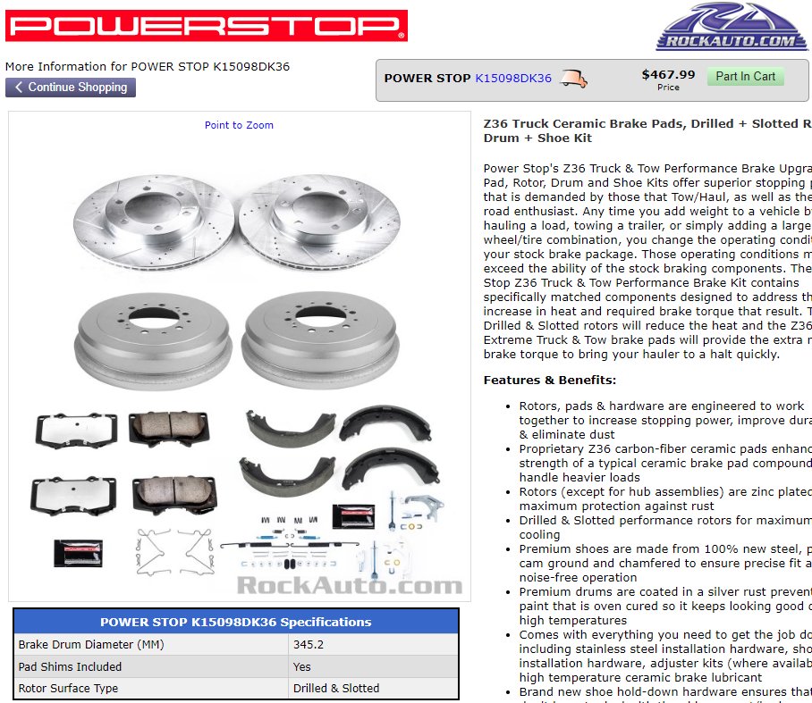

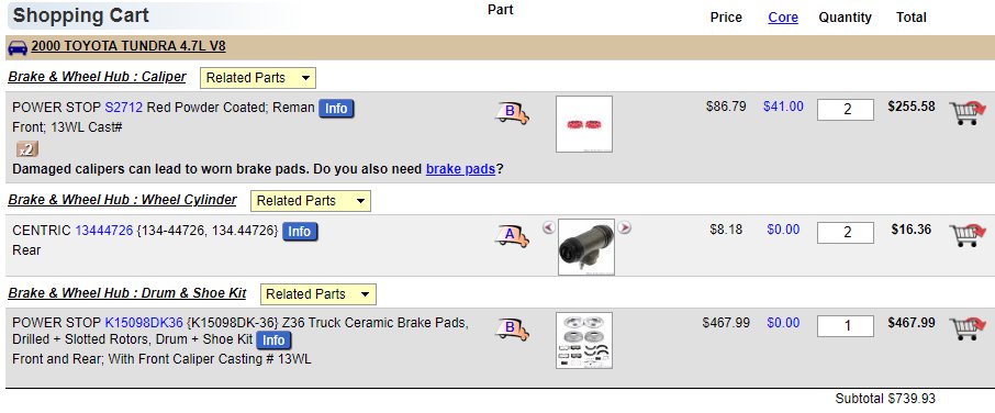

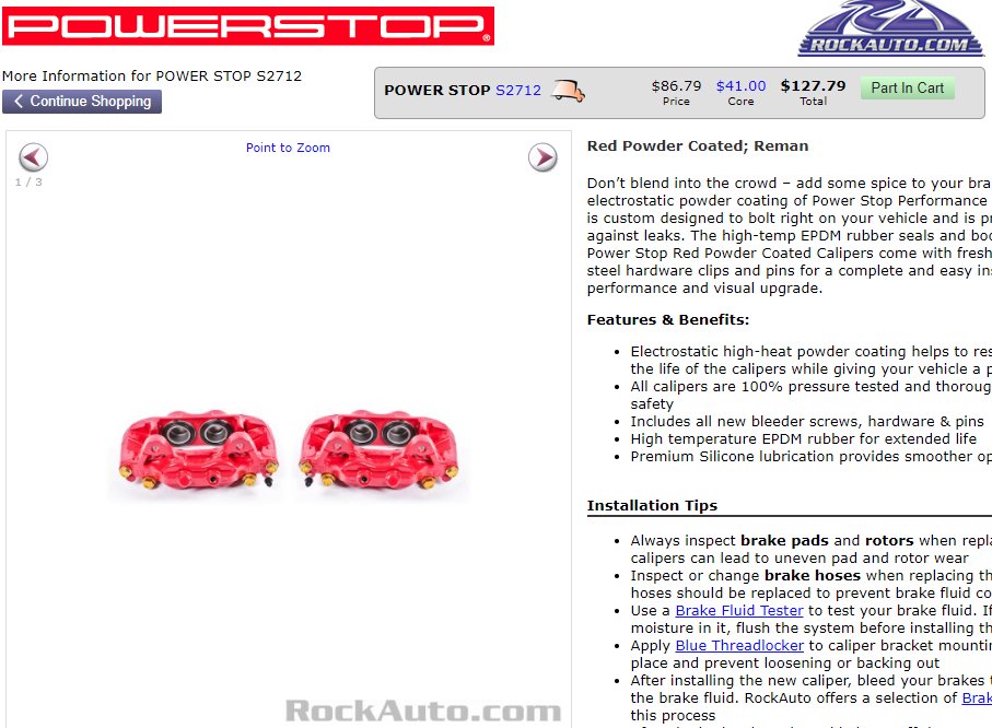

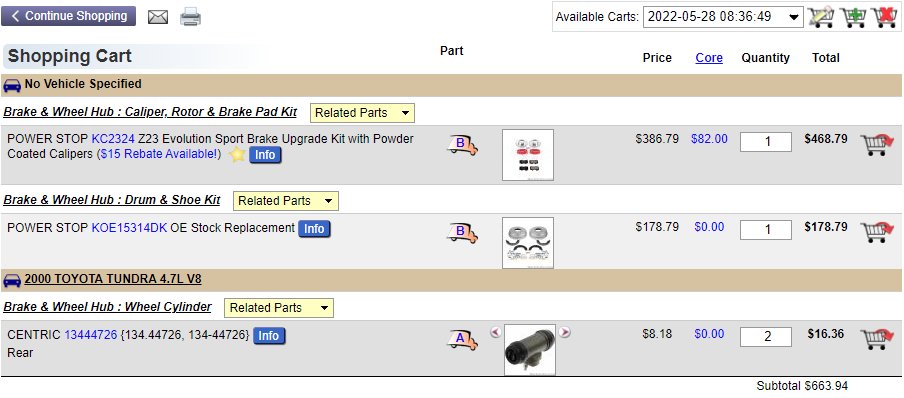

    Slowly starting to build a parts list for crackie. Pictures are links to the listing on RockAuto. Looking at brakes right now. Open to any, and all suggestions/advice! Also, for peace of mind... I'll go ahead, and do the Brake booster, and Master cylinder. Special thanks to @Thrussn for this! T100 brake booster upgrade!
    Not against any suggestions of anything else from anywhere else. Memorial day coming up, I'd like to jump on any discounts I can snap up...
    Thanks in advance!

    You'll save yourself some cash if you go with these two.
    https://www.rockauto.com/en/moreinfo.php?pk=4752030&a=PowerStopPK
    https://www.rockauto.com/en/moreinfo.php?pk=8845304&a=PowerStopPK

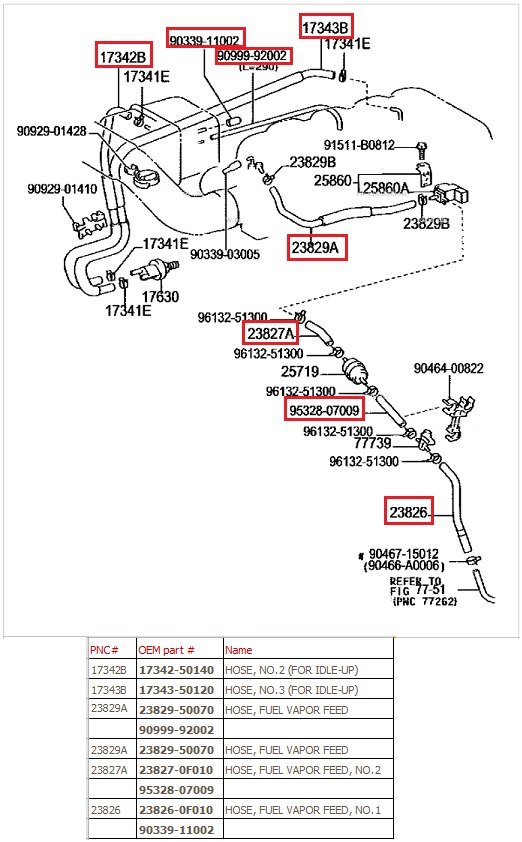

    I also need to completely redo my vacuum lines. They're all hard as a rock and cracked. Small evap leak code just came on too.
    Did you find a kit or just got some stock hosing and cut everything to size. My mechanic said that he wasn't sure how to do the vacuum lines because they were specially bent.
    New to vac lines... I don't know heck about the evap system so any insight would be appreciated

    When I did mine, I chose to go OEM. Hard part was most toyota online sites weren't that accurate with their part presentation for vacuum lines. I chose to use the below site and all worked out well. If you choose to go OEM, you could at least use the site to look part #'s up.
    At that link, choose your basic model/frame code, at next page select whole model code, next page select Engine, fuel system...., next page over to right select Vacuum piping.
    Parts catalog for Toyota Tundra (epc-data.com)
    the below is my layout for model code UCK41L-PRSLKA....

    Not sure the real world review on Powerstop rear drums, but most aftermarket give vibrations that are unresolvable. OEM seem to be the #1 choice for drums. Mixed reviews on powerstop fronts. OEM rotors with EBC green stuff pads seem to be the best reviewed for fronts.

    Thanks bubba this will get me started. How much did the hosing run ya, do you remember?
    Might be kind of a peaceful job... Just matching up hosing and replacing

    Approx $100 but it was only the 2 going to the air control valve on PS motor and also the one on driver side going to the throttle body. Those 3 had enough drastic 90's, I chose to use OEM. Your 03 will be different from my 04 in many ways and suggest you look at @Tundra2 post below and perhaps he'll recall what size tubing he bought.

    Yeah @Tundra2 I'm curious about your experience sourcing all the vac hosing.

    Man, I was just looking for where I bought that to link it! One size doesn't have quiet enough if doing all the hoses. The 2nd biggest I believe.

    8mm then? This is great guys, thank you.

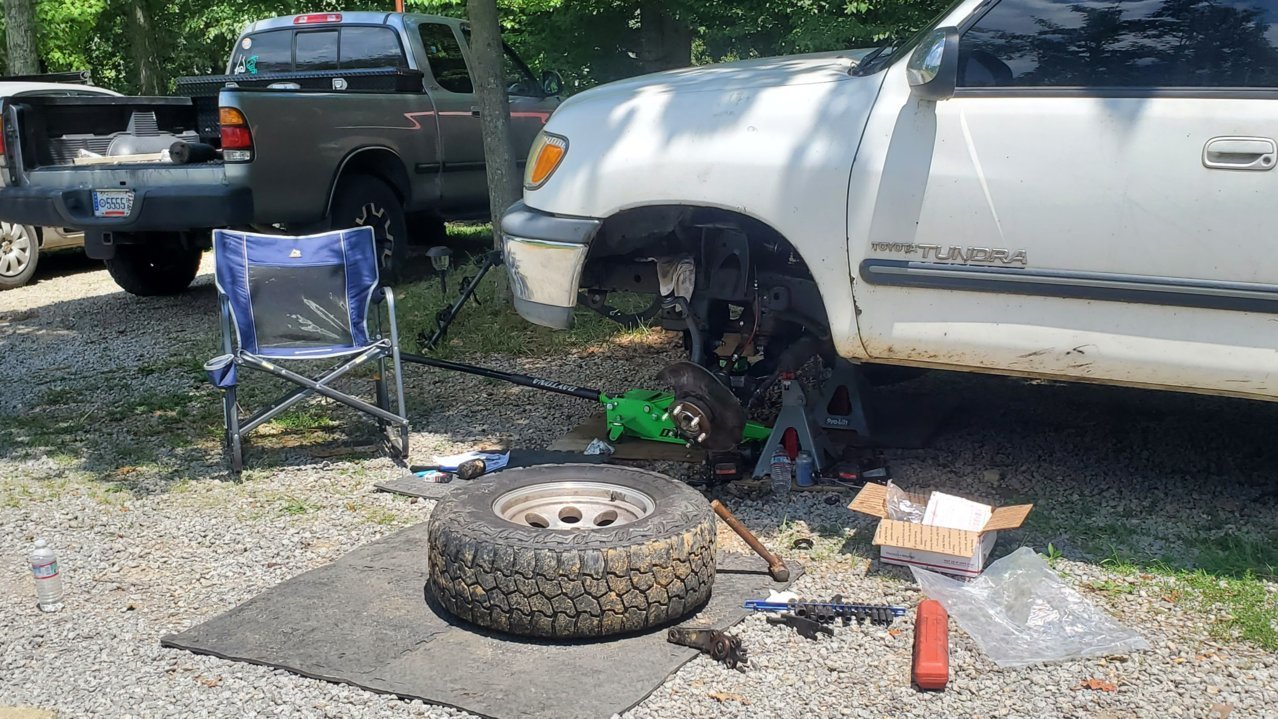

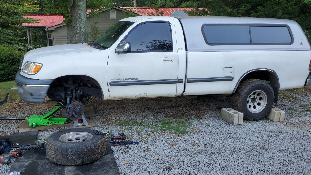

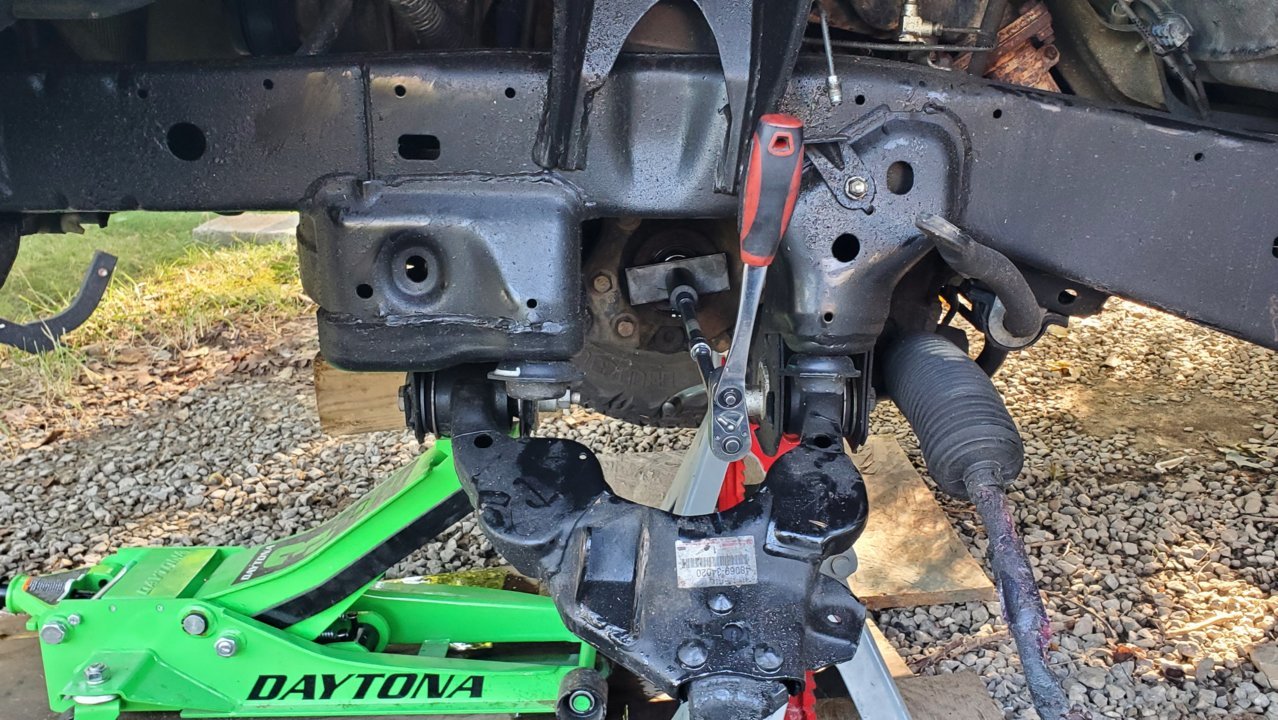

    Started working on the front end of crackie today with my Girlfriend Tabitha. We were talking, and working most of the day so I didn't get many pictures... Here's where we're at so far...
    This is driver's side only...
    • Drivers side was completely stripped except for the lower control arm because it was replaced by Toyota when they did the frame recall.
    • Old no-name lower ball joint replaced with OEM.

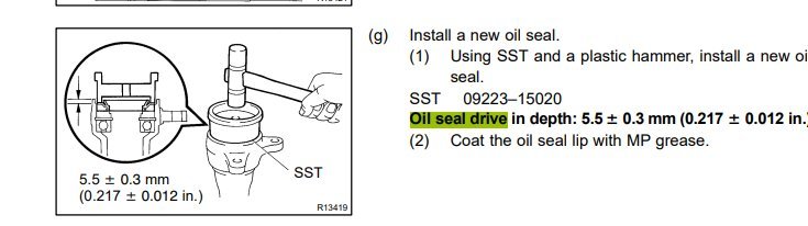

    • ECGS bushing, and new oil seal installed. Yuuge shoutout to @FrenchToasty!!! Yuuge!
    • New to me Junkyard CV axle installed without rebooting. (Later date.)
    • Old upper ball joint pressed out of the knuckle, and new SPC adapter pressed in.
    • Knuckle reinstalled. LBJ nut torqued to 103 ft.lbs. All four LBJ bolts torqued to 59 ft.lbs.
    • OEM upper control arm removed, and replaced with SPC UCA.
    • Wheeler's off road stainless steel brake line installed on frame side hard line.
    The plan for tomorrow??? Rip apart the passengers side, and take my shocks to a shop in town to have the tophats, and the coils replaced while trying to make headway on the driver's side brakes, and continue on the passengers side.
    More to come, pics included... ;)
    Daily first gen link
