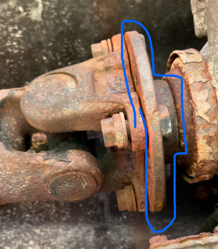

    Sketchy those bolts are already quite loose, eh?
  26. Jan 28, 2025 at 4:55 PM
    #56
    FiatRunner
    FiatRunner 2003 rich
    Nov 25, 2022
    #87321
    1,181
    Jack
    Chicago Suburbs/Milwaukee
    Very sketch. That was about a month after I got the truck- I was noticing tons of vibration, but it was making a weird squeaky noise. Literally the only thing keeping those nuts on was the rust on the studs. Tightened them down and it was good to go. Still no idea how they loosened themselves.

    So I just looked through my album, and yeah, I was wrong about all the "guts" staying with the front half. Aparently I have no recollection of the disassembly :rofl:
    It's really not bad imo, but you're probably going to want more than one day to get it done.

    You don’t want any residual oil on, in, behind, or near the crack. Steel not so much, but cleanliness is next to godliness when it come to welding aluminum.
    There’s a chance that the heat may damage the RTV that’s between the two case halves, but there’s only one way to find out.
