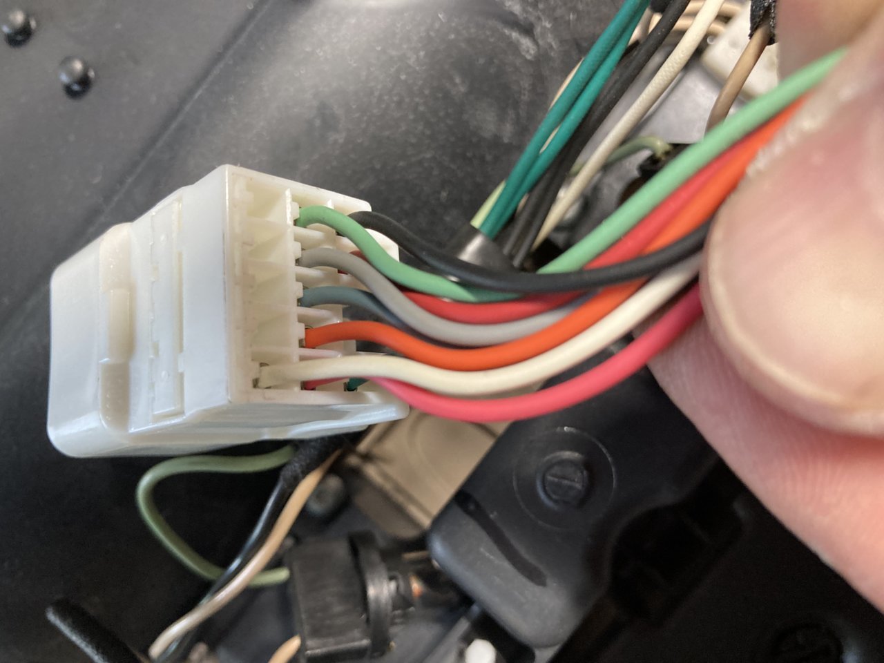

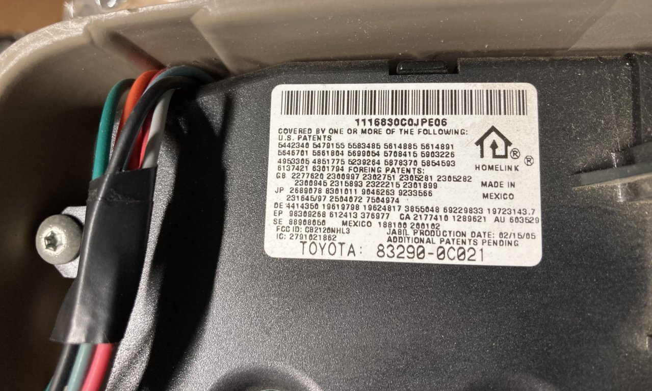

    Like you I have an 04 DC and my overhead console part # is 83290-0C020, it has been replaced by 83290-0C021. Even tho mine is equipped with moonroof, it will work even tho you have less wires than I do.
    Your plug and wire connections....

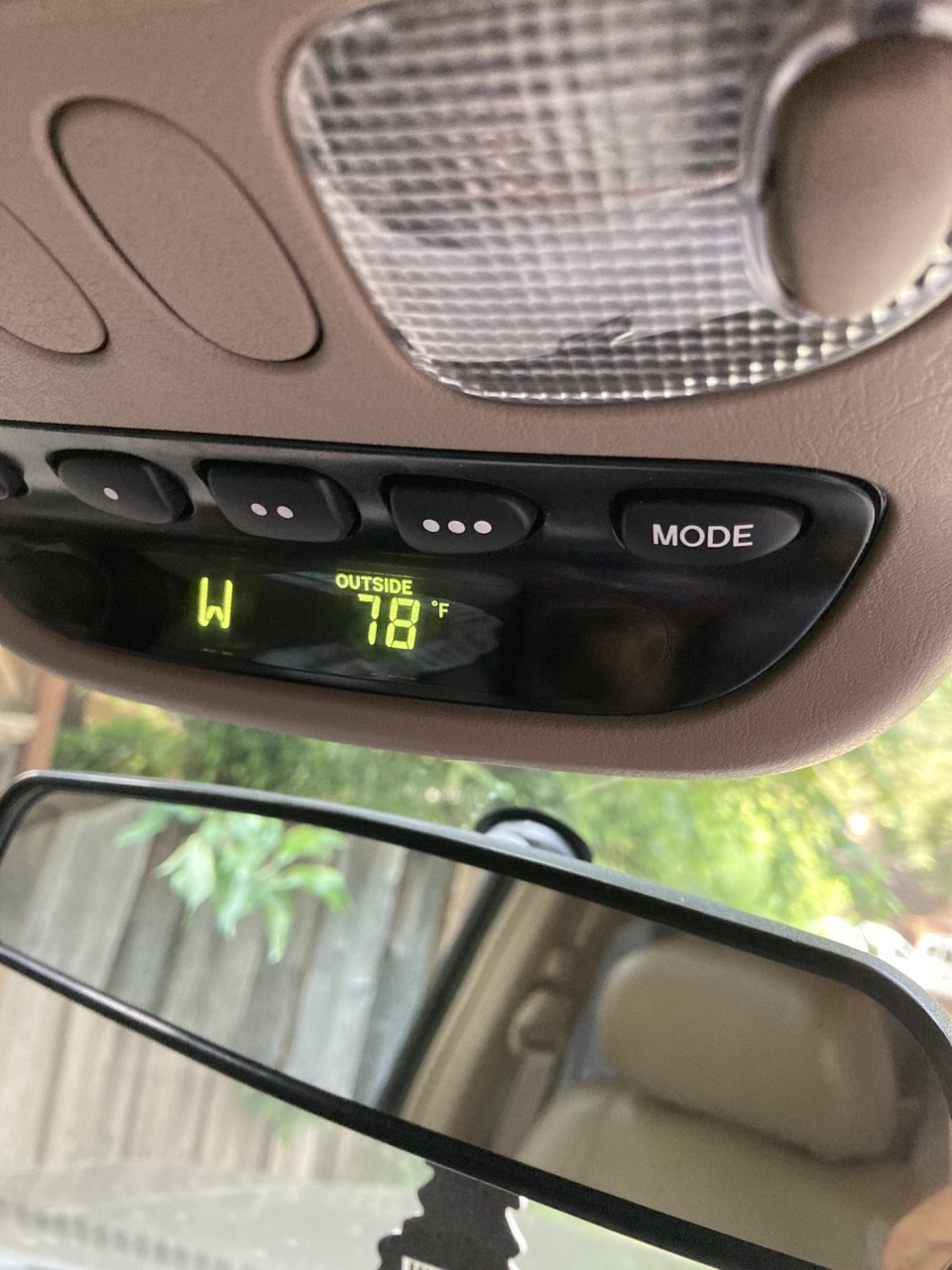

    Got a unit off eBay from o2 Sequia no sunroof,Ayer plugging in temp sensor in front passenger’s side next to horn seems to work great except I need to recalibrate compass, here are the pics of unit not needing wiring modification for my 04 Tundra double cab no sunroof,anyone know how how to recalibrate compass?

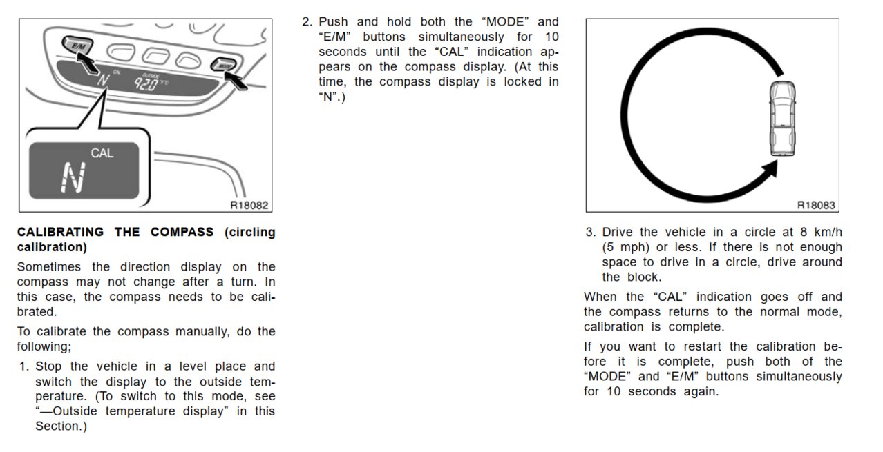

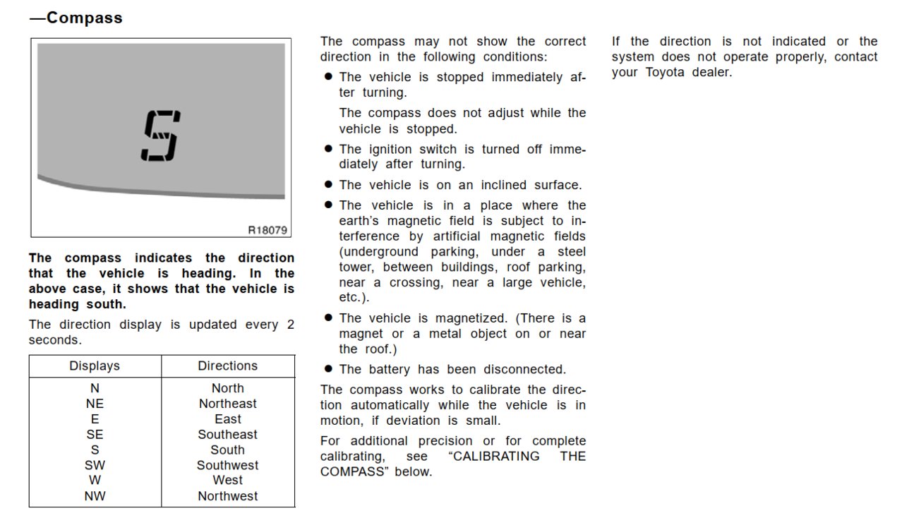

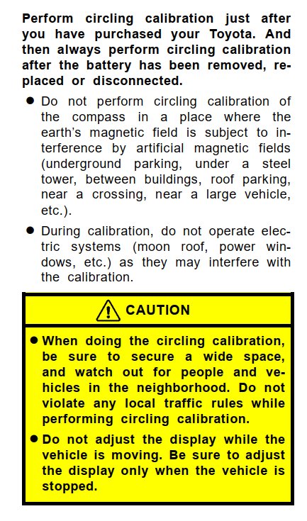

    Here, let me Owner'sManual that for you.

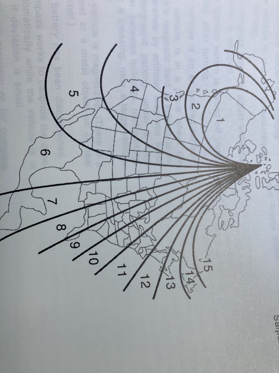

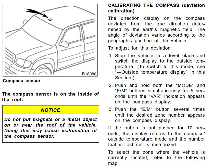

    So after installing new compass & temp display overhead console in truck ,the display unit was displaying incorrect direction ,so I had to calibrate or adjust the settings to do this press mode button display shows direction and outside temp in Fahrenheit ,press mode and E/M buttons at same time and hold until VAR appears then press the E/M button until the number that represents your location on this chart,this is the procedure for the unit I put in my truck 02 Sequoia ,precise instructions for your vehicle are located in your owners manual under compass ,here is the location chart ,I am stoked with my upgrade total cost for this project was $67.00 cost of unit on eBay plus $14.00 for ambient sensor,all plug and play no modifications I am stoked 52ABC9A0-22FA-4B5A-810E-DE29910C4A65.jpg

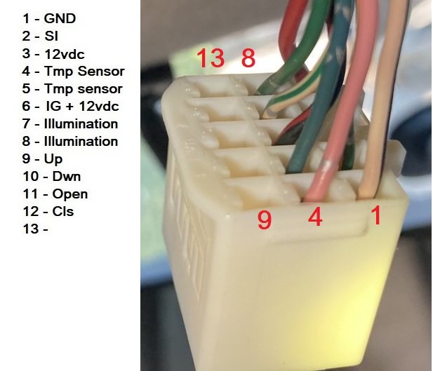

    This is a long shot but do you remember the color of the wire?

    Ground wires are quite often white with black stripe on our trucks.
    Wiring colors vary wildly between years and cab types, so his 2005 is likely not going to match your 2000.
    Go to THIS POST, look 4-5 lines down into the 1st post, you'll see a series of links to factory service manuals, electrical wiring diagrams (EWD), keyless entry programming, etc. Grab the EWD for your year.
