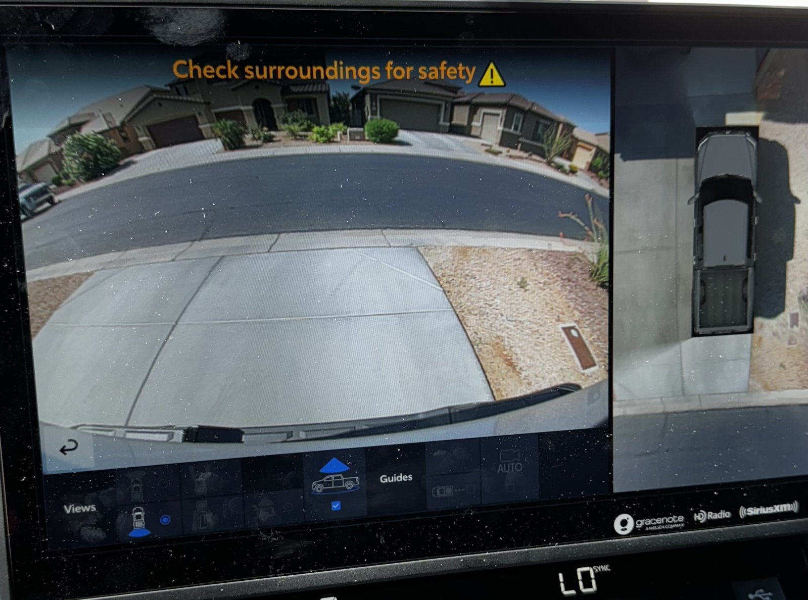

    Well, welcome me to the club.
    Backed up yesterday and noticed no lines on camera.
    Camera view screen looks like photo that swageit posted.
    Another thread for the same problem: https://www.tundras.com/threads/fixed-trailer-backup-guide-camera-errors.133688/
    Seems most people had this problem early on. It took 15K miles before it showed up for me.
    Also looks like a not so uncommon problem for 2024s.
    Many complain it happened after heavy rain or car wash.
    Might be the genesis of my problem as it has been raining here nearly nonstop for a week.
