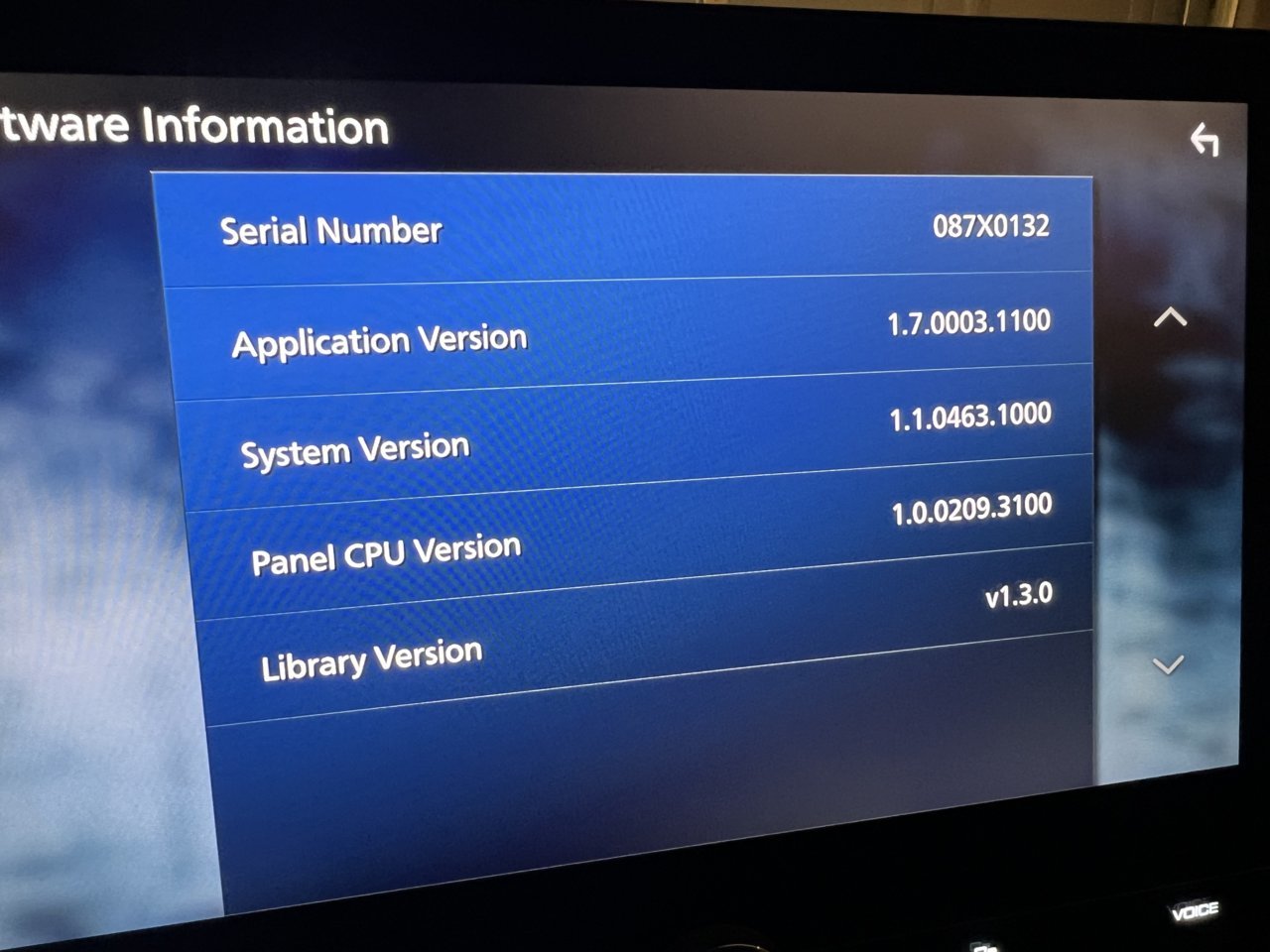

    I'd love to say updating software was easy...haven't figured it out yet. Garmin Maps on 1007 even worse. The Kenwood dealer said they would update software for me if I drove the truck over there.

    For some reason, mine unzipped to a folder in a folder so the unit did not see it. I cut & pasted the folder out to the top of the drive & it updated.

    Finally got it done...Maps not firmware

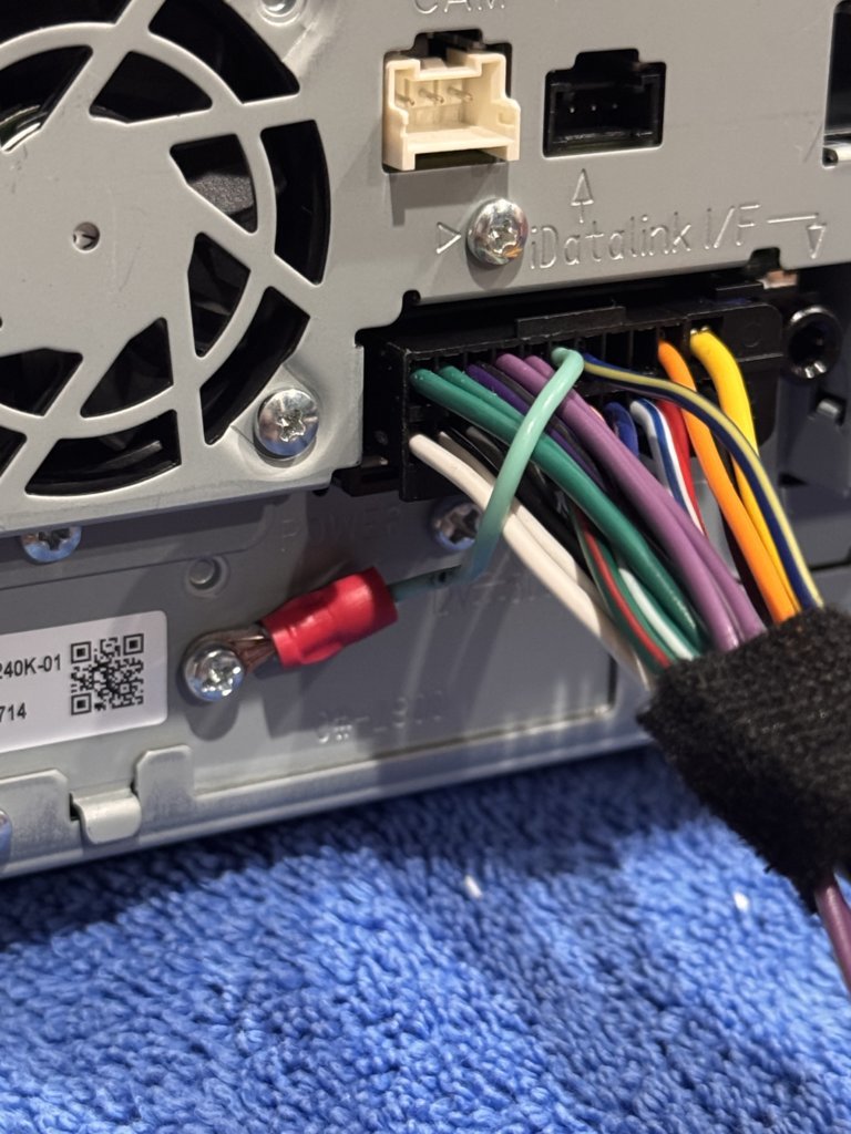

    How do you ground the brake wire?
    I installed a 1057xr last night to test out the wiring/speakers and amp. Everything works, but before I stuff wires and put the dash back together, I am wondering how to ground. I used maestro harnesses and don’t see a speed sensor wire. Is it already grounded with the maestro harness?

    found the green wire in the harness and ground it to the headunit.
