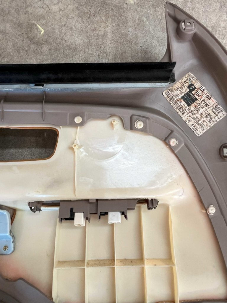

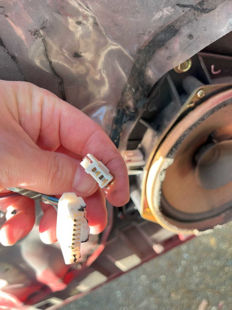

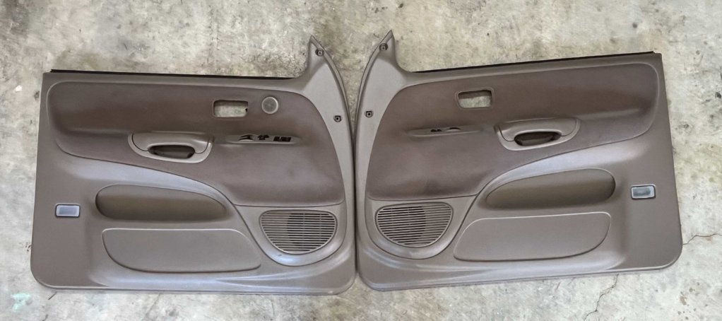

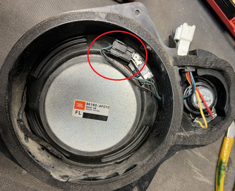

    Driver door wiring harness.jpg Driver Tweeter connection.jpg Lower speaker connection.jpg Passenger door close up.jpg Door Fronts.jpg I finally got some good weather and a few minutes to pop off my door cards. The driver side door was def replaced, and they absolutely did the craigslist rebuild on it. The tweeter hasn't been hooked up since we have owned the truck evidently, and the door light was never plugged up either. The vapor barrier was just hanging half off, and there is no pigtail for the tweeter.

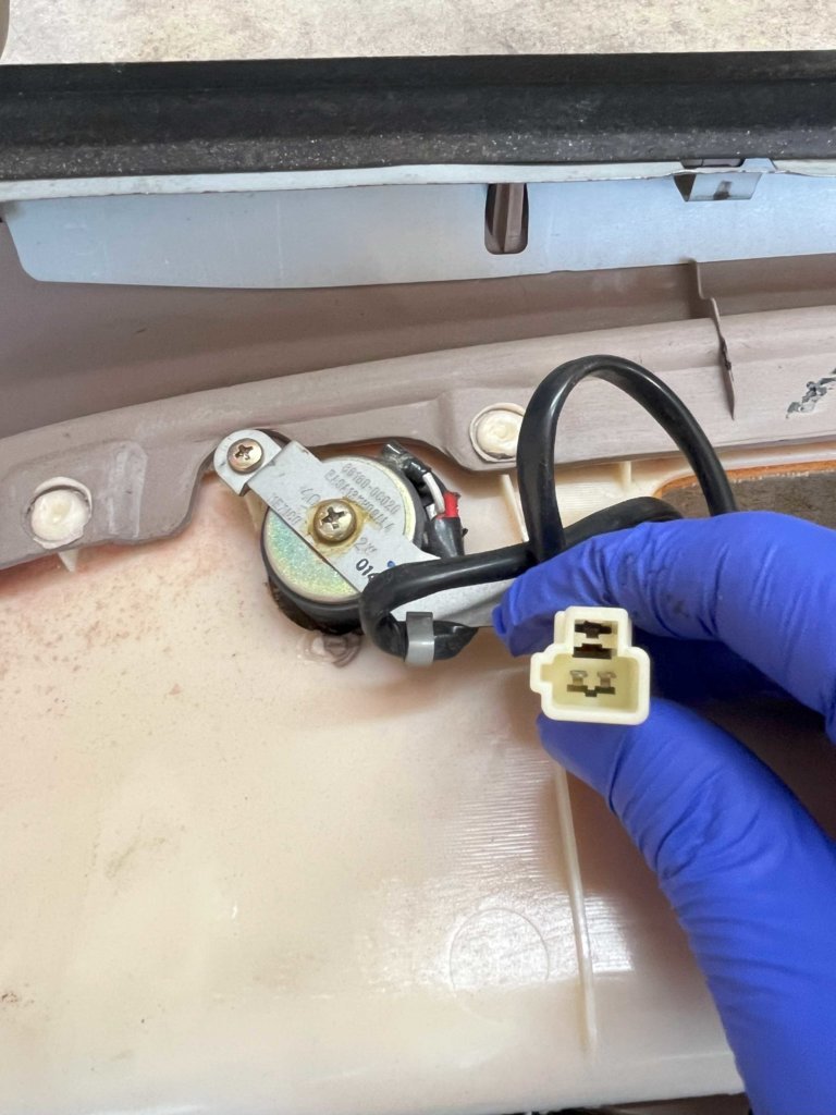

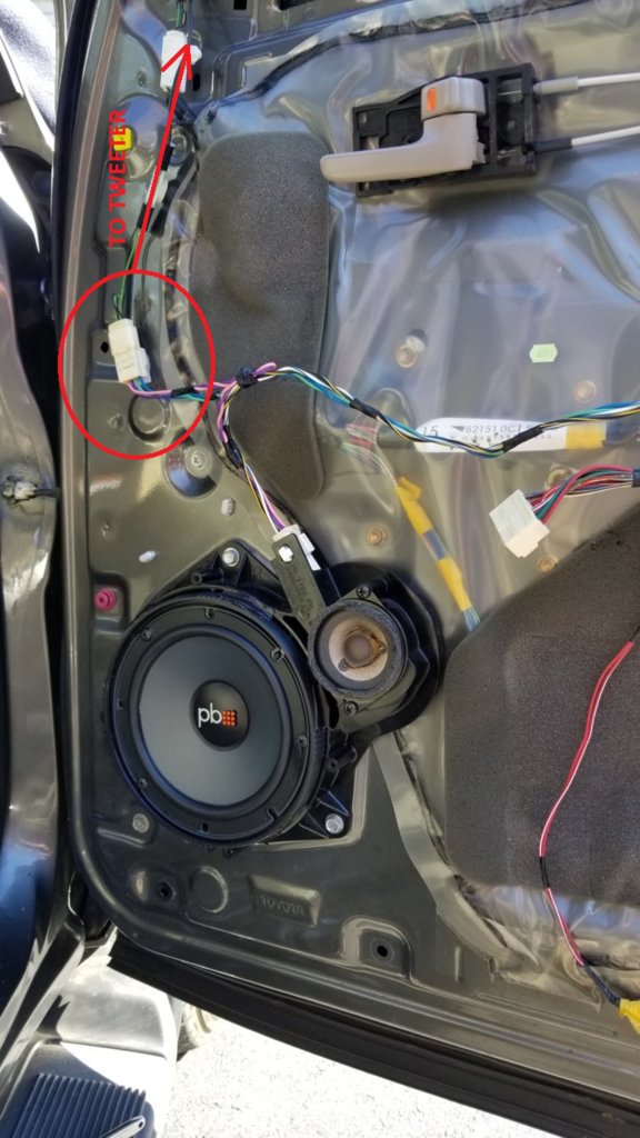

    With that all said, and with not having the factory harness port for the tweeter, would it just be easier to run new tweeters into a crossover into the new head unit?
    The passenger side door does have the tweeter bracket mounting holes. Looking up prices for just the passenger bracket, the prices ($35-40) are more than i can get a used door card ($20) (if i can find it in my color at u-pull-it). Has anyone replaced the stock tweeter cover with an aftermarket? I'm afraid the aftermarket tweeter mount would be smaller than the oem, and look less than ideal. But also, i've had the truck for 5-7 years and didn't even notice the passenger side never even had a tweeter in the door. I guess i could just drill a hole and spray paint the aftermarket cover to match as best as possible. Or do i just say, screw it and put in 3 way 6.5's in the door.
    I would like to fix the vapor barrier (New or can i patch it up with some thick plastic and flashing tape).
    The Metra 72-8104 adapters look like the right adapters for my stock lower door speakers. But i won't need tweeter harnesses adapters since i don't have them on either side.

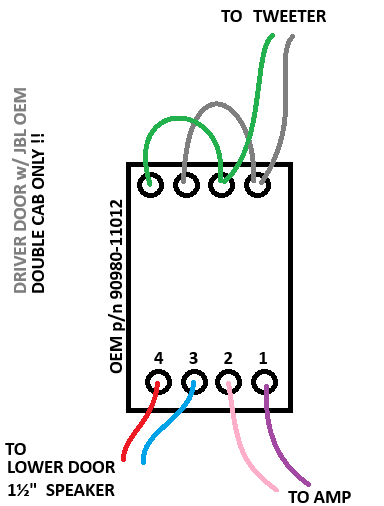

    Since the OEM speakers fork at the connector into the door, I'd probably delete the Y-cable to bring it down to a single speaker pair, use the Metra adapter to fork that out w/o cutting the factory harness, then buy a good pair of components for the door that include a crossover with 1" tweeter and a 6.5 or 6.75" woofer.
    • Install the metra connector in place of the Y-harness
    • Run that new pair of wires to the crossover
    • Wire out of the crossover to the tweeter and woofer
    Regarding the passenger door...
    • Drill the passenger door in the appopriate location with the same diameter hole as the driver door
    • Install the tweeter in the door using the supplied basket from the speaker manufacturer you chose
    • Enjoy the new sound.

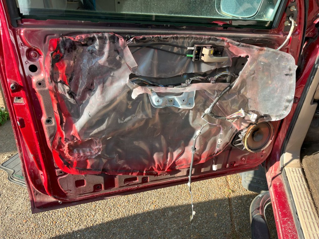

    I can only offer what I chose to do when I was installing new speakers and new leather on door cards.
    I removed all the old butyl gummy tape and cleaned the left over with acetone. Napa and other auto, local hdw stores sell butyl tape. I chose NAPA's glass butyl tape for Automotive, comes in 15' roll and 5/16"....same as original. As for plastic, I chose to replace with 6 mil clear that I had and that most Hdw stores carry. Wanted to be one and done for many years to come. Given as it helps as not only a noise barrier but makes the door a contained structure so that the water can only go down and out the drains at the bottom of the door, without it there is a gaping hole the water can get into the car through.
    G_unit3000 and shifty`[OP] like this.

    Fantastic. I'm about to order my audio stuff, and the Butyl tape and clear vapor barrier. I may try to scrounge around and find the factory push plugs that go into the vapor barrier without breaking it as well. All of mine are trashed. Thanks for all the tips and tricks. Looking forward to being able to enjoy the audio!

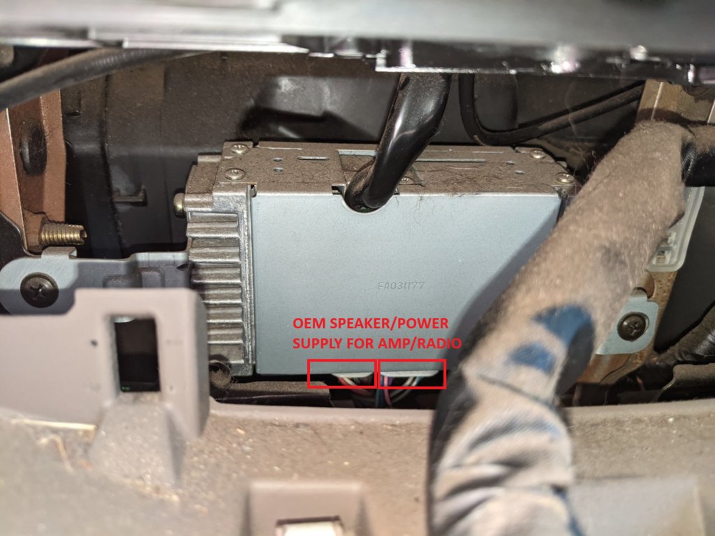

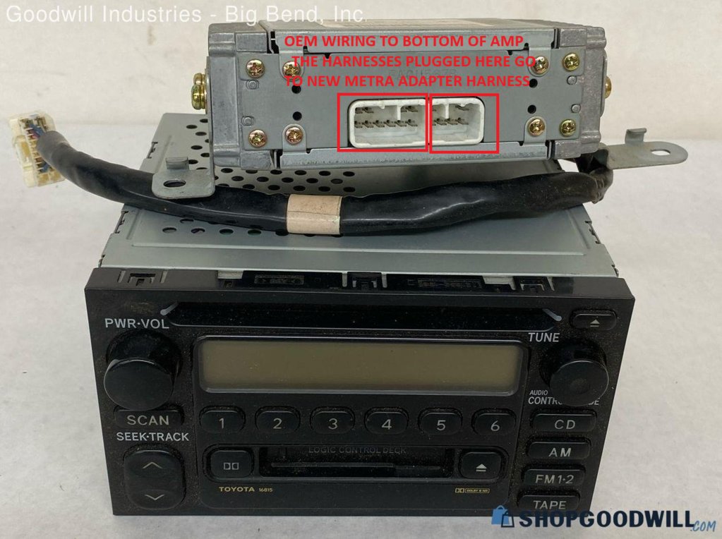

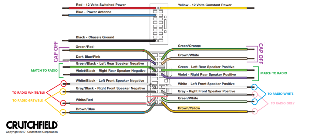

    It would be super helpful to know: It appears you have the RC truck, Regular Cab, correct? (I assume the "SC" in your Vehicle Info is maybe for ... Single Cab?)
    Beyond that...
    • Have you confirmed you have the factory amp? Which should be in the dash, HERE.
    • If you do have the amp in the dash, that is the location for the 2001 AC and RC trucks, it'll have two connectors coming into the bottom of it, note the two harnesses at bottom of the amp HERE.
    • Referencing THIS PIC, removal of the amp is optional, but you need to (1) unplug that black bundle that goes up to the rear of the OEM radio, which likely requires you to pop the OEM radio out* for access to the connector, and (2) pull those two red-boxed white connectors at the bottom of the amp and plug them directly into the Metra 70-1761 radio harness you've purchased from a reputable source
    If you're smart, before you even start the steps above, you'll graft the Metra harness onto your aftermarket radio harness, outside the truck, BEFORE you start this process, so it's plug-and-play ... and you won't do any really stupid shit like: Using wire nuts. Twisting the wires together and taping. Crimping with beans.
    The proper way to terminate wires in your harness is one of three methods:
    • Solder and heatshrink (see video below)
    • Butt splices using proper crimpers (like this, avoid these all-in-one pieces of shit, and ALWAYS tug-test each wire pair after crimping)
    • Crimp caps (like this), though they tend to take up a lot of space
    If you have a soldering iron and intend to use the first bullet see this video. Don't listen to people out there who say stupid shit like, "But solder joints will break with vibration!!", it doesn't happen if you twist your wires as shown in this video, and flow the solder into the twist in as Mark @ CAF does in this video. Just remember to slide your heatshrink onto the wires BEFORE you start soldering ;)

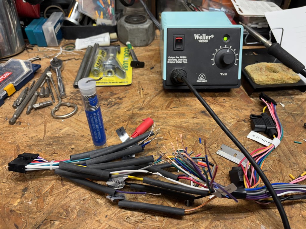

    And since I had to knock a harness out for my parent's "new" Jeep JK, just for the record, I do practice what I preach :D
    (and my shop bench consistently stays messy af)

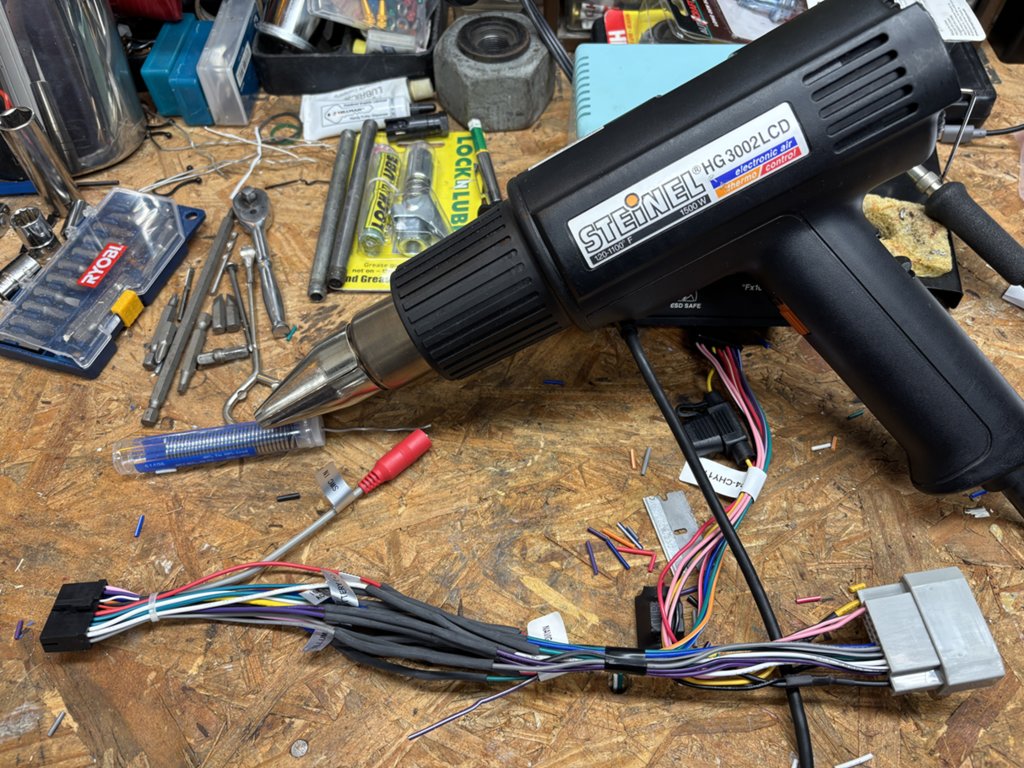

    Former hardcore GM guy here. I get it.
    They're misinformed. See below pics. Hopefully it'll give you a crystal clear idea of what's in your dash. The setup you see here is what was used on all in-dash amplifier systems for 1st gen Tundras.
    Note the position of the big black wire sleeve throughout the three pictures. Also note, the OEM RADIO (1st pic) has two inputs on the rear. The right-hand input is for trucks w/o amplifier, IIRC. Toyota sets many of their earlier OEM radios up with two different rear plugs, one for amplified, one for non-amplified. It has zero impact on your install, but maybe it's interesting to know why there's an empty harness plug-in on the rear of the OEM radio.

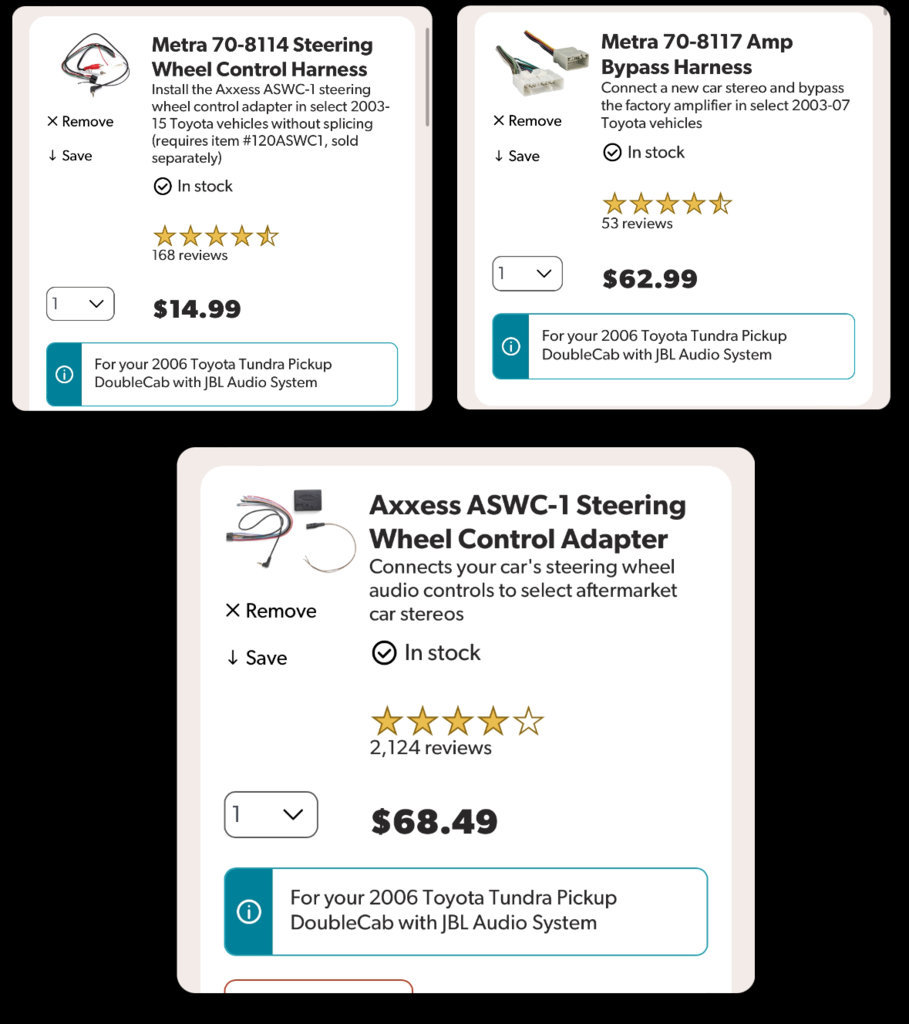

    @shifty` Hello, I'm new here. I recently acquired a 2006 DC Limited with the JBL Navigation. I have a few very specific questions and I'm really hoping you know the answers.
    First though, THANK YOU!!! The amount of info you have posted is impressive AF, but more than that it's the quality of your posts that really stands out to me. You're very knowledgeable, you explain things very well and I can't tell you how much I appreciate that. Anyway, here we go. As I said, DC limited with the JBL Navigation. I really love the truck but not having an aux in or bluetooth is just not going to work. Short version is I don't want to replace the HU unless I absolutely have to, in large part because my hearing is fairly well nuked. Whether it was the years of dove hunting without ear protection, or my suburban in high school with 4 15's in the back, my hearing is not what it used to be. Replacing the JBL system for improved audio quality is likely to be a waste of time and money for me because in the end all I'm looking for is a way to listen to my music without having to burn CDs like it's 2003.
    So from my reading and research it seems that the JBL navigation HU sends only one pair of left and right audio to the amp. The HU then uses two wires for data to the amp to change the sound output, such as fade and balance. So finally here's my two questions:
    1 - Is the audio pair that the HU sends to the amp analog or digital?
    2 - Does the HU itself actually vary the gain of the audio to the amp to control the output volume, or is that information also sent to the amp over the data lines? Or put another way, does turning up the volume knob on the HU increase the audio output TO the amp, or does the HU send a signal over the data lines and tell the amp to increase the output volume?
    Thanks in advance for any info you can share, and not just from Shifty!

    I think I found my answers, which is really frustrating. I put in quite a few hours searching for info and answers only to find them BOTH less than 30min after I had caved and made the above post.
    To anyone who finds this thread, I'm pretty sure the answers are as follows:
    1 - Is the audio pair that the HU sends to the amp analog or digital? Analog, probably. In another post Shifty observed that the HU audio output to the amp is shielded, which likely denotes low-level outputs. And though he doesn't specifically state this, I assume also analog.
    2 - Does the HU itself actually vary the gain of the audio to the amp to control the output volume, or is that information also sent to the amp over the data lines? Or put another way, does turning up the volume knob on the HU increase the audio output TO the amp, or does the HU send a signal over the data lines and tell the amp to increase the output volume? Yes, very likely. In helping someone trouble shoot an install with an aftermarket HU using a PAC TATO, Shifty notes that the JBL amp "has internal stepping that happens in relationship with the JBL radio". I read this to mean that the HU output stays constant and instead the HU sends data signals to the amp and the amp varies the output volume.
    https://www.tundras.com/threads/poor-audio-quality-kenwood-head-unit.152372/page-2
    And so to the reason I was asking these questions in the first place. I am fine with the factory JBL HU, the amplifier and even the speakers. I'm not fine with no way to input my own audio, that's just not going to work for me. A few months ago I had been playing with some some bluetooth receivers, they actually will work a transmitter or receiver, and they have a few specific behaviors that I really like. They are tiny, low power, have good range that can be extended significantly with a small external antennae, can give specific devices connection priority AND it doesn't have any annoying beeps or computer voices to announce that your device has connected. These aren't plug and play though. The pads on the board are spaced 1.27mm apart, which is half what I consider "normal" size and makes soldering a PITA for 47 year old eyes and shaky hands. You also have to use a USB to UART cable and send it AT commands, THAT was fun figuring out. I have no background in electronics and I can grasp just barely enough to fumble my way through by trial and error. I got mine from eBay.
    https://www.ebay.com/itm/266838482907
    All that to say that I believe because of the way the JBL audio system works, that I should be able to intercept the audio output from the HU and switch to the output from one of these bluetooth receivers instead. The HU should still be able to change the volume, fade and balance. So everything looks factory and original, I can still switch back to the radio and the steering wheel volume controls still work as normal. It might even be possible to use the "next" and "back" buttons on the steering wheel, though not sure how I would do that just yet.
    I will post the results, good or bad.

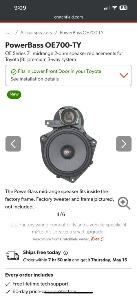

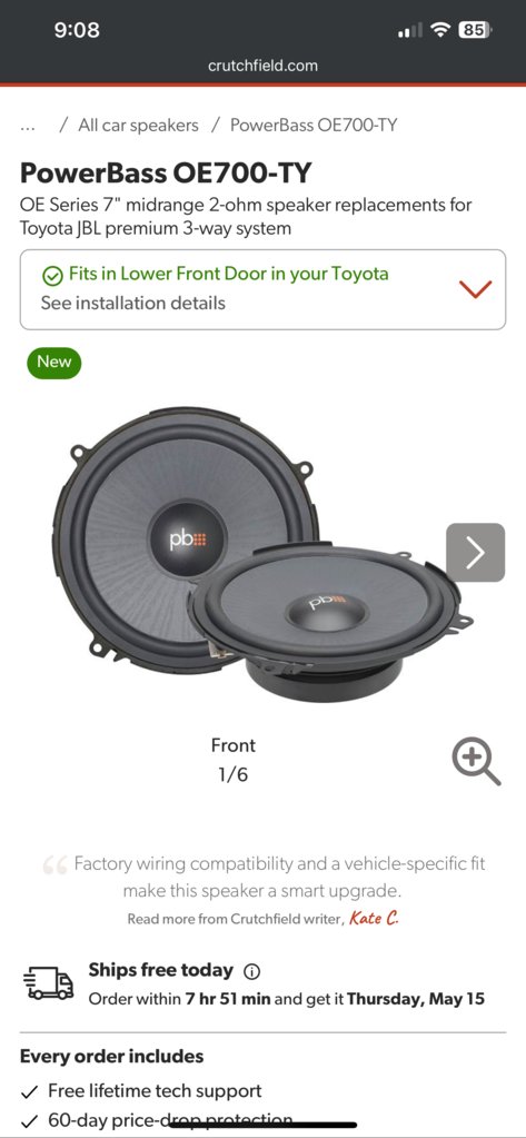

    Okay so I finally got around to doing my speakers because you know, life has gotten in the way a lot. I get everything open and my front door speakers are not six and a halfs. They're bigger... And I'm not sure if they're going to be 6 and 3/4 or what at this point because crutchfield doesn't say anything about it.
    Update, not 6 3/4 either... Bigger. Idfk

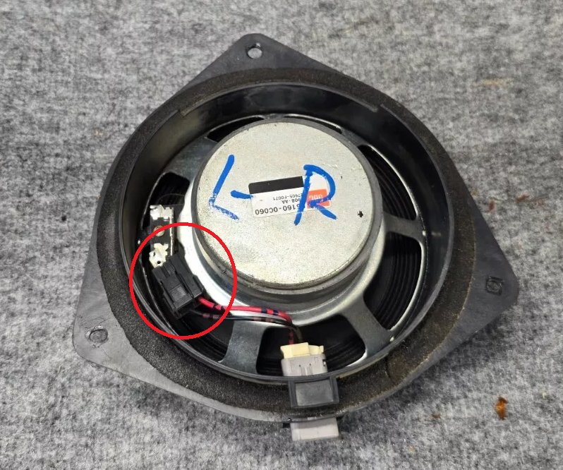

    Double Cab OEM housing (those with the 2-speaker lower housing) will fit up to 7" drivers. But in using 7" drivers, the outer rim of the one 7" mid on the market I'm aware of sits about right, but the mounting holes won't line up. Rear door OEM housing fits 6½", from what I'm seeing, but again, holes may not line up.
    Unfortunately, for the front, because the diameter of the rim of the 7" driver and the OEM plastic housing don't line up properly, you'll need to make your own holes to get a 7" to install. If you opt for a 6½" or 6¾" mid in that hole, you can use the adapters which come with the aftermarket speakers to fit things in. Just note that, while some speaker manufacturers claim they're a 6½" mid, the actual cone and driver on quite a few are more lik 5¼".
    A couple of companies make a replacement bolt-in speaker housing for the front doors of the DC 1st gens.
    • Scosche claims to fit 5¼"-6½" drivers with their SAT6 housing.
    • Metra claims to fit 6½"-6¾" with their 82-8153 housing.
    • American International also makes a part that fits 6"-6½" but I'm not going to link it b/c I've never seen anyone use it.

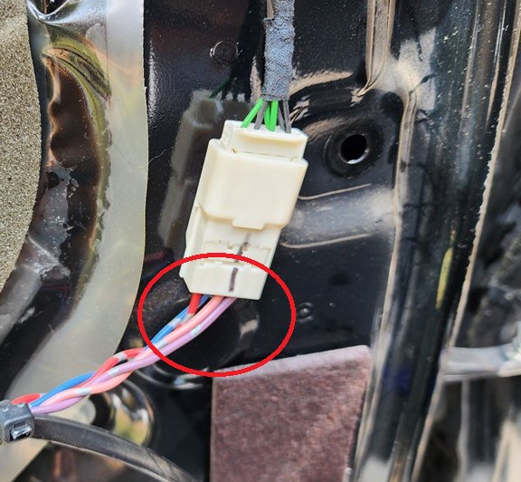

    Note that all three options technically delete the smaller 2"(ish) driver that's in that 2-speaker lower door housing. Which, in theory, is fine, because you'll get better sound stage having your mid down in the door and using the sail paner tweeter higher in the door for sound.
    If deleting that lower speaker, I would go to this specific connector up near the tweeters, and find which of the four colorful wires (i.e. not the green and black wires) are feeding down to the 2"(ish) driver's housing, and de-pin the pair (in this case, it'd be the red/blue pair) out of the white connector, then pull the wiring, since you won't be using it any more. By de-pinning, you effectively delete the lower speaker and can re-install later if you ever wanted to roll back, just keep the wiring with the speaker housing. (I'd love to get my hands on a pair of OEM housings)

    I don’t need to connect this to anything right? This is just if I wanted to connect a backup camera or have certain features in the head unit be locked while vehicle is at speed.
    The reason I ask is my truck DID NOT come with a radio from previous owner. So I’m not sure if that was something that is supposed to be plugged in somewhere. The harnesses back there look fine and not mangled. I believe the previous owner was going to install something. I’m guessing they probably failed at bypassing the amp and gave up. I negotiated a bit off the price due to not having a radio, and I planned on putting in a carplay unit anyways.
    I attached a picture of the 3 harnesses I plan on getting. I have double cab with jbl amp and want to be able to use steering wheel controls. Are these 3 still the best option? I’ve been reading up on your old posts from 2-3 years ago @shifty`
    Now just time to decide on the actual unit itself. I read that kenwood/jvc sometimes struggle to work with the Axxess solution, so I’ll avoid those two brands.

    If you’re asking about the 2-wire/5-pin grey connector, nope, doesn’t need to connect to anything unless something wants speed readings or reverse trigger for some reason.
    Those are the 3 harnesses I’d buy with the vehicle you’re describing, if it is bone stock. I’d make sure to check if they’ve upgraded speakers or anything already, make sure both plugs are attached to the OEM amp, and make sure they haven’t cut into the OEM stereo harness anywhere.
    Lucky2[QUOTED] likes this.

    You could probably find someone on here that had JBL in their vehicle with theirs that they'll never use, and maybe would give it to you for shipping. Here's the part number for JBL with navigation and DVD, and I know the Toyota p/n 86120-OC140 was one of the JBL receivers for Tundra & Sequoia '04-'07.
    RE: Doors, you really would only need to inspect behind one front and one rear, and it's potentially overkill, I'd just want to arm myself with that info, know what I'm up against. If the OEM drivers are still intact in the doors, I'd potentially wire the amp bypass a bit different. The double cab JBL speakers are wired as follows:
    • Front door tweeter and ~2" lower-door speaker: Each speaker is 4ohm, but wired in parallel (bridged at the 4-pin connector ~7" below the tweeter with black/green wires) to make a 2ohm load to amp
    • Front door mid: 2ohm driver
    • Rear door mid: Fairly certain this is a 2-ohm driver also
    If someone did update the OEM speaker, they'd probably install 4ohm drivers. It won't impact the first pair in my bulleted items there. But the front door mid and rear door mid would be half the load, and installing aftermarket without changing anything else on those two doors specifically would likely make things sound a bit muffled, unless the person swapping them out was smart enough to swap in 2ohm speakers. JBL and PowerBass have both, within recent years, made 2ohm drivers to fit our trucks, and I know someone whose previous owner installed them).
    Lucky2[QUOTED] and G_unit3000 like this.

    Just to expand on this, for those who still run the JBL speaker setup with the amp like myself, Crutchfield is now offering an updated version of the 2 OHM PowerBass OE700 (now with the p# extension -TY) with new basket mount holes to directly mate up to the factory OEM speaker housing in Tundras and Sequoias, along with supposedly having OEM style speaker terminals on them as well, eliminating the need for the metra harness (at least on the woofers).
    PowerBass must've had enough complaints about the fitment on the originals that they decided to update to give it a true drop-in style.
    These actually dropped on CF just in time for me (I refoamed my woofers recently but didn't center the cone properly with the voice coil on the passenger side so it constantly rattles, oh well, I'm done messing with those) I have a pair coming this week and will update on the fitment.
    https://www.crutchfield.com/p_151OE700TY/PowerBass-OE700-TY.html

    Is there any good write ups for wiring the double cab? I looked a bit and didn’t see anything super comprehensive yet.
    Appreciate this information. Could very well prevent a future headache.
