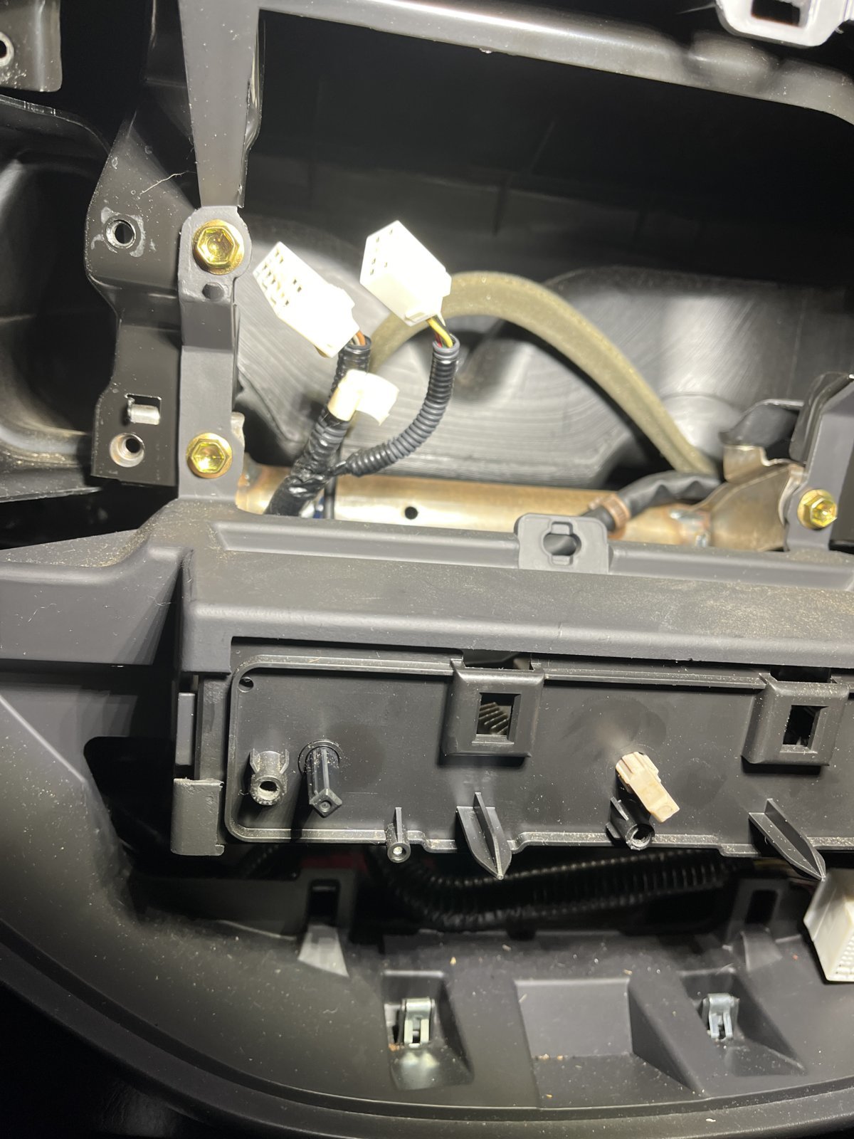

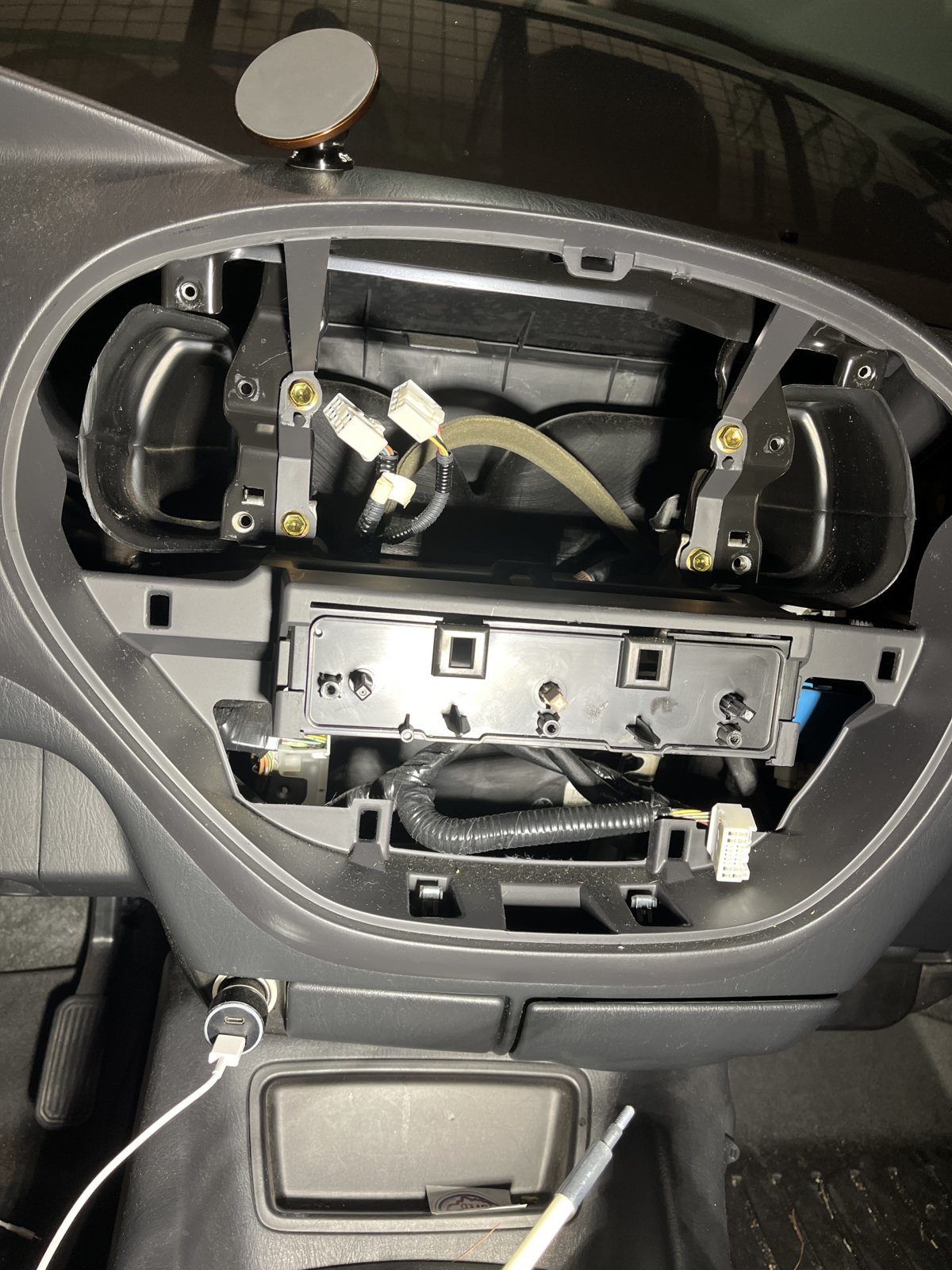

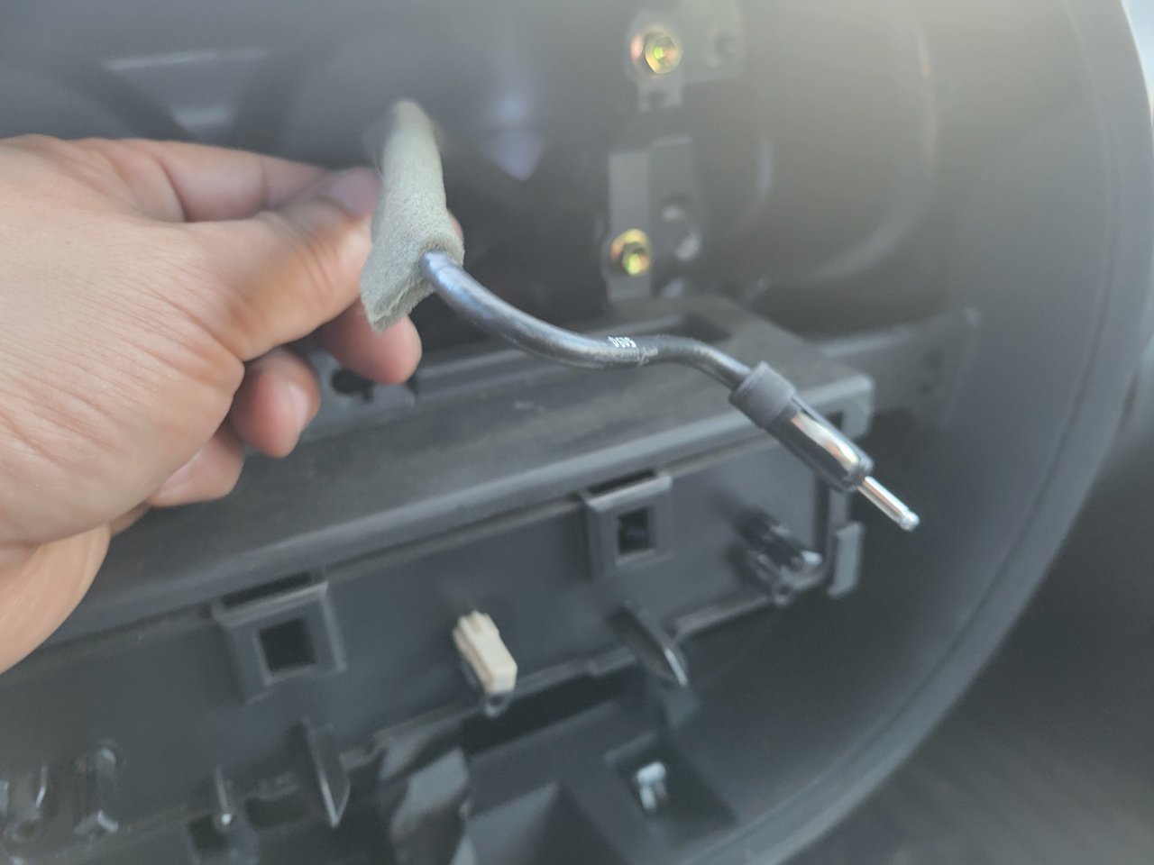

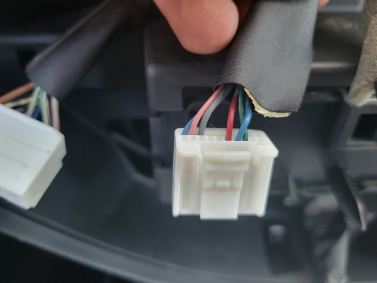

    Hoping that maybe someone can help with some questions/issues I'm running into with my stereo install...
    I'm installing a Scion headunit in my 2005 AC with a non-JBL/amp in rear system. I've been reading up the posts from @empty_lord and @assassin10000 as well as the links to other forums and bought the necessary harnesses (I think). Here's the issues I'm running into...
    - First, I only seem to have one antenna plug and from what I've been reading, I should have two. The original headunit has inputs for two plugs.
    - I bought the base harness kit off ebay and it included the 20 to 28 pin harness, USB harness (useless), and the antenna adapter harness. I also have the 2 into 1 antenna plug splicer and the small. I'm not interested in Bluetooth calling so am skipping that adapter and will replace the USB adapter with one that is more functional. Is this all I need in regards to adapters/harnesses?
    - I have two wiring harnesses coming out of the dash: a 20 pin and a 6 pin. I'm able to connect the 20 to 28 pin harness but can't figure out the antenna adapter harness. This harness only has a 10 pin for the headunit side - it does not have the 6 pin for the headunit side. The truck side of this adapter is a 10 pin which doesn’t match the 6 pin coming out of the dash. Should this adapter also have the 6 pin plug/harness or do I need another harness? Part of me thinks that the amp wiring is throwing me off and I need the Metra 70-8121 harness. What do y'all think?
    I've included pics of my single antenna plug and the 6 pin plug that I'm not able to match up with...
    Lots of great info on this thread! Thanks in advance for your help! 20230425_170611.jpg 20230425_170548.jpg

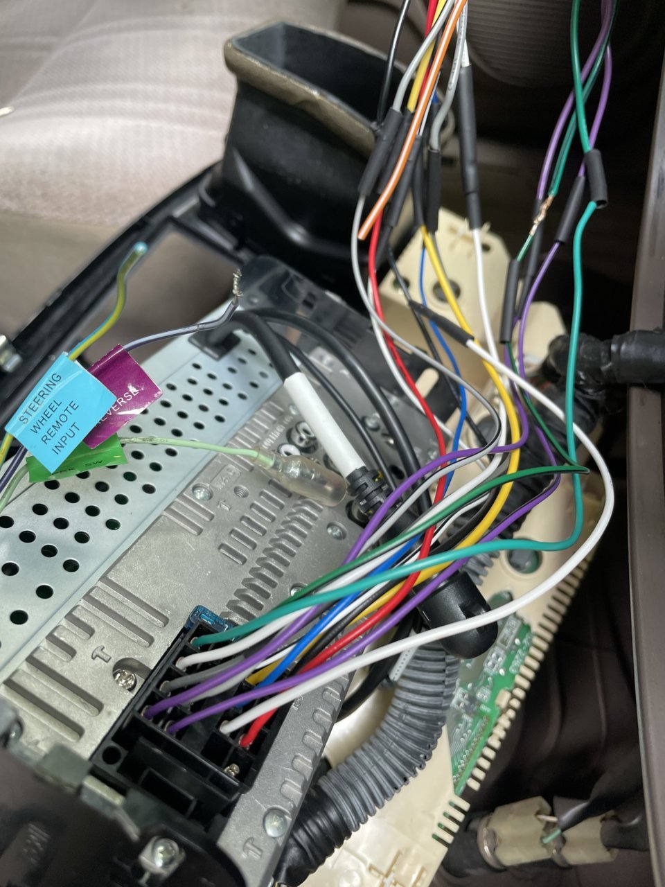

    I'd need to see everything laid out as I show above to spot any issues. It is weird that you'd get no sound on any speakers if the Metra harness you used is color-matched to the ATOTO harness as you see on the harness I linked above (although it's not tied to an ATOTO, ATOTO should be using industry-standard colors on their harness, or at least I would expect it!)
    That's why I went to verifying audio source, volume level is up, mute is off, balance/fader are centered. But you know, ATOTO is sort of shitware Chinese garbage, it's entirely possible teh unit is defective and its integrated amp is defective...
    Can you snap a photo of the harnesses, and confirm 100% you've fully seated every harness? I mean, the fact the rears and fronts are each on different plugs into the amp ... that makes it damn near impossible to be a bad connection there.
    It's not hard to blow an integrated amp, if a couple wires arc together because they're not crimped or sealed, as you put it.

    I’ve done enough dumb shit to know to look out for the dumb shit lol…made sure the volume was up, mute off, played with the fader, etc. Also tried multiple sources (radio, Bluetooth).
    Pretty certain I didn’t arc any wires. The heat shrink is on there pretty tight even though it isn’t sealed and I was careful not to let anything touch.
    Here’s the pics of my harnesses. I had to by a radio harness off eBay. The only thing weird was the red and yellow was switched (referenced the pin out in the HU manual before I wired it) and there is no orange Illum wire.
