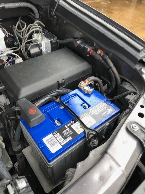

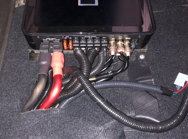

    I don't see how it would work without having a constant battery feed.
    Running a line isn't too difficult.
    Several threads on how to do that, most from those running amplifier lines to the battery.
    I already had run a few wires thru the firewall grommet.
    Including an overkill 0 ga for my amp...:D
