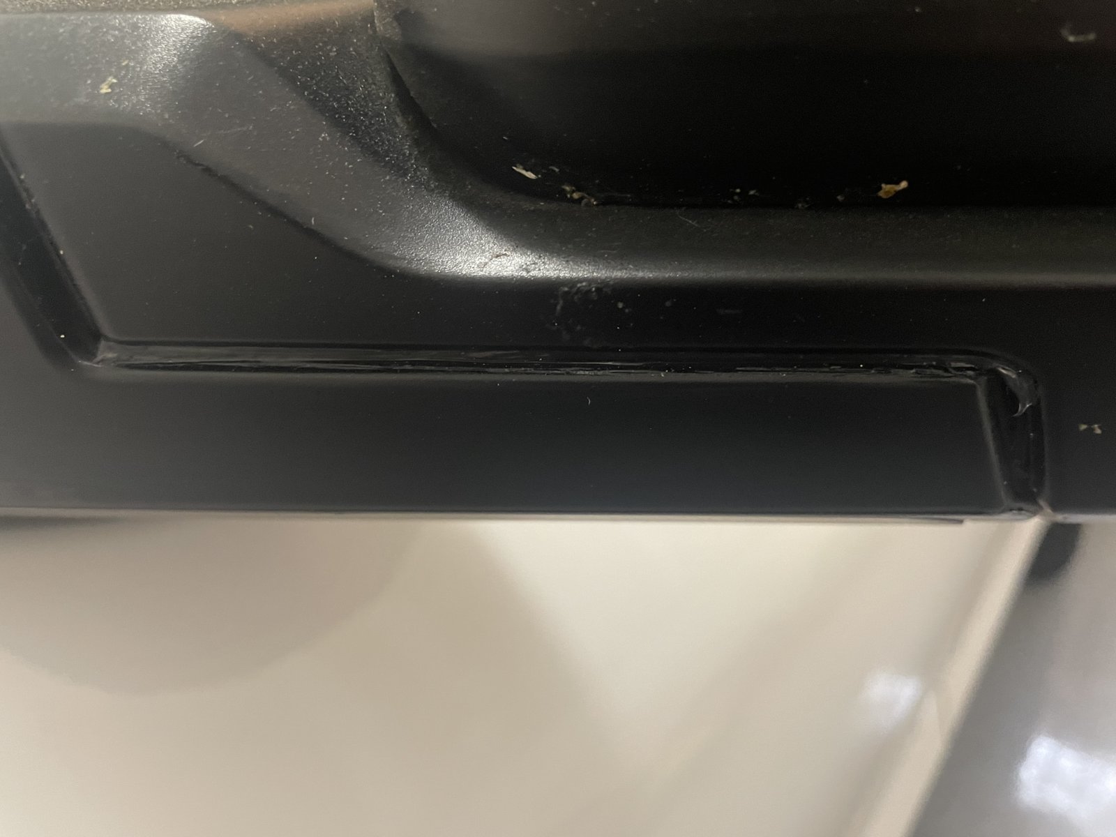

    Thank you so much! I just slapped a piece of clear packing tape right where you showed and for the first time in 1.5 years my truck is dead quiet on the freeway. No whistling or wind noise at all. I never would have thought the noise was coming from this strange spot underneath. THANK YOU

    UPDATE: I put black electrical tape on the same seam that Jeff shows in the photo several days ago. Driving around town, of course, I didn't hear it. And today, after a five-hour drive at 78 MPH, I never heard the whistle, despite winds in various directions. I think this must be the solution. Cautiously optimistic.

    Oh man - I am so glad I could help. When this whole fiasco started - I kept finding Forums that pointed toward window seals and door seals. It was wildly frustrating. I own a repair shop (Powersports, not Auto), so I'm pretty good at diagnostics. It was a long-long-long process.
    Contact me if you have any suggestions to improve that 3" strip of tape.
