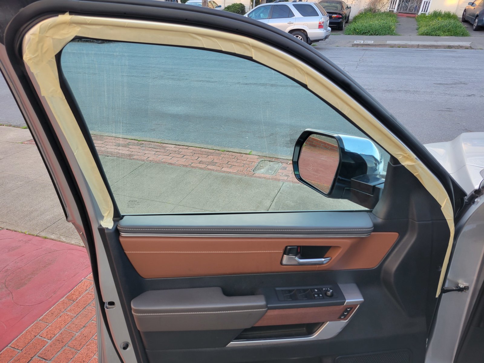

    What's a big deal, here's the solution guys... Remember, it's a TRUCK! so what I paid $80k for it and have saddle tan interior?
    Dealer already replaced the window seal 4 times for me over the last year and half 20240226_173252.jpg

    lol, you're for sure the winner of the wind noise award of tundras.com
    did you eve try that extra piece of trim that the TRD John guy slide into the window channel for grins? it was like 15 bucks on Amazon, Im curious if that would stop it for you.

    Guys, so what I did is actually pretty helpful in terms of reducing wind noise.
    So if you have to drive long distance, you can do this in a pinch. It looks ugly but window still rolls up down and if you find black color painters tape then this will blend in much better

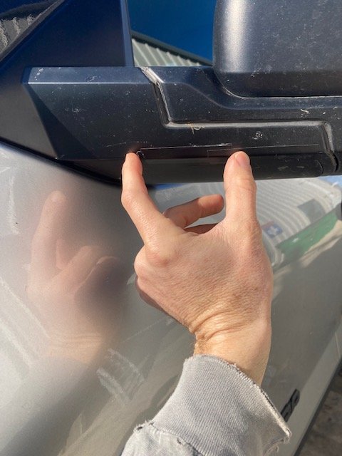

    Here is the Whistling Mirror Fix.
    As a reminder - my wind noise does not appear to be the "Common" wind noise. My door seals and window seals look really good. I don't feel / hear / see any cold air getting through the window. There is no air getting around the door.
    My driver mirror SQUEALS over 45mph. It's horrible. I taped all the seams on the mirror, and the noise is 100% gone. It took approx 6 months of slowly removing and replacing tape to find the smallest section. This 3" piece of black electrical tape solves the problem completely.
