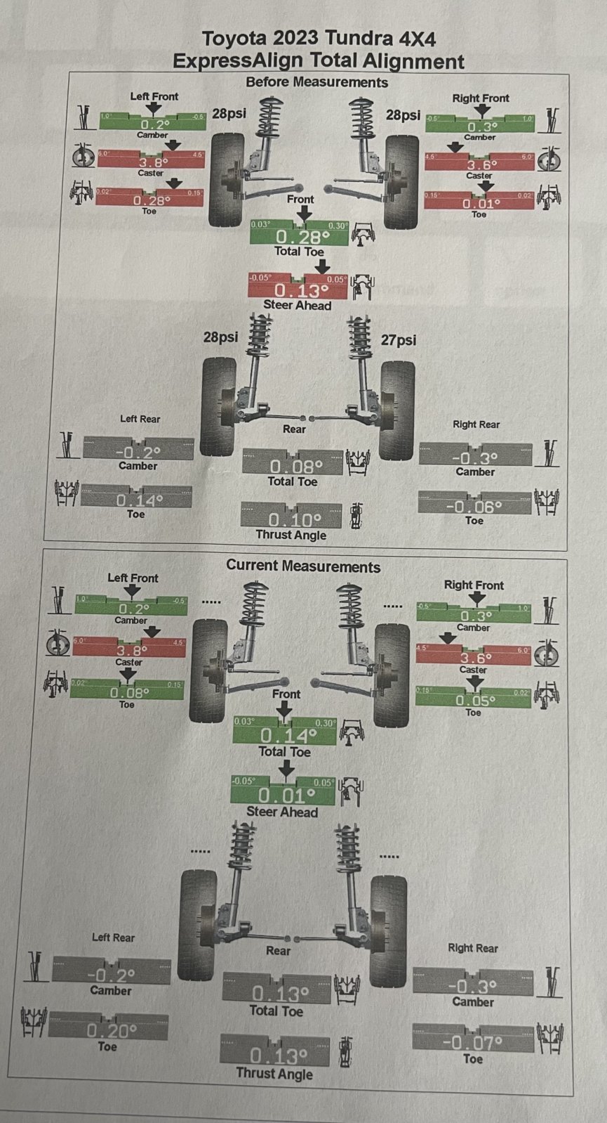

    So I took THOR in to get the oil changed and at the same time have them eliminate the V-8 sound, increase my temporary turn signal to blink five times instead of the default at three (I tow alot and prefer to have some "time") AND look at this whistling noise. oh BTW, I also asked them to check the alignment based on many of the posts I have seen here AND the fact my right front tire edge looked pretty worn since I put almost 5K miles on her.
    Guess what? The whistling noise is gone but the mechanic said he couldn't repeat the gripe when he test drove it. Interestingly enough, he test drove it AFTER the alignment. I have not heard any whistling since I got my truck back. Not sure if it is related, but it seemed to work for me!!!!! :)
