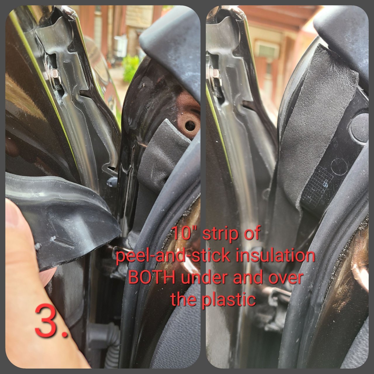

    Trd lift kit and 285/65/20

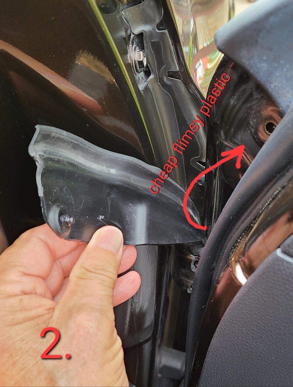

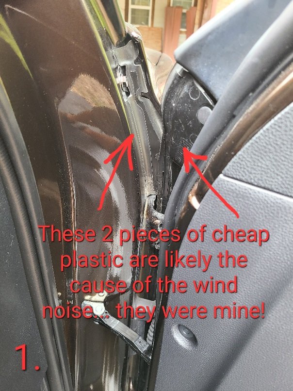

    I have a 2023 tundra limited. I had the dealer install the trd lift kit. My truck has had a high pitched annoying wind whistle since about 1500 miles. Dealer has replaced driver side door seal around the door and the door hinge seal, which did nothing. Last night with the help of a friend I found where the noise is coming from on my truck. Air entering through engine bay and fender area enters through a air pocket by hood hinges and air hits the windshield seals at the bottom and create an annoying wind whistle at anything over 27 mph. I was able to get this sound to go away by using a piece of foam on each side under the plastic trim at back of hood and bottom of windshield on each side. I plan on talking to my dealer about it. Maybe new windshield seals will solve the problem, but would still put foam or similar in the area described to slow the wind down. Ill get some pics soon to show the area. By the way, just realized last night as well, that when the dealer installed my trd lift, they removed my factory fig lights and put blanks in place! So now I have to deal with them on getting those back! My experience has been nothing but annoying with the toyota dealer. From them "throwing away all my factory suspension components" with 300 miles on them, to now this!
    Mattedfred likes this.
  12. Oct 14, 2023 at 4:55 AM
    #522
    Huskyrider20
    Huskyrider20 New Member
    Oct 14, 2023
    #105371
    8
    2023 toyota tundra limited, trd off road, trd lift kit
    Yes, we were there the sane day they finished the lift. I was like there is no way they trashed that stuff. They ended up paying another customer having the lift installed to buy his factory stuff to give to me. Insane!
    4mm and Mattedfred like this.

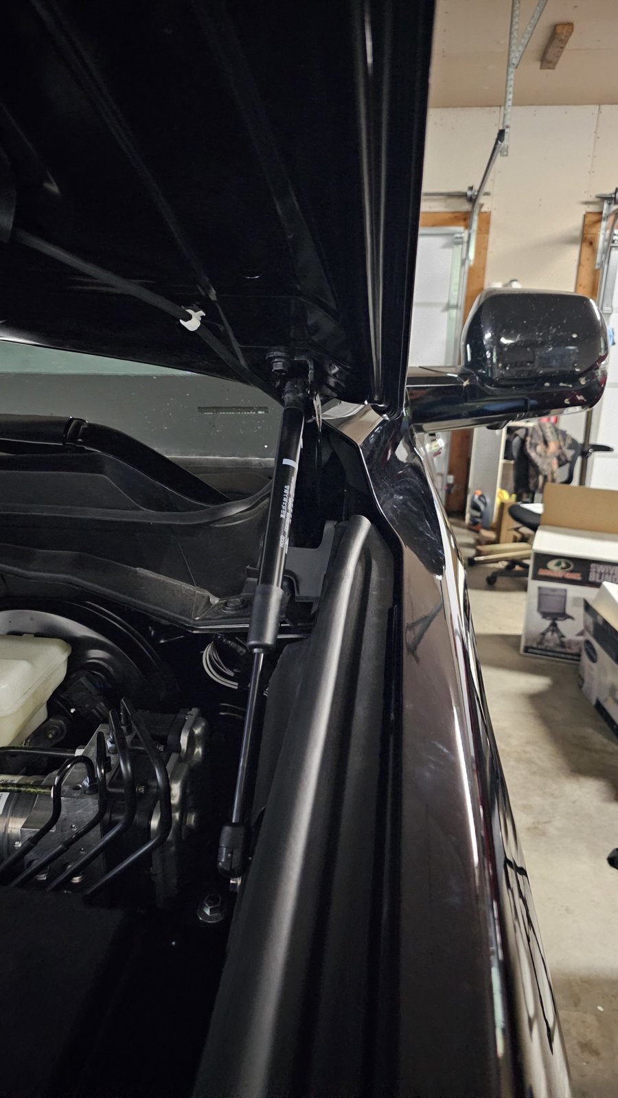

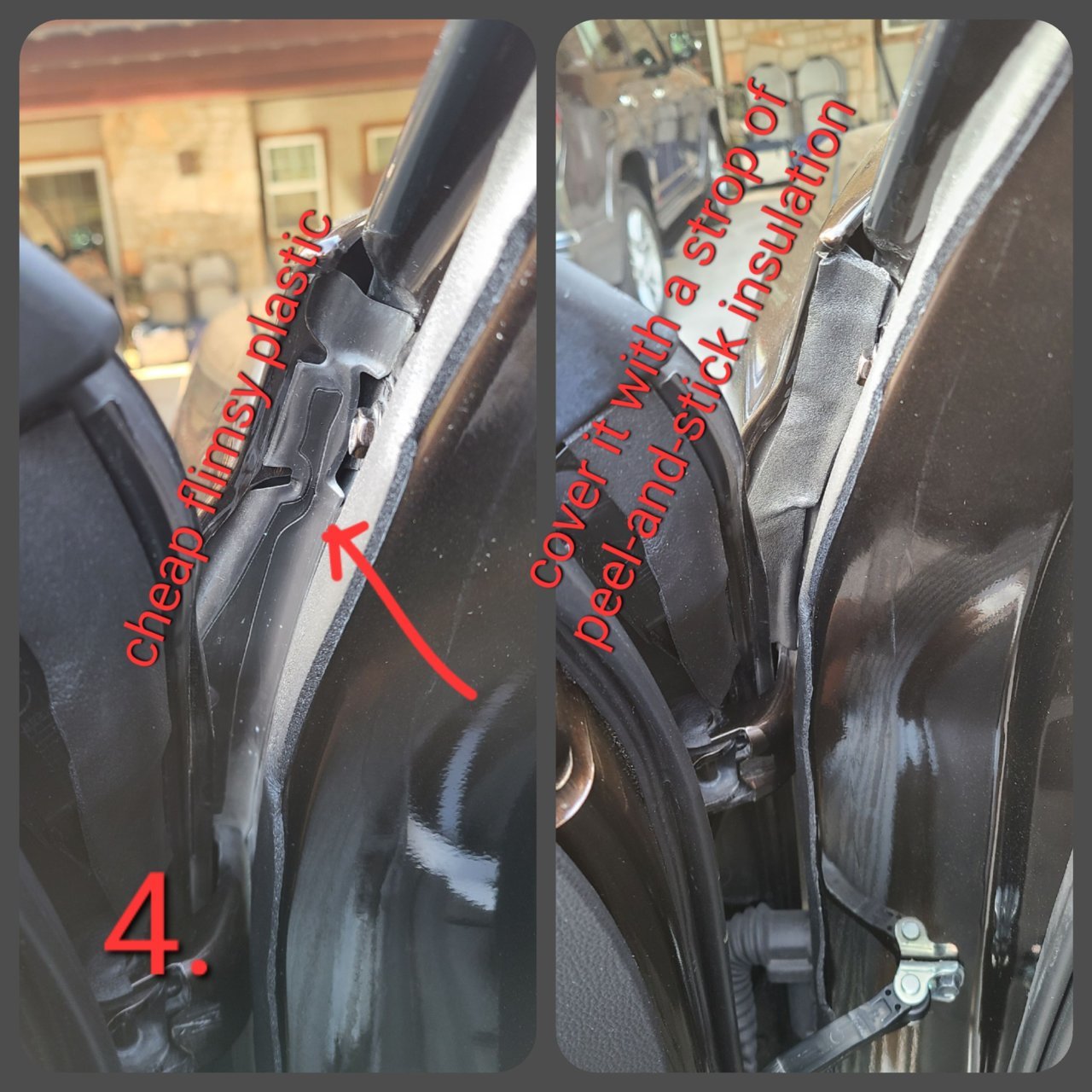

    Here is view looking into the pocket area where hood hinges is on driver side.
    Kap1 and Tundrastruck91 like this.

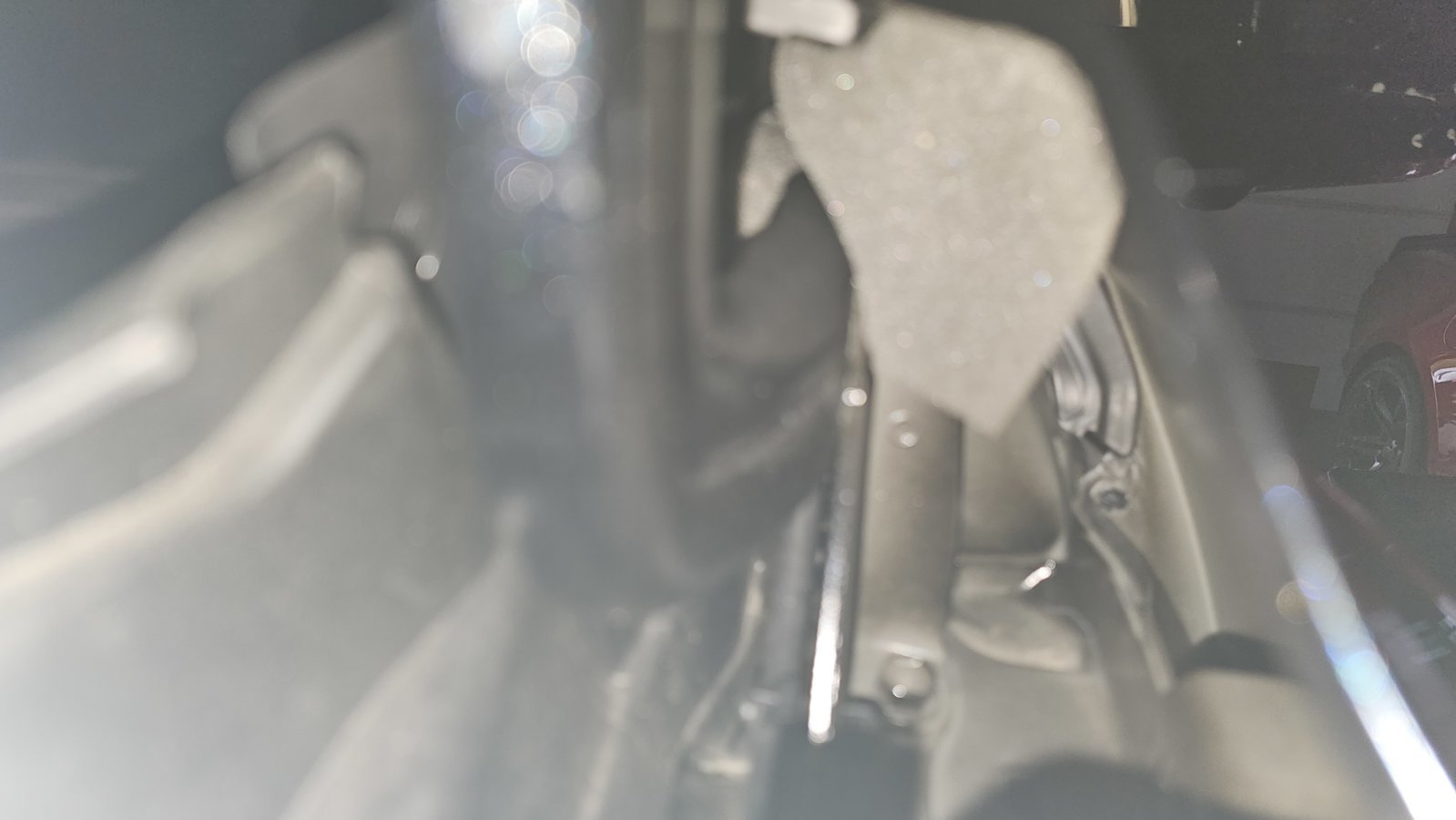

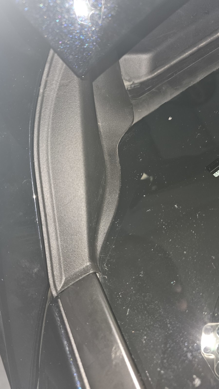

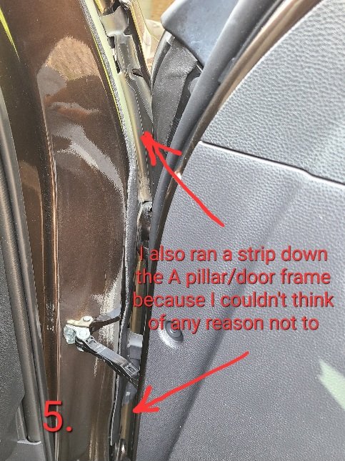

    This is the trim piece that I put foam under. This is looking down on back of hood area, where windshield goes into cowl

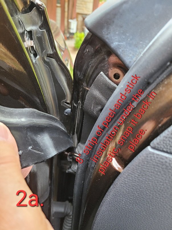

    One more view looking into the hinge area.

    Try this one
