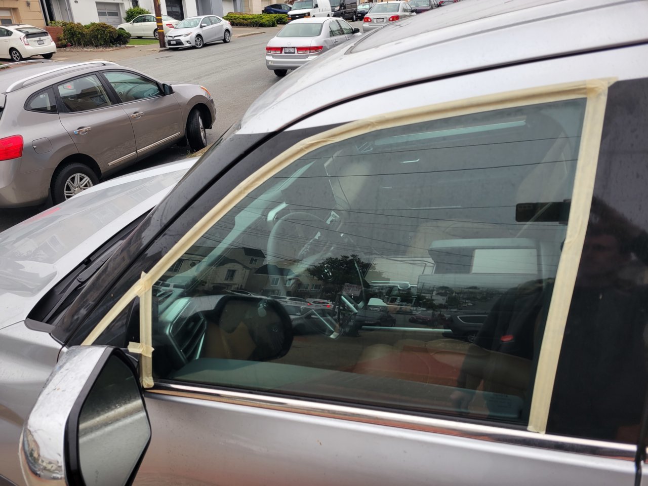

    Same here! They replaced driver side window runner few months ago and it fixed whistling but now it's back! I can push on the top corner rubber piece while driving and whistling stops... Taking truck in for this same issue next week.
    Taping up the window fixes this whistling and wind noises so this is the window runner seal again!

    I had exactly same issue with my 1794 2022 driver side mirror, whistling noise went away when I closed mirrors, however, after 2k miles closing or opening mirror didn't make any difference anymore.
    Issue end up being the driver window runner (rubber seal around the window). Tape up your window just like I did 3 posts above, drive around and see if that will resolve your whistling issue, then ask dealer to replace the window runner. That fixed it for me for few months but now it's back whistling a bit... Taking it in today

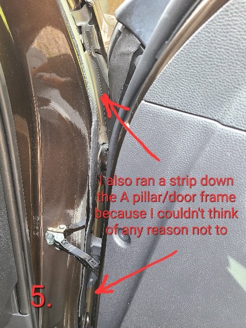

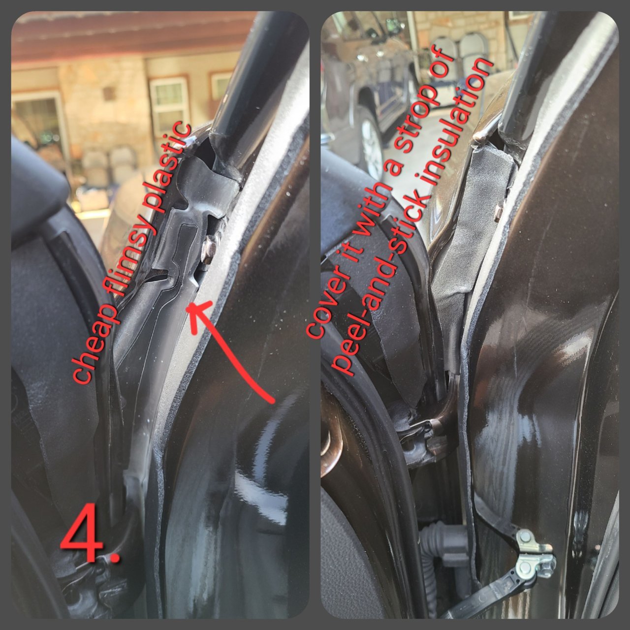

    I got thrown out of the local dealership this week. Took my 2022 1794 Edition, $72,000 truck in with the ongoing wind noise and 8 other issues... other than falling on it's face when accelerating from a stop, they "can't replicate" any noise or problem I've had with this POS! I drove my 2009 Tundra for 13 years with no problems, except gas mileage.
    Reference the door seals mentioned above, my 1794 has them. They have to be made from used milk cartons, the plastic is so cheap and flimsy. Here's my $10 solution from Amazon, which seems to have helped a lot with the wind noise:

    All you have to do is to tape up all window and door seams in question with painters tape and see if the whistling or wind noise stops. It's easy to figure out what's causing the noise

    41
    I've had a chance to take several road trips since putting those seals in, and can DEFINITELY say this reduced the wind noise by at least 50% ... not gone, but way better.
