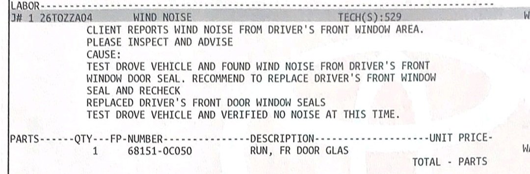

    The solution! At least for my issue.
    Had dealer replace the front driver side window rubber seal aka runner, and it's dead quiet now! No more whistling on freeway, and wind noise is much quieter now. It feels that even music sounds better now without all this external noise.
    Here's the part number for front side driver window rubber runner that was replaced.
    My Toyota dealer in San Francisco, Richmond district is awesome! Just text my service advisor and he gets part next day and text me to bring it in. Don't even need to schedule appointments and they're always available within a day or two! (unlike Ram dealer 2-3 weeks out!) Screenshot_20230301_182712_Adobe Acrobat.jpg Great customer service which is a BIG deal for me after fighting with Ram dealer for the past ten years!
    Henry1jg and Black widow TRD like this.

    Idk if it's new part number for the rubber window runner or not, but it fixed the issue
    pcguilford and Black widow TRD like this.

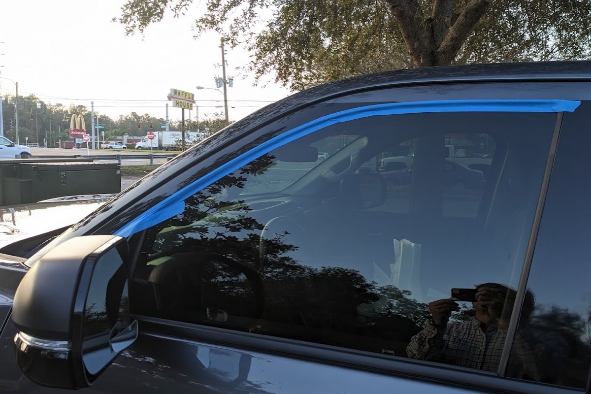

    I'll take a photo for you. But I'm not sure if there's anything special about it.
    I only had driver side window rubber runner replaced. New one looks fine, pretty straight, nothing really special about it.
    As I posted photo above, tape up your seal with tape, and if that helps, then ask your dealer to replace the particular seal. Won't hurt...

    You have to tape it up to determine what exactly is causing noise in your truck, just like I taped up, see couple of pages earlier in this thread

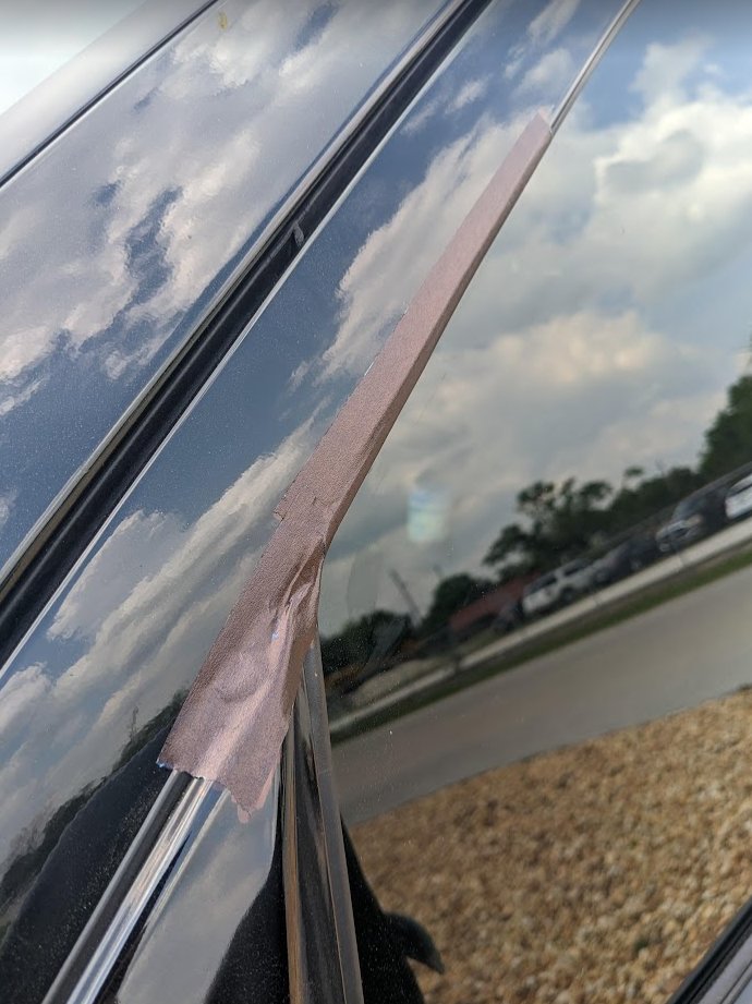

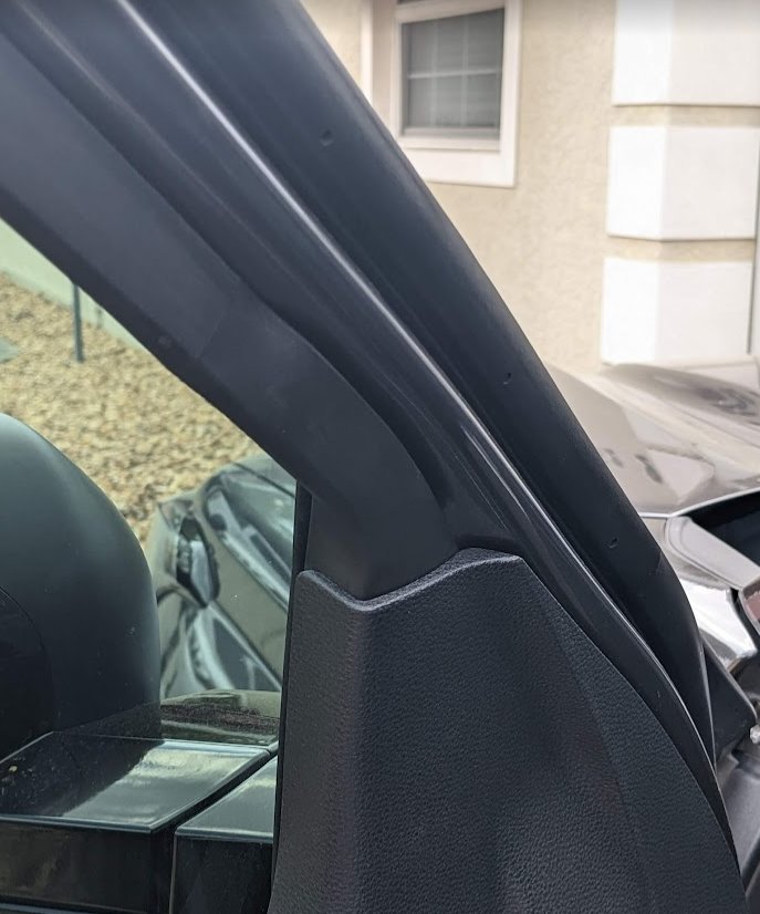

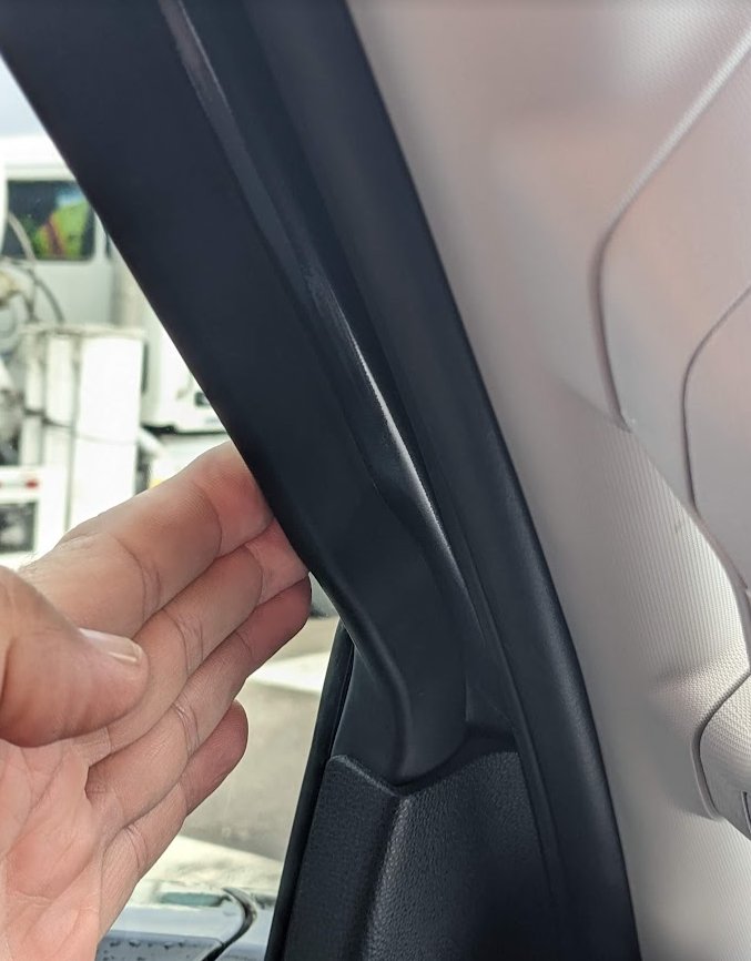

    I have dialed my whistling noise down a bit to the front part of the driver's window. Some have reported it to be the back part against the B pillar, so it is not the same for all.
    When I force my fingers in between the rubber seal and the window it reduce the noise. When I tape over that are on the outside the whistling is almost completely gone.
    I started by taping the whole seal, which took care of the whistling, and then removing pieces until the whistling is back.
    It's actually ridiculous how missformed the seal is and it passed inspection:
    Pressing the window outward reduces the whistling:
    Taping over this section of the window seal just above the mirror takes care of the whistling (at least in my case. Others have found that it is in other locations)

    I had exactly same whistling noise. I had it fixed by dealer by replacing the window rubber runner. I documented the fix a few posts up on this page
    pcguilford and Boerseun[QUOTED] like this.
