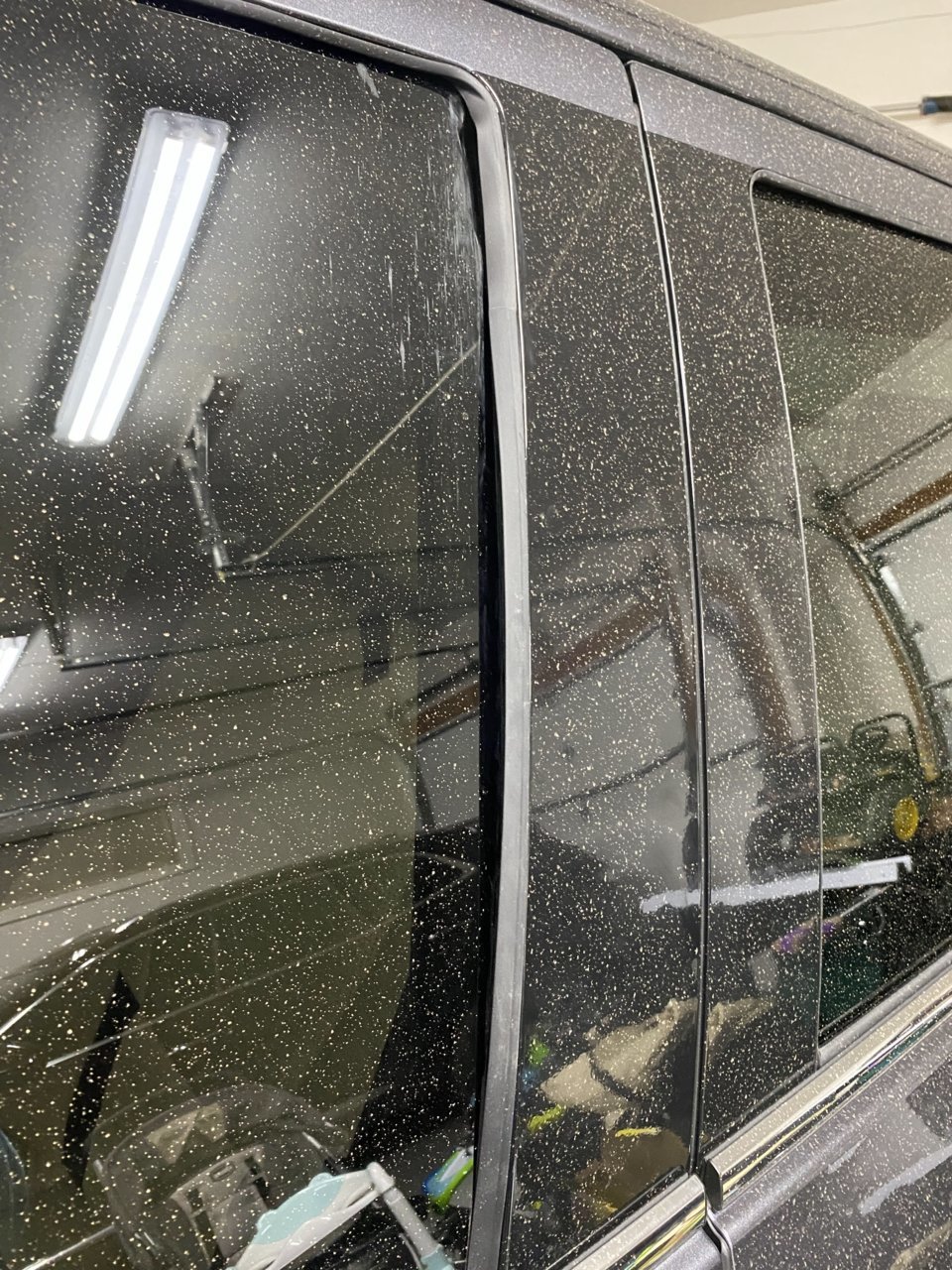

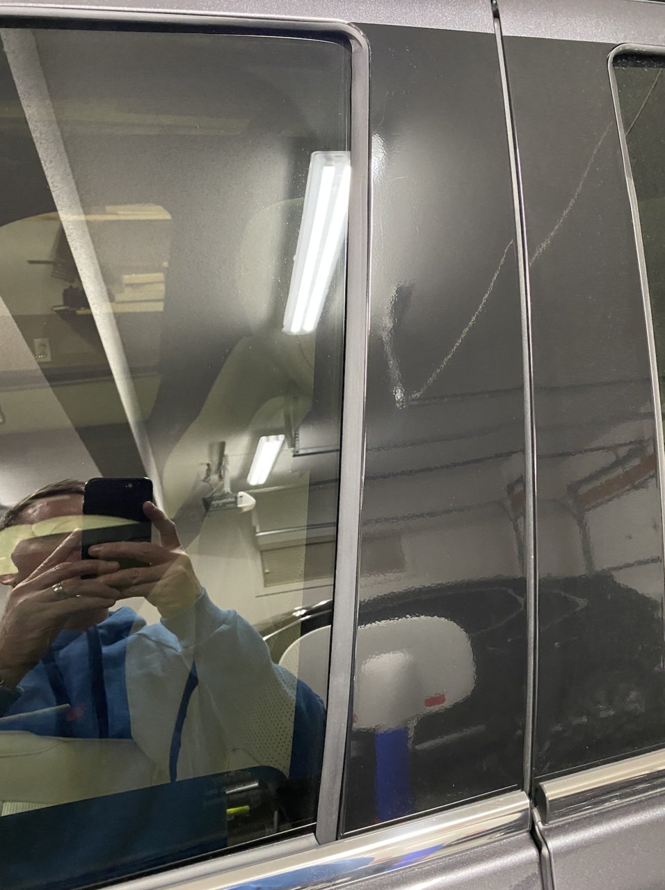

    A couple things to note on my experience:
    My 22 1794 was incredibly quiet when I first bought it. Although there was a noticeable whistle on the drivers window only above 75mph. It wasn't enough to turn me off from buying the truck but it was present. Over the course of putting 9000-10K miles on the truck the wind noise got considerably worse. In addition my truck developed the upper door/window squeak/rattle where the upper door frame actually wiggles against the cab (this is a separate issue from the wind noise).
    I started complaining about the wind noise to my dealer around my 10K service and it took them a bit to get to a point where they agreed to replace all my window seals. The dealer did all the taping, etc that they're doing to try and determine where the wind noise is coming from but ultimately what i've realized is that each truck is different depending on where the seal isn't snug up against the upper door frame. Mine in particular from in the back of the window near the B pillar because the seals were flared out catching wind and causing noise. After the first round of new seals the drivers rear, passenger front/rear were both greatly improved (basically back to new truck level of quietness). However my drivers window seal was horrible and frankly I was disappointed that the tech even let the truck leave his bay looking like this (photo below). So here is where the issues began because the service advisors 'excuse' for the seal being in this condition was that it gets shipped in a small package and 'if i wait until summer when it's hot it will lay flat'. Well that explanation didn't quite resonate with me since the other windows were perfect. Another trip to the dealer and a second & third seal netted the same result. I told them I wouldn't accept the truck back like that so they got a regional tech out with another seal and now it looks like the other three and no longer has the dreadful wind noise at 70+.
    Window seal after 3rd replacement.
    Following the window seal was the upper door squeak/rattle situation which really can't be solved unless Toyota redesigns their inner door to cab seals and makes them substantially larger so the door seals to the cab tighter. I solved it myself by adding additional stick on auto/marine gasket above the existing cab seal to put additional pressure on the top of the door. I did this for both drivers and passenger front doors. This solved the problem of the upper door moving around when hitting bumps, but I don't consider this to be a long term solution. My hope is that Toyota comes with a future TSB for this issue, but time will tell.
    Henry1jg, FLTundra22, mayan and 3 others like this.

    That first photo is SOOO BAD. It looks like my 2 year old installed a window seal sold by Harbor Freight. SHAME. SHAME. SHAME.

    Yeah I was pissed.

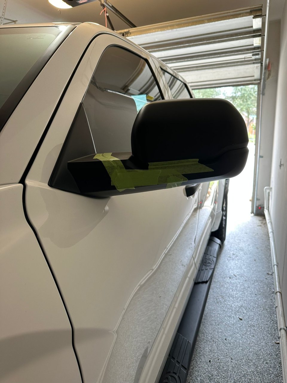

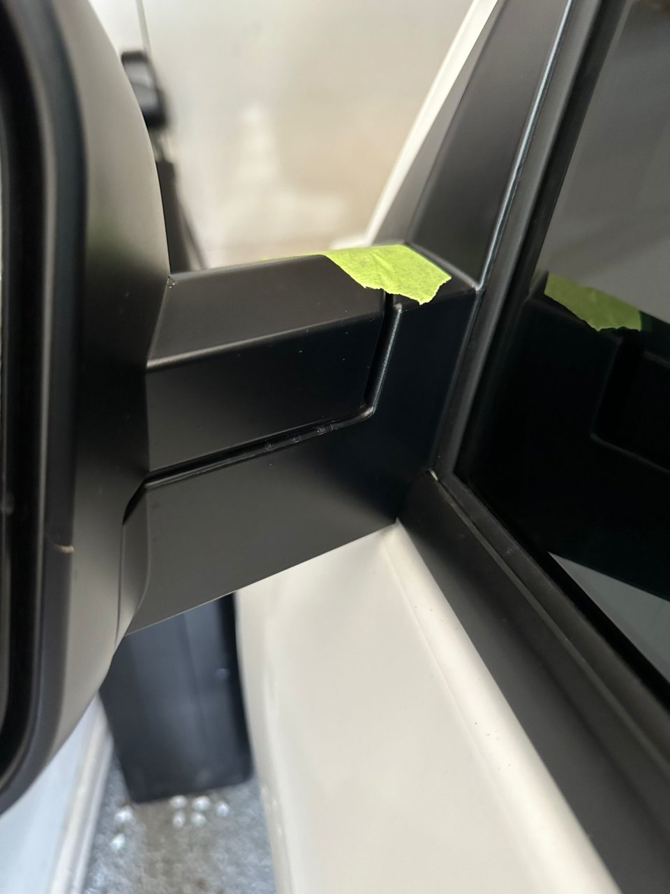

    Taped my mirror up and noise is still there, taking it to dealer tomorrow. I think it’s a gasket problem. Going to tape airways to the window and see if that helps. I’ll keep y’all updated

    doing this solved the whistling isssue from the driver side, now I hear the passenger a bit more lol. I’ll take it to Toyota tomorrow and see what they say.

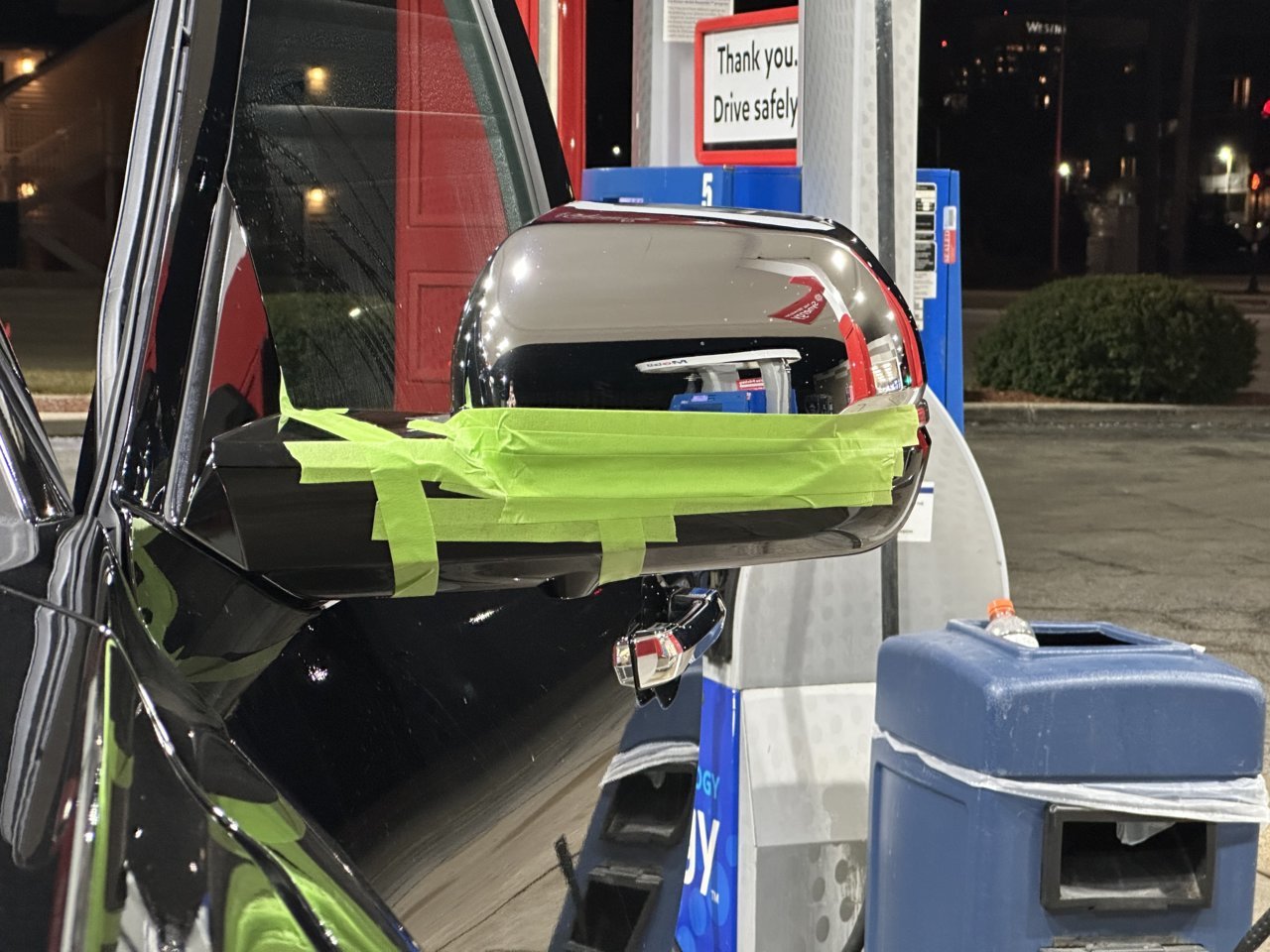

    As others said, it seems that these wind noise issues are unique to each truck - depending where the seal gap is that's causing wind to intrude and whistle.
    My driver side always gets whistling noise above 40 mph. Originally, of I fold down my power mirror, the noise was gone and only would re-appear at about 70mph.
    However, now that my truck for 2k miles on it, folding mirrors does not help to get rid of the whistling noise. It's weird how something changed that folding mirror no longer helps with the noise. Even though nothing changed on my truck... Maybe some dust over the past 2k miles? Idk
    I tried taking up the whole mirror without any results, so I believe that my particular issue is probably window seal at the driver door. Didn't had a chance to do more taping...
