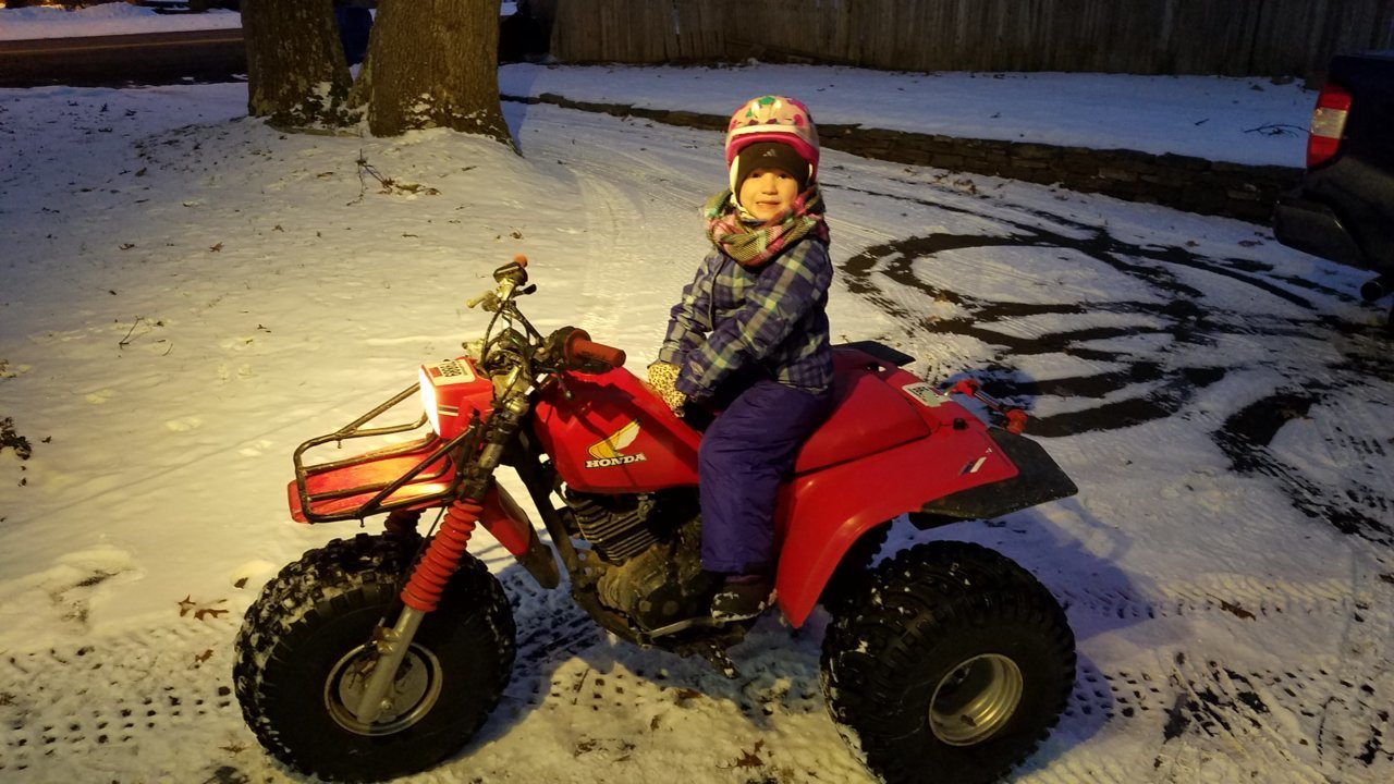

    I like your style. Here's my 250sx with mu daughter posing after we did some snow riding

    What year and size is the honda?

    I swiped this photo from google but i did have an 82 or 83 110 just like that. Then got me an 86 250 r afterwards

    I received an '84 110 for Christmas in 1983. Happiest 8 yo on the block!

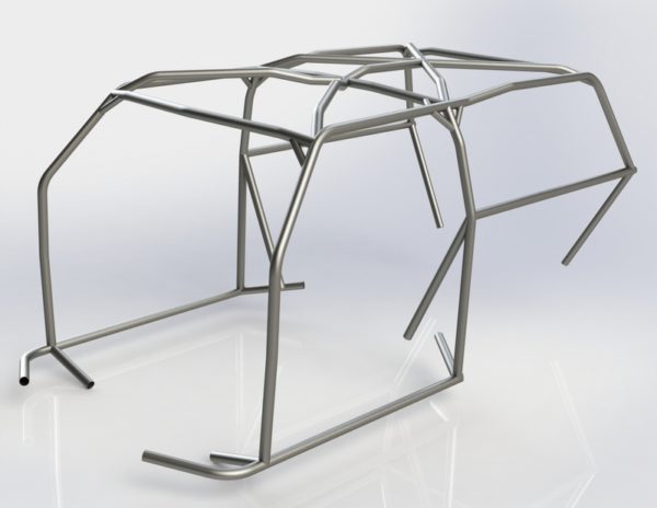

    Anyways....
    Why no cage? If you want it done right, it will cost you a LOT. I'm not talking about the store bought bolt together cage that's mild steel with a seem. I'm talking about a properly fabricated cage where the interior of the truck is stripped and it's caged bumper to bumper with DOM 4130 chromoly.
    This is a roll cage kit built by Solo Motorsports for a Ford Bronco. 1.75" DOM tubing.
    Sell's for $2500. And that's if you weld it yourself. For them to weld it, is another $500. Notice the tie in points to the frame. 8 points of connection to the frame, it doesn't penetrate the firewall either. It's just the cab. And there's still no triangulation aside from the roof bars. Nice for a prerunner or chase truck, but not enough to race with. Plus, you still have to gut the inside of your truck to weld it.
    If you're going to cage your truck, you're going to do it right the first time. If you're going to do it right the first time, you're going to spend a lot of money. If you're not going to do it right the first time, it's going to cost you a lot of money to have it done right the second time.
    But if you're really considering caging your daily driver, consider getting a offroad vehicle for the purpose alone. Rock crawler, or a 4 seat prerunner. Even factory UTVs don't have a rollcage. They have a "roof support system". A fabricated bolt on rollcage will cost you up to $3000. https://utvactionmag.com/utv-roll-cage-buyers-guide/
    Offroading isn't cheap.
