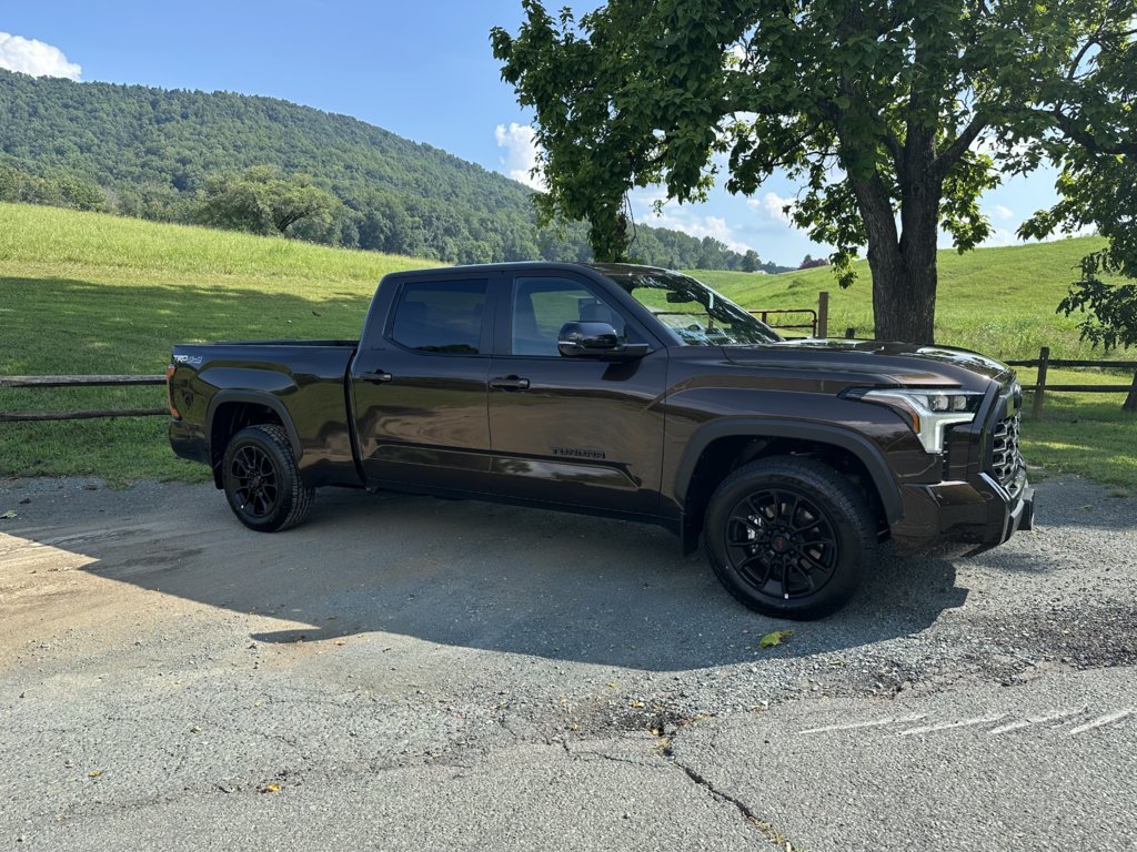

    WHat lift/level kit did you go with? What size tires? Yours is pretty much how I'd like mine to look once I'm able to level/lift it! Thanks

    Eibach Pro 2r, two full turns on front from factory settings the rear replacement springs with the kit brought the back up to keep a little rake. 285/75r18 KO3s, with the offset of my wheels I had do a few things to get a set of rokblockz mudflaps to fit without rubbing. Also have a JBA UCA as well. Mine is a limited OR so there is no air suspension in the rear.
