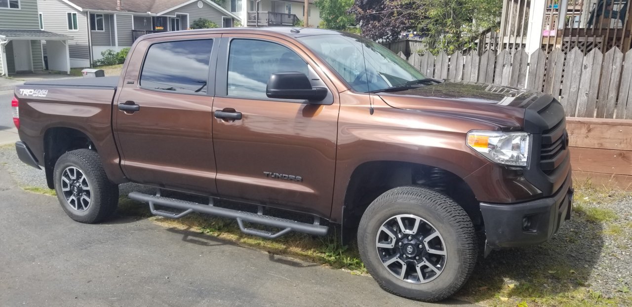

    I just got them on about a month ago with toytech shackles on highest setting. Love them. Also did bmc chop as precautionary measure but will be running 295/70/18 on my method bronze roost when stock tires run low. Kept a little rake. Debated between Bilstein 6112s, 5100s all around, and toytech eibach. I will definitely be getting the rear trd sway bar soon as well. Love the lift and of course Darren from boss 4x4 hooked me up with a great deal .super nice guy and even replied to my messages with questions on the install during the weekend.

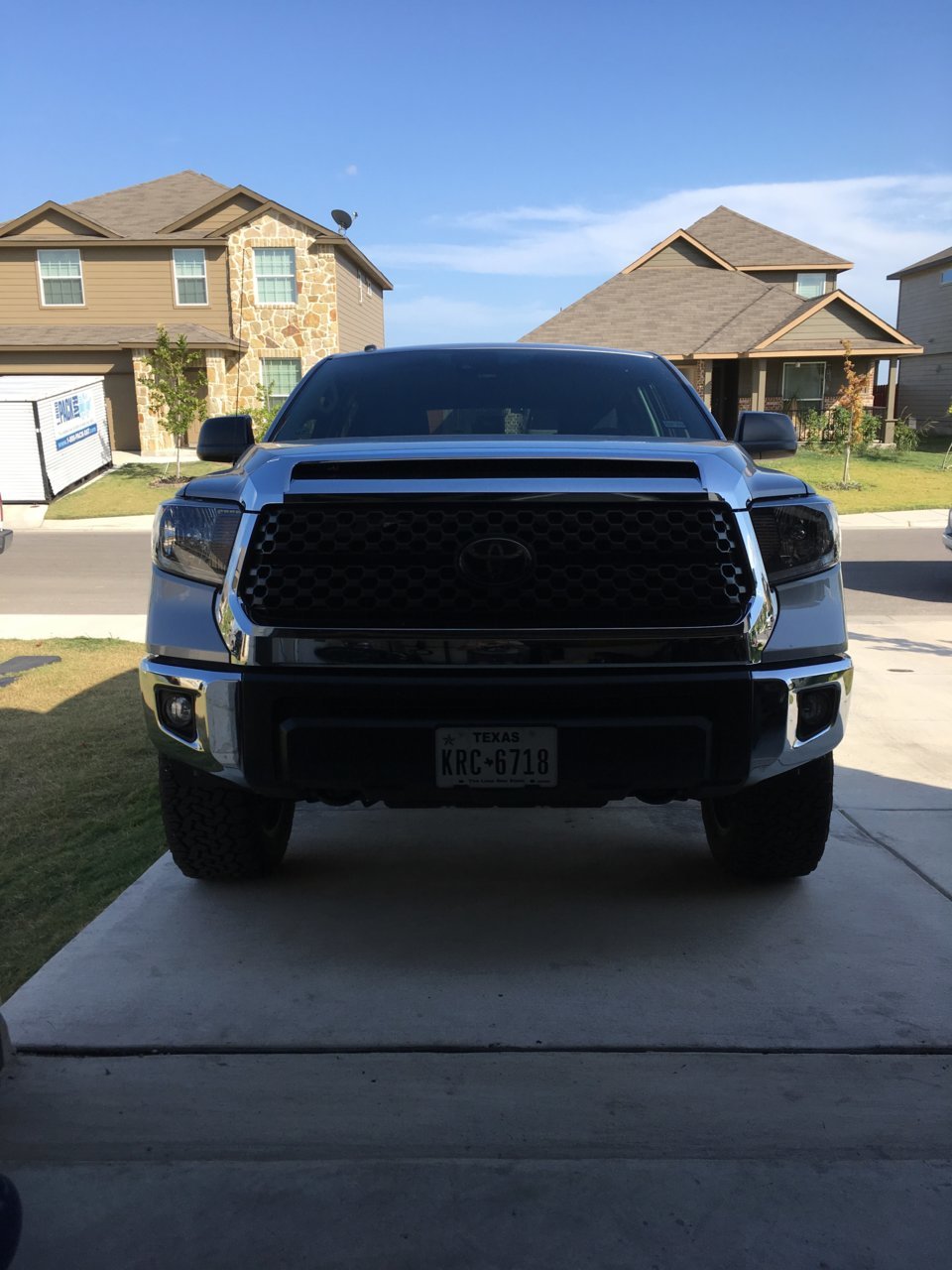

    Just put mine on. Like it so far. Have to ignore the sad stock tires. 285/75r18's on the way
    Dgjman, yoshi82, equin and 4 others like this.

    Looks great. Very interested to see the look when the tires get on there. Did you do shackles or blocks? And do you think you’re going to have to do the BMC?
    Thanks for posting!

    Shackles on mine. Could swear I've read somewhere where it should be good but I guess I'll see

    That picture you uploaded makes it look like the rear is lifted a lot higher than the front... that’s the only reason I ask. But I’m doing the shackles on the 1.5” as well. Really eager to see pics when you get new tires.

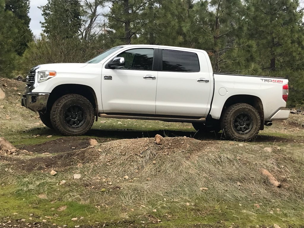

    I run the Eibach one shim on drivers side for lean, TC UCA's, CB +2 shackles on rear with 295/70/18 Cooper ST Maxx. Love the stance and Ride.

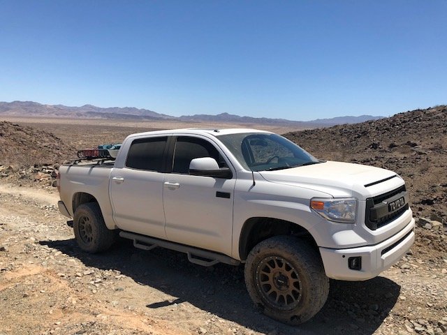

    Icon 17 rebounds, total chaos UCA's, general grapplers 35's, corsa exhaust chopped, fox 2.5 DSC coilovers, DAP, white knuckle sliders, voodoo bed rack, baja lights everywhere, VLEDS, bedslide, C4 front bumper, warn winch, victory high hitch with dual swing out rear bumper
    Same kit here no complaints, also running with toytec rear shackles on highest setting with total chaos UCA's and front diff drop. I am running method 20x9 with toyo at 305/55/20 no body chop mount needed, just had to trim and push the plastic up a bit. Daily driver and occasionally off road planning more trips soon.IMG_0951.jpg

    Looks awesome!

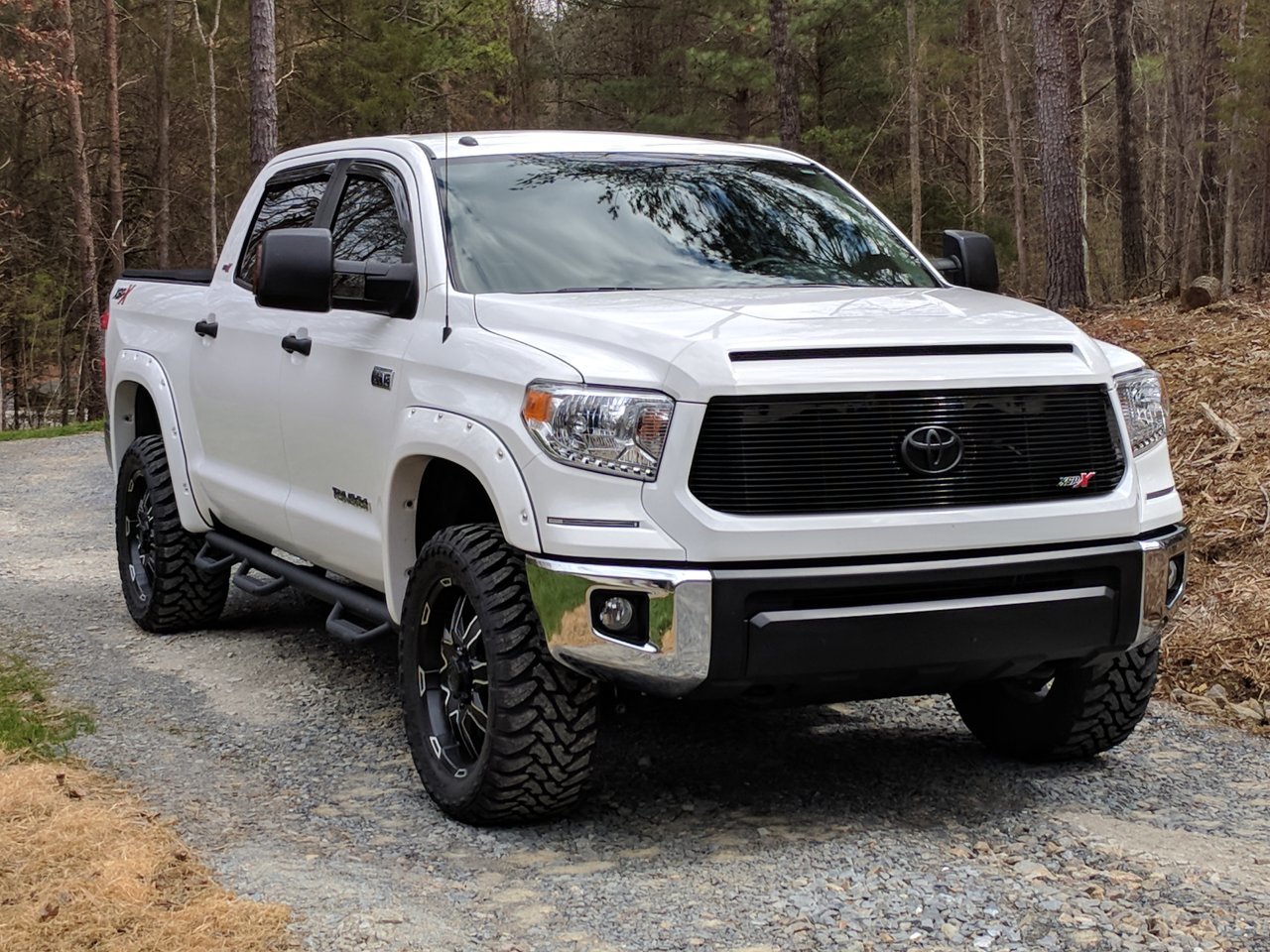

    I have the Eibach coilovers here and love them. I also have a 2" block in the rear with the rear Toytec Boss Shocks. The truck rides awesome. I definitely recommend them to anyone looking to upgrade their stock shocks. I'm running 33x12.50x20 Toyo M/T's. I also have the SPC UCA's to get everything nice and aligned.

    looks BAF. i see you also have the DRL panels. how do you like that mod? Very clean brother!!!!

    Thanks. Those panels were part of the XSP-X package.
