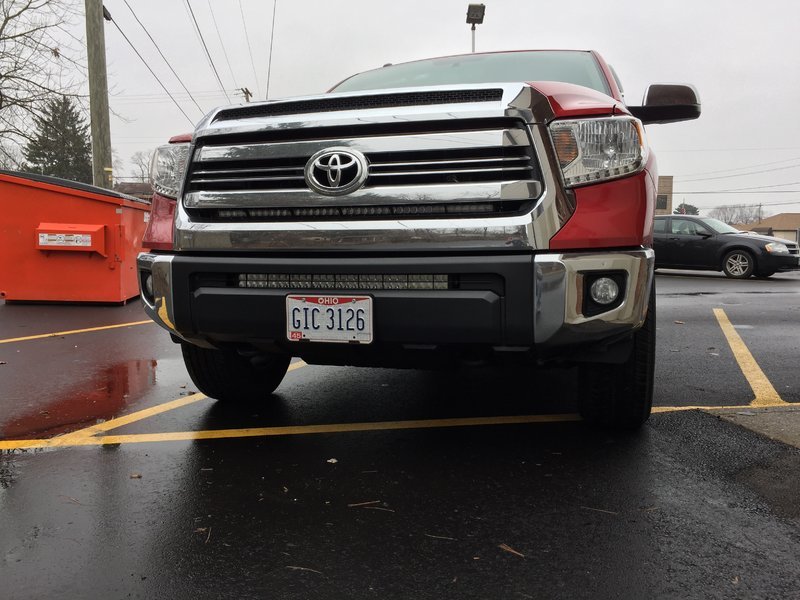

  15. Jan 7, 2017 at 10:27 AM
    #45
    HornetOne3
    HornetOne3 New Member
    Jun 10, 2016
    #3575
    53
    Sean
    Columbus ,Ohio
    2016 Barcelona red Crewmax SR5
    38in on the lower, Osram 180w flood/spot combo
    46in upper ,Creed 1in slim ,5d 260w spot beam for long distance
    When both are on , they lit up night like day
    Wires are very simple to installed. I just connet the + and - right out of the battery ,the switch ran thru the rubber in the firewall
    But i recommended to fabricate your own brackets as most factory ones wont fit into our trucks easy
    I went and bought some 3/8in aluminum bracket at Lowes and used the visegrip to bent them with what ever angle to fit into behind the grille
    (no paint needed for aluminum and easier to bent than steel but still has a rigid mounts better than factory's )
    Sixpack likes this.
