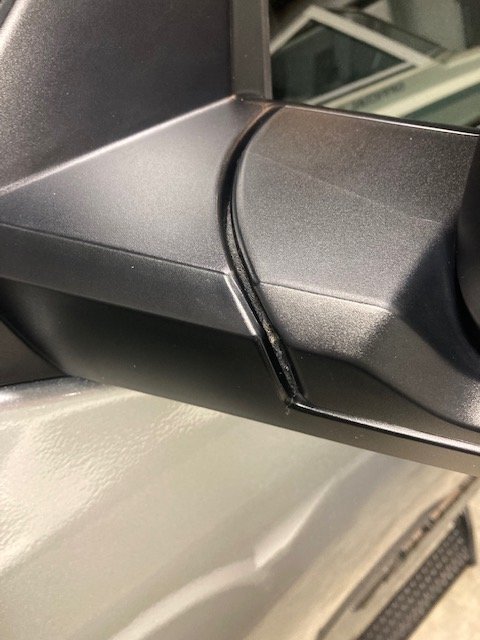

    OK - So I made lots of headway today. I drove the truck with all seams taped up, and of course the mirror was perfectly quiet. Then I removed the masking tape - and the whistling was horrible.
    Then I cut a 4x4" piece of black t-shirt, folded it in half, then shoved the fabric in the curved joint between the mirror and the stationary mount. I packed it in there good with a thin flathead screwdriver. Noise is gone. No whistle at 60mph, no whistle at 80mph. Gone.

    That's a good idea to put tshirt in there. I will try to confirm that as well when on freeway next time.
    Any idea on a fix though? As mirror opens closes frequently and cloth will come off eventually

    This is an awesome find jeffcoseo !
    It's probably the precise size and shape of that gap that is resonant (whistles). A small change to the shape will probably kill the whistle. Especially if you block off the middle of it.
    I'm thinking a stick on rubber bumper in the gap that doesn't interfere with the mechanical motion has a chance.

    Mine has a faint whistle on the drivers side mirror as well. I wonder if insead of jamming something in the entire seem if you just blocked the front would it stop the whistle. Also i wonder if we opened up the leading edge of the gap ever so slightly. by trimming back the leading edge of the inner side of the seem, would stop the whistle.

    All of these are possibilities AWDdude.
    Like I said above, most likely even a small size or shape change will stop it.
    And this may explain why some trucks have the whistling and others don't. Just the way the mirror base parts fit together, wide gap maybe, and that creates the whistle....as in a whistle one Barney Fife would have less the pea ;)
    I suspect the fix is very simple.

    I don't have power fold-in mirrors. Mine are just the cheap plastic fold-in style. I don't think I would ever fold them in purposefully. I may keep the black t-shirt in there and run a quick bead of black caulk on the seam. The difference between Whistle and No Whistle on my truck is deafening, unmistakeable, howling.
    It probably came down to manufacturing tolerance. What's funny - the horizontal seam on that mirror has a small rubber gasket to stop wind and rain from pushing through. But the vertical seam is wide open with no effort to slow air movement.
