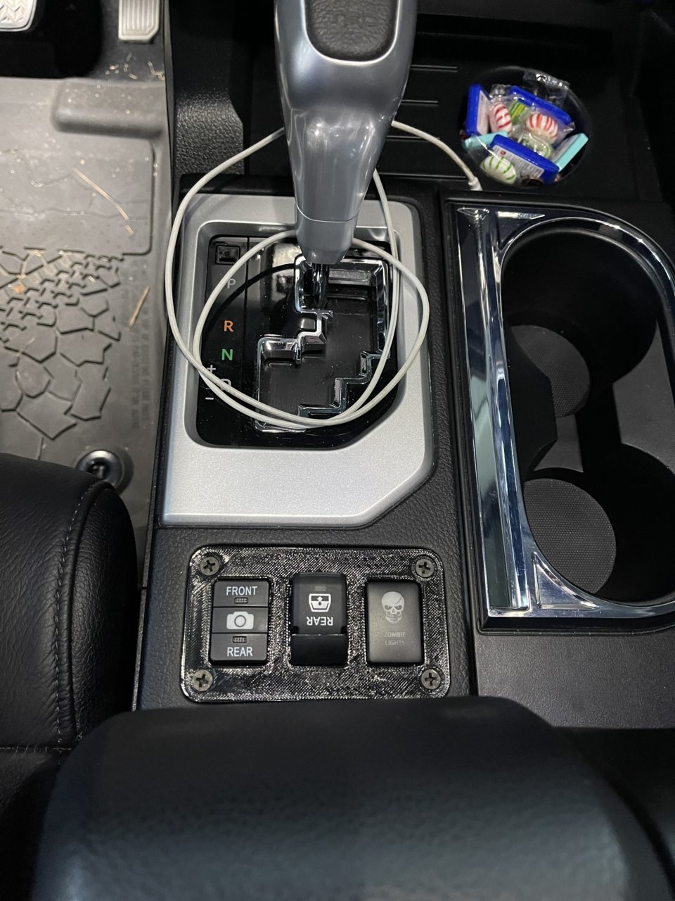

    Got mine installed in this nice spot, had to add length to the wiring, @RainMan_PNW, great install information, and @abomb60, great 3 switch panel, TRD PRO is coming together.

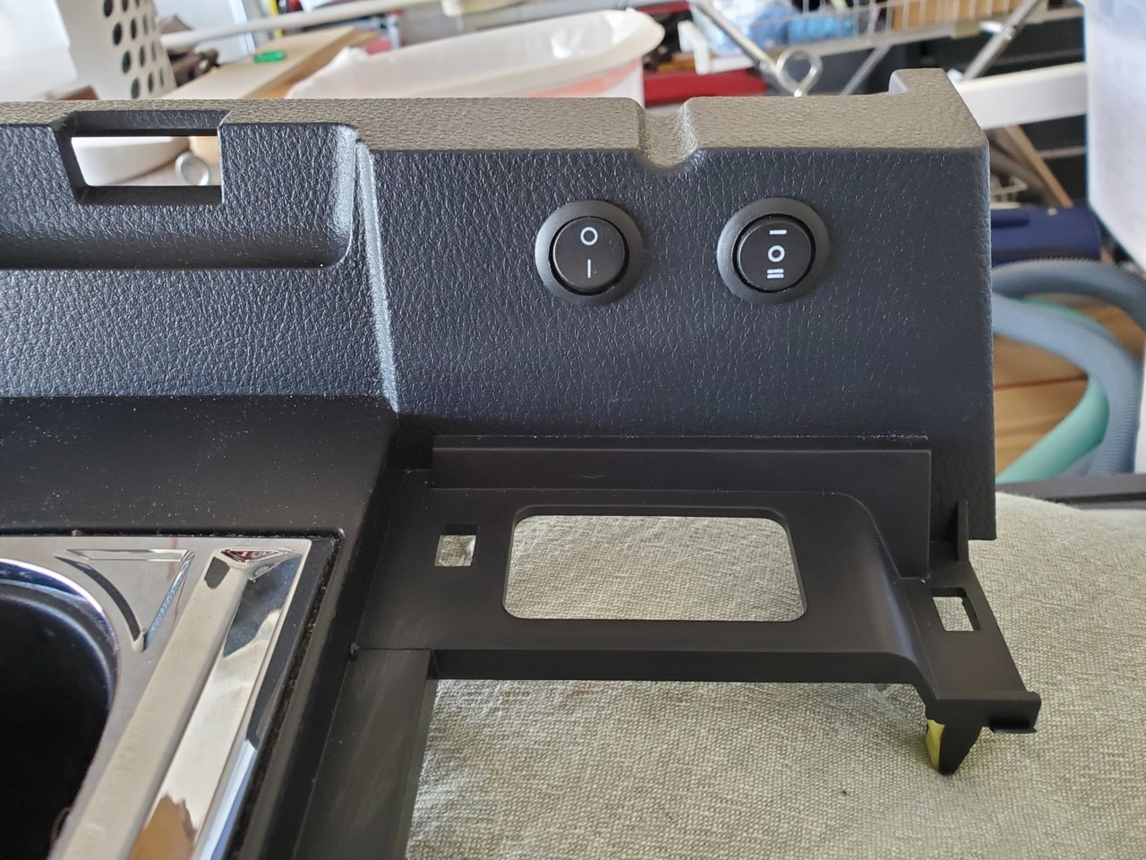

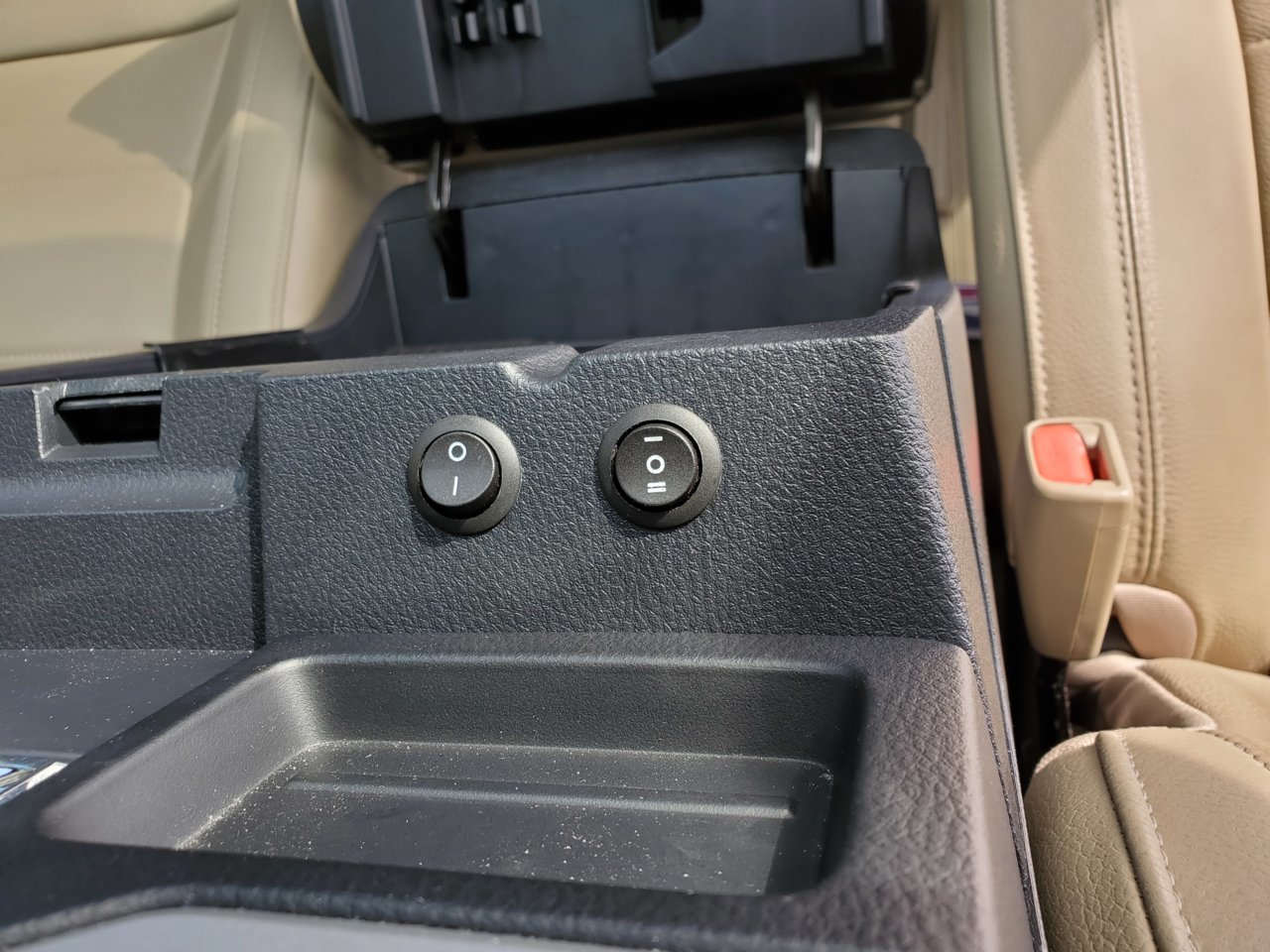

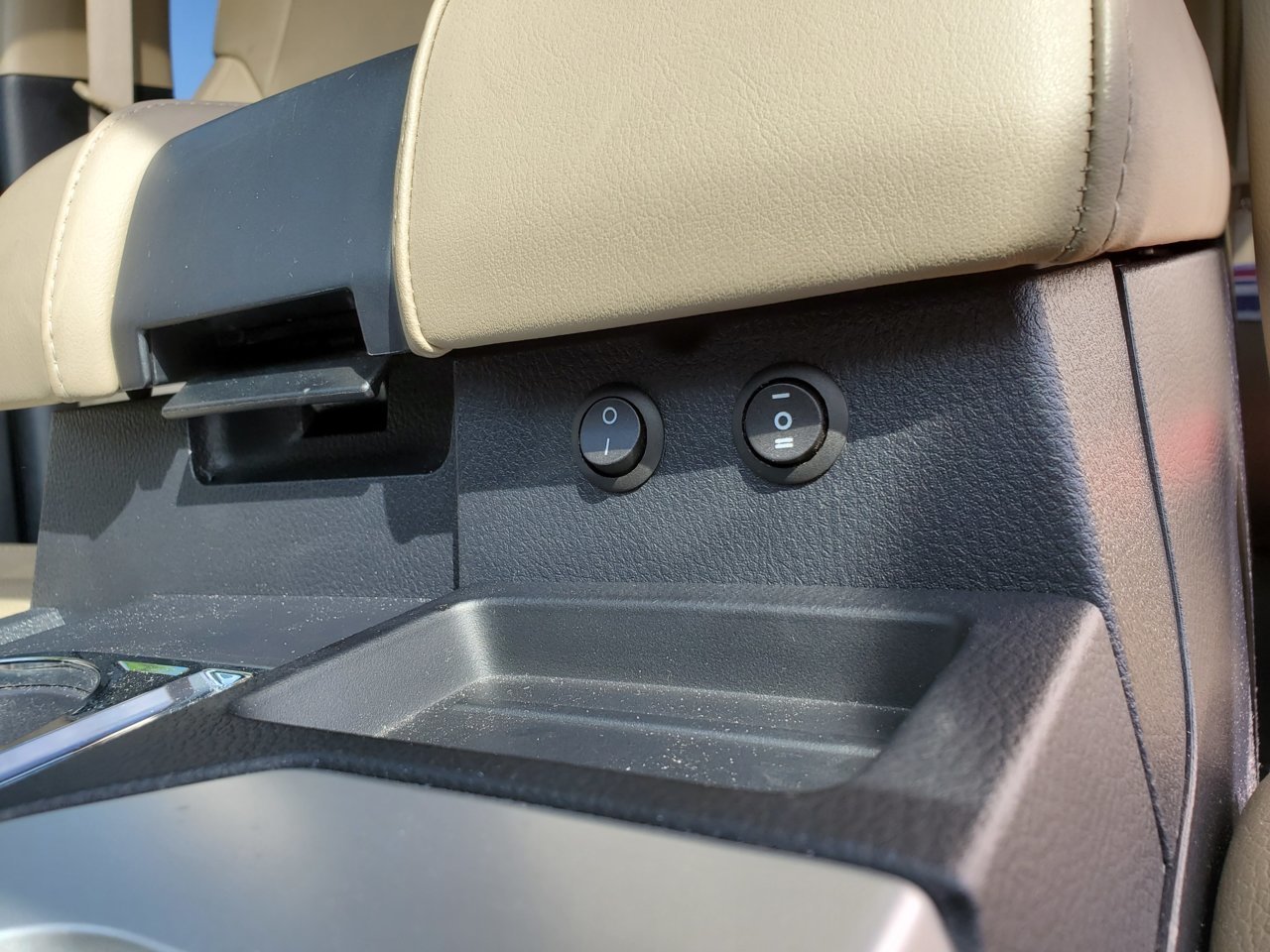

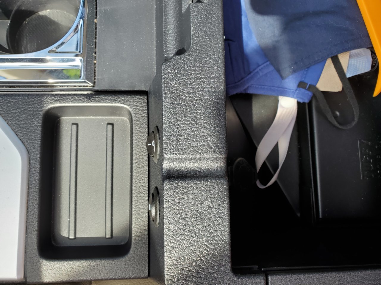

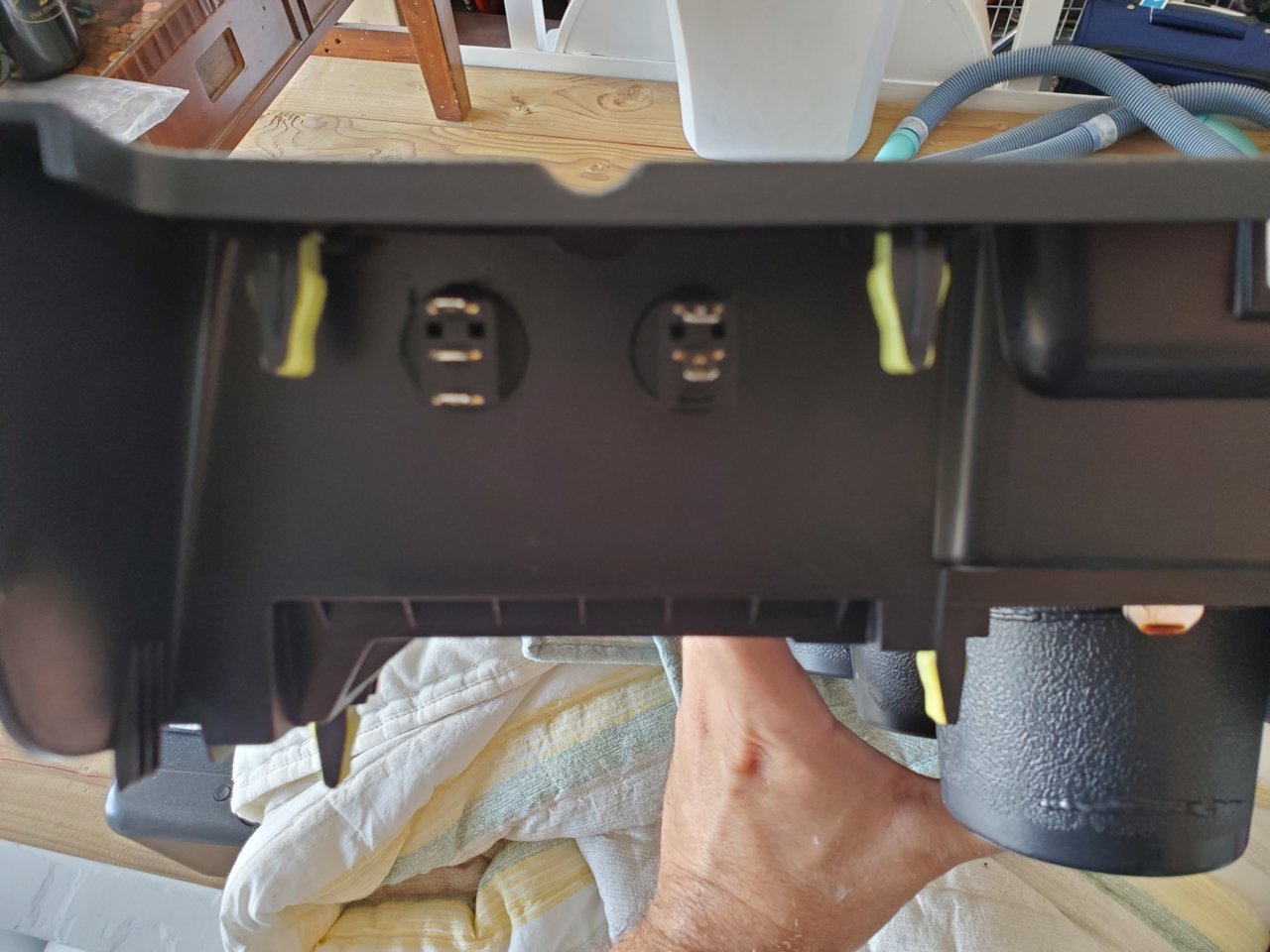

    Here are the pictures I took when I mounted the switches. Hopefully they assist you with the placement. You'll need to pay attention to the console part that this snaps into because the switches will be very close to some plastic tabs when assembled. It's a tight fit, but doable.
    Jego and Shadowfax1[QUOTED][OP] like this.
