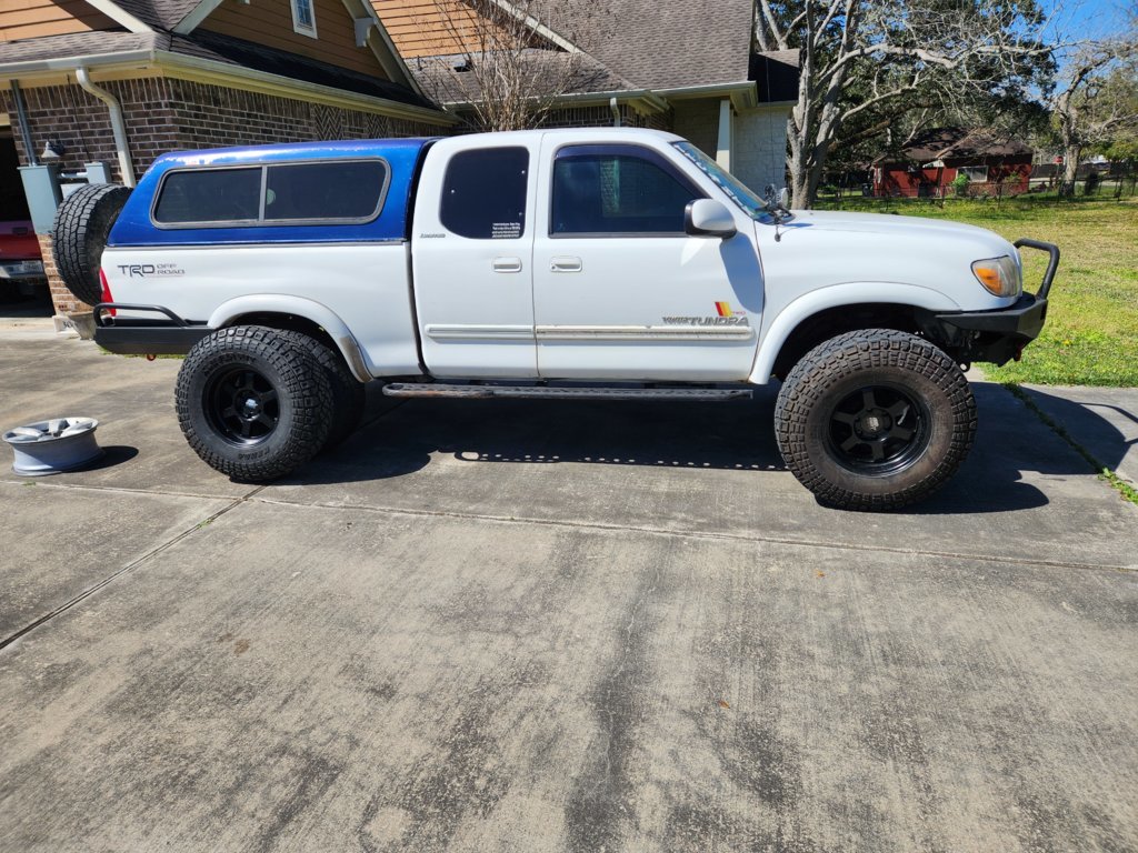

    I have 295/75r16
    They're basically a 33.5"x11.5" tire.
    I need to turn the wheels and torque the inner rear most LBJ bolt on each side to 90ft lbs, get a shorter 19mm 1/2" drive socket (and possibly a shorter torque wrench) to torque the center steering rack bolt to 122ft lbs, find a second set of hands to torque the two rear cam bolts to 96ft lbs, and adjust the toe. I'be been doing what I can when I can. But not having a helper is making go it slow. Still making strides. Hoping to take the truck to Juan at Toy Lex for the fine adjustments this week.
    I'll bring two 35" tires mounted on wheels on the tenth, we can play with if we have time, after doing your and my springs. But I don't plan to do the body lift until sometime after Jambo.

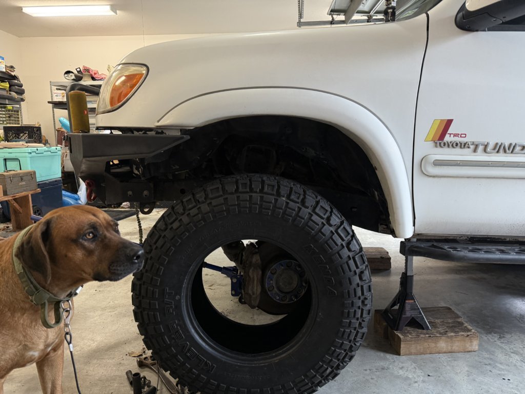

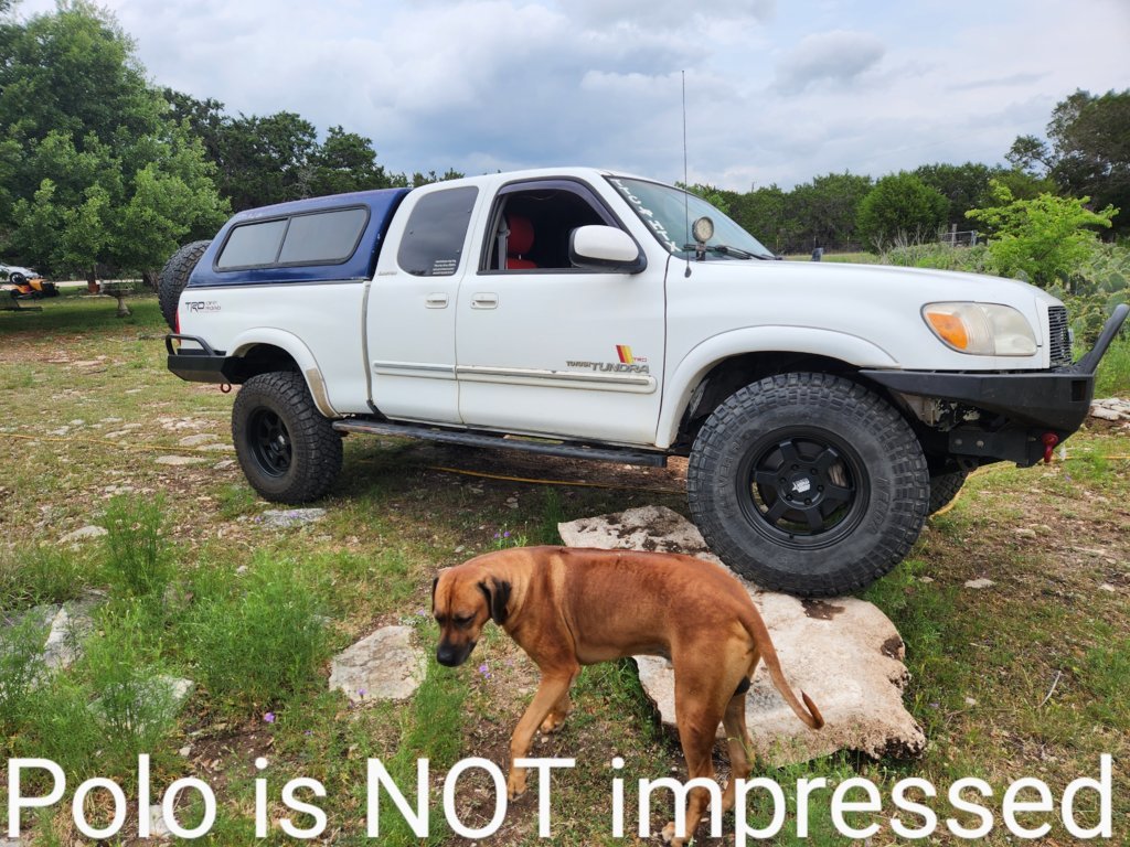

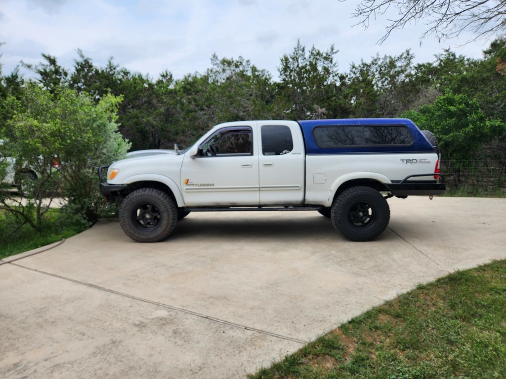

    I realized I never did a follow up with the Kenda Klever RT 35x10.5R17 mounted

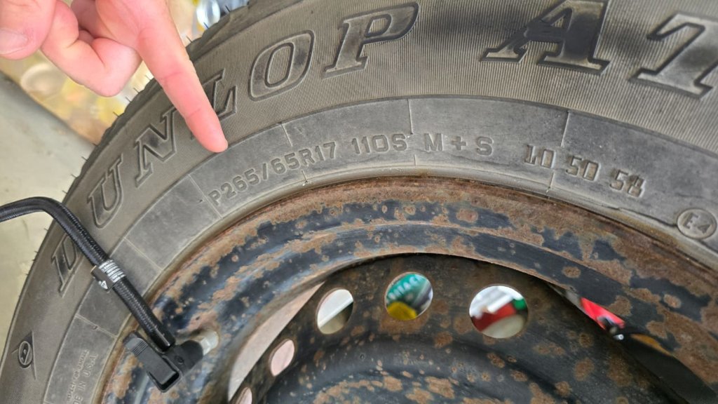

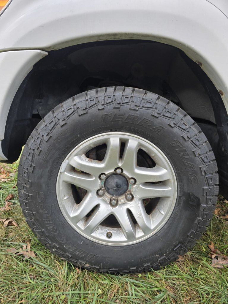

    My truck. I suspect the rims are what came on it (and need work, obviously).
    P265/70/R17
    Spare tire: P265/65/R17
    So I think my running tires are a bit bigger than what she came with.

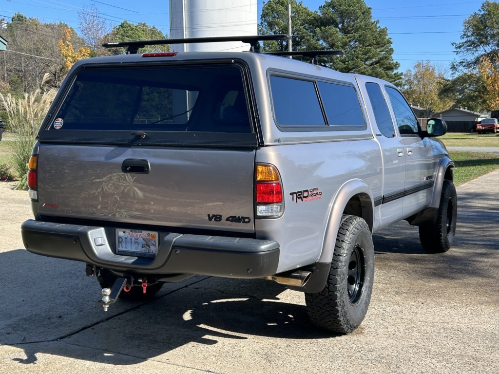

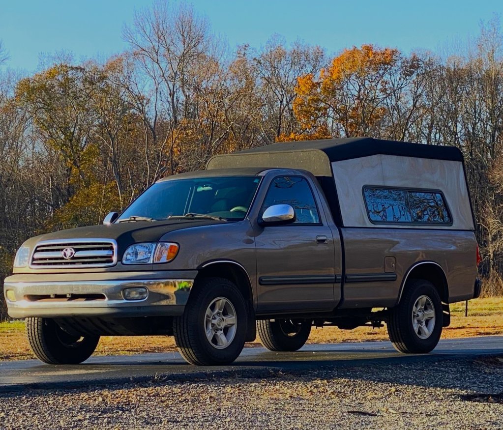

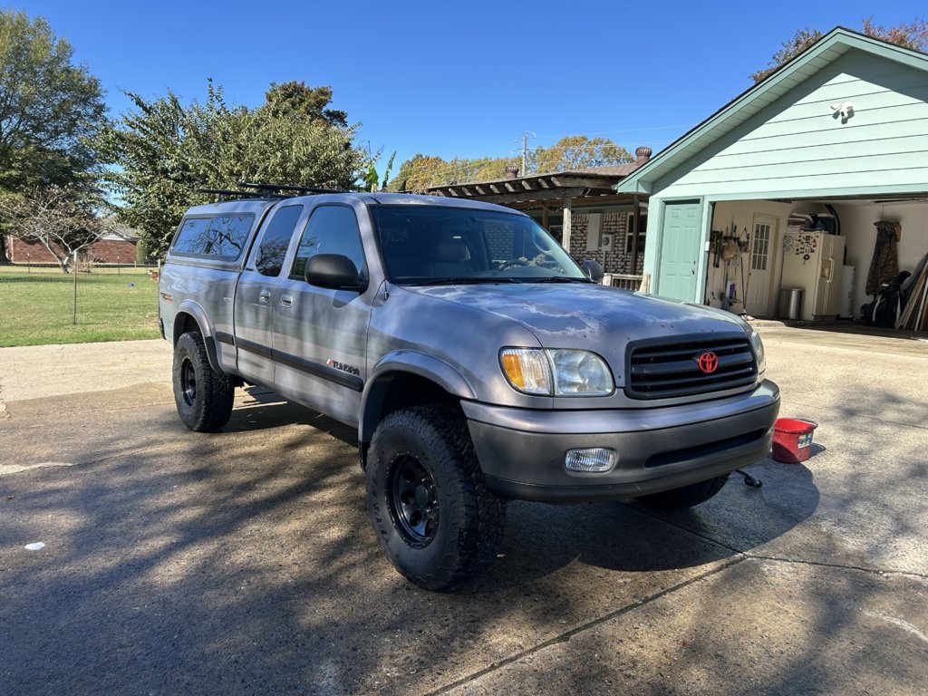

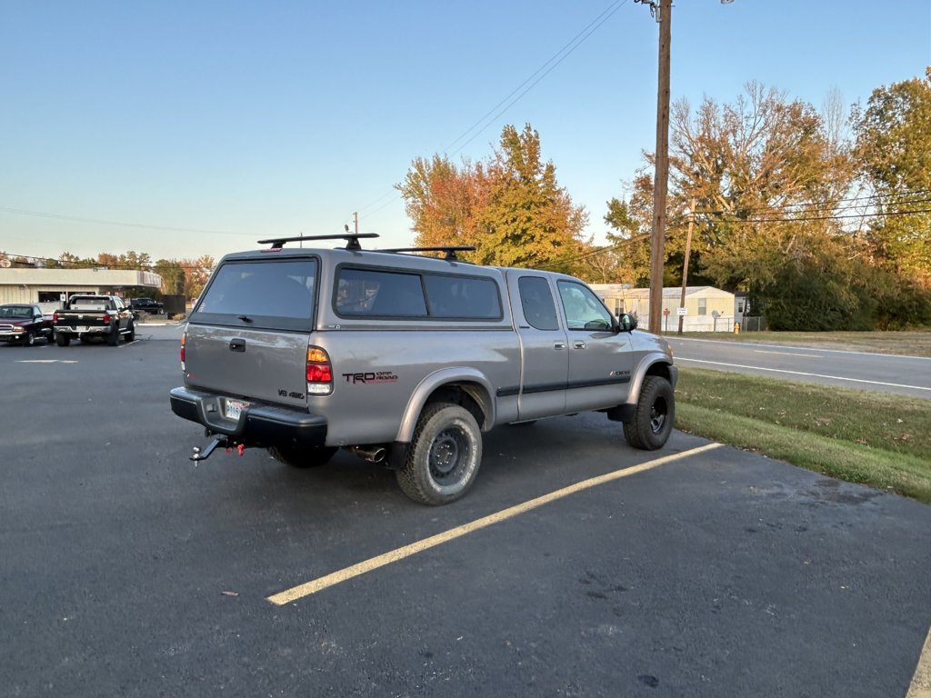

    I never posted mine either it seems. 285/75/16 on 16x8 wheels with 4.5” back spacing.

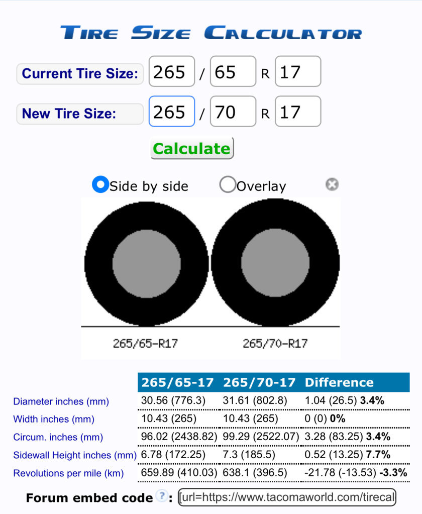

    The "65" on my spare tire.....if I replaced all of my tires with P265/65/R17's....how much of a height change would that have?
    Conversely if I replaced my spare with a P265/70/R17----it would fit under the bed fine, right?

    About an inch difference. The larger size would fit as your spare.

    How big of a problem would running that spare cause being one is less in diameter?

    That smaller spare wouldn't be ideal. Would be ok to get you to the tire shop at in-town speeds.

    Nice looking rig. Are you still running stock gearing?

    Thanks. No, I'm running 4.56 gearing.

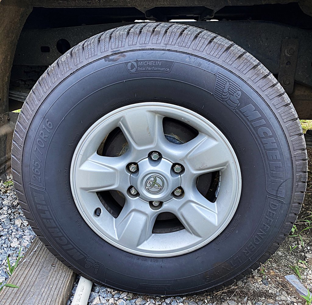

    265/70R16
