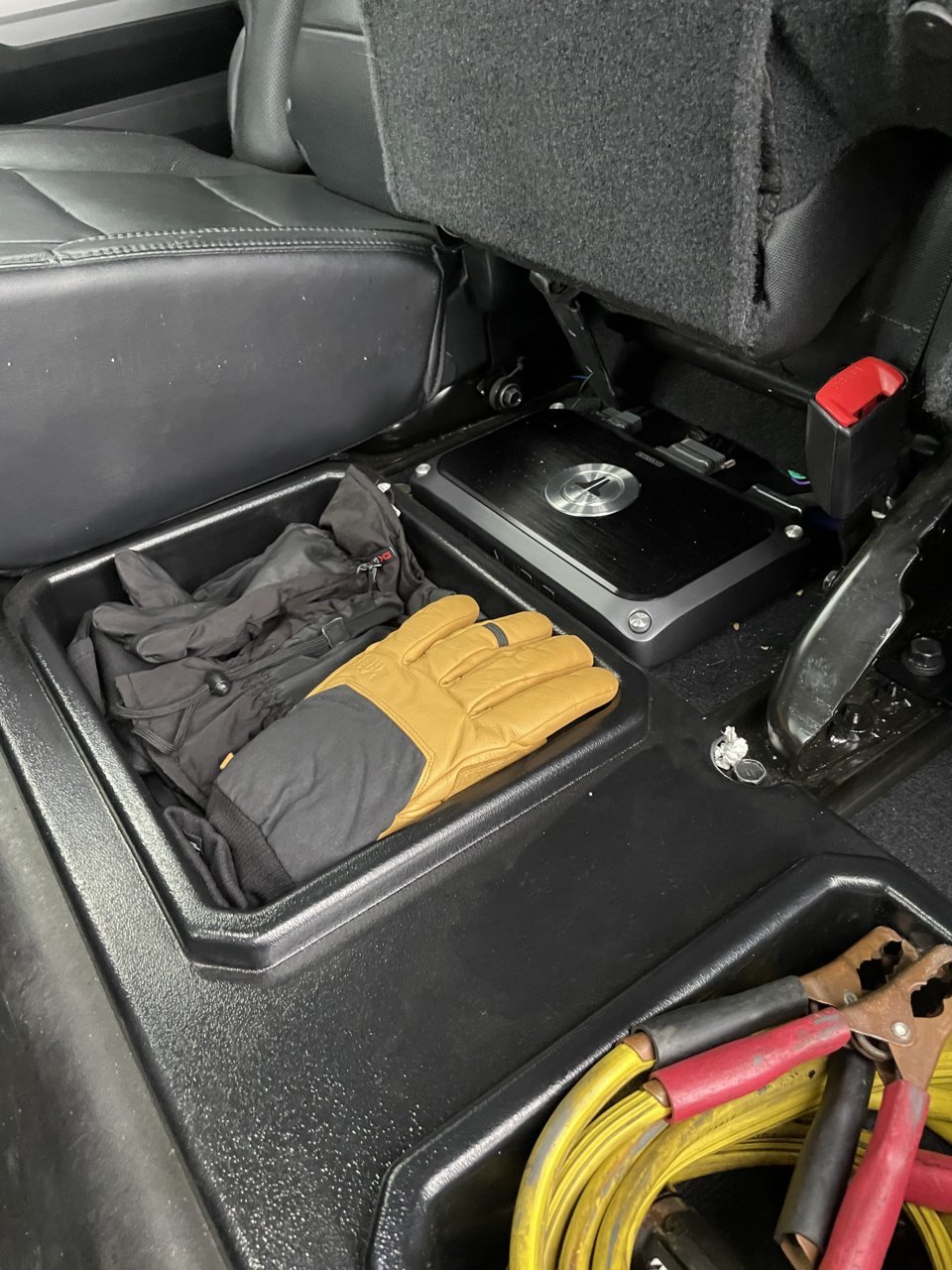

    Here is what I ended up using on my install.
    -VX1000 5 channel , rear doors left stock for fill.
    -Audison 6.5" w/crossover. (separates with tweeter in sail panel) No center speaker.
    -AMPPRO add-on TOY interface
    -Stinger 4 gauge amp kit
    -JL audio stealth box 2 10tw3's

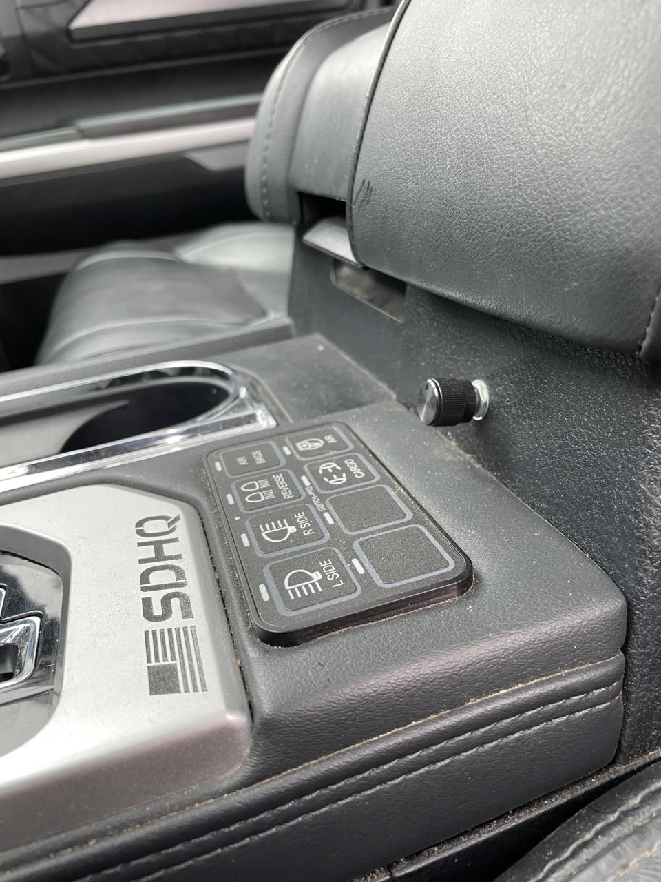

    BTW here's the amp location and my sub volume control location. Excuse the mess, I have two boys :)
    I like that spot because my fingers are right there when my arms on the armrest.

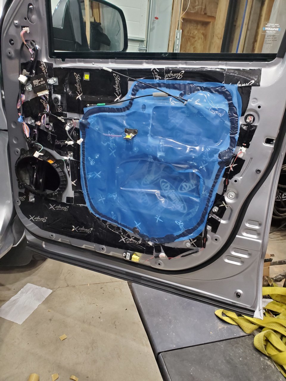

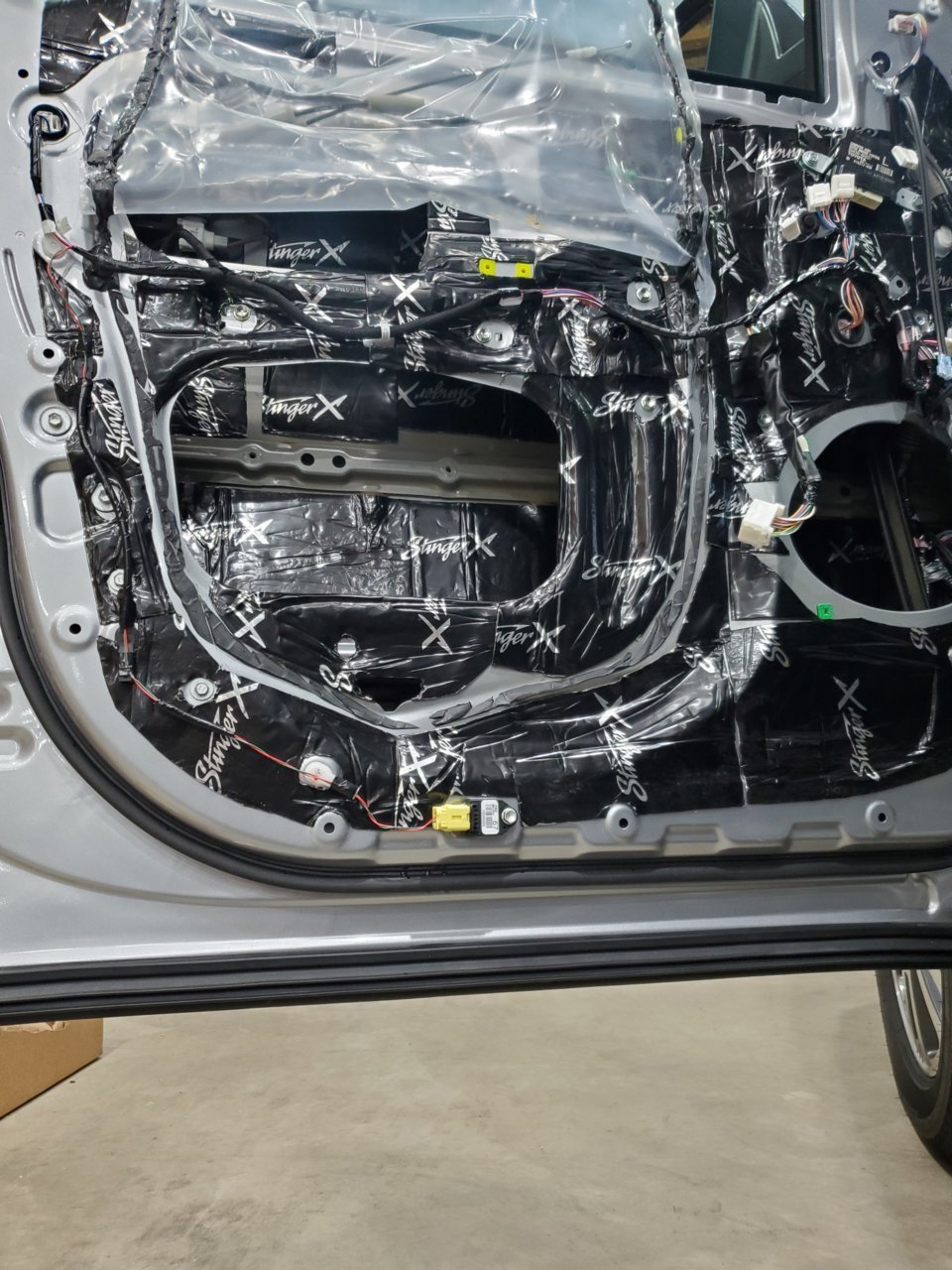

    So a quick update on my progress: For reasons only German car-owners can appreciate, today I unexpectedly got to put about 30 miles on the half-reassembled '21. I'm thankful that
    1) I had pulled it out of the garage last night, and
    2) it was re-assembled enough that it only took about 10 minutes to get it roadworthy. I'm sure I got plenty of looks with my AMP harness all wire-tied up under the frame on both sides lol

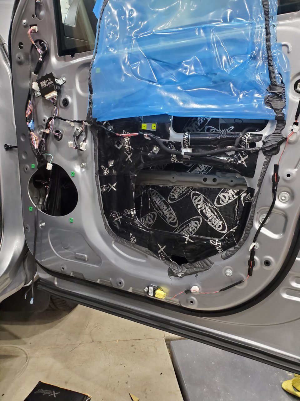

    Following all the work I did packing the floor, rear wall, doors, and roof with dynamat and following that with closed cell foam insulating pad, the difference between the two trucks is quite remarkable. The 21 is AMAZINGLY quiet inside now. I got back into my 17 for a bit this afternoon too just to compare. It's true that I still have my A/T's on that one and street radials on the 21 but the 17 was SO much louder. I was truly shocked (but pleased that all that work seems to have paid off) at how big of a difference there is. I hope it is still that good once I get my A/T's moved over to the new one.
    Now, back to why I had to drive a half-reassembled truck.

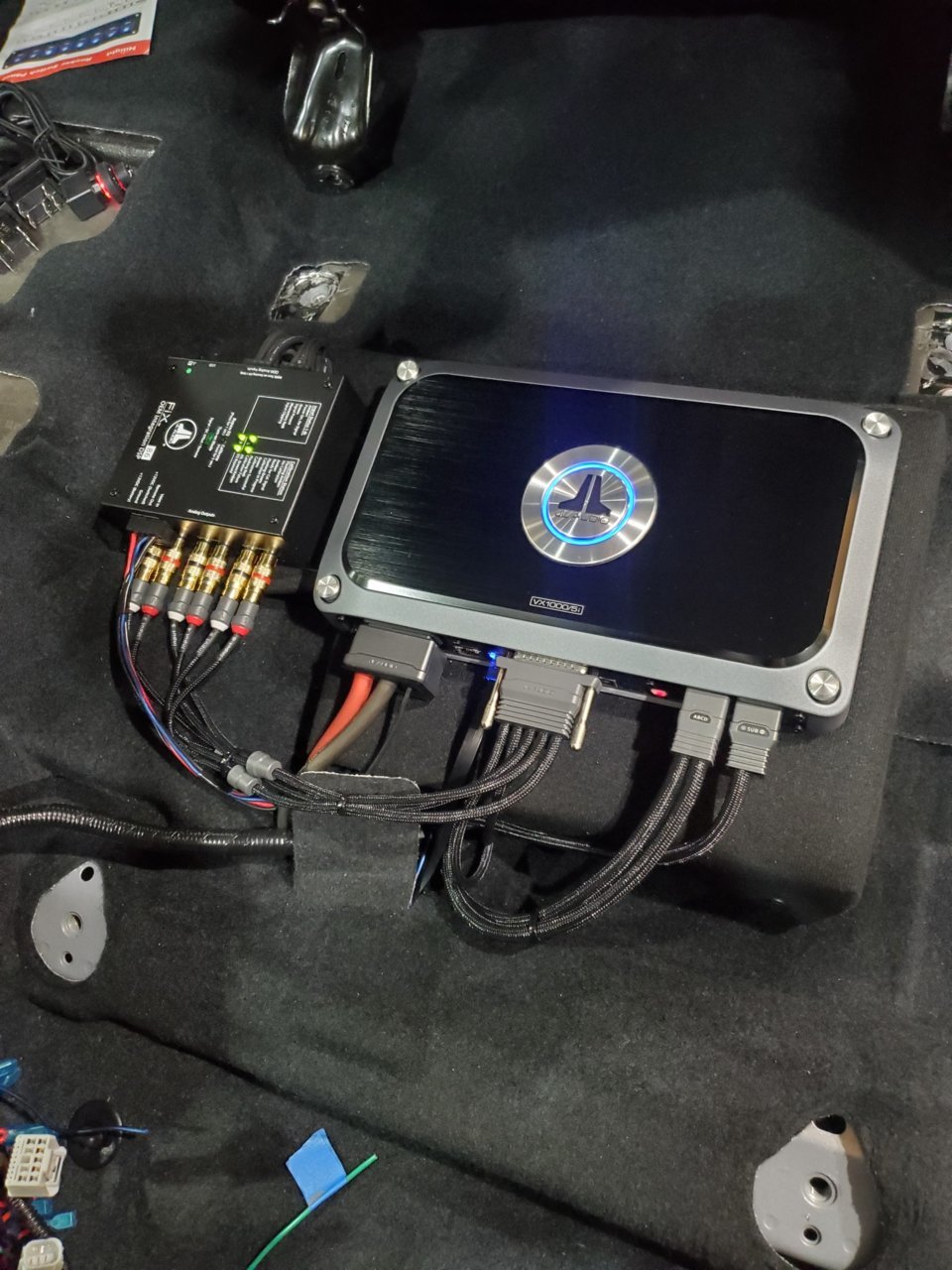

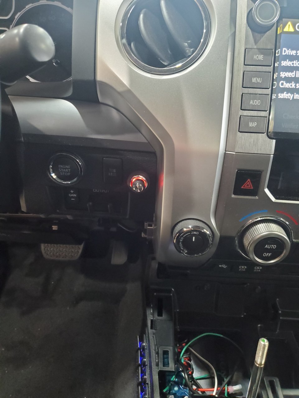

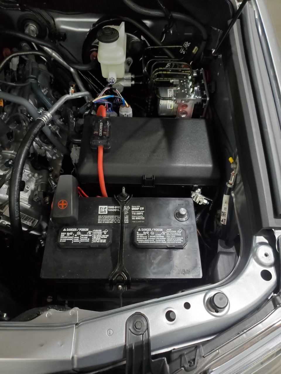

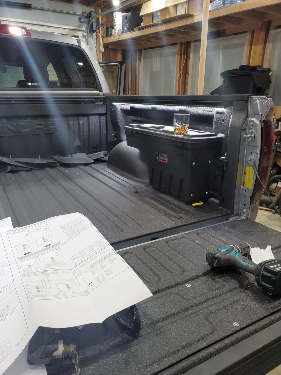

    A few more pieces have moved forward over the last 48 hours. Got my amp wired, accessory circuit tested, all the wires to my back relay panel work as they should. Very glad because I wasn't looking forward to ripping any of that out to fix problems. Started this morning at 4AM on the passenger front door. one layer of dynamat inside & out, one layer of closed cell foam. This truck has eaten 80 square feet of dynamat so far. Probably close to 100sf by the time I'm done matting the other surfaces I want to hit. I'm kicking myself a little bit for not doing the inside of the rear doors before I got them all back together. Check out the video of the difference:
    https://www.youtube.com/watch?v=1RIsQk5oeLg&feature=youtu.be
    There's actually a ton of aftermarket wiring in here. It took some work to hide it all in as close-to-factory routing locations as possible. All that's visible to the untrained eye is my 4ga amp feed. I mounted the fuse holder with machine bolts using rubberized insulating washers on the back side of my fuse box lid to keep the penetrations watertight.
    Trying to keep everything serviceable is where the time gets spent on a project like this. After dynamat and foam, I can still get to every service port and bolt in case I ever need to get back in here again for maintenance.

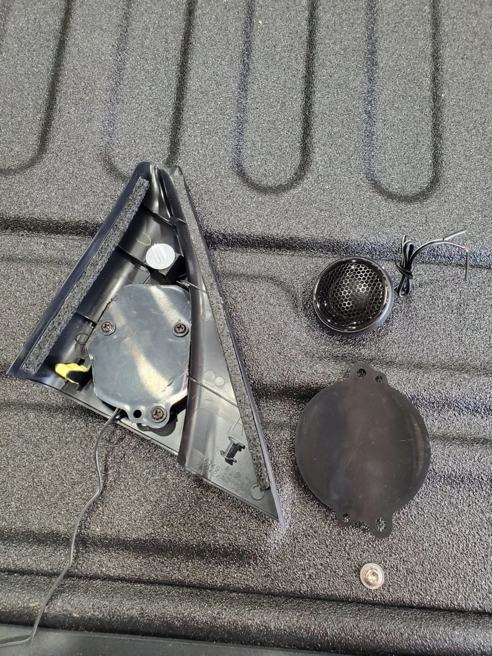

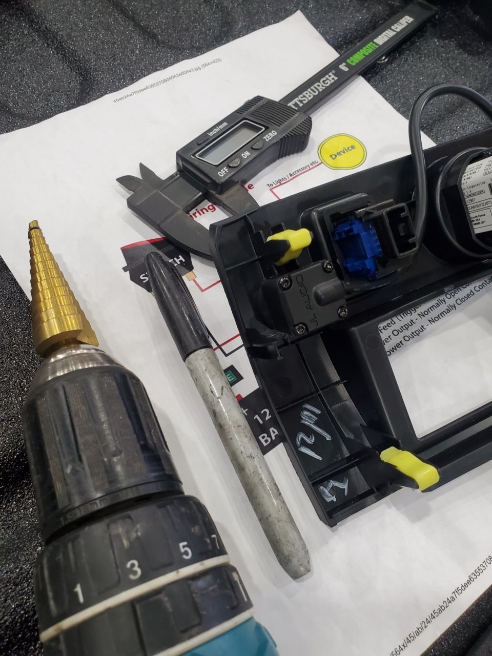

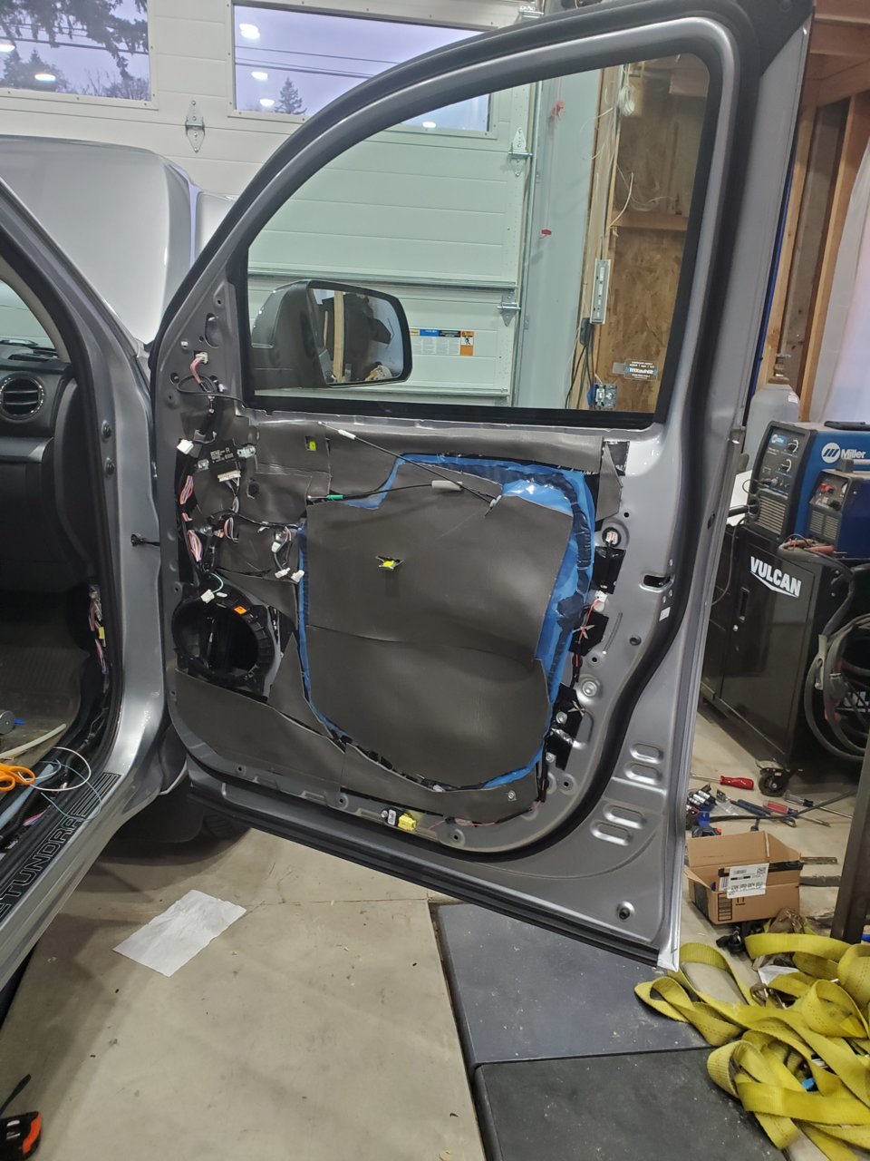

    Interior is starting to look like a truck again. Two more pieces need to arrive before I can completely button it back up. I'm still waiting on my ESP longbox (due next week), and the rear tailgate lock (No ETA - still on backorder). If those things were here already I could be putting the interior completely back together this weekend.
    Crutchfield sent these fit-kits with my tweeters. After cutting and drilling, they worked really well. If I ever sell this truck I plan to pull the stereo so I didn't want to go crazy with chopping up truck pieces.
    I've gone through 92sf of dynamat so far. will probably make it past 100sf by the time I'm done.

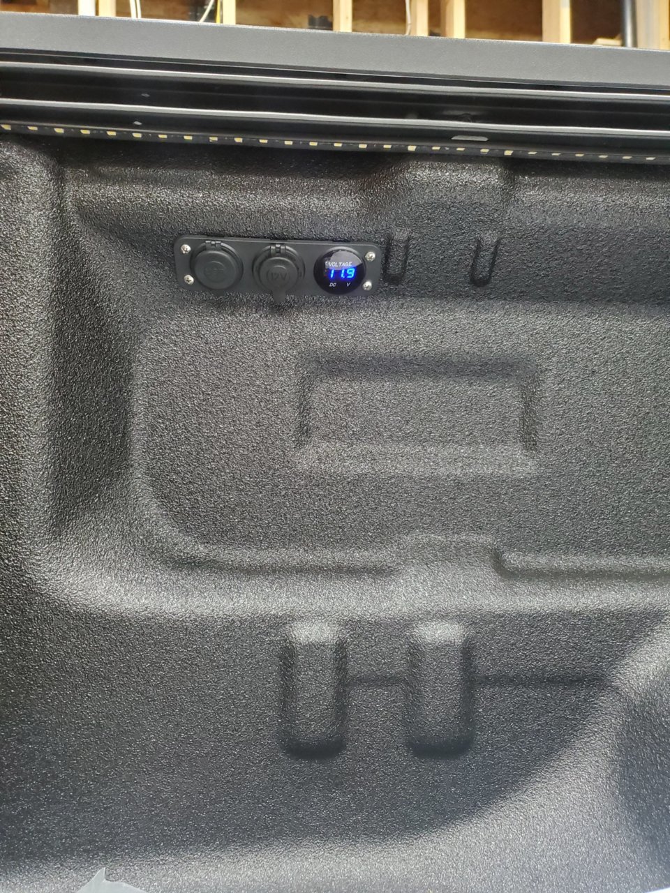

    Bed power turns on/off inside the cab.
    Bed lights turn on/off with factory cab light.

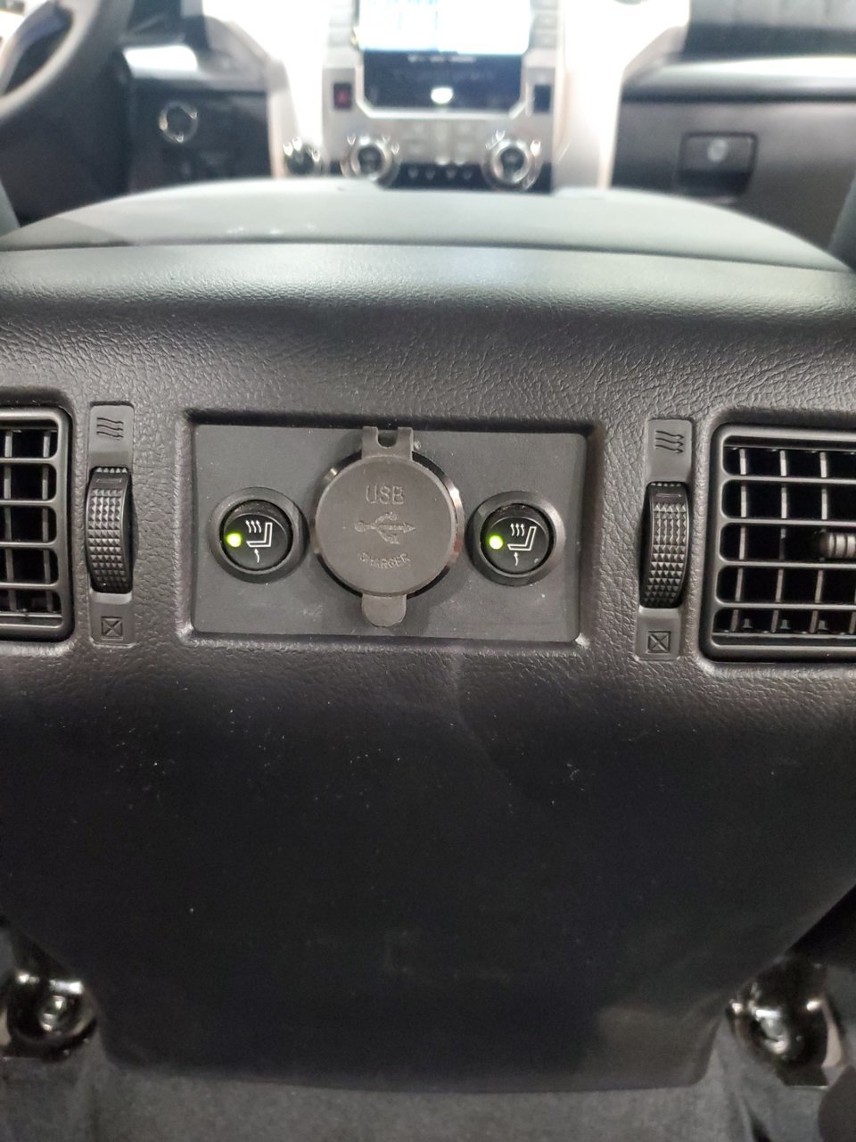

    Rear heated seats turn on/off with my switch panel, so I can make sure they don't get left on by the kids. Also replaced the useless cig lighter plug with 3 USB ports.
    Amp/Fix under driver's seat. I built the rack out of sheet metal and wrapped it with black headliner material. It's not an exact match to the carpet but close enough for me.
    This switch panel will serve the purpose I set out for it and the location works well for me, however I'm now wishing I had gone to one of the pushbutton panels. I didn't know about those yet when I was ordering all my stuff though. Oh well. Front to back is bed power, front light bar (activated with high beam), rear seat heaters, and nav-in-motion.

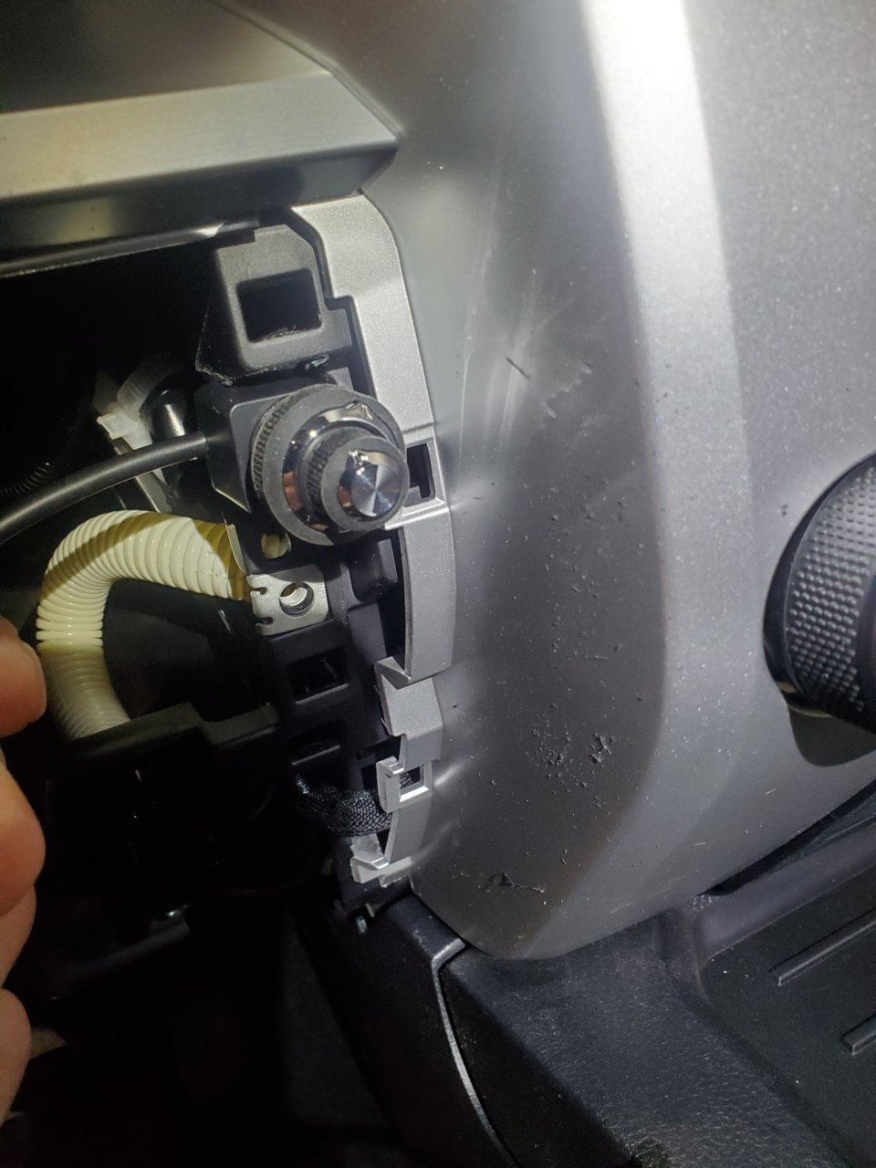

    This one deserves its own update because of how intricate it was.
    The updated JL Audio control knob thingy now has the status LED built into the knob so if I put it under the armrest (my favorite location, personally), as many have done with the DRC-200 model, I would not be able to see the status LED. So I instead opted to snug it in next to the tow/haul button. Getting it there took quite a bit of re-measuring and re-re-measuring with my caliper but it does fit if you're extremely careful with the hole placement. I think this is probably the best location for my purposes. I wanted it out of the way, but still accessible and line-of-sight.

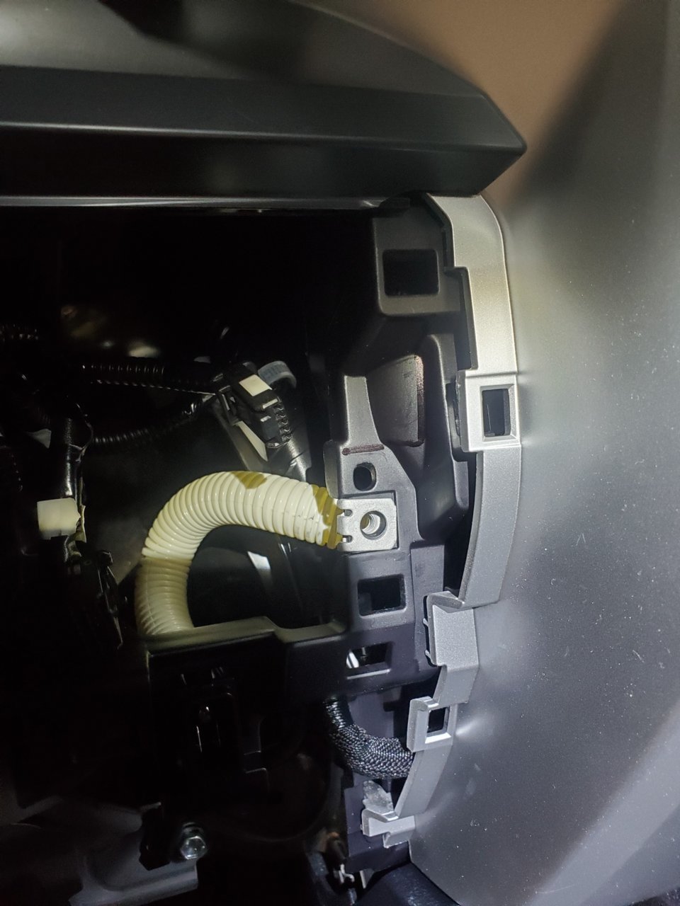

    Sharpie marks where I'm about to cut. Be very careful here as the airbox is right behind this chunk I'm about to remove.
    If you look carefully you can see the little nibs I had to shave down on the back of this panel.
    Again, I would have preferred it under the armrest like everyone else does but this is a decent second. Now I can see the status LEDs without taking my eyes off the road.
  28. Jan 10, 2021 at 4:15 PM

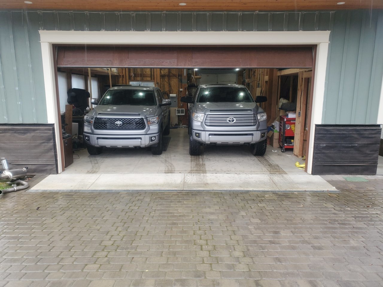

    Going with an 18' wide by 9' tall garage door may quite possibly be the single smartest decision I've ever made. I brought both of them into the garage for a bit so I can swap the wheels/tires. Will sell the 2017 with the OE wheels/tires off the 2021.
    thetastelingers likes this.
