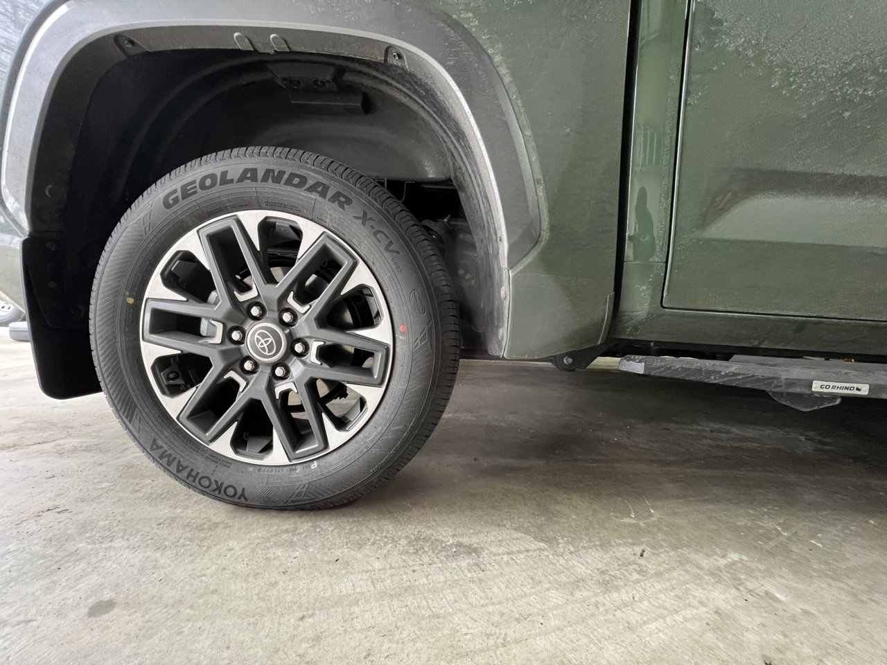

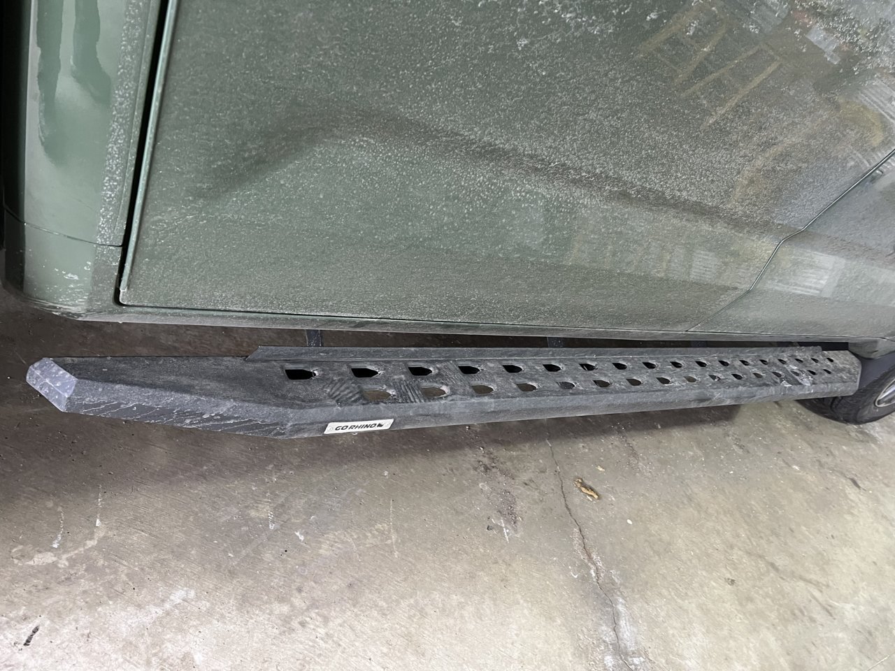

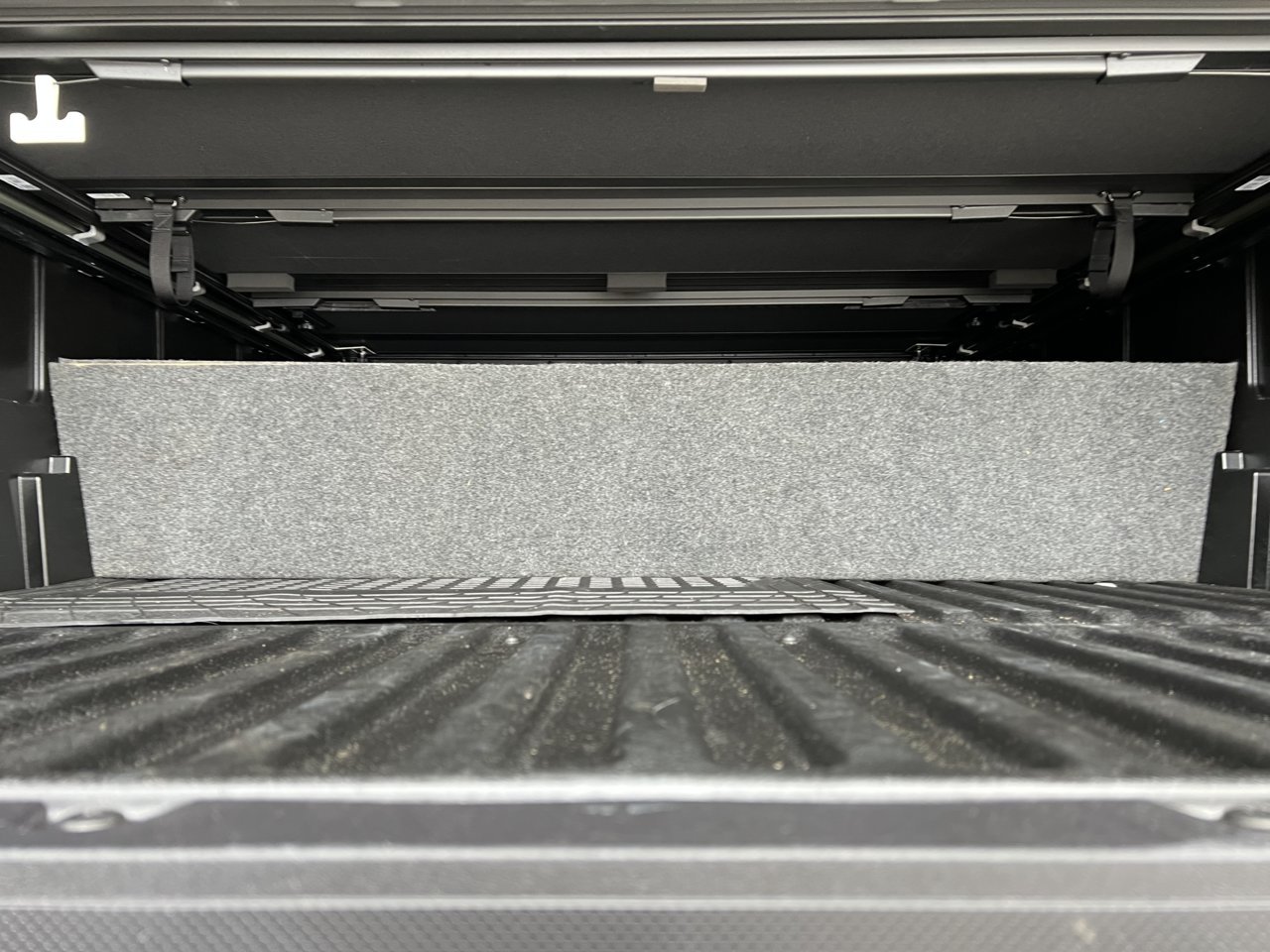

    Installed steps and mud guards, and made a bed divider

    Tell me more about your bed divider, please and thank you!

    Sure...I cut a piece of 2x12 cedar to fit the channels between the bed. I left about 1/4 of an inch on either side for the carpet, and used a router to eliminate the sharp edges.
    I had extra carpet that I bought locally for a previous boat trailer project. I just wrapped and stapled the carpet on the cedar.
    Behind the divider, I have small pieces of exercise mat that shim the divider to prevent it from moving within the channels of the bed.

    That looks great and adds a lot of functionality. This would be a nice up-grade but I'm not sure I have the tools or the talent to do this myself. Hate to pay a shop to do it as I don't want it chopped up. How long did it take you?
