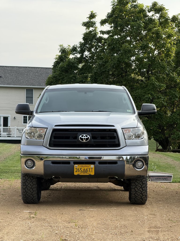

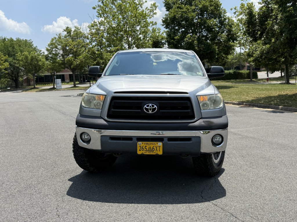

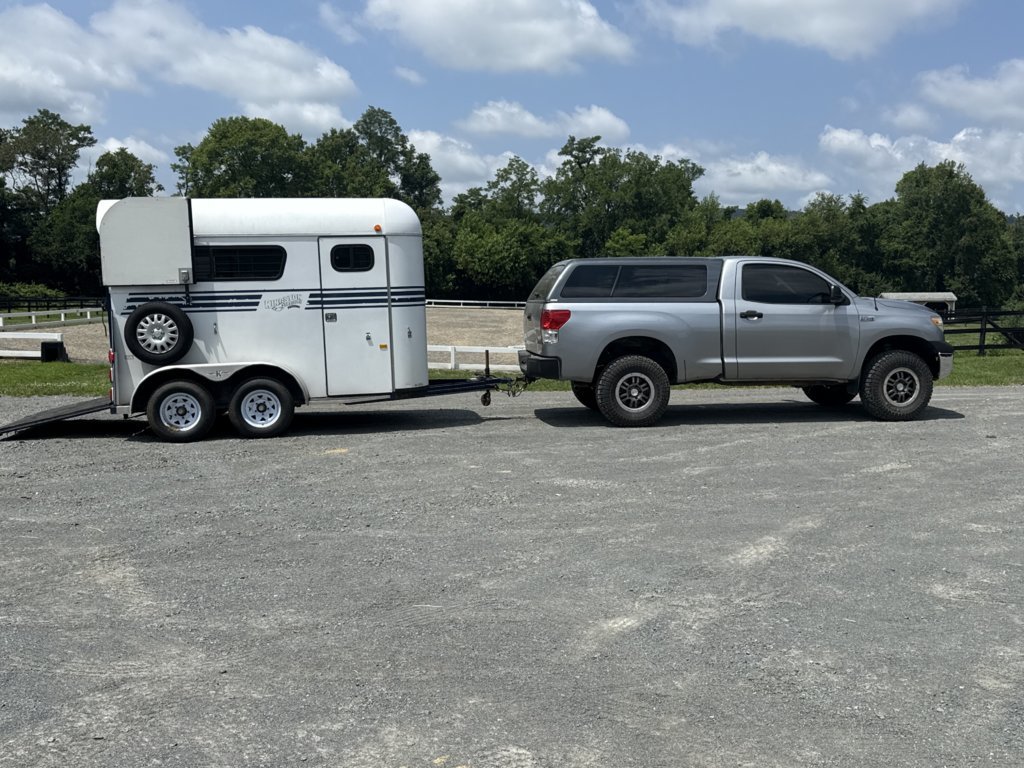

    Got lucky and found someone parting a silver tundra near me. New headlights and bumper trim
    Before
    After
    also took the horse for a ride
    chugs, The Dude, ZPhilip and 9 others like this.

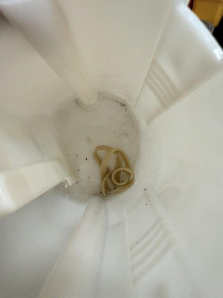

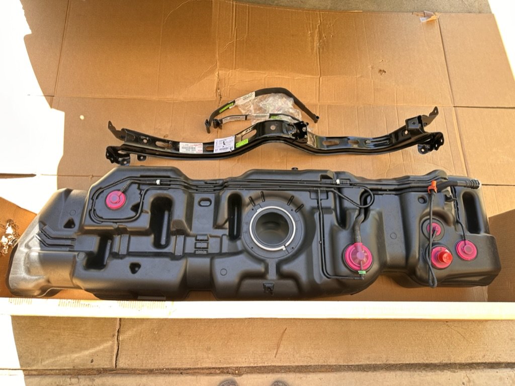

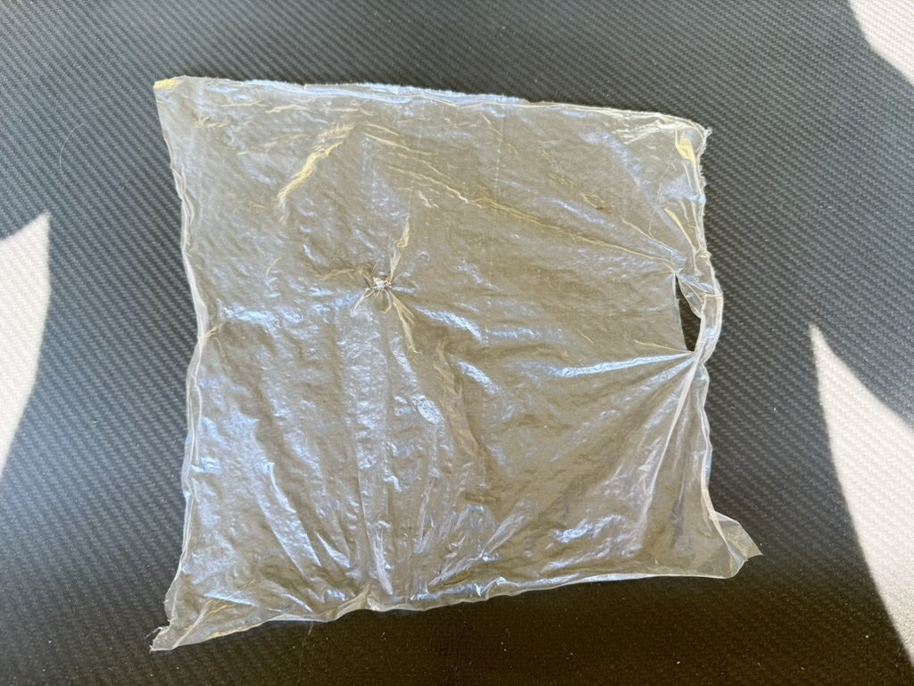

    I was 1,200 miles away from home on vacation, when I experienced sporadic loss of fuel pressure. The first time it happened, I was on flat interstate with my toy hauler in the middle of rush hour traffic. Ambient temp was 95º and I had been driving for the past 8 hours. I had a little over a 1/4 tank left, and noticed fuel temps exceeding +125º! I was able to lightly use the accelerator, having intermittent fuel pressure, and worked my way over to the shoulder. I had 15 gal of gas cans with me and dumped it all in bringing the fuel temps down to 90º. It restored fuel pressure just enough for me to finish the drive to a gas station, but I couldn't add more than 40% throttle (I have PE set at 41% throttle on account of boost - in other words, ECU commands more fuel at 41% throttle, going into open-loop with AFRs at 12:1 or less).
    Later, I started losing fuel pressure whenever the tank fell below half, on top of having high fuel temps.
    I made it to my last destination and ordered a URD upgrade pump, had it shipped to my location, and was ready to install it while I was on the road.
    Now a little back story - 2 years ago I installed a 38 gal tank. What I didn't realize is that there was supposed to be a plastic sheet covering the opening for the fuel pump.
    Tank at unboxing...
    After dropping the tank on my recent trip, I found that I did in fact have the protective plastic... it must have come off during shipping and I didn't see it in the tank before installing.
    Plastic stuck in pump housing intake and wrapped around float:
    Then I found the rubber band that would have been used to hold the plastic over the opening:
    Got it all cleaned up and put back together. Needless to say, no more fueling issues!
