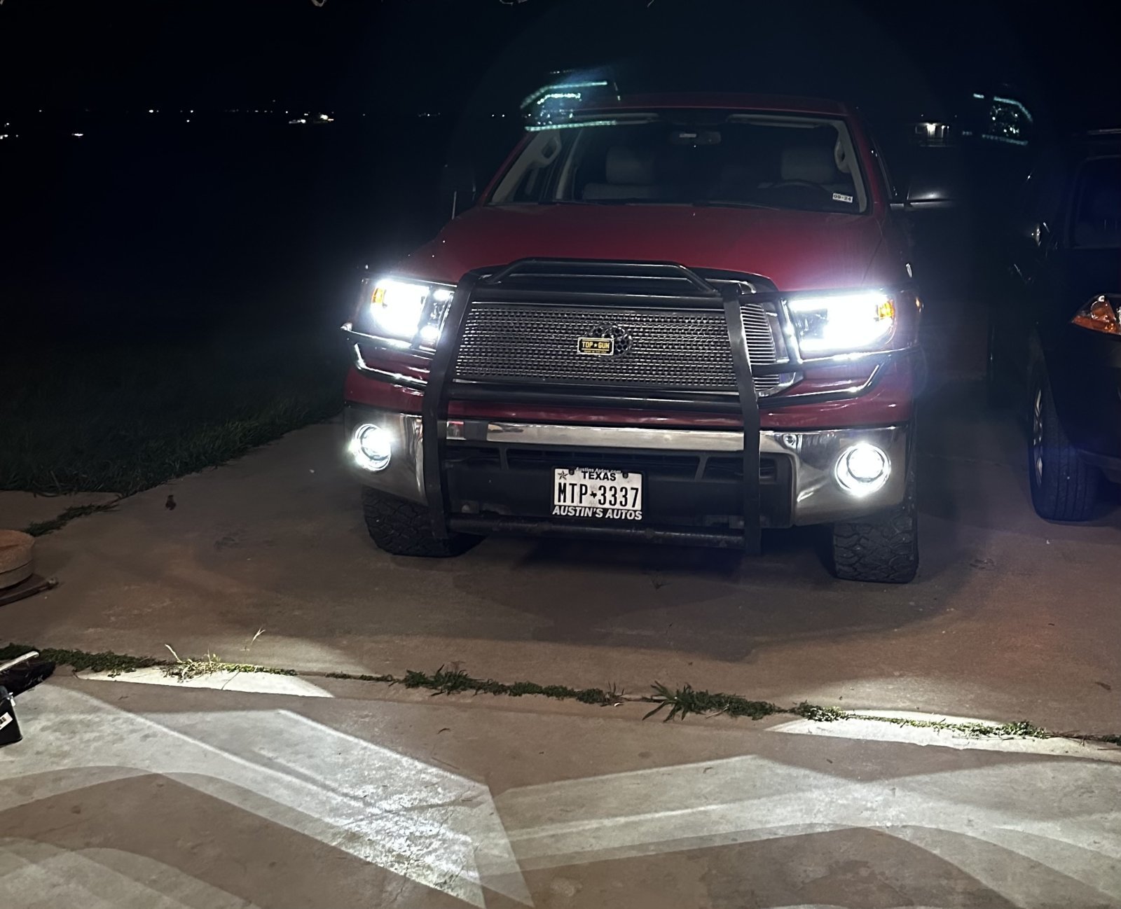

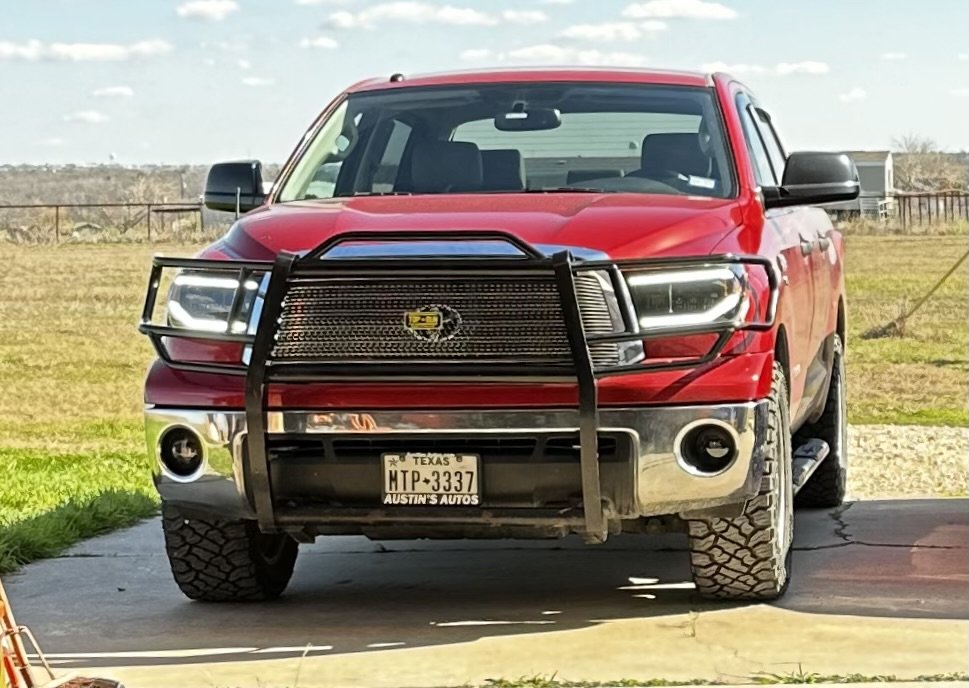

    That’s a very unique light pattern on your driveway

    I had also noticed this, at first thinking that I had something wildly misaligned. I figured out that it was from reflections off of the grill guard. As is my sci-fi nerdy nature, I stated to my wife "it kind of has a Romulan or WarHammer look to it." She replied "it kind of looks like the WonderWoman logo. Ish." And with that, any and all efforts on my part to apply some nerdy guy coolness disappeared like a loose balloon farting its way out of picture.
    The DRL's are insanely bright. (Not a complaint).

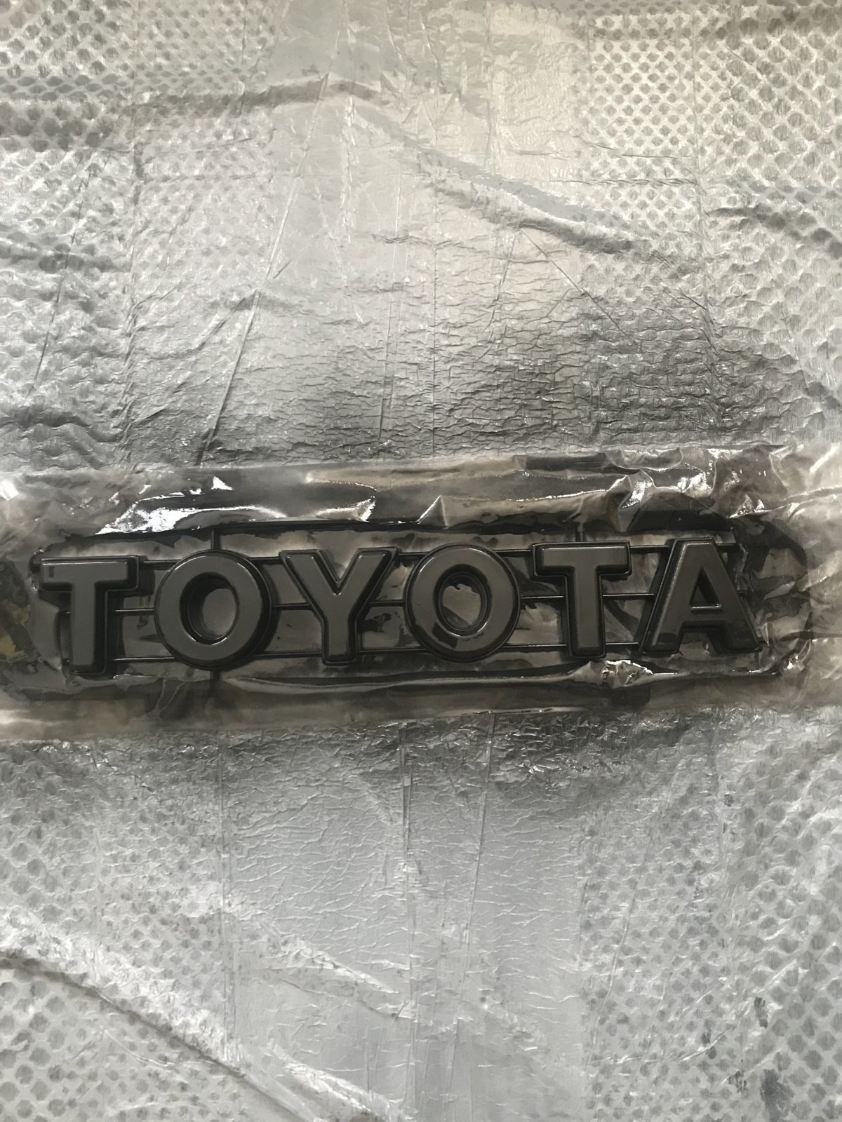

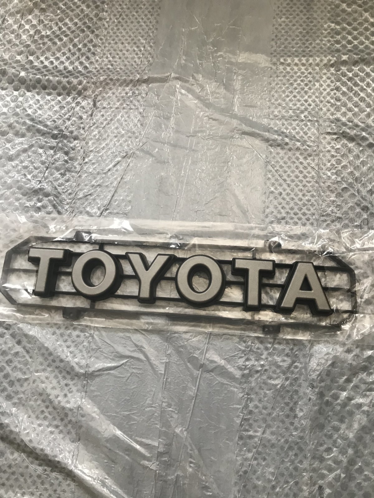

    Started painting the grill insert for my new grill.
    Before
    After

    I'd like to be able to find a Yota logo like that but that would fit in the emblem area on the Rock Warrior grill. Anyone?

    What paint did you use?

    my favorite truck mod paint; Plastidip. It looks really shiny when wet but dries matte. It's wet in the pic.

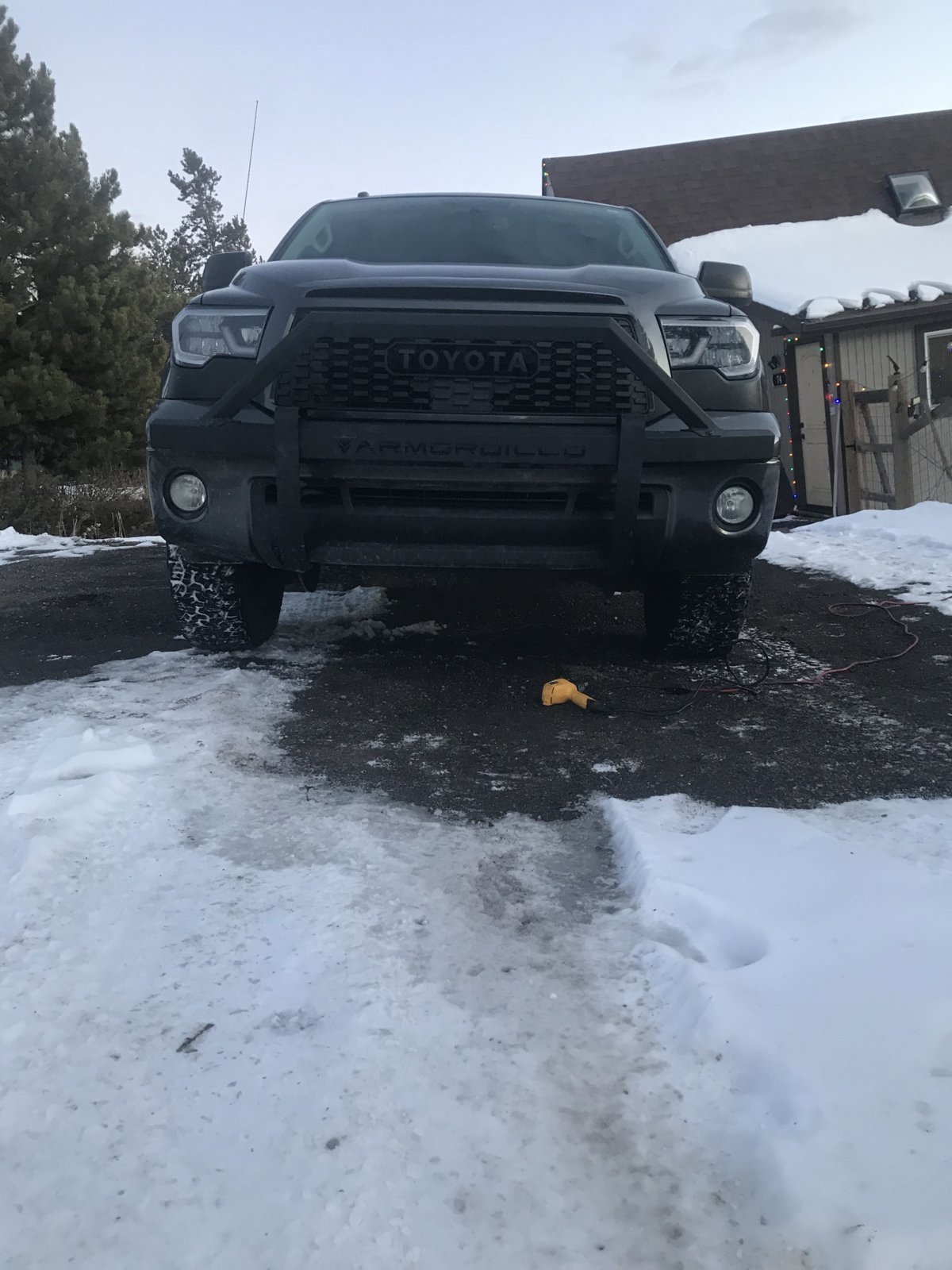

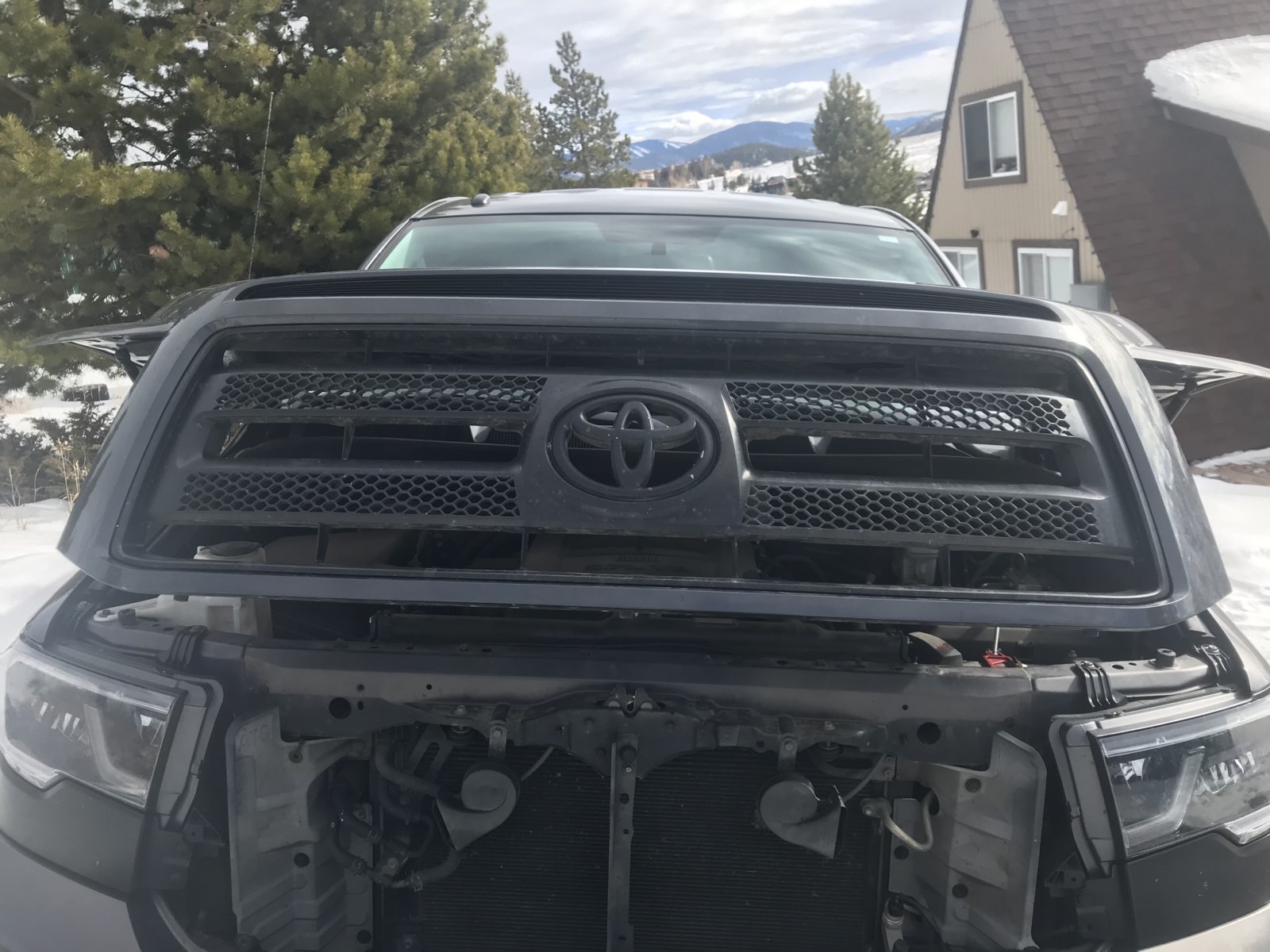

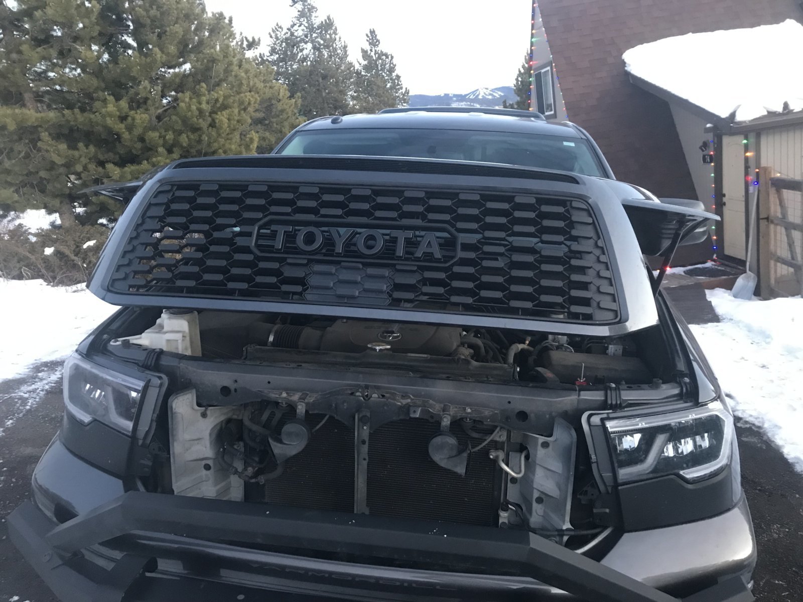

    Well I spent almost 4 hours installing the TRD pro grill insert today. Temps got into the mid 30's so it wasn't too bad taking the grill off then moving inside to complete the insert changeover. I likely fiddled with it longer than I should have but I was mindful of not wanting to break any tabs. Tedious is an understatement. With lots of patience I was able to complete the install without breaking any tabs off the grill surround while taking out the OG Rock Warrior Grill insert. I did notice that I was missing a few of the yellow female connectors that the top of the hood bulge pins go into, but that must've been from the previous owner.
    The hardship for me today was losing my favorite gearwrench 10mm socket into the engine bay while reinstalling the grill. Im super ocd about tools and placement of them and that 10mm has been with me since I was in my 20's wrenching on dirt bikes, (I'm 51 now). As my wife says, I'll probably talk about that socket for the next few weeks bemoaning my atrocity. Beyond the socket mishap the grill looks amazing and the quality of the plastic is oem comparable. The grill came from https://goodmatchup.com/products/2010-2013-toyota-tundra-front-bumper-grill-insert-black-mesh.
    I also installed the 3d sensor cover that I got from @Rube207. I pried the sensor cover off with a pry tool and applied 3m adhesive then stuck his cover in place. It fit like a glove.

    Looks awesome and great patience not breaking anything. RIP to your 10mm

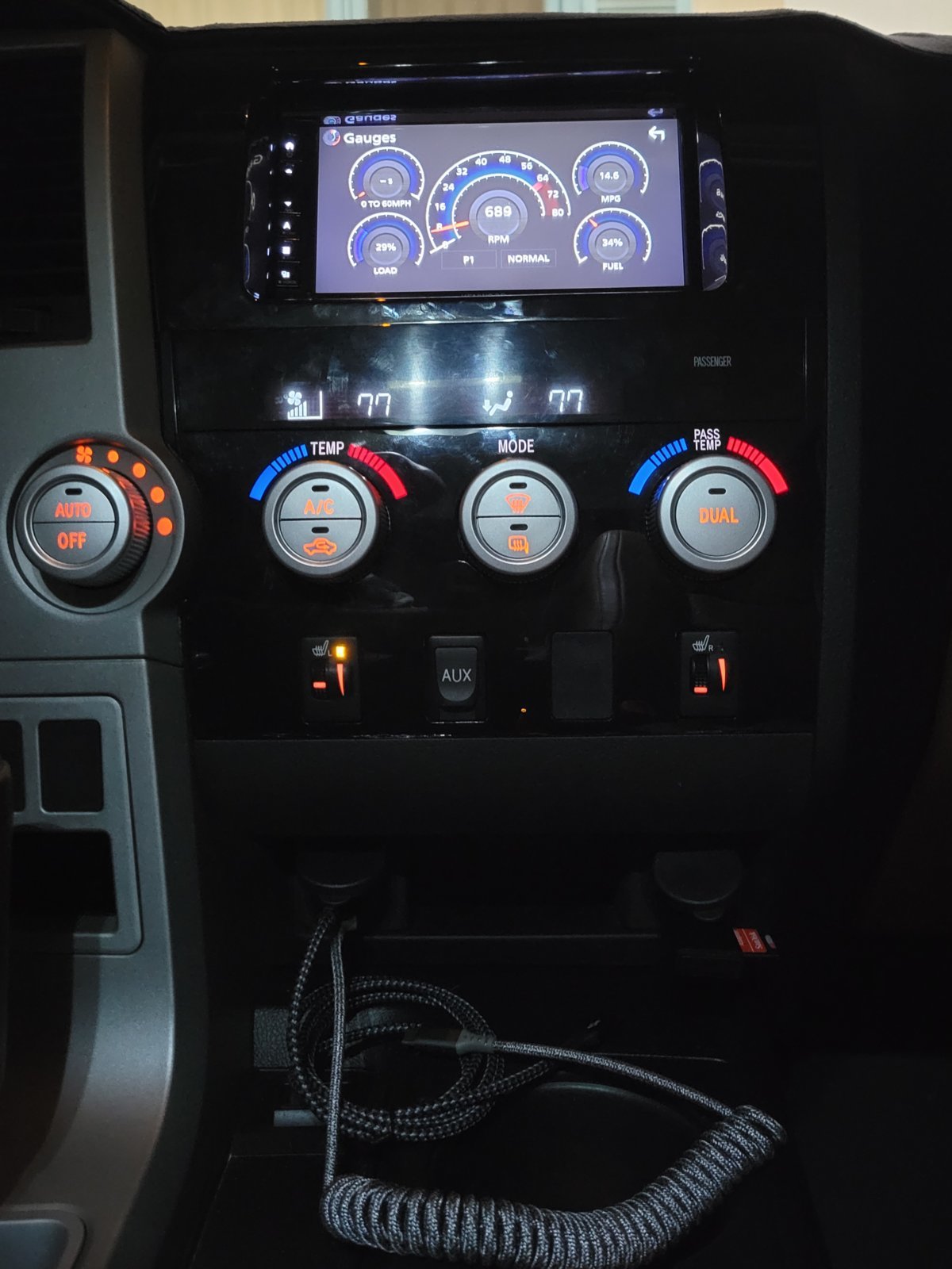

    It's been over two weeks and I've not completed the TPMS project. But, I did buy an Autel MaxiTPMS 508WF, so I'll never again need help with this system.
    Today I finished my 'other' project and invented something useful to all Tundra owners. A good start to 2024:
    Pictured is my installation of Kenwood DNX697S* with ADS Maestro RR2, 2-USB Inputs, AUX-IN (w/ VID-In), AUX-OUT (w/ VID-Out), factory Audio AUX-IN also retained and my invention: CAR-MIC-SVR.
    (I especially want to try the gauge in the top-left corner of the screen!)
    Stay tuned: https://www.tundras.com/threads/use-oem-mic-with-aftermarket-headunit.93038/. I'm working with another Tundras.com member (charliebison) to verify it will also install seamlessly in a 2019 Tundra SR5 with Maestro RR and a Sony head deck. Then the sky's the limit: other Toyotas? Honda? Pioneer? Alpine? Etc... On testing so far, I'm told the factory microphone sounds better than aftermarket mics. It should because it's powered. Plusses include: It's the factory MIC; It's hidden behind the roof console where it belongs; You never have to go near it during plug/play installation at the stereo harness while you're there installing the aftermarket head-deck anyway.
    *Footnote: DNX997XR would have been better but I don't like the fold out face... high-risk mechanism. Also, Android Auto phone mirroring is a real problem - a retro solution needs to be found!
