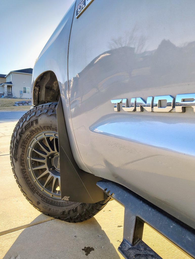

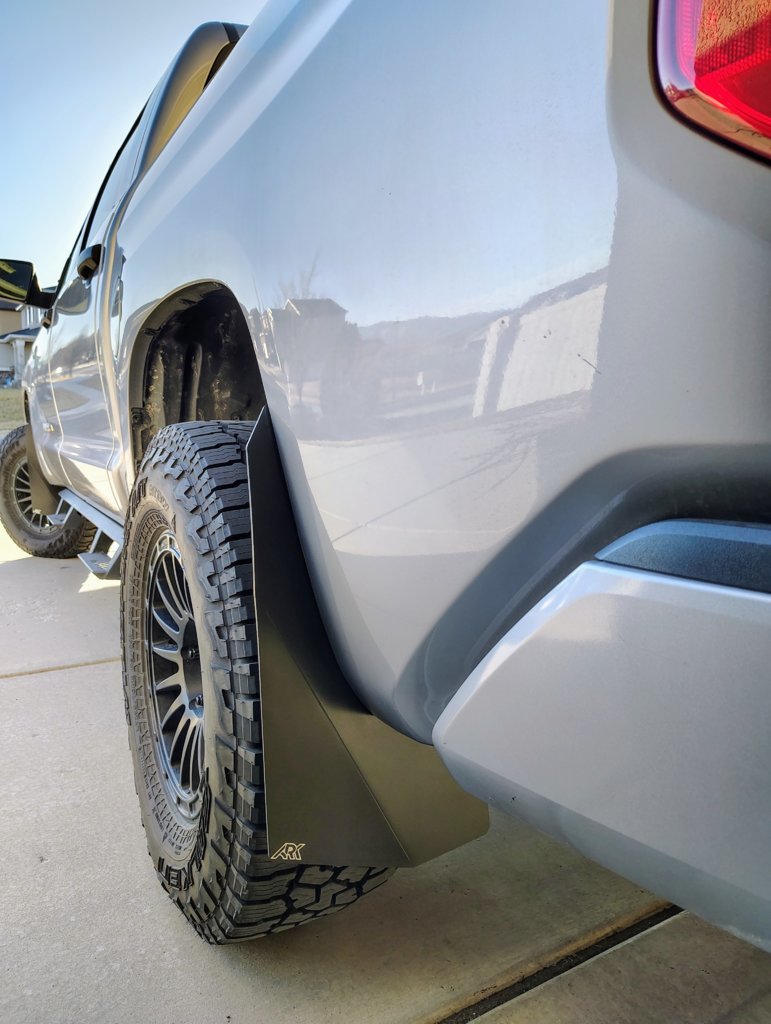

    I installed ARC mud flaps! Gives it a nice sporty look and should protect my rockers from rock chips.

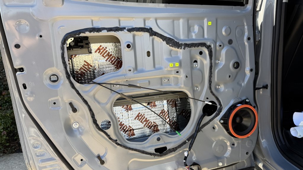

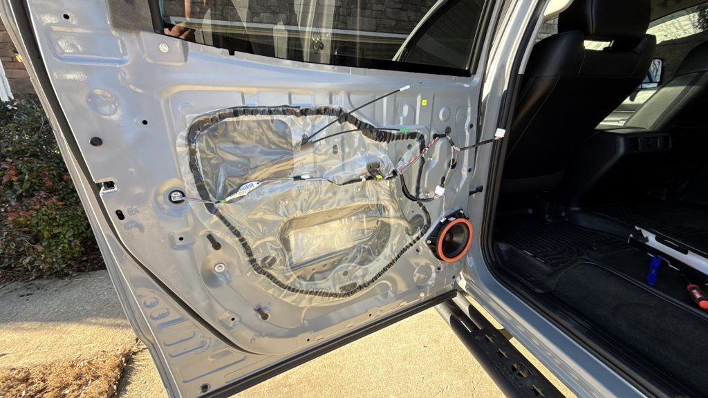

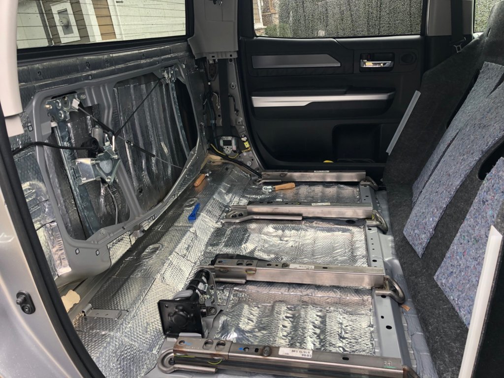

    Back at the sound deadening today. Wish me luck gents

    Can you choose how far out they stick? Or are the mounting holes pre-drilled?
    I’m on OEM wheels with stock offset; I like these, but I don’t know if I need mudflaps to stick out that much…

    They are slotted for vertical adjustment. Very little side to side adjustability. The holes are pre drilled. Mine are the full sized flaps. They sell micro flaps that may be better for stock wheels and tires.

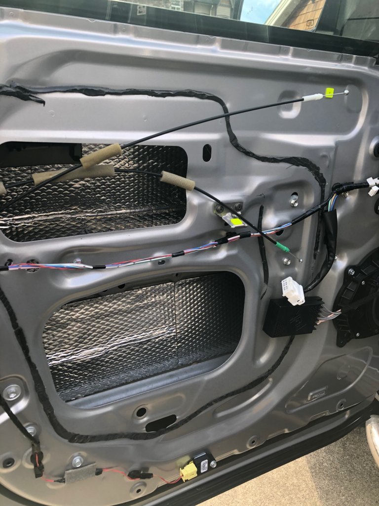

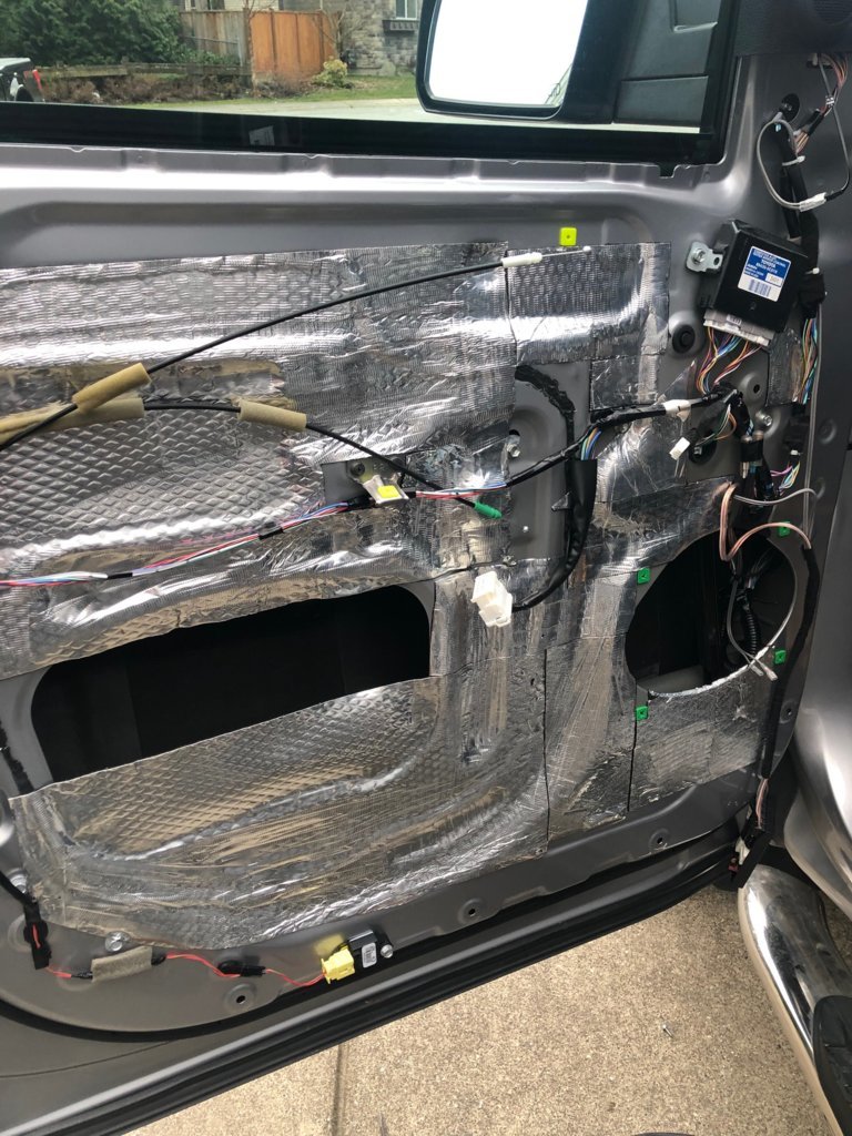

    Good luck! It is worth the effort! A quiet cabin at highway speeds is so much better
    I did the inside and outside door skins and the floor when I installed new speakers and subs.

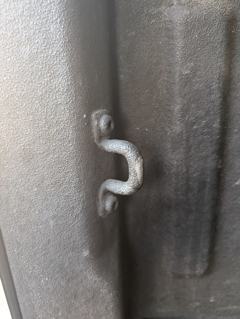

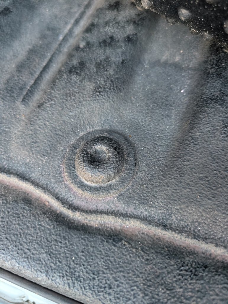

    Gosh. this is going to require some effort to install the bed stiffeners...
    no. they sell Total Chaos/Chaos Fabrications ones.

    Razor blade and it pops off. Not hard.

    I used a very small screwdriver to pry the bed liner out of the bolt heads. Once that is removed score around the perimeter and they come out easily.

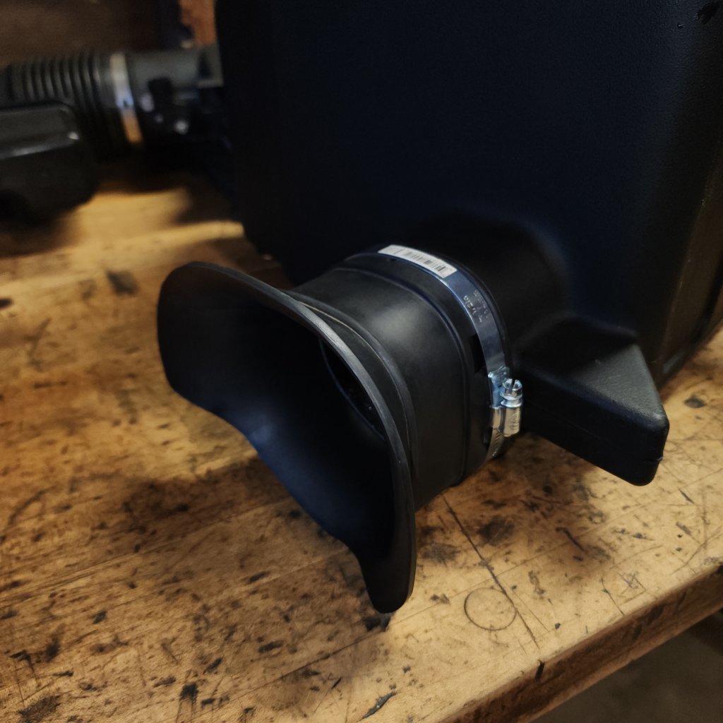

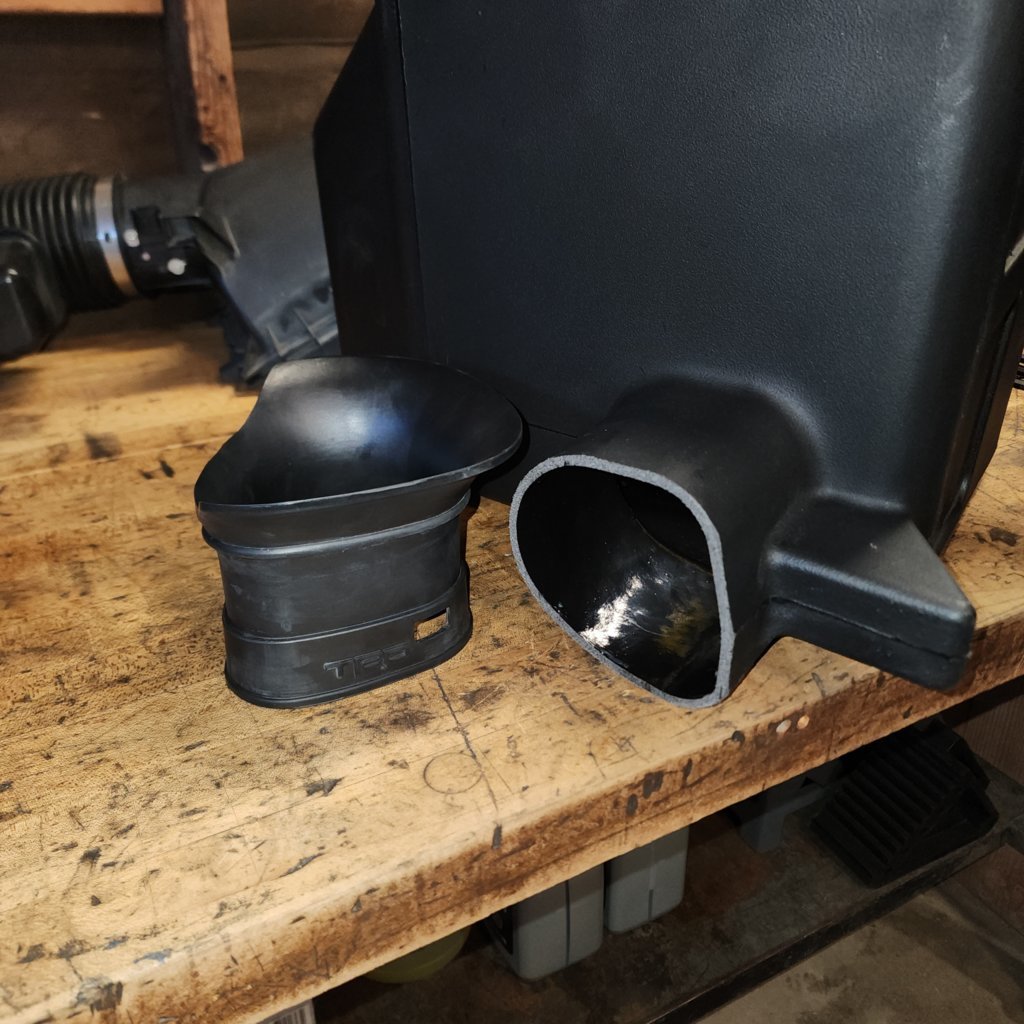

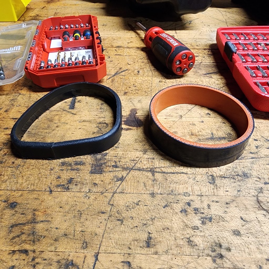

    Alright, for all of you cool kids who have installed your Stillen intake AND used the TRD air accelerator, give me some tips, please. I was able to persuade the accelerator on the intake with a heat gun to soften the accelerator a bit and slip it over the ridge. However, when installing the bottom of the accelerator won't go into the hole in the fender. Aight, then tried accelerator into the hole first, then intake, what a chore that is.
    Did anyone remove the coolant reservoir, for more room? I've tried prying that bottom piece as well, but don't have much in the way of leverage with the res in the way. Haven't even gotten to those 2 bolts for the box yet

    LoL. Told ya that was gonna be a PIA. That's why I ended up cutting up my box which I know you said you didn't wanna do. I shaved off about an inch from that and an inch from the throttle body coupler for proper fitment.

    Yeah, there's NO room. But I did see pics of someone who succesfully installed itno cutting and no clamp. I'll have to dig back through the threads on it and send them a PM.
    Even considered pulling the fender liner for inside access, but I don't have replacement liner clips on standby. It may go in sans accelerator, get clips, and give it another go this weekend

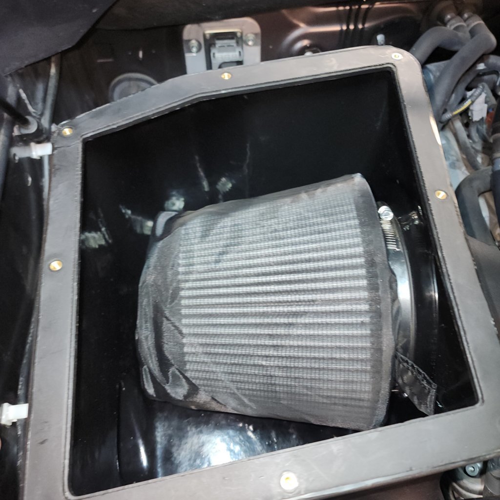

    No issues... So far! Stillen Cold Air Intake Mass Air Flow Sensor
    Here's a few pics from my install..
    Also, I didn't mount the box the way the instructions say to mount since I'm going to have to remove it for smog checks so Im using my own washers that made it a bit easier for me to install..
