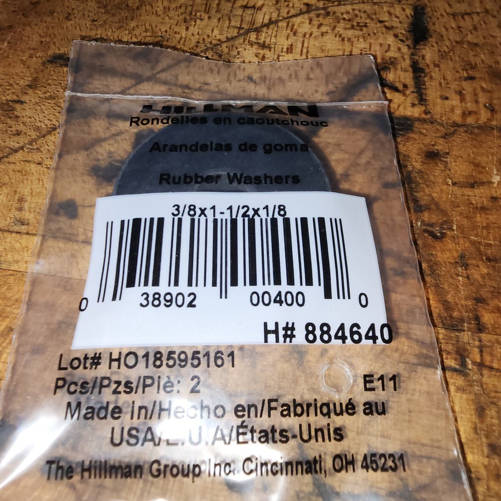

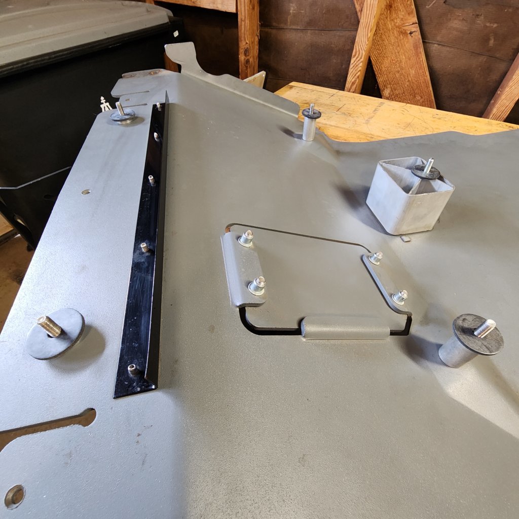

    I have an eBay knock off of the TRD skid but it's basically the same thing. I removed it entirely and placed the rubber washers so they sandwich between the skid n frame..
    I removed both my skids just to do an oil change and add the Fumoto Valve. Figured this was a good time to add the washers. It's pretty simple. Easier if you got someone helping you put it back on. Alone it took me I'd say maybe an hour for just the skid but I did a few other things in between. Removing and putting it back on.

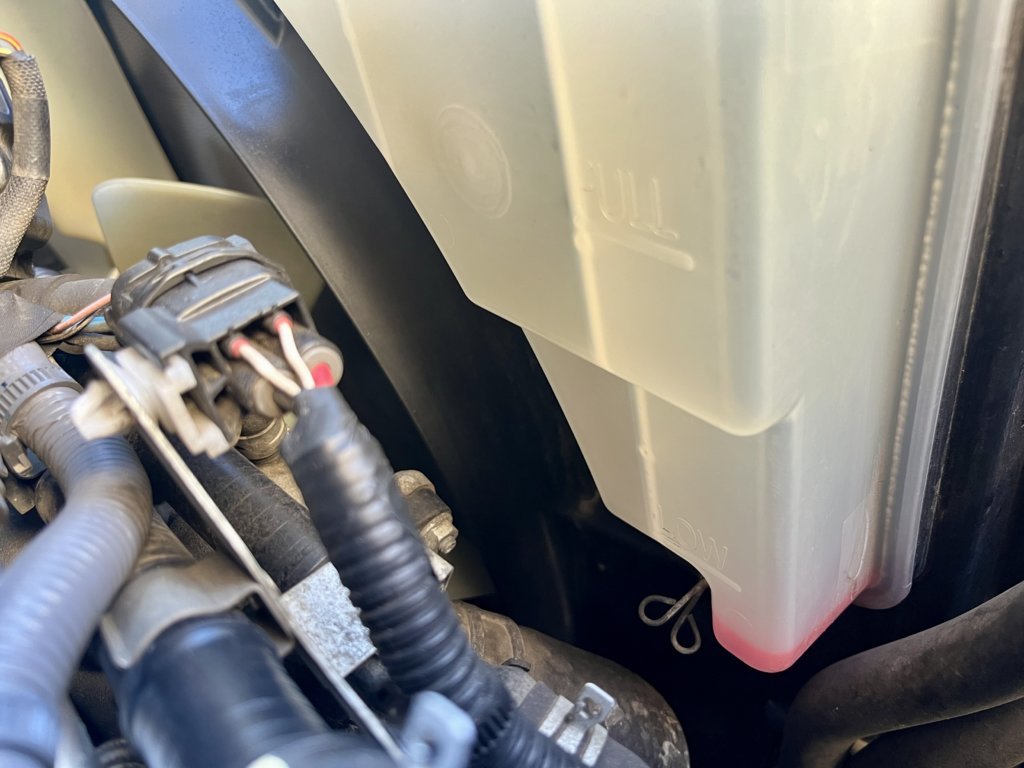

    Wow same thing happened to me too.
    smokint[QUOTED] likes this.
  7. Sep 14, 2024 at 7:46 PM
    CaptRussia253
    CaptRussia253 New Member
    May 15, 2022
    #78415
    1,394
    Ruslan
    Wild same here. Gotta add some tomorrow. Anything equivalent to oem that I can grab from autozone?
    smokint and pvn.beluga[QUOTED] like this.
  8. Sep 14, 2024 at 8:10 PM
    pvn.beluga
    pvn.beluga New Member
    Dec 28, 2020
    #56744
    2,008
    Phuc (Phooc)
    Connecticut

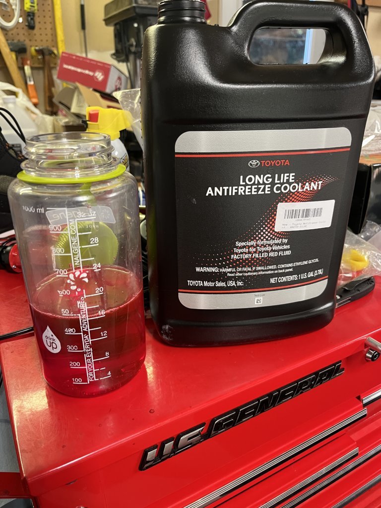

    I heard Zerex Asian is just as good. But I ended up buying a OE 50/50 jug for $29.
    Lassie and CaptRussia253[QUOTED] like this.
  9. Sep 14, 2024 at 8:52 PM
    CaptRussia253
    May 15, 2022
    #78415
    1,394
    Ruslan
    I’ll grab some Monday from the dealership.

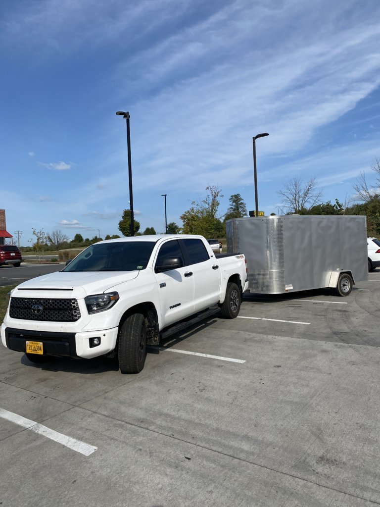

    1700 mile road trip last week from VA thru WV to KY and back towing ~3500lbs. Went pretty smooth with the airbag helpers set 18psi and had the trans t-stat pinned open. SG3 helped in monitoring trans temps. Got pretty good at using the go-pedal to get the trans to drop to 4th and let the torque converter lock up to keep trans temps lower going up the long steep grades in southern WV and eastern KY.

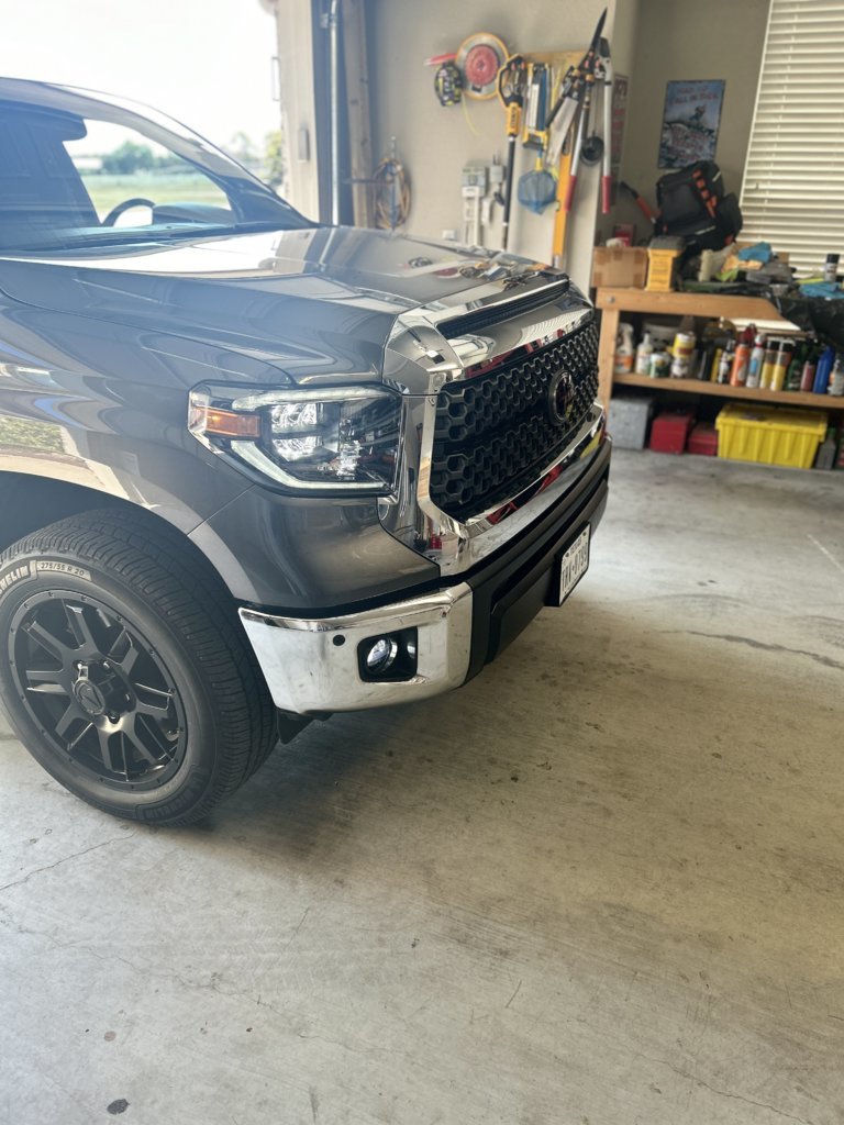

    IMG_0075.jpg Finally got my TRD Pro Headlight/FogLight assemblies installed on my 21 SR5

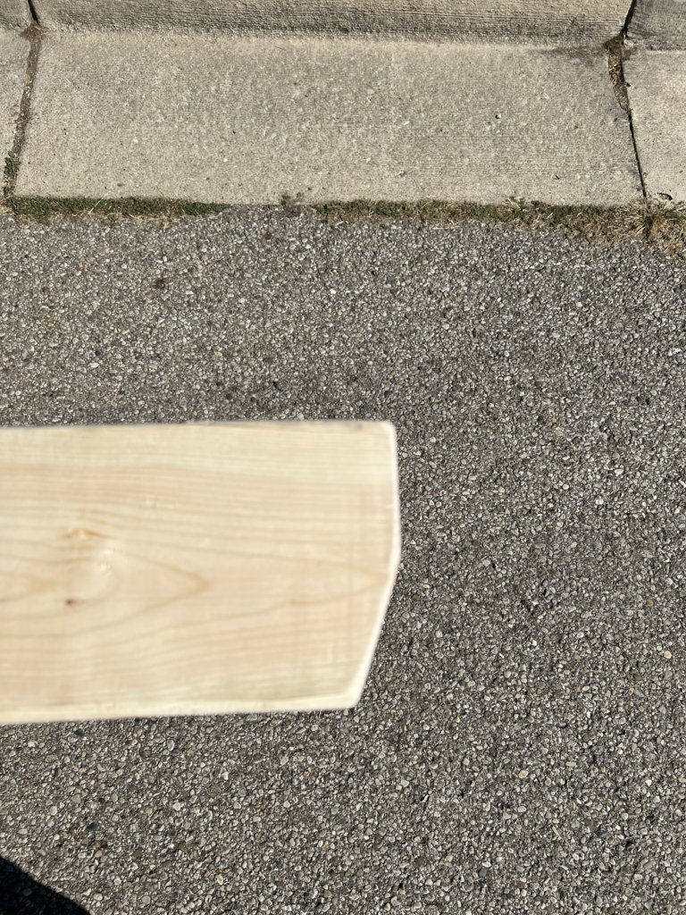

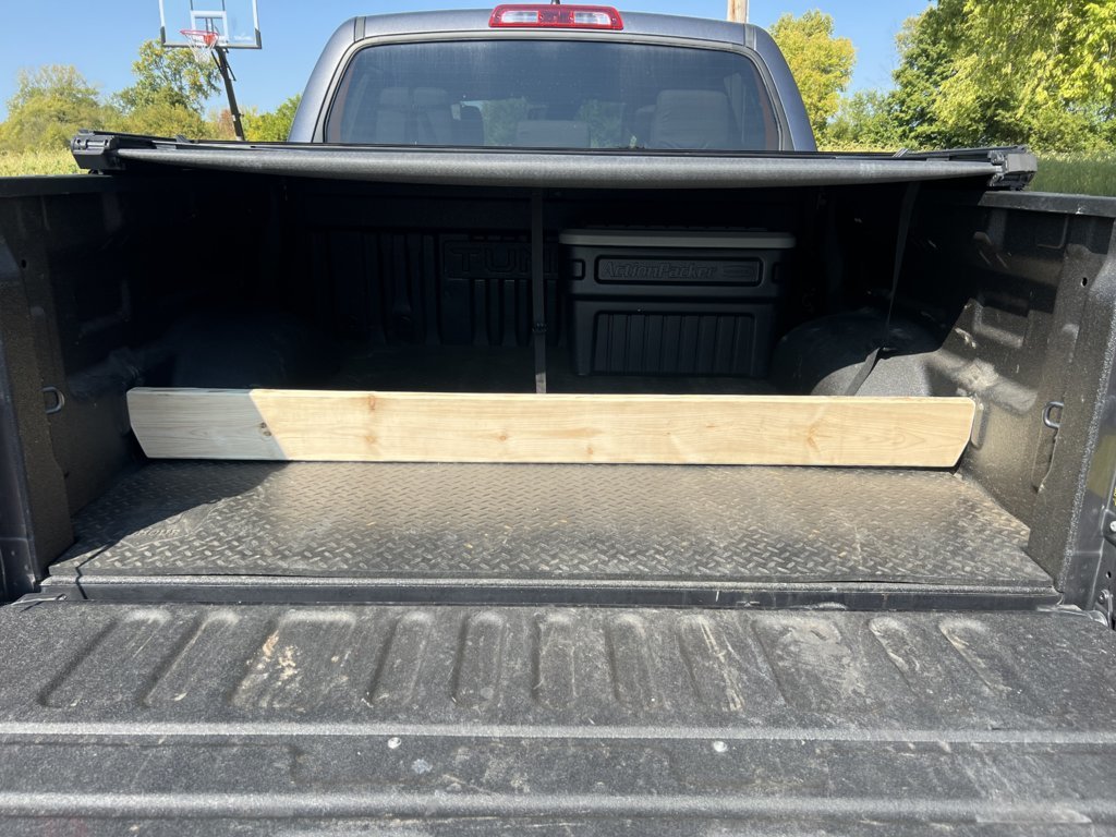

    Couple things
    2x6x8 board, cut down to 66 1/4 length, 20 degrees cut in middle on each end, rounded smooth at each end using a sander. :thumbsup:

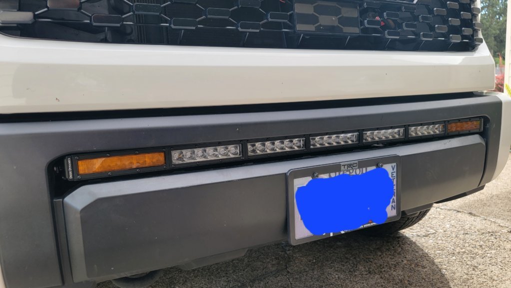

    Finished the 42" DD Stage Series light bar with the "Perfect Mounts" from Hotshot Offroad, well mostly finished. Still have some wire harness management to do, and while I was fishing the wire harness behind the grille, I took the opportunity to put some loom over the front camera wires and clean that up as well. I don't have a rivnut tool and my son's die for his is too small to finish the Rago Fabrication compressor mount, so I will go visit a friend after work tomorrow and finish routing the wiring harness.
    I didn't realize that the switches are keyed to certain spots on the dash, I was going to move the rear window switch over to the right side of the steering wheel, and put the light bar switch under the headlight leveling switch. Annoying. I definitely think I will do a SwitchPro at some point if I have more stuff to control. I may also redo the switch wiring for the light bar if I don't go to a SwitchPro, as I would rather have it behind ignition circuit so it only works when the engine is running and the illumination tied to the dash lights. It was a hassle because for some reason I cannot get the harness to unclip from the Cali Raised LED switch I got, and didn't want to break it.

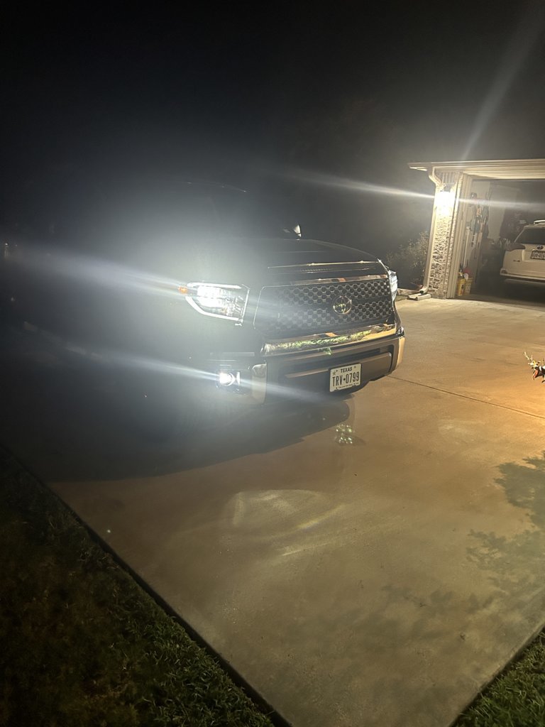

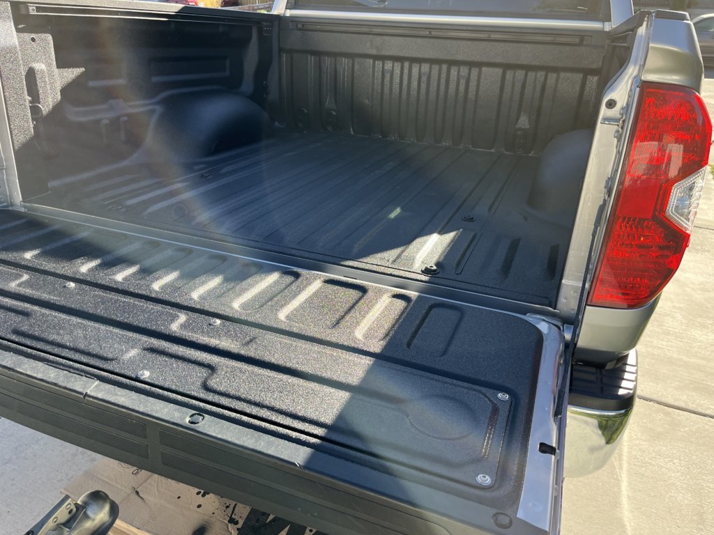

    Bed: lined (Rhino)

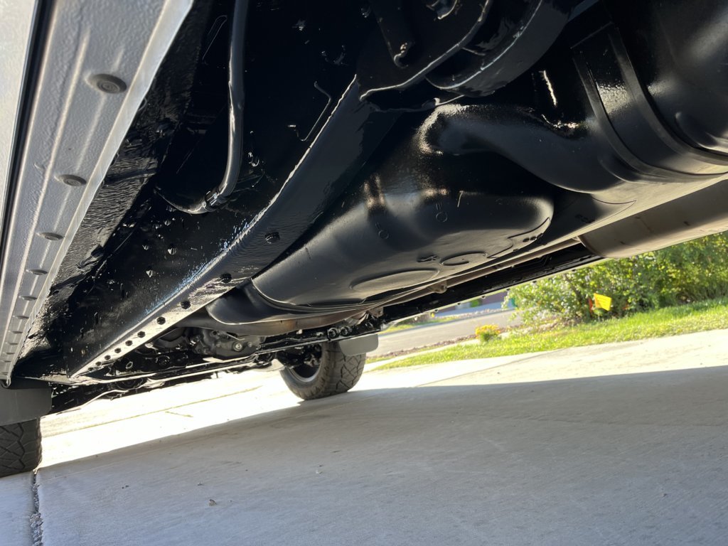

    Undercarriage: Coated (Wool Wax)
    Next: Tonneau cover
