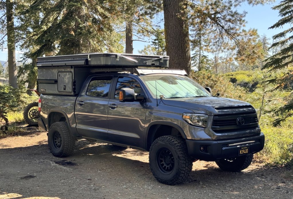

    What flares ya got there Junior?

    Black Rhino Rapid 17" 35x12.5 Mickey Thompson Baja Boss Fox Performance Elite 2.5 DSC at 3" with Coachbuilder 1/4" shim on driver side JBA UCAs Fox Performance Elite 2.5 DSC rear shocks Dobinsons HD Leaf Springs Firestone Airbags + Daystar Cradles Prinsu Cab Rack 2024 Four Wheel Camper Project M Camper Mods: Goal Zero Yeti 4000 house battery 200w solar IceCo fridge Truma Propane Heater

    Best looking flares I've seen for a 2nd / 2.5 gen, I would have added these to mine and added aftermarket wheels years ago if I would've found them. They look factory.

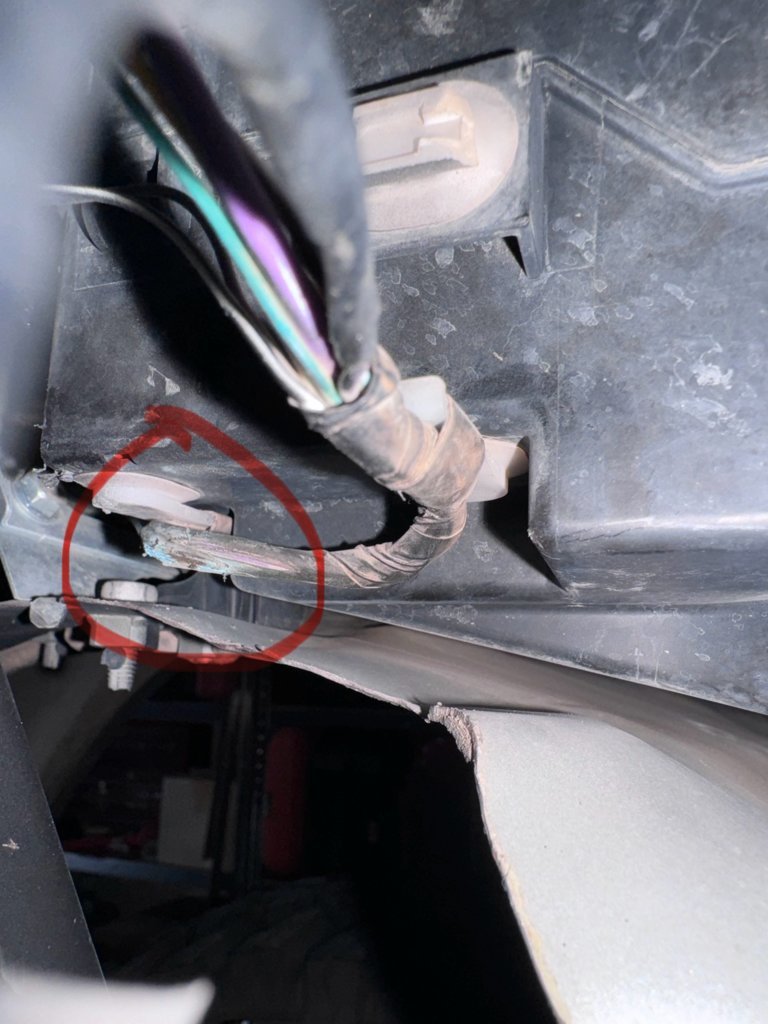

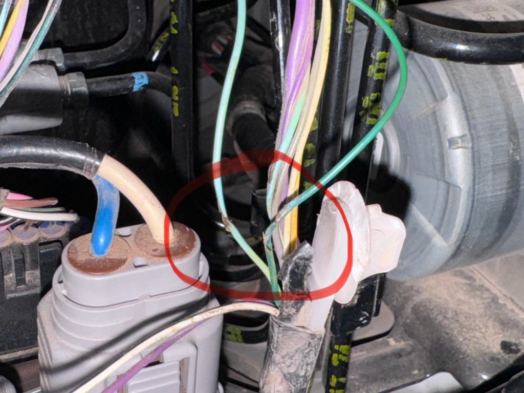

    :mad: Got another nice gift after washing truck from the fab shop that installed my LT kit - battery light on. Alternator output was fine but stuck at 13.6v - 13.8v, negligible AC/no AC pulses at the battery terminals so figured regulator was done. Didn’t feel right so started checking…, sensor wire had fluctuating 0v - 6v, continuity test failed from alt-s fuse to 6 pin connector at the fuse box. Both green wires were nicked when cutting out the inner fenders for the secondary shock hoop, the one strand connecting the alt-s finally crapped out after 4 years. :facepalm:

    Well that’s annoying

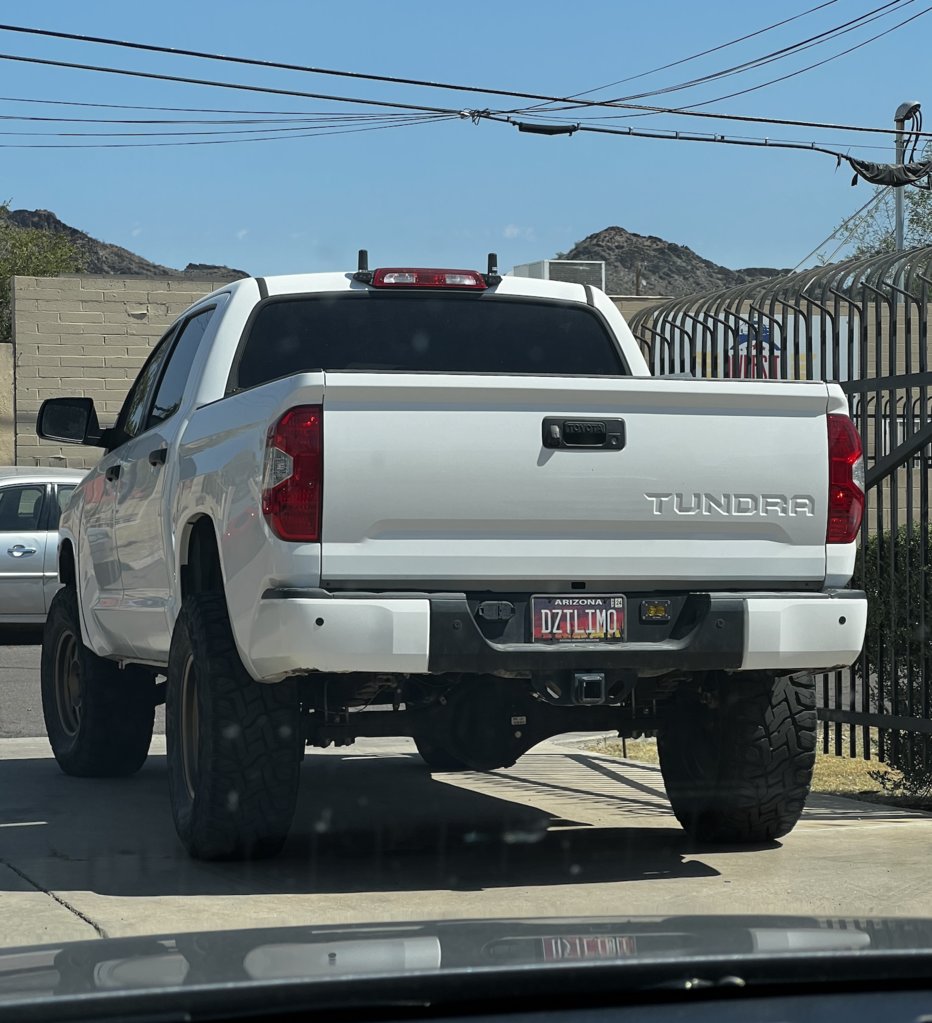

    If it makes you feel any better my truck has been away for over 2 weeks and has been relocated to a different frame chiropractor...can you guess where @Vizsla ? :rofl::rofl:
