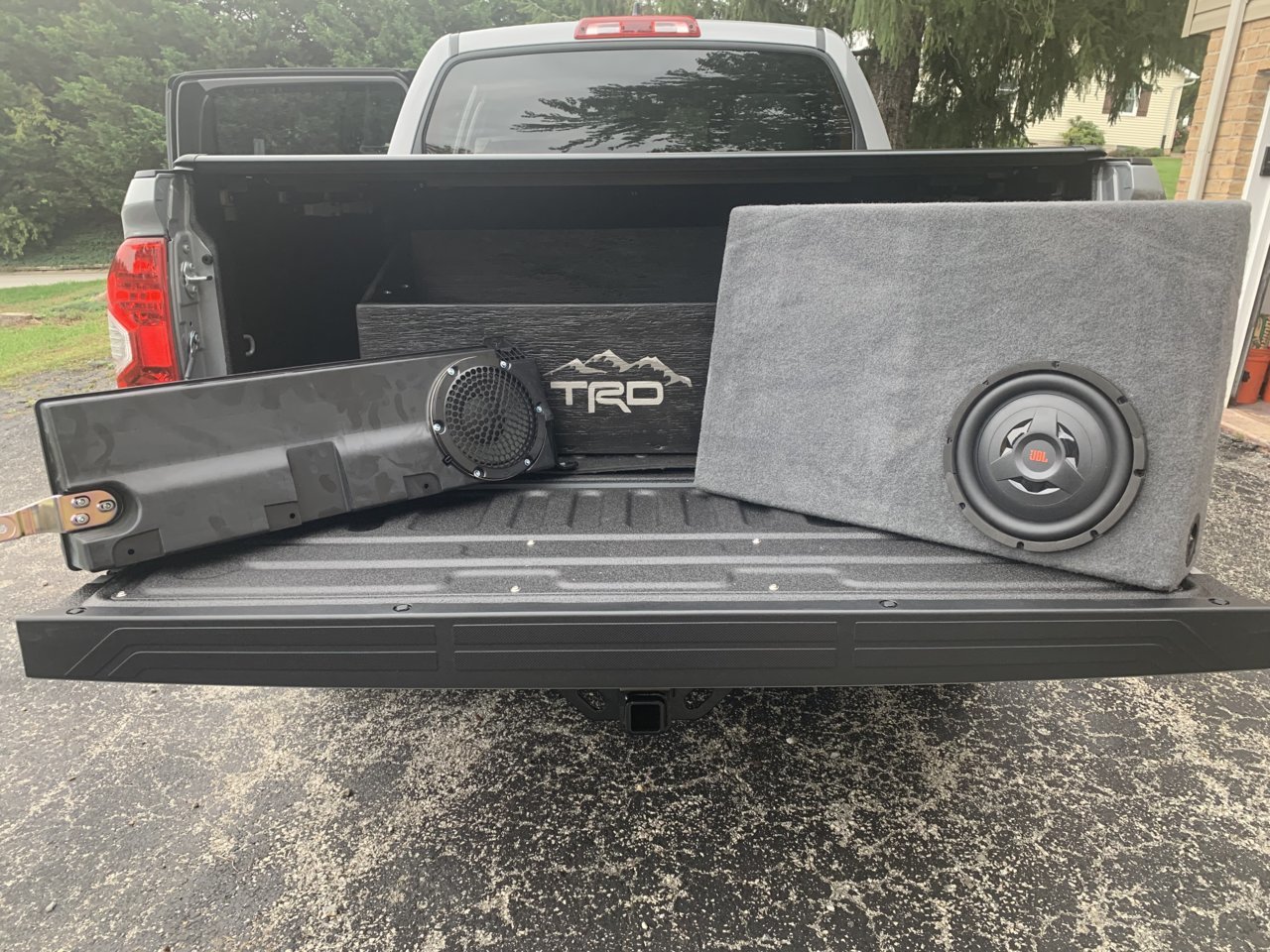

    Installed the JBL sub Enclosure from James Randy Taylor (Tech 12 Volts)

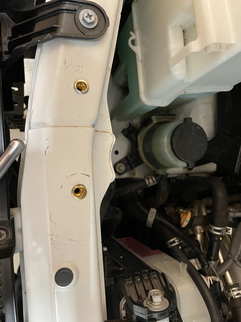

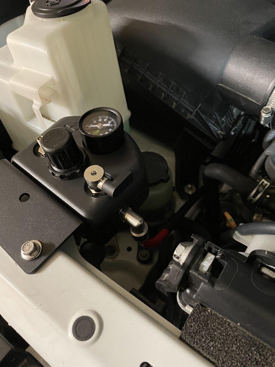

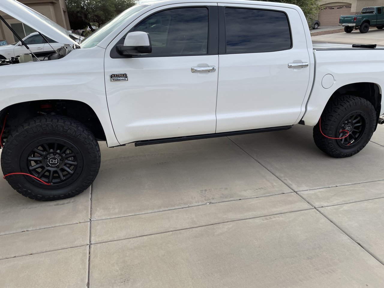

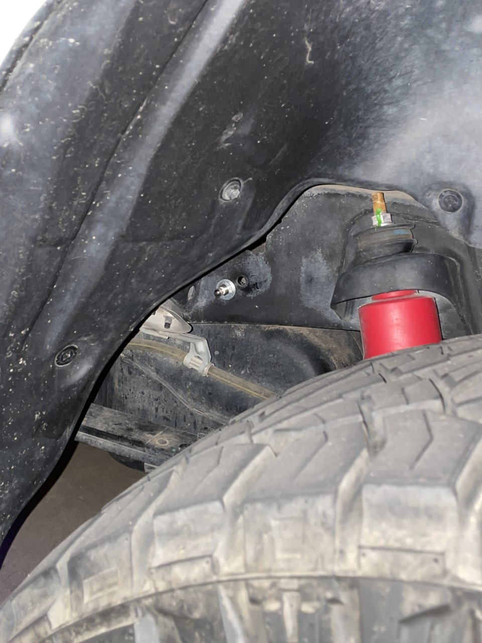

    Installed the Air Up Down system this evening …will test functionality tomorrow, but fully expecting it to run well after seeing one used in my buddy’s truck. Install wasn’t too bad, just a pain routing all the hose across the back wall and out to each of the wheel wells.
    I added Threadserts for the mounting bracket to give a more secure/sturdy platform as was concerned using just self-tapping screws might not be strong enough for the weight when off-roading.
    Last photo shows one of the connection valves at the driver’s side rear (chrome capped valve mounted on the frame)

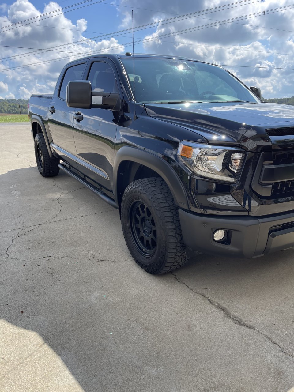

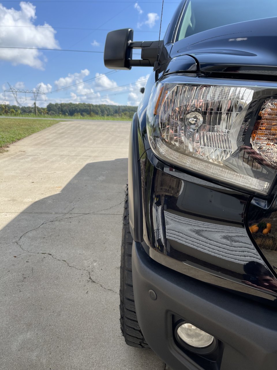

    A2A7E6D0-C736-49FB-8818-55DAD8A554B6.jpg Installed Bushwacker OE smooth fender flares. Wheels are +18 offset so it lines up pretty darn well

    Did you put PPF behind the flares?

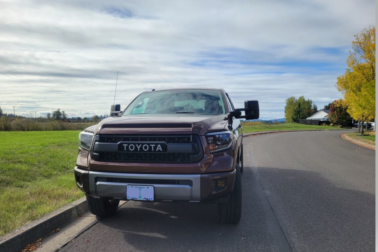

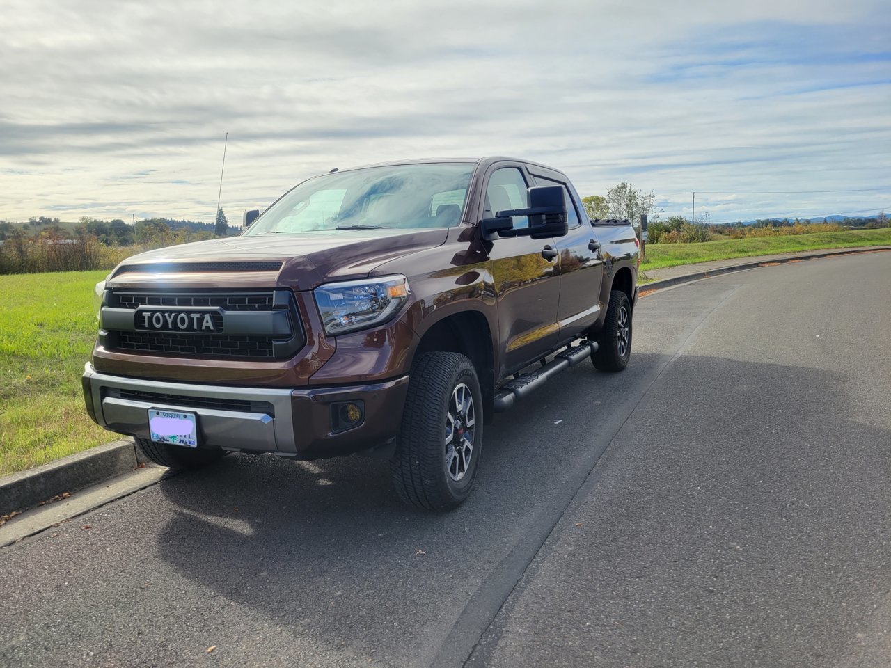

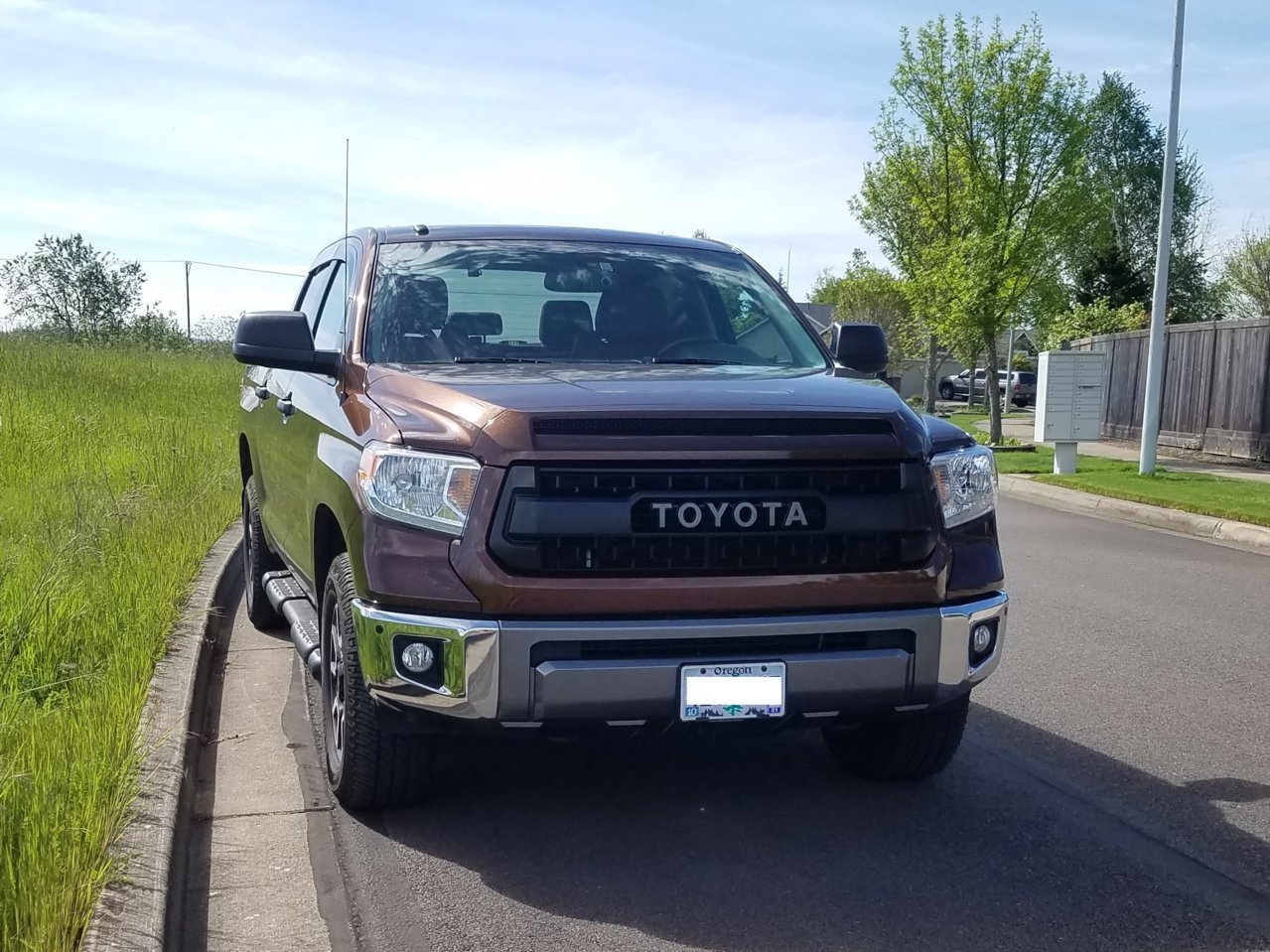

    Installed 2019+ TRD Pro headlights and color matched bumper ends. The bumper ends were powder coated with Prismatic Powders' Lazer Copper. They are slightly darker than Sunset Bronze Mica.
    Before:
    After:
    GAknight, AggiePhil, TomC843 and 10 others like this.
